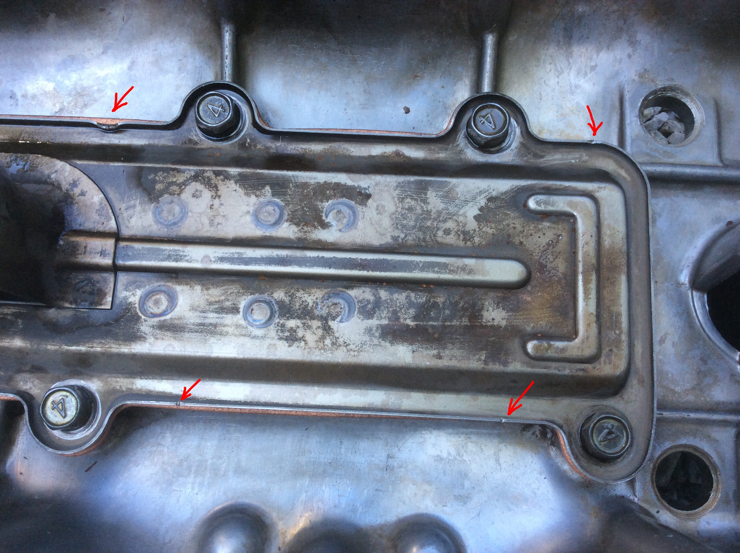

Just a follow-up.
First off, it seems likely i was running the truck way too lean. I had neglected to plug about six vacuum holes on the carburetor, which might (?) explain why it rapidly overheated.
I also took it upon myself the clean behind the valve cover baffle and replace the PCV valve. Behind the baffle (had to remove 8 bolts) it was absolutely clogged with tan colored oil froth and other dirt. As I was playing with that, I may have stumbled on the cause of the "valve noise".
As indicated by the red arrows on the photo, it looks like the rocker arms were colliding with a lip on the valve cover baffle. There are eight nicks or dents on the baffle lip, one for each rocker. The rockers themselves look undamaged, but each has a small worn spot on top where they were impacting the baffle.
Hopefully I did not overheat and kill my spanking new cylinder head with all of my naive incompetence.

You wrote that the cam is new, did you compare to the old one? Measure the lobes with a dial caliper? This is strange?

Weeks later...and the cam measures to be about the same as the old one. Good thought, though.
What i did was take a grinding bit and remove the edges of the baffle in the eight places where the rockers had impacted it.
I realize now that those ding marks may have occurred years ago. There may have been a time when the valve cover had been overtightened.
