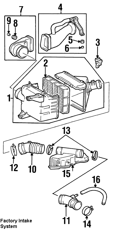

That guy has "Intake Silencer Mod (New)" in his signature, so I did a search on google and here is what I came up with.
http://www.fordf150.net/howto/airintake.htm
Apparently the silencer is like a muffler on your air intake and is a restriction going into the throttle body. I guess removing it will increase air flow into the engine. He also has one of those throttle body spacers which are supposed to increase air velocity into the engine and spin the air but I have heard that they are a fluke. Any thoughts on this?

I think that the Tacoma does not have the intake silencer and that is why it is rated at 190 horse ather than 183 on the same 3.4L V-6. Toyota felt that the 4Runner target market would want it to be a little quieter.

Originally posted by swerks
what does a taco have in place of the silencer, and would it fit our 4runners ????????:eek:
Here are the two 1999 3.4L intake systems side by side. 4Runner to the left, Taco to the right. Part 15 on the 4runner diagram is the 4Runner resonator and part 3 on the right diagram is the Taco resonator. Taco Parts 3, 5 and 6 cost $75. Dont know if they fit the Runner.

96_1st_responder just noted that the 1996-1998 intake is similar to the Taco, so lets not get our hopes up yet...
Here is the 1996-1998 4Runner intake system, difference being the Resonator #2 (part 10)
