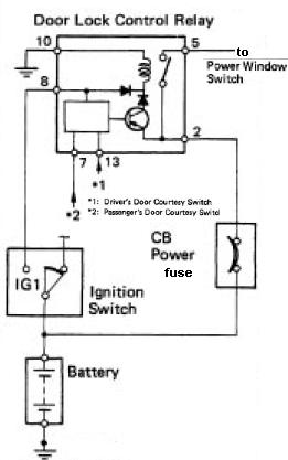

It's D6 - see if this helps.
The objects next to it are A12 Antenna relay and O10 Overdrive relay.
Assuming you started with the fuse?
Assuming it is indeed a bad control relay - if you cannot find a cheaper source for a replacement, if you wanted to you can wire around it quite easily, or put in a $4 simple relay. All the "control" relay does for all that money is give you the time delay after the ignition is turned off. It simply feeds power on/off to the window switches, but has a 60 second "off" delay. Nice feature but not worth $300 to me!

I edited down the relay diagram (@#$& 49k picture size limit) for ya.
Good luck.
