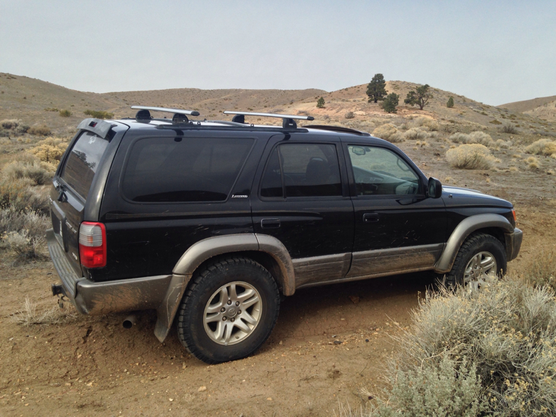

I have 265/70 big o Bigfoot tires. Small amount of rubbing at full flex and turn. No lift.

I do. On my profile picture.

Care to post a picture?
the pic is small in your profile
Thanks

What year 4runner do you have? Wasnt 99 higher than all the other years and the rest are about the same height? Is your speedometer off?
What brand are your (big o Bigfoot tires)?
Thanks for your help here
Old Mar 18, 2015 | 02:11 PM
konah's Avatar
Joined: Dec 2011
Posts: 144
From: Reno, NV
2000 limited. There are places on the web to figure out change in speedo differences. I may be off by a mile or so depending on the speed. The brand is Big O. American made, I think they are made by a well known tire company. I have used and trashed a couple other brands in the high desert of nevada. These are doing well so far. Road noise is not a concern for me, so I can't answer that.
