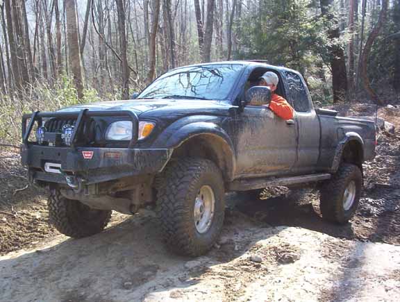

That is exactly what I did on my 2002 Tacoma but I had a 3" body lift. I was able to notch the mounts and move the bumper up 3". I retained 4 of the 6 mounts that hold the ARB to the brackets and then laid some heavy welds down. It still wasn't as strong as before but it held up to some heavy winching. Be sure to lay down some good solid welds and not tacks. In the pic you can see where the brackets hang beneath the bumper. I didn't move the brackets at all. They still mounted to the frame at the same exact point.

km runner, if you're winching and wheeling in that you should move your bumper down about a half inch, being flush up with the body is just asking for trouble

Hence the importance of laying down some good solid welds. I had about a 1/2" gap in between the bumper and body when I first installed it. After some heavy winching, it tilted the bumper up towards the body. No worries, it has been fixed since then and I no longer have the truck.
