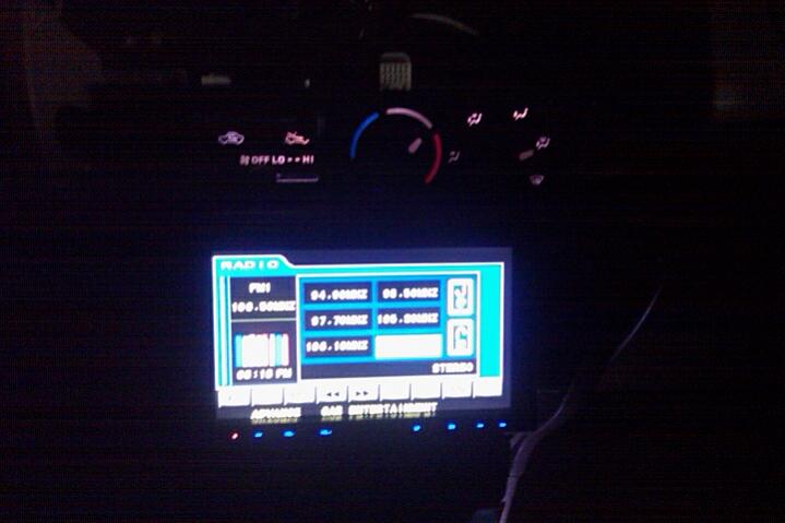

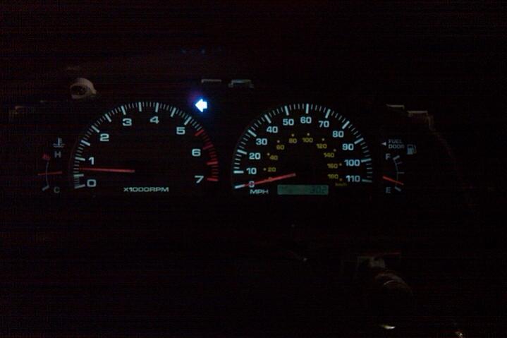

I'm re-doing mine with LEDs this time. I tried with reg bulbs first to see how well they turned out and I didn't like them too much. I think there will be hotspots with LEDs and that's the reason why I tried incandescent bulbs first. I will post some pictures once I'm done with the leds. I'm still waiting for them to coming in. The incandescent bulbs coat me about $20 and I just paid $40 for the LEDs. I would buy extra neo-wedge leds though cause they are a pain to install/remove. I ruined 3 of them trying to remove them.
Here are some pictures of what I have done with the reg bulbs. I used xenon super white bulbs, but it turns out to be kinda dull green. The turn signals are blue bulbs (kinda teal, unless you remove the green arrow covers). The HVAC are super white bulbs (not as bright as I wanted).

dragonboy, that looks legit, i like ur head unit, how much did that cost you? and i belive if u get the 3 way light bulbs, they will not have hotspots, or at least what people have said on the fourms. I plan on doing this , however i just paid my school tutition and im BROKE . i hope u like the LED swap though
