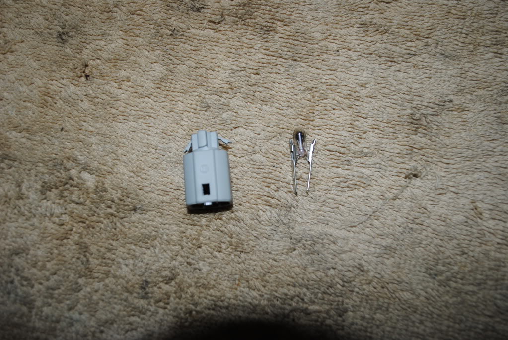

I ditched the radio shack LED idea as soon as I realized I had leftover neo-wedge LED's that I could simply take the LED out of the base and use. I took some pictures for reference since the cigarette lighter seems to baffle people more than any of the others.
Plastic base with bulb and pins out of it.

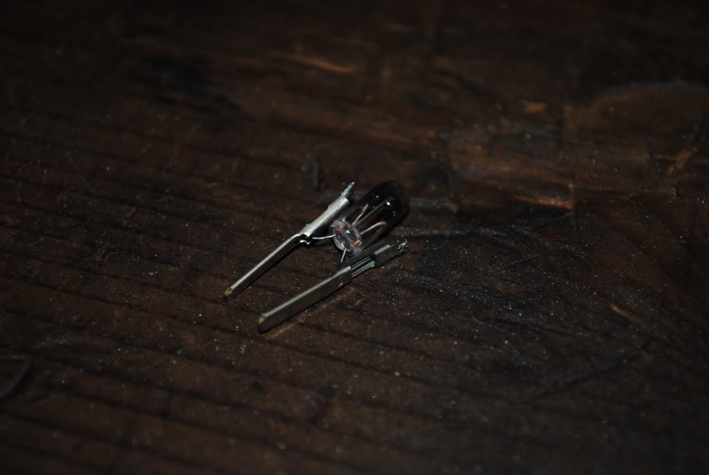

Factory bulb and pins after removal from base

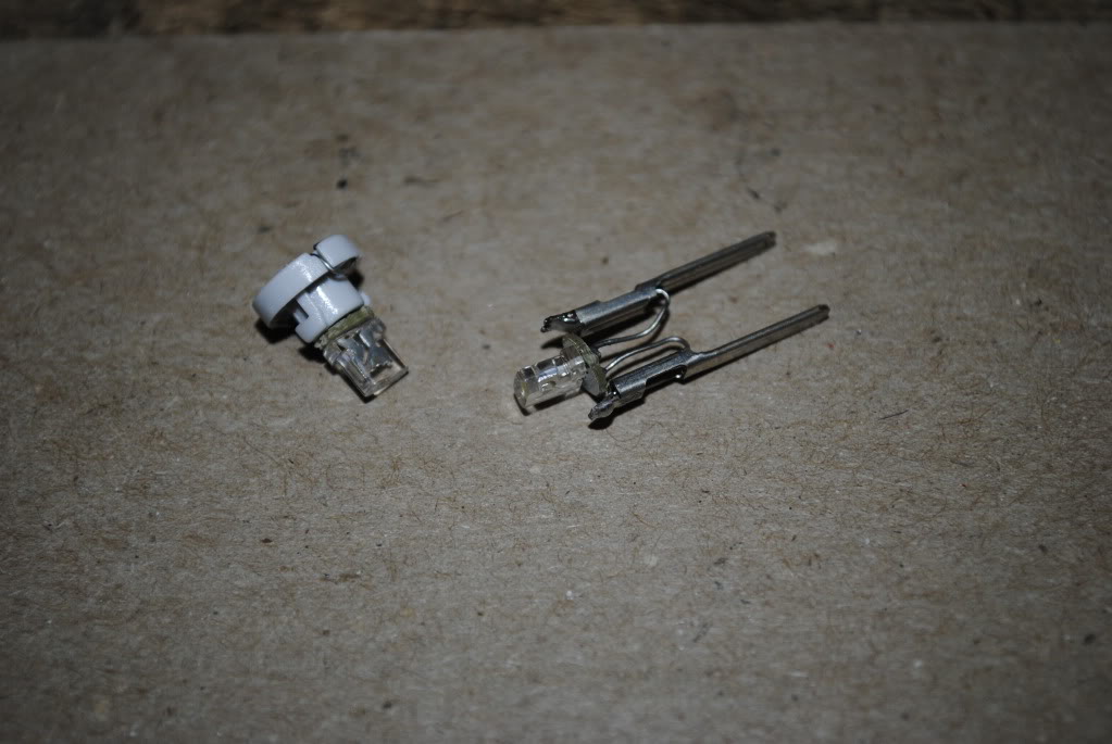

Single neo-wedge LED completely installed into cig lighter plastic base.

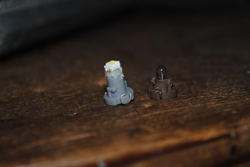

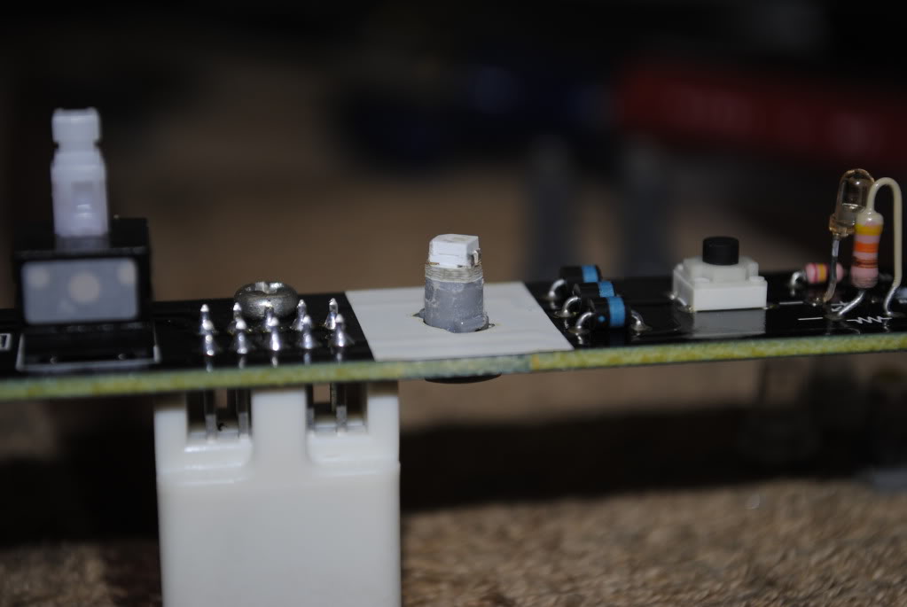

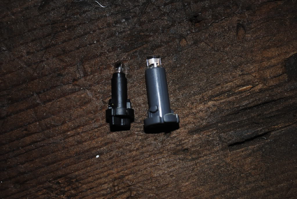

And here are some pictures for the bulbs for the rear window button, defrost button and ECT button. It's just two bulbs.
1999 SR5.
Stock bulb (right) compared to a Type A smt LED from autolumination. I had to turn down the LED on my bench grinder to make it fit...it's already been ground down in this picture. The disc under the SMT LED is too big initially...that's what I ground off.

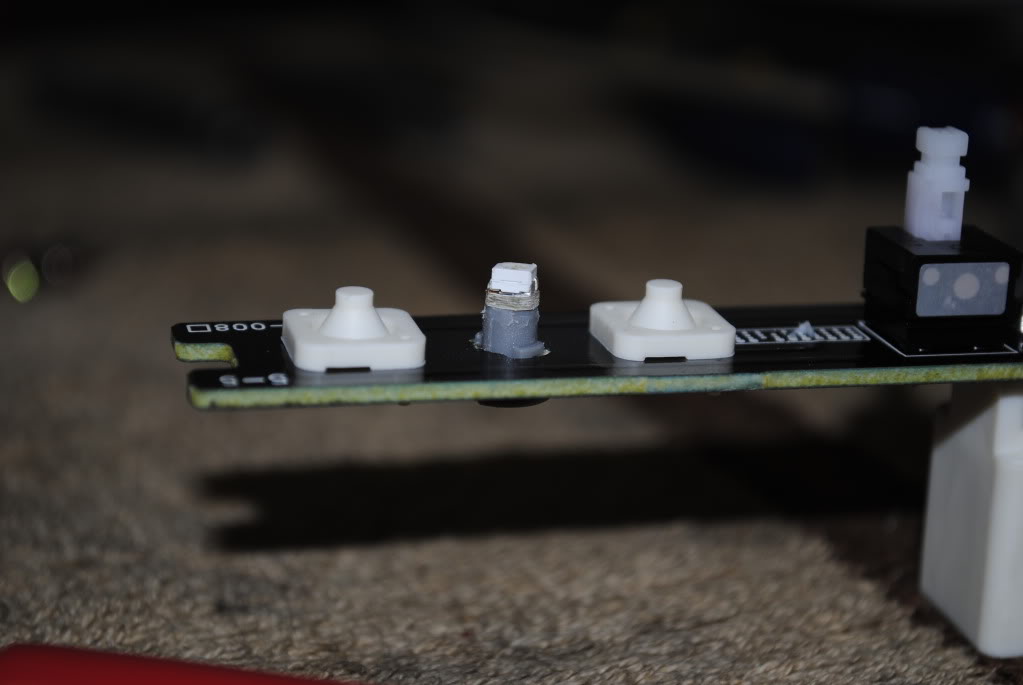

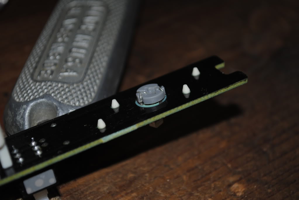

Installed. They would not turn and lock into place, cause the notches aren't big enough. But since the whole entire bulb base was so big, they stuck just fine by friction.
I used two of the exact same bulb...even though the factory bulbs are not the same. One is tall and one is short. The only tall LED's available are Type B though....WAY too big. Pic for reference. The short LED works great in the spot where the factory had a tall bulb....because it's so much brighter than the stock bulb.
