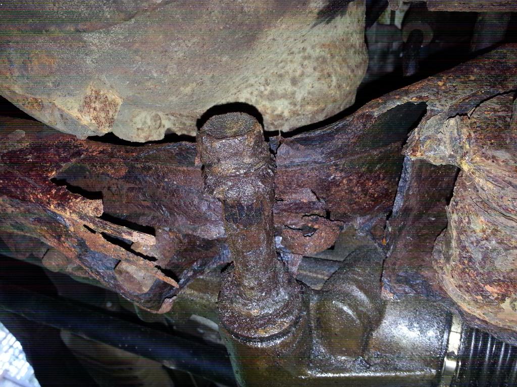

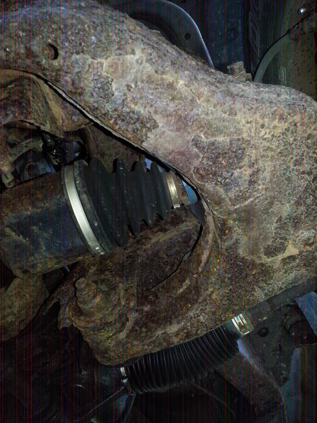

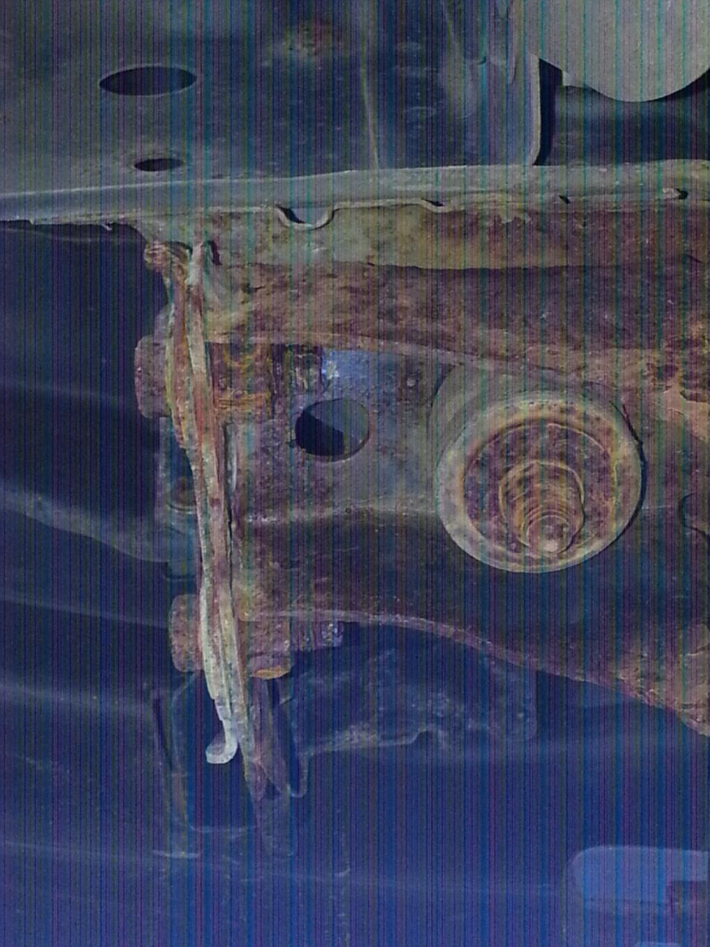

This Tacoma I have has a great drivetrain with only 145k on it. The previous owner quit driving it because of the rusty frame. It's pretty shocking. I'll get some pics pretty soon.

Well the difference is the 4Runners were all built in Japan!!
The Tacoma was built in the USA The Frames Built by Dana Corp .
What makes it hard is your truck being in that year range means not a whole lot of donor frames still going to be alive.
I rather doubt buying a new frame from Toyota is within the budget .
Waiting to see pictures .
Size:  190.0 KBURL=http://s166.photobucket.com/user/shedmr/media/Mobile%20Uploads/20150214_143453.jpg.html]Name:  20150214_143453.jpg
Size:  257.3 KB Name:  20150214_143413.jpg

See what I mean. Shocking.

it will work but it might be as bad as yours in a short time
Just curious where your truck came from.
I never saw a front end that bad.
