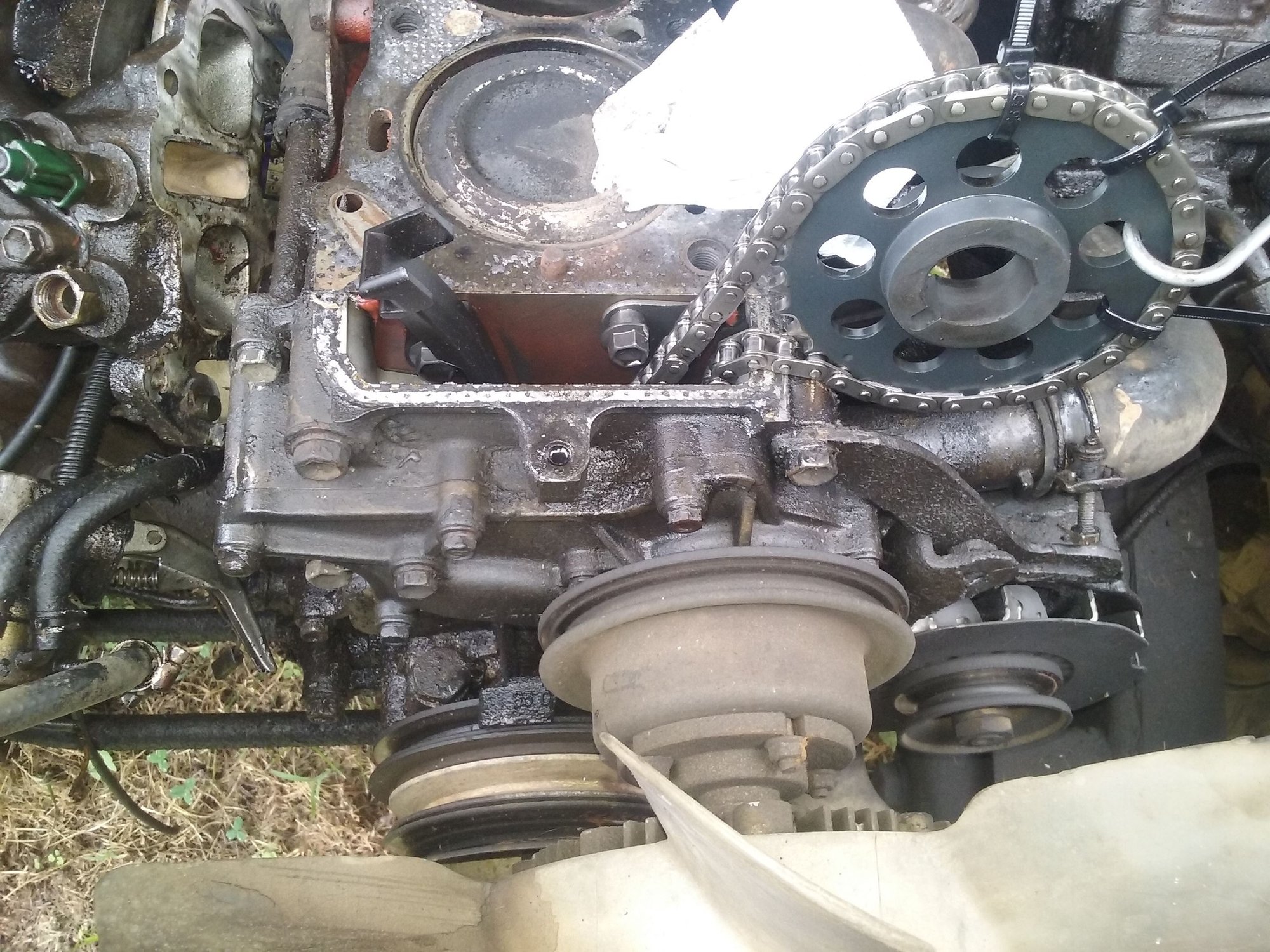

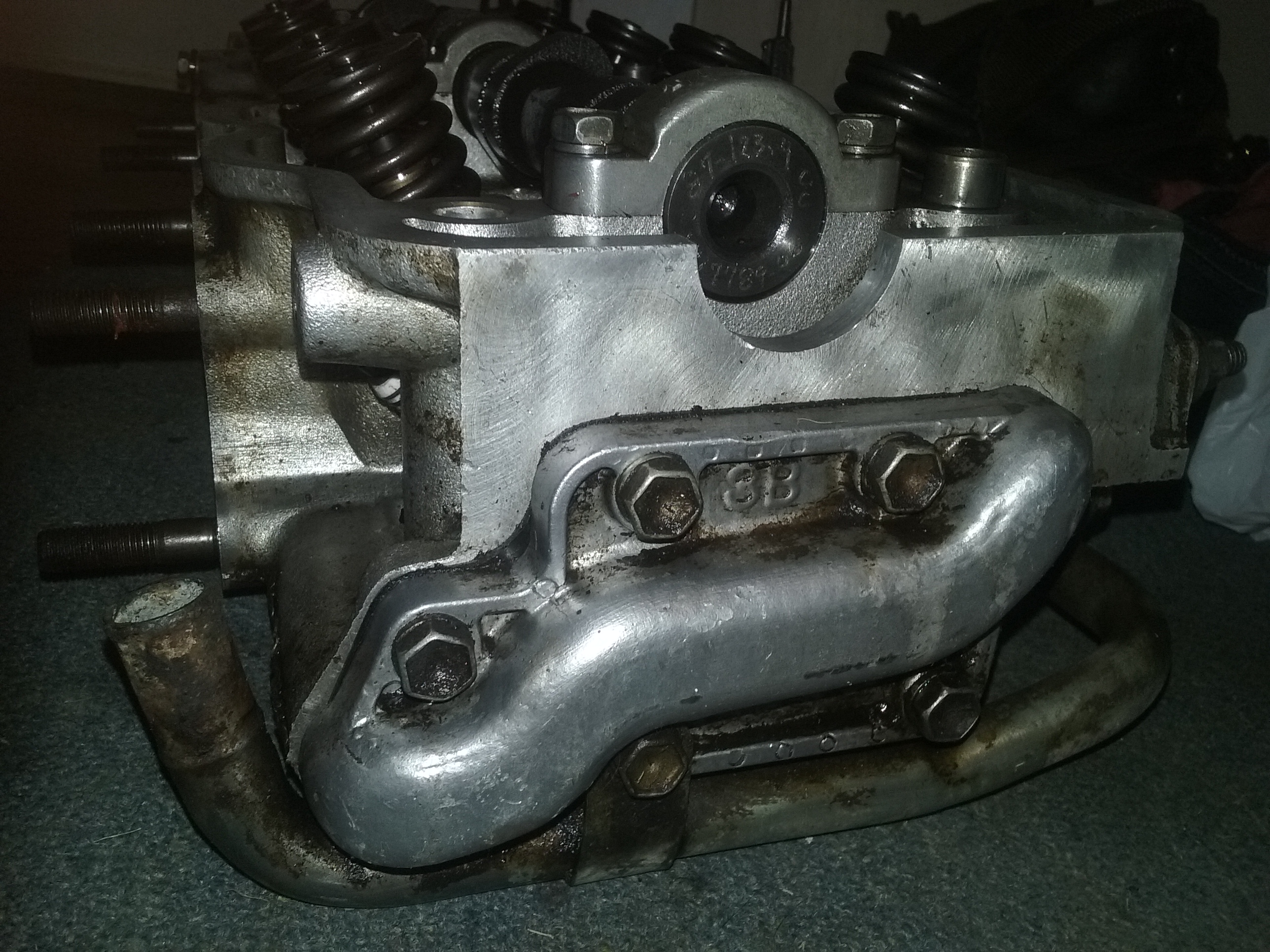

I have an 82 toyota 4x4 pickup with straight axle, i recently did a dumb thing and needless to say my mechanic says it needs a new head in which i have off but im having problems finding the exact fit (as im no pro but no dummy either). My mechanic told me that i have an 86 model engine but I dont know exactly what head(s) are compatible with this, or if the one i have is worth just getting fixed. My engine was running fine when I took it to mechanic but it was blowing LOTS of compression out of the PVC valve and creating big smoking mess as well as blew the head gasket in 3 spots (says the mechanic). There appears to be no wear on the lower block I just need to get a new head or get advice on whats wrong with this one and get it back on there ASAP. Pics are included! Any info will help im lost with 2 much compatibility info and not enough knowledge about my engine that is apparently different age than my truck!

I would find a new mechanic because he does not know crap about Toyota Engines. That is, without any doubt, a 1981-1984 22R head (Based on the round ports and intake bolt pattern). You CANNOT put that head on a 85+ block and you CANNOT put a 85+ head on a 81-84 block. Actually, let me correct myself.... you technically could, but after you get the machine shop bill from the stupid amount of modifications you would need to make you would have spent more than you would have if you just bought a complete engine.
You're likely going to need to rebuild that head. Nobody makes new castings for the 81-84 heads and very few (if any) reputable Toyota engine builders have those heads available - including Engnbldr and LCE.

Also, what makes you believe that it is not the original engine? Another way to narrow it down, but not definitively would be based on the timing set. If it has a 2 row chain then it is likely a 81-82. If it has a single row chain then it is a likely a 83-84

But bottom line, that is a 81-84 head so if you want to use the block it came off of, you MUST use a 81-84 head to replace it.

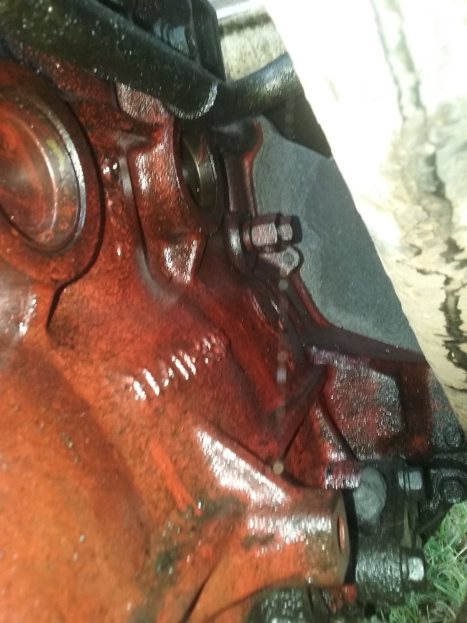

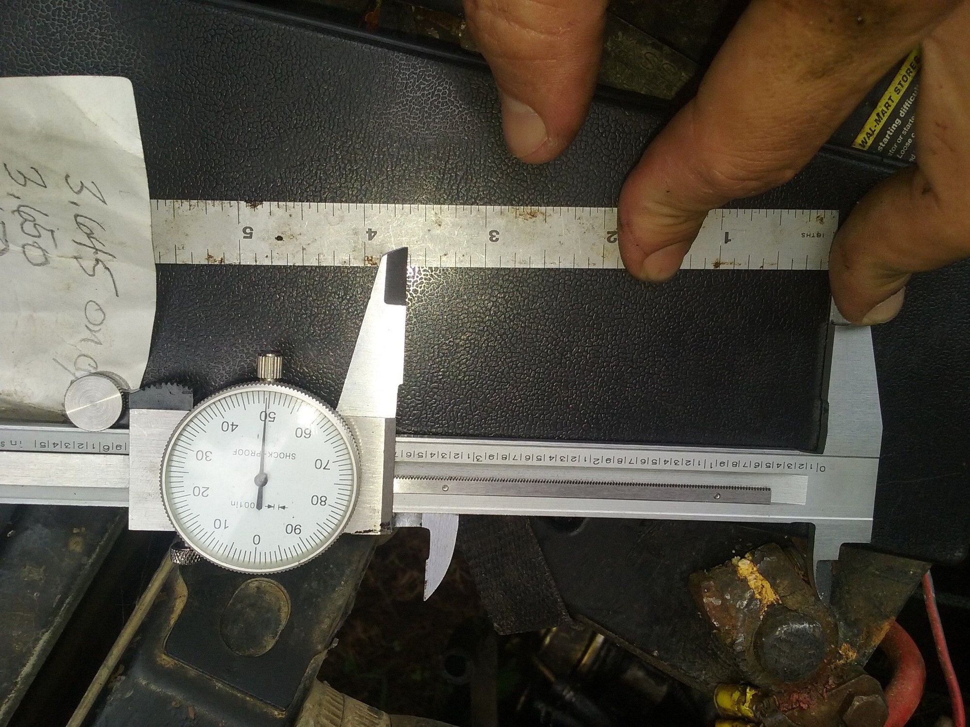

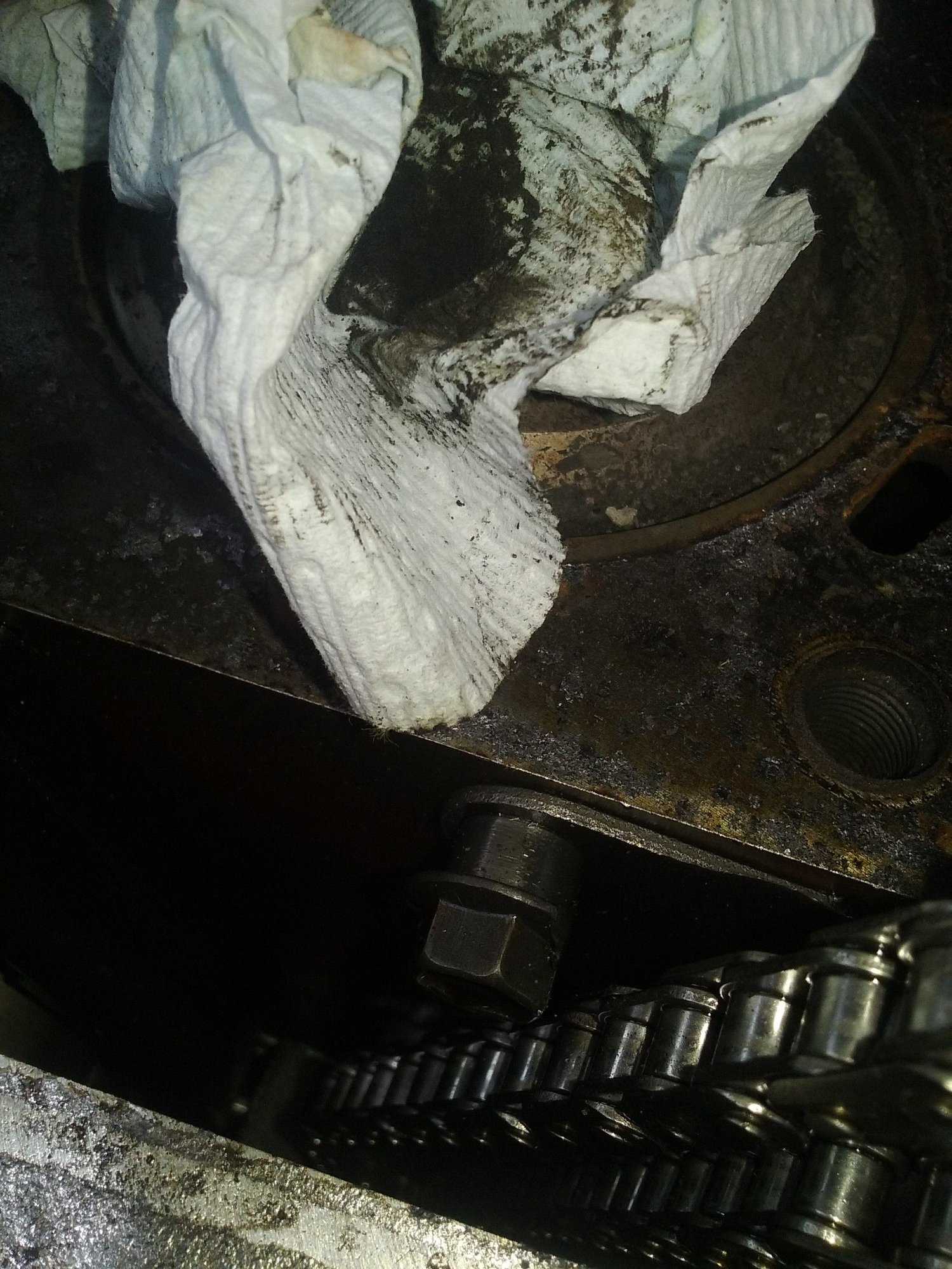

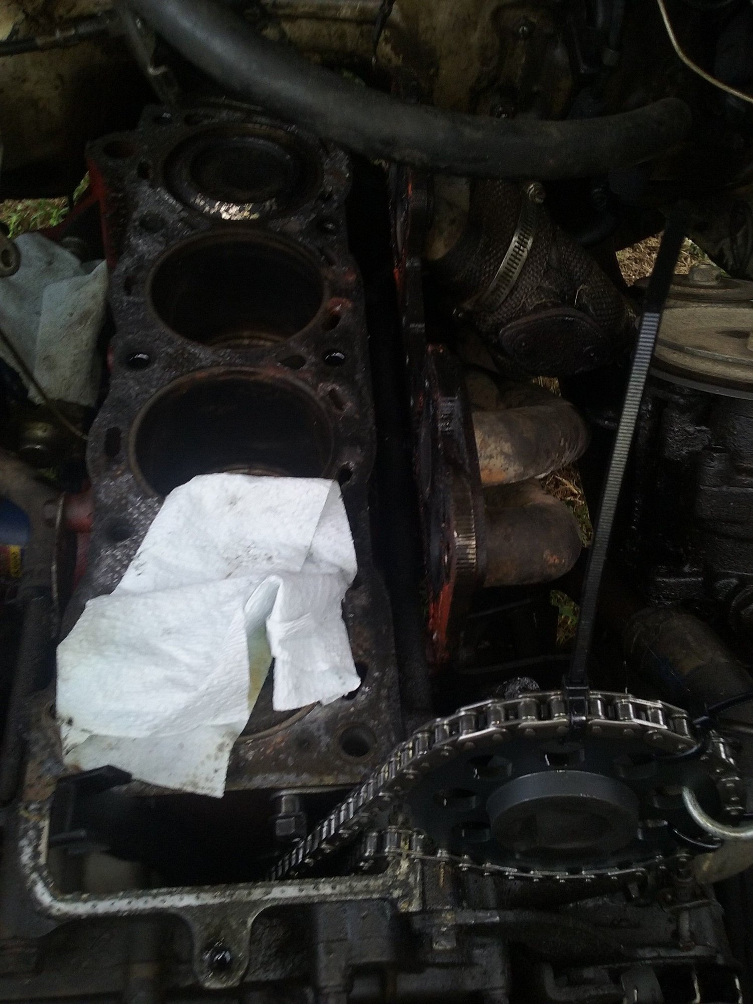

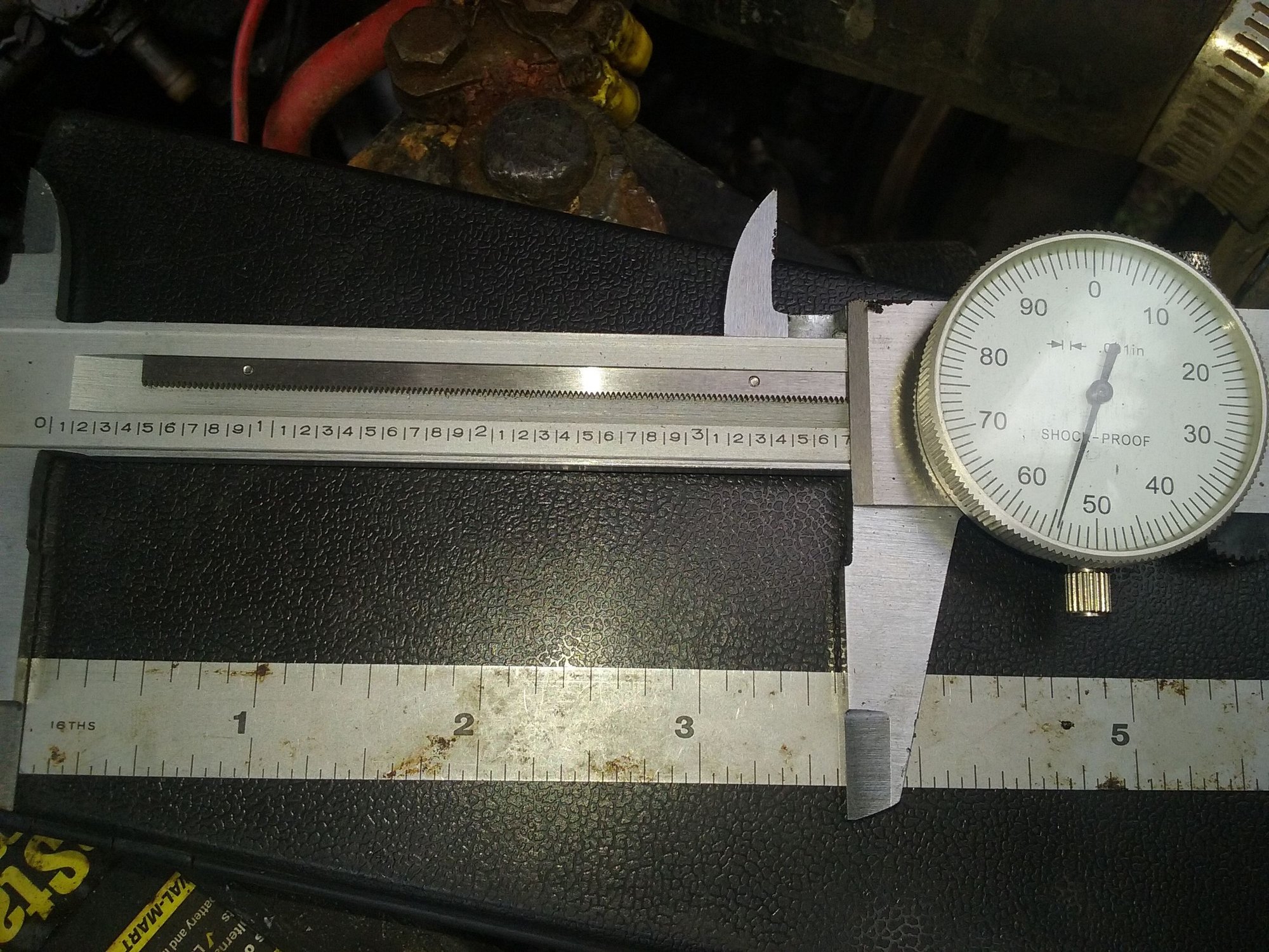

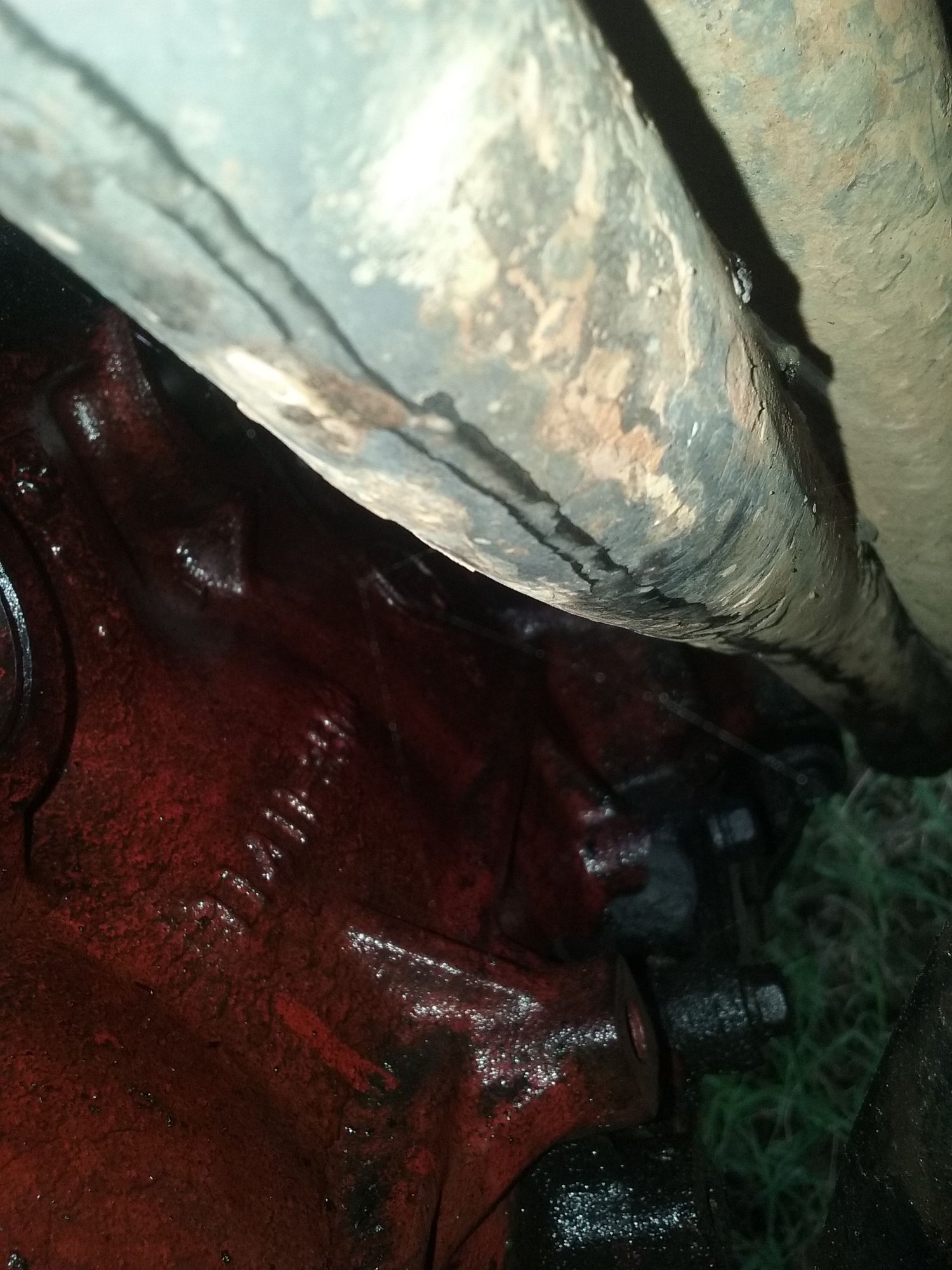

Here are some images of block I finally got
The diamater of the cylinder walls were 3.625
timing chain wear but LOTS of water coming from somewehre that will drain immediately to oil pan when put in radiator without running

How many times do I need to tell you that you have an early 22R engine (1982 to be specific) before you actually start rebuilding it??

He's correct, early 22R head. Look at this link, it is stickied at the top of the Newbie section.
https://www.yotatech.com/forums/f120...k-head-243586/
Your head is not compatible with 85 and later heads. Early heads are difficult to find. You can, however, swap the entire motor out of an 85 or later truck into yours. Intake and exhaust can be kept original to your truck. Mixing and matching parts can be a headache down the road for you or especially a future owner, but it's an option in a pinch.

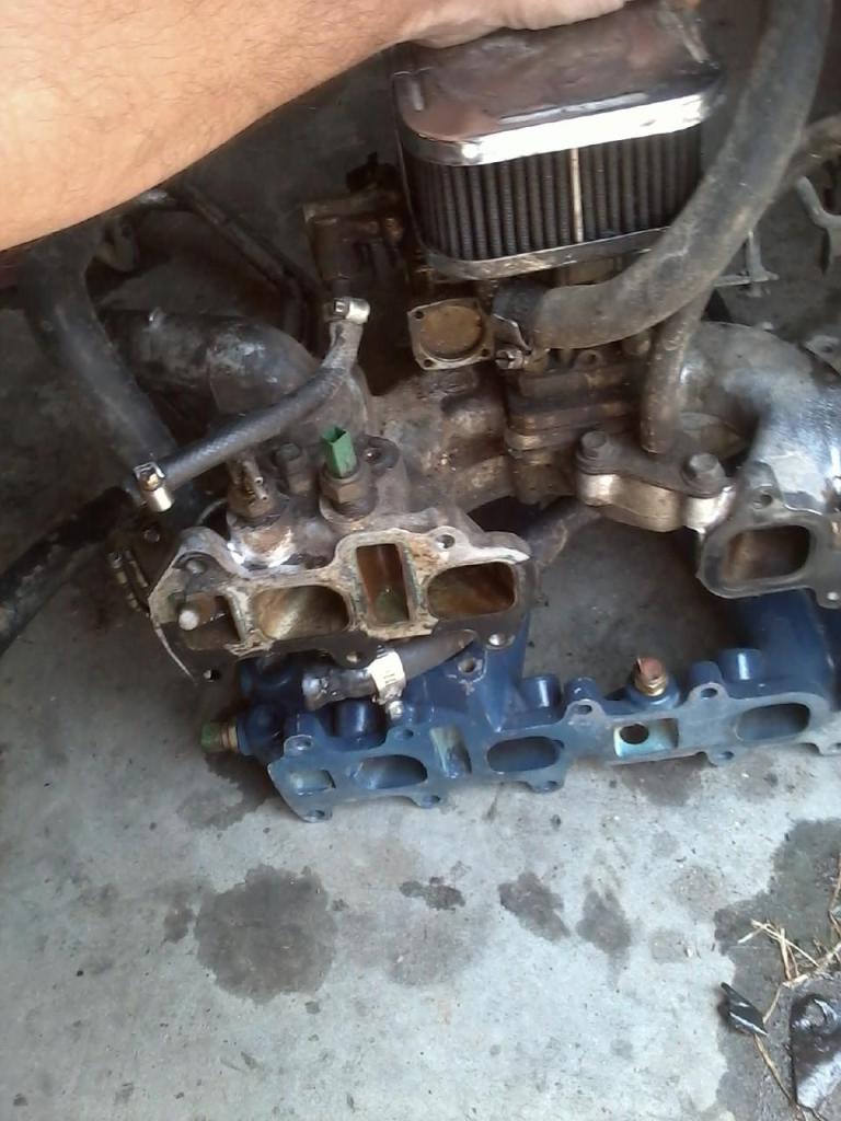

I have heard both, yes and no, that a older style 22r can be adapted to a 22re. I am going to say no as the intakes are not interchangeable. I could take a 22r harness and replace it and make it work, but I have this motor sold and will just rebuild a motor that I have.
Here is a intake manifold that I used for my 86 Runner and something wasnt right on it and had to use another. The first stud up by the fuel pump lines up but nearly all of the rest dont as you get furhter to the back of the motor.

I've seen an EFI lower manifold on a round port head. Strange that you tried a seemingly identical configuration and it didn't work.
