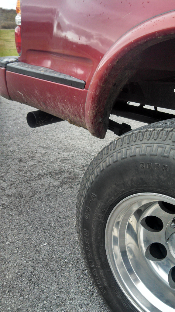

I have looked and looked on the site for answers cause I know that it has been brought up a hundred times but I need help , I just spent 5 Hrs yesterday putting a custom exhaust on my truck . I ran a 3 in pipe from the down pipe to the front of the bed and split it into two super 40 delta flow mufflers and continued the 3in out to two tips with no cats . An I drove the truck home and it feels like I'm pulling my 4wheeler now ,it seems to have lost quiet a bit of power ? My q is do u all think the computer will adjust to the change or am I going to have to step down in size ? BTW its sounds great an almost too loud !

I'd love to do away with that crappy crossover deal !why Toyota done that I'll never know ??? But I'm gonna go to a single pipe all the way 2.5 and turn it out like factory cause it runs Like crap I have drove it all day and it hasent got any better lol

Well I fixed the low end prob I put a piece of 2 1/4 pipe from where the from cat was to the axle ( nothing in the pipe) then 1super 40 delta flow muff -2 3/4 out kinda where the factory exit it to a 3 in tip and it runs better than ever! I never thought that scavenging made that big of a deal ! Wow
