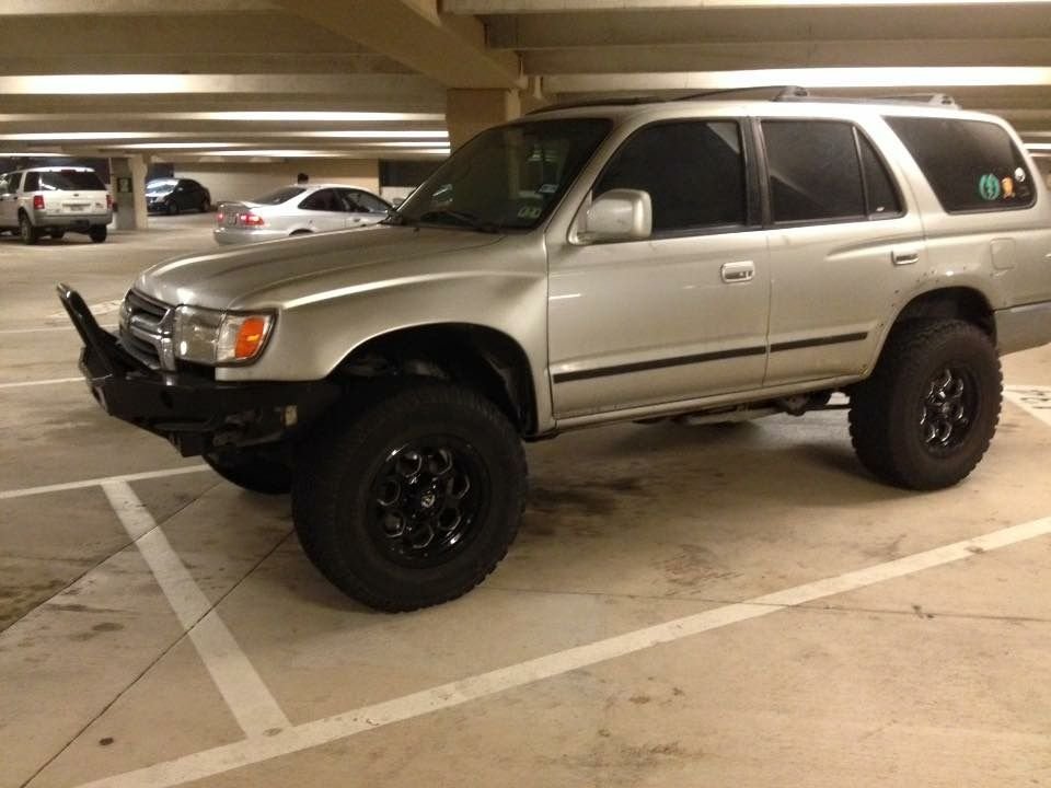

Apparently my engine is bad. More likely shop did poor work. But the rear axel was replaced end to end brand new within the last few years. Tires and wheels very new. Is it worth it or pull the big parts and scrap the rest ?

I had the motor rebuilt less than 2 years ago. But also had to have trans rebuilt about 5 years ago. Financially I’m not sure I can afford a new motor. But I’m thinking between almost new wheels and tires, powder coated bumper, and almost new axle I can get 5k ? I love it but I’m exhausted. It has been at the shop that did the rebuild for 2 months and I’m just ready to give up. And I don’t have time, nor probably the tools, to do a full swap myself. I’m in Houston area.
