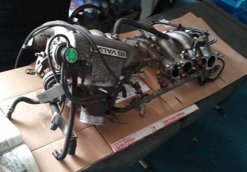

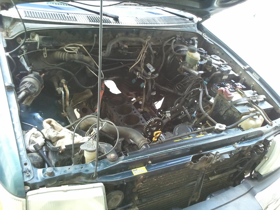

@TA: what do you mean I need new bolts anyways? I didn't get any new bolts.. my current ones look fine. I don't want to buy any more than I have to.. if these bolts will work then I'll just use them
How so I know if the bolts stretch?
I need to know.. cuz I think I'm going to put it back together myself.
Last night and this morning I removed everything from the engine compartment (intake and exhaust manifolds, plenium, feul rail, throttle, etc. labeled everything, with tabs of duck tape that have matching numbers and cleaned up everything as well as I could.
At this point, I think I have a much better handle on things and should be able to finish the job. Plus... no mechanic would even look at this until monday... and with any luck I should be able to pick up my Cylinder head from the machine shop today and that gives me the rest of the weekend to put her back together.
I get the feeling that the machine shop keeps trying to nickle and dime me and keep jacking the price up... so I really don't want to buy new bolts if I don't have to.
the quote started at $405 then.. OH! and extra $80 to resurface, oh and wait... we need to replace that valve that's extra... OH, and maybe other valves need to be replaced too! geez! I thought they were just going to replace all the valves since they are grinding them all... now they are saying that's extra.... and this doesn't even count the $140 for the gasket kit I had to buy and give them.
This just in.. the shop had the head ready they replaced 1 valve which cost $31 !!! I thought they were 8-10 bucks a piece.. oh well... everything with tax is $540.39 I expected 500... extra 40 for the rush seems fair.
Also.. I need to do something about the exhaust manifold... I guess I should just get a new one. Have to price that out... should I just upgrade to some doug thorley's? maybe a junk yard will have a cheap OEM replacement.
Attached Thumbnails Compression shot in 1 cylinder - Burned Valve? HELP-engine-compartment.jpg   Compression shot in 1 cylinder - Burned Valve? HELP-intake.jpg

The stock head bolts are stretch to yield bolts and are supposed to be replaced after being removed. You can try reusing them but should one stretch after it is installed it will warp the head. They are usually pretty cheap directly from toyota, not sure about where you are.
You can try reusing them though, just pay real careful attention to how they torque and make sure they are all the same.
The head rebuild price sounds about right for your location considering everything costs more out there.
For the exhaust manifold, if you want to upgrade to some headers now is the time to do it, I would rather go with a turbo setup personally. They are cheap and easy to install but cost more.
Just price it all out and see what option is best for you.
