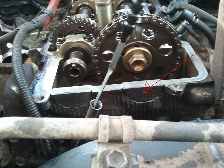

but I can't seem to the the semi-circular plugs out to remove the timing sprocket.
PB blaster and mallet? it says nothing in the haynes manual about how to remove them.
the illustrations just all of a sudden show it removed. pfft... any suggestions?

#39
here is a pic
haynes shows it removed... I can't get my socket on it without removing it... If i had a large 3/4 closed wrench I could leave it in... may be time to go buy some tools
