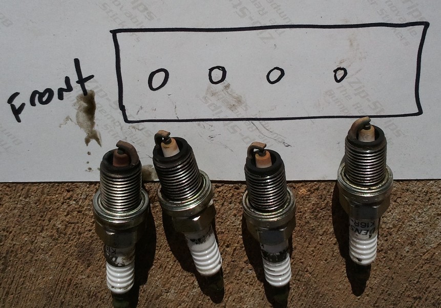

I ran the compression check but being a complete noob, I did it cold.
cylinder #1 is only at 50psi..... 2,3 and 4 are all at 175 psi.
Again, being a noob I didn't do a wet test on the low cylinder. My coolant, and oil look fine. Seems as though the #1 valve is leaking not #3.. but it may be burned? take a look at the plugs.
Does that look like a burned plug / valve at #1?
OK... so my question is... How screwed am I? What do guys think is going on here?

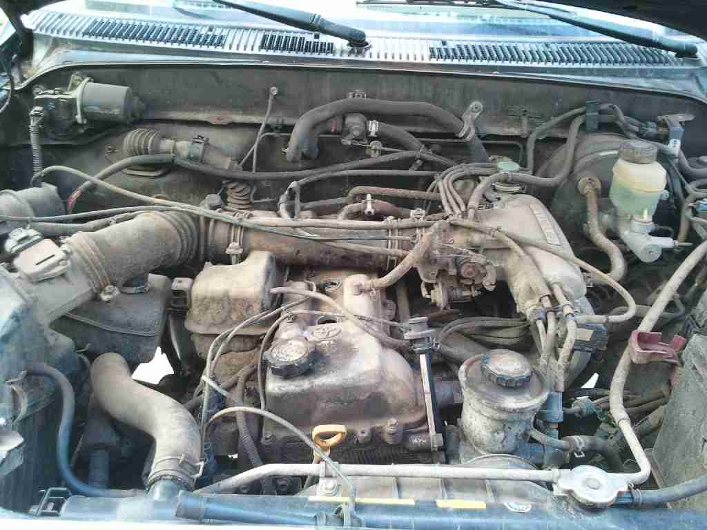

here is a pic of my engine compartment.
Thanks to everyone for their help.

With compression that low in #1 sadly I think you have a problem a little more serious then Seafoam is gonna fix. Your mechanic sounds reasonable that a burnt valve or messed up piston are the most likely causes.
The spark plug does indicate that you are getting some oil into the cylinder so it could be the piston/rings although generally stuck rings will still have more compression then that.

Hey TA.. could you point out which vacuum line I'm supposed to use... I really don't
know my ass from a carburetor.

For the seafoam my first pick would be one of those 3 small hoses on top of the throttle body. I bet that they don't all pull vacuum so just figure out which one does and use that.
