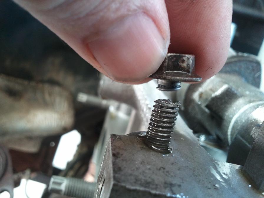

Well, after spending lots of time cleaning my valve cover, then the bolts I installed the valve cover... or tried too at least until this happened.
I told you my stupid torque wrench was tweaky! It was set to 15 ft. lbs.!!
ARRG
You can see from the pic there was oil on the bolt... but the bolts were all dry and crusty looking... even after I cleaned them I put a little oil on the bolts.
Also I remember that when I found the valve cover 1/2 the bolts were only finger tight and the others weren't much tighter... it's possible the bolts were already stretched and weak which was partly why they had gotten so loose.
So, I think it could be that:
a. torque wrench crapped on me.
b. oil slicked it too much reducing friction so that 15 ft. lbs could not be reached before bolt failure.
c. the bolts were already stretched and weak and failed before 15 ft. lbs.
d. b and c
e. all of the above.
anyways I think the bolts were already weak... cuz I was super careful and light with the torque wrench.. I kept thinking, "Where the heck is the click" I was only turning the torque wrench with 1 finger... but I had to keep turning it because there was no increase in resistance. I know there was a lot of play because the rubber washers and gasket... I kept switching back to a regular wrench to make sure it wasn't crazy tight... but I kept turning and the resistance would not increase..
I kept going slow, then BAM! broken bolt.
moreover I was able to back the broken bolt out with a set of plyers and I didn't even have to use my kung fu grip.
Well... I guess at this point I'll wipe off the bolts and put them in dry and get a replacement for the broken bolt
EDIT: interesting... the toyota service bolt the same size and thread as the valve cover bolt... Woo hoo!!!

I would look into another torque wrench. I would get a 0-100ft/lb personally if you only have one. Not much need for more then that for most car needs. And if you need more it is usually just a matter of cranking it as hard as you can lol.
Lucky for you that is a simple fix but if you get a new wrench, get it now and recheck the cam caps.

This is killing me... I'm scared spitless I'm gonna shear off another bolt.
I went and bought a new torque wrench... I even set it to 12 then to 10lbs... but those damn bolts won't get tight enough... I keep going slowly.. been doing this for over and hour... every turn feel's like it gonna break...
the washers with the rubber under them are all bent and deformed... just to get to 10 lbs.
The Toyota FSM doesn't even mention torque specs for these... the haynes said 15... I'm not even to 10 and I feel like they are going to sheer off...

I finally called my local Toyota Dealership and they told me that 15 lbs is the correct torque for valve cover bolts on this model truck/engine. 15 lbs IS NOT THE CORRECT TORQUE AMOUNT!!!! I had two bolt heads shear off and had to drill out the bolts.
The gasket kit comes with new metal cup covered rubber grommets for each bolt. When you are tightening the bolts, as soon as you observe the metal grommet tops begin to flex the slightest bit you have the bolts tight enough. If it feels to you like the bolt is tight enough before that then stop! It probably is tight enough and if not you'll see a little oil leak after a test drive and can tighten it a little more.
That is a hell of a lot more fun than spending and hour and a half drilling out broken bolt ends.

On the valve cover bolts there is no need for an exact torque. I just do them by feel personally.
If you get an oil leak go back and tighten them down a little more.
Also as the gasket crushes they will keep going and going which is what you are feeling.

The valve cover bolts/nuts/grommets/whatever don't need anywhere near 10lbs. 3-5lbs is more like it, but you would really need an inch-pound wrench to hit a low value like that. Really, precision is not important here anyway.
You could probably get them about right by just twisting the wrench extension with your hand.
