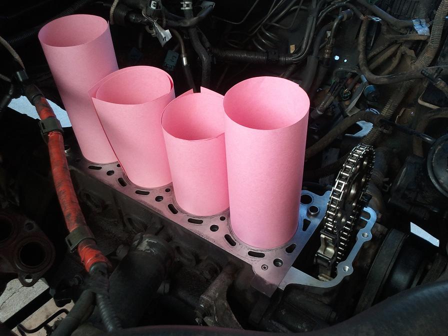

I'm pretty much done cleaning my block but I'm really concerned at this point. I used 1.5 cans of CRC brake cleaner and the 3M scotchbright pads seen below
The head is really pretty rough at cylinder 1 and not quite as bad at cylinder 2. I'd get it machined.. but I'm NOT gonna remove the engine... so we can just rule that out right now.
but should I use the copper spary adhesive or put "the right stuff" over the rough parts of the block to help the gasket seal... or will putting the seal on dry be enough?
Please look at the detailed pics and advise
overview of block
Cylinder 1 overview
Cylinder 1 zoom
Cylinder 2 overview
Cylinder 2 zoom
Also.. I realized that I scuffed the inside of cylinder 2 a lil bit with the scotch bright pad when cleaning.. DOH!!! I don't think it's that bad, what do you guys think?
EDIT: now that I think about it.. the guy at the machine shop showed the the bottom cylinder head at cylinder 1 and said there was some burn or leak through or something like that at cylinder 1 that was likely THE CAUSE of the burnt valve in the first place... he explained this to me to tell me why I need the cylinder head resurfaced... so I guess these are just pics of the other half of that problem.
please advise... I'm at a stand still at this point... not sure what to do.

Getting it machined is what should happen. If that is not an option then you can try the copper spray and hope it holds.
See this is why I just replace the whole engine, you don't have to worry about all these nickle and dime problems that come up.

So... how should I cover up the cylinders before spraying... should I just stuff rags in the cylinder??? also, do I need to cover up the cooling channels as well?
..and then after I spray... I should still put some of "the right stuff" in the 2 front corners by the timing chain?
EDIT: Is this crap luck or what.. the machinist told me it's VERY rare that the block would need to be machined too cuz it's cast iron steel not aluminum. Would you say this is rare... or relatively common for an engine block with 165K

It is not common, don't see that much pitting very other. Usually just surface pitting that would not effect the seal of the gasket.
geez... that just seems typical for me of late... can't waste time about it though.
Do I need to cover up the cooling channels before spraying this stuff?

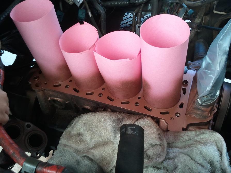

Well... I don't think the spray will mess up anything too bad as long as I have the cylinders covered... here's what I did...
now I'm gonna spray two coats on the block and gasket... put a dab of the right stuff where the FSM says to then put the head on.
Attached Thumbnails Compression shot in 1 cylinder - Burned Valve? HELP-2012-12-30-14.13.08.jpg   Compression shot in 1 cylinder - Burned Valve? HELP-2012-12-30-14.53.21.jpg

Permatex Spray a Gasket says to spray both sides of gasket per TDS. It says:
DIRECTIONS FOR USE
1. Provide adequate ventilation.
2. Surfaces should be free of oil, dirt and grease.
3. Mask areas that should not be coated.
4. Shake can with ball agitator for one minute. For best results, aerosol can should be at room temperature before spraying.
5. Holding can 8 to 10 inches from the surface to be coated, press the nozzle and discharge the product uniformly. Apply to both sides of gasket. Avoid overspray. DO NOT SPRAY into engine compartment.
Allow solvent to evaporate before assembly.
http://www.permatex.com/products/pro...sealant-detail
