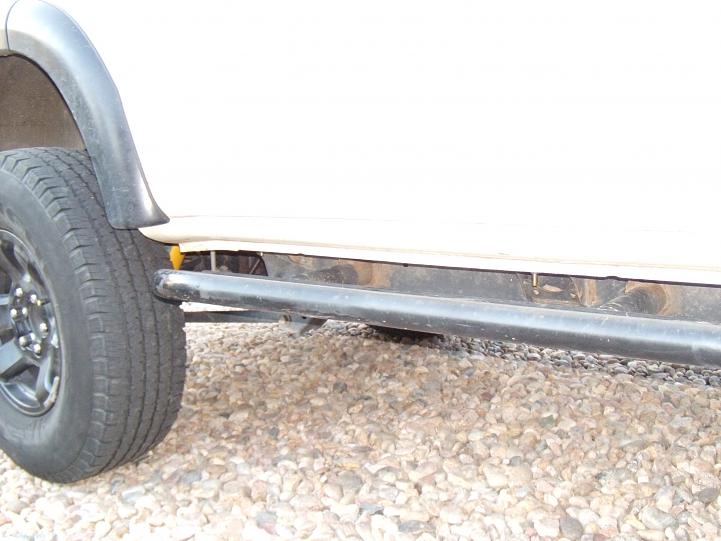

My extra inch now installed on the 99 Runner....
my body lift now complete and learned a lot along the way. I had my buddy Slava of Quality Auto (formerly with Irbis) install it.
Here is a shot straight on showing the gap of the ARB bumper. No I really don't think I will move the bumper for now...
second shot shows clearance of the sliders-this is why folks say to get the lift first then the sliders. Lots of room now to work around under there.
I had also ordered the poly bushings for the body mounts but discovered my Runner was equipped with a strange variation of the mounts-so the bushings did not match up. Just went with the 1" body lift instead .
A small hiccup we encountered was clearance for the 5 speed manual tranny. The even gears (2 and 4) did not want to engage properly. I had to open up the center console and remove the shifter knobs to get at the lower rubber boots. I removed the 4 sheet metal screws that hold the metal bezel piece in place against the body.
This was covered in 4crawler.com instructions under "Shifter Modifications" and Roger Brown himself answered every question I had almost in real time online. Very glad I did this lift and even more glad I did not attempt to install it myself.

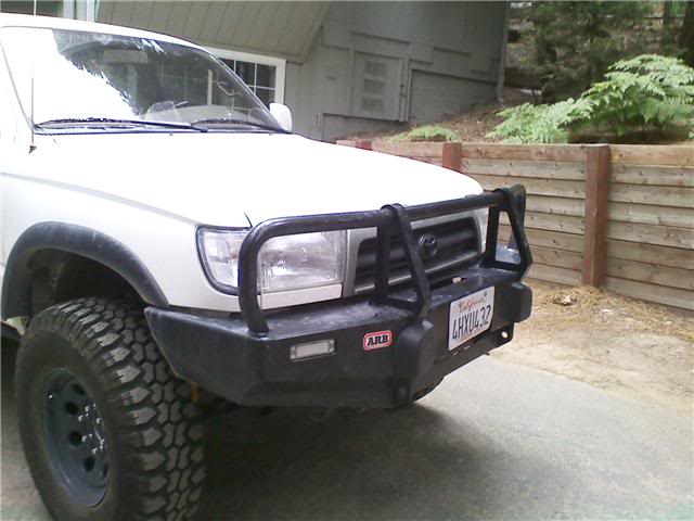

Drill new holes in the bumper for a 1". Here's mine: (I've yanked Jeeps out with it like that too and it's solid as hell)

thanks camo but I can't take any credit for the install itself-I just whipped out the wallet
yah mine is an inch but the blocks measure more like 1.25 when you first get them. Honestly I am inclined to leave as is -it gives the body more room to not get pinched up when off roading for example. Brian has the correct solution however.
