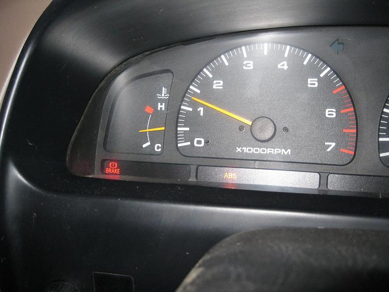

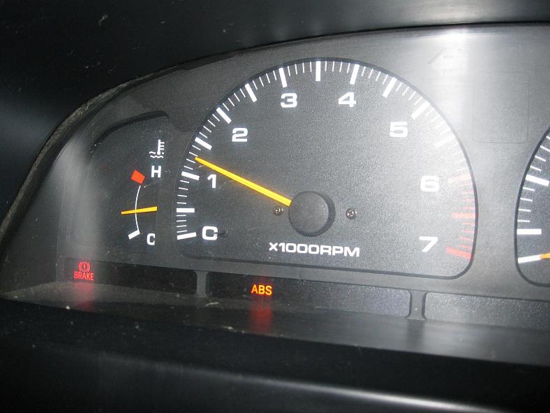

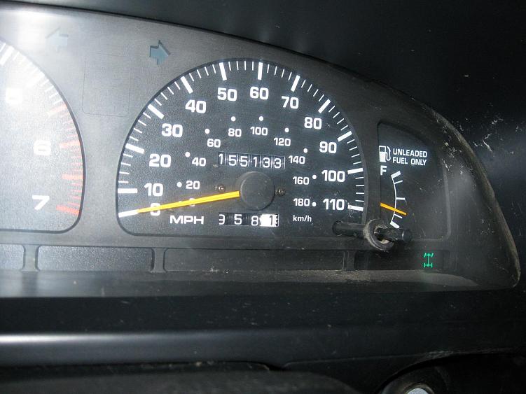

Hello In the middle of resurrecting a 97 4runner (check out my build thread for more info). Anywho, there are a couple lights illuminated on the dash. Obviously the brake light, I believe it has a brake line leak somewhere around the back axle, and the parking brake is seized up in the “off” position, I can’t budge the lever. The green little drivetrain is lit up. Is that to show you its in 4X4? I have the lever next to the gear selector in high, and I see the little 4X4 button, but when I click it nothing happens. The button physically is in the out position which I am guessing is 4WD off. I put in a spare battery but today I went to start it and all it did was click the starter. The battery is good. So I am guessing it has a parasitic drain somewhere. Is there a common place? When I got it started I also had the ABS light on, but after leaving it on the trickle and restarting that light has gone out. Also the radio doesn’t work, when I turn the headlights and dash lights on they all come on except for the radio lights too. The interior map and dome lights don’t work also. I am pretty sure I checked the fuses good but I will replace anyway. It also likes to idle high as in the one pic with the brake light. Please let me know on what you think. Thank you for your help!!

The brake light is the e-brake light, it just means that either the e-bake is pulled or something is grounding the switch inside the console, the drivetrain light is the 4x4 light and it won't turn off until you drive the runner so that it cycle the hubs and disengage.

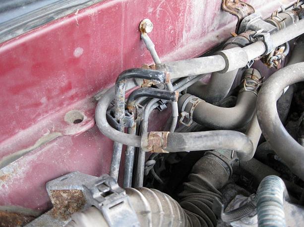

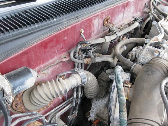

Ok, got a ton of things sorted out last night. First the dome light fuse was blown, so now interior lights and radio work however the power antenna doesn’t. Going to do whip mod eventually. The clock also doesn’t work. The green light came off and it does go into and out of 4wd with a little clunk. Has a brake line leak for sure in the rear. The key stuck in ignition had something to do with the shift lock solenoids by the shifter took all them out, cleaned terminals and reinstalled and now it locks the shifter correctly. So now the key come out of the ignition with ease! And since the key was stuck in the ignition the car was stuck in accsy. So that’s why the battery was being drained. So new question, I took a pic of these to nipple under the hood. On other 4runners I see they are attached to the hose that seems to be looped on mine. Why is this? Should I un loop them and reconnect to the nipples? They seem to circulate throught the heater hose? Thanks!

Those are for the rear heater, the heater core for the rear is located under the front passenger's seat.

So that means someone undid these.... Maybe because they were leaking? I really dont need the rear heat, how well will it heat without it? But if it works might as well hook it up.
