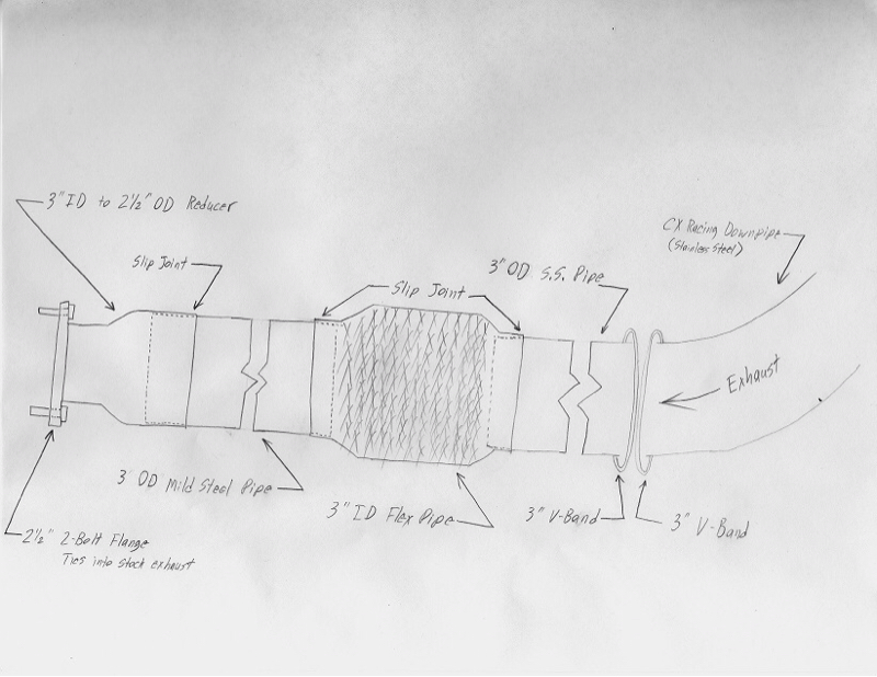

That same guy is also on Tacoma World, his build thread there is a bit more detailed.
You will most likely have to fabricate a piece after the down pipe to connect the rest of your stock exhaust. Here's a sketch I drew up a few months ago with how I plan to make it happen.
Attachment 101770
Very possible, not on there myself.
Yes, you will have to fab some pipe at the end of the downpipe but this is not hard any any good exhaust shop should be able to do it. Although personally I would just build a new exhaust while in there with 3" piping to improve flow and performance.

Don't forget that you'll also need a flange for the downstream O2 sensor. With adding this section of pipe, you'll also be taking out the stock piece that has that sensor flange.
Thats a piece of cake, not worth worrying about. Any good exhaust shop will fix you right up.
Although if you have a non-cali truck I bet the stock O2 Sensor would work just fine. but have not seen the pictures to know for sure.
Either way I would have a new exhaust made for these reasons, that way everything can be done over. Shops build exhaust systems from scratch all the time, O2 flanges are simple.
I had one built for my 300zx some time back, took them like 30 mins to go from the turbo outlet to rear bumper, all custom with muffler, hangers, O2 sensor and all that jazz. Think it only costs me around $200 as well. Given it was not a high performance exhaust at only 2.5" but that all it needed.

Thats a piece of cake, not worth worrying about. Any good exhaust shop will fix you right up. Although if you have a non-cali truck I bet the stock O2 Sensor would work just fine. but have not seen the pictures to know for sure. Either way I would have a new exhaust made for these reasons, that way everything can be done over. Shops build exhaust systems from scratch all the time, O2 flanges are simple. I had one built for my 300zx some time back, took them like 30 mins to go from the turbo outlet to rear bumper, all custom with muffler, hangers, O2 sensor and all that jazz. Think it only costs me around $200 as well. Given it was not a high performance exhaust at only 2.5" but that all it needed.
Just pointing out that you'll likely need to find the flange beforehand. I forget where I got mine, but it's not that common of a flange that Toyota uses so your typical exhaust shop won't have it laying around. Of course you could just cut out the old flange from the stock pipe and reuse it. Or omit your downstream O2 completely.
While it is a pretty standard narrow-band O2 sensor flange, you are correct it is best to buy your own and bring it to the exhaust shop. If nothing else it will be cheaper.
Same goes for any wideband bungs or v-band connections.
