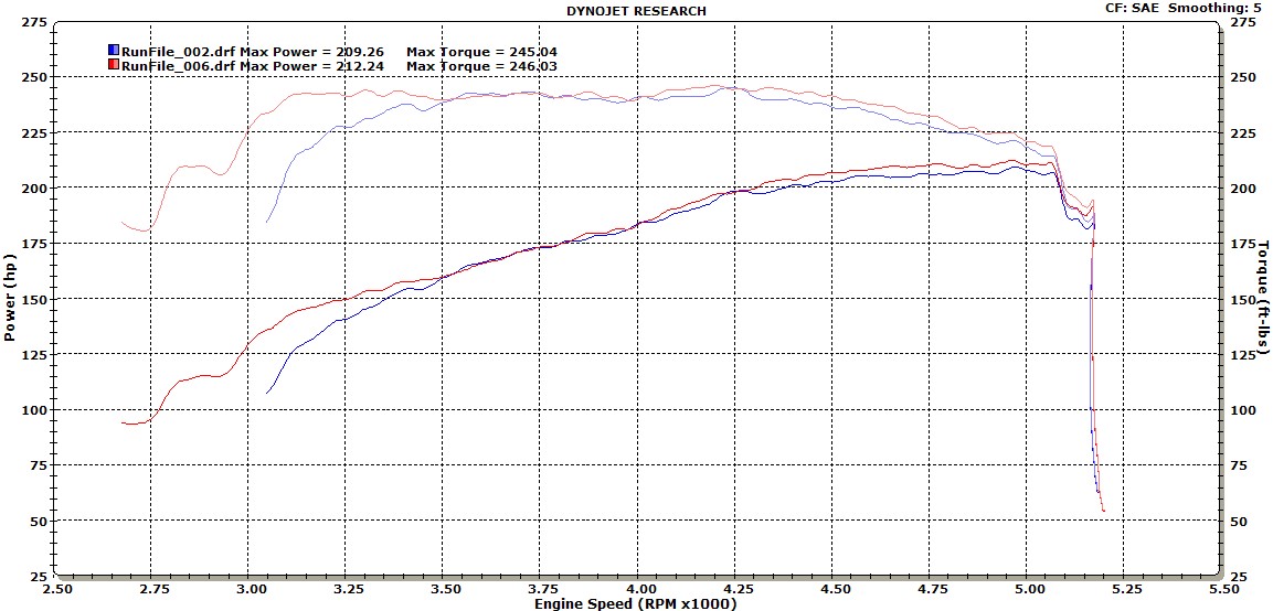

Well here it is. I have the headers on and I am happy with them. The sound at low rpms is nice and I definitely can notice a difference in throttle response, power, and the engine likes high rpms more. I went back to the same dyno and had it done in the same manner. Somehow I don't think that I got any very good runs with the headers. Anyways, here are the two first runs of the three from each day before and after. Run 002 is with manifolds and 006 is with headers. Obviously I was hoping for better #s with the headers, but I don't think this chart reflects as much difference as I can feel. Maybe the auto tranny is screwing the test up a bit, or maybe thats about it for extra power. Just for peace of mind I may try a different dyno and see what I get.

Little lower then I expected but not much. I would have expected 10-15hp. Differnt weather conditions and the amount of heat soak can play a big role in power as well.
I would not worry about a different dyno. Dynojets are the only consistent dynos out there. They read what they read and that is that.
More then likely heat soak and/or weather differences are the reason for the numbers being a little lower then I expected. I notice that my truck is very sensitive to the weather and will drastically change how it feels from day to day.
Headers are not a very good bang for the buck mod AT ALL. I don't recommend them unless someone just must throw more money at the truck or has literally done everything else.
Water/Meth injection would give you MUCH bigger gains then that for less $$$.

Yea ive seen what meth can do to this engine. I am happy with mine and dont really want to put any more into it plus I dont know how id tune it. Im gonna get a transgo jr kit installed in the transmission soon. Ive just broken in a new remanufactured one so want to protect it this time plus shift faster/harder.
Maybee im not seeing 10-15 cause I still have stock dual cats?

Cats will hurt it some. Tuning the meth kit is really easy. You tune it with the 7th injector just like you are now. You will simply remove some fuel to keep AFR's correct. No harder then what you are doing now. In a way easier since you have a MUCH larger room for error.
