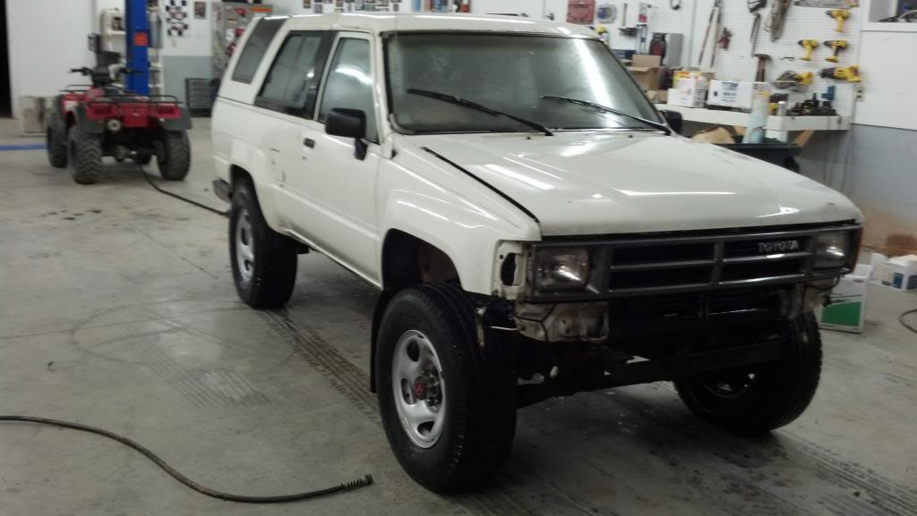

Pulled out of the woods a few months ago and have been busting knuckles on it here and there but here lately iv'e been busting but on it. Body has been sitting in the woods for around around 15 years and the motor has been sitting in it for the last 7 or 8.

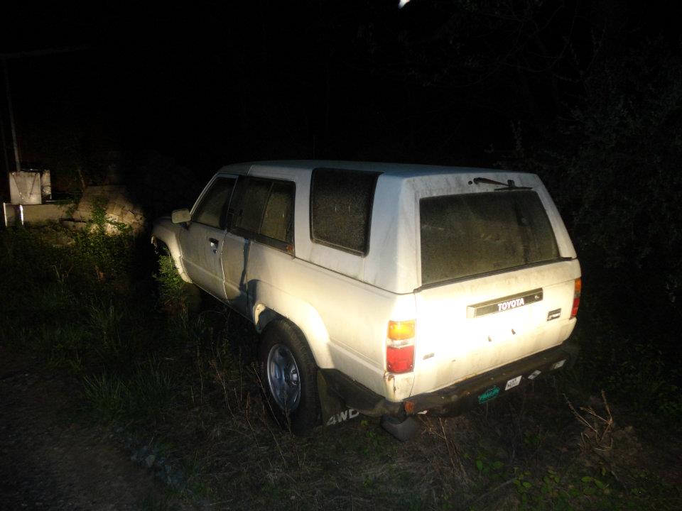

The night i randomly decided i was going to rescue it from its resting place
After a purple power bath:

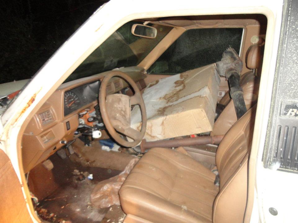

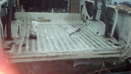

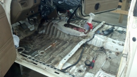

Carpet delete mod, well actually the whole interior since the weather stripping was bad and mother nature had made here way inside. (there was literally an ants nest in this truck)

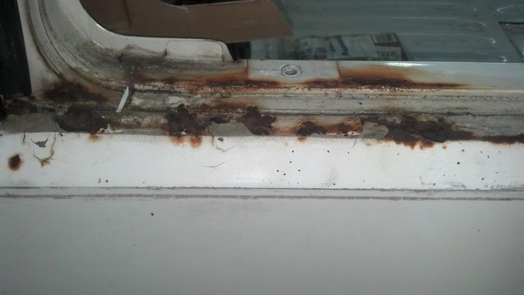

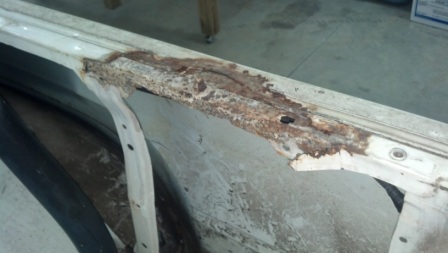

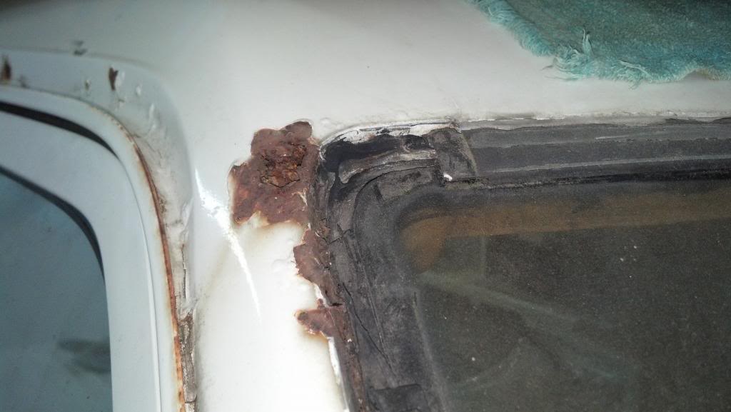

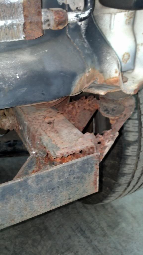

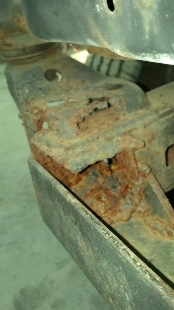

Surprisingly no rust on holes in the floor pan but here's where she has the cancer. My buddy's dad is super good at body work and says he will guide me through it and help out here and there.
I've always wanted to learn how to do body work so i guess i have the perfect project to learn on I guess...
The frame is solid except for the front, i'm not sure what i'm going to do about this since i have no fab skills

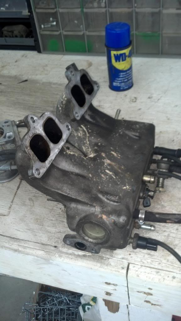

Swapped the ECU, gas tank, and fuel line from my parts truck that was running not long ago (It has a more rust that this truck so don't ask)

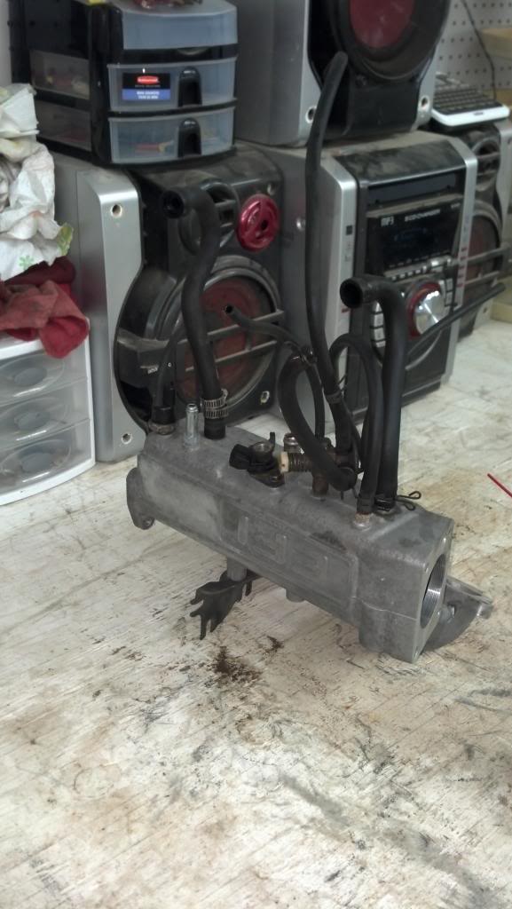

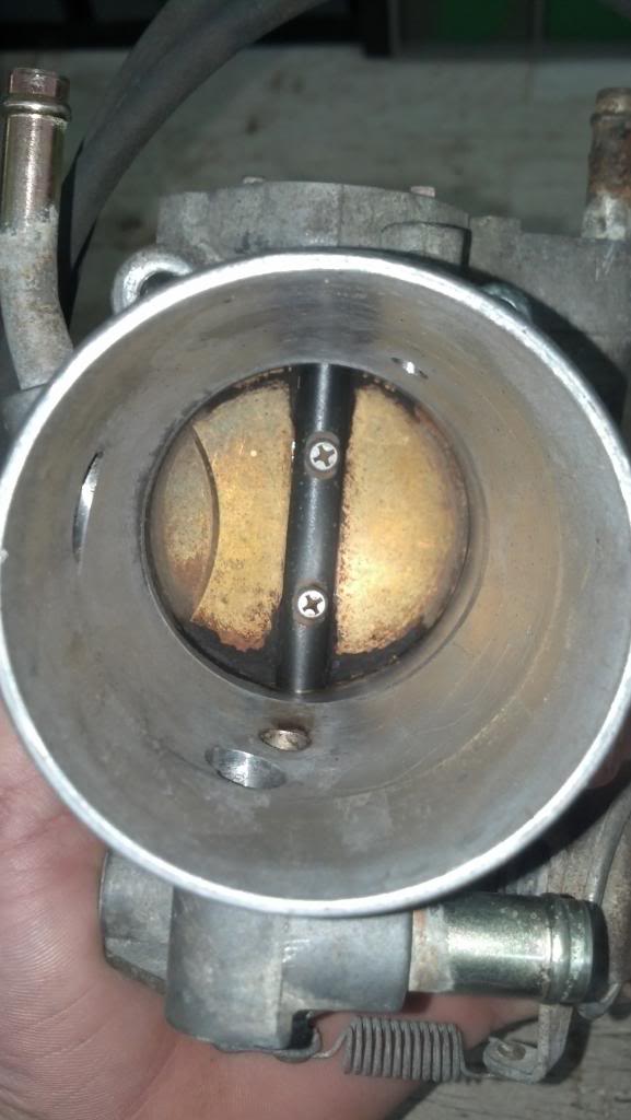

Cleaned up the upper intake that came with the truck, the throttle body, and lower intake from parts truck.
Now in the process of hooking up everything to the motor, check the valve clearances, check the compression, if it's acceptable then set the timing. (is that the right order of things?)
Tomorrow i'll start plugging in the wiring harness and all that fun stuff

I know you have direct access to a body guy already but here is some second opinions and stuff.
Your passenger side front body mount looks salvagable, just clean off the rust and treat it. The drivers side is borderline unsafe, if you can't salvage the mounts from the parts truck you can use some plate to firm it up.
The cap support, quarter panel upper, It's had to say from the pictures but hopefully that is just surface rust. I'd tackle that second. Do the tailgate area first since it's pretty much straight it'll be a good warm up and you'll be familar with the sheet metal break when you do the quarter panel. The A-pillar, window mounts should be lots of fun, if you have someone do this for you pay close attention and ask lots of questions it'll be a gold mine of a learning experience.
I really like how you arranged those rust pictures, "Oh thats not to bad.. Ew.. Oh thats gonna be fun.. Ouch.. HOLY CRAP!"

...Carpet delete mod...
I applied sound-deadener on my floor, and my carpet is still in good condition so I put it back.
Just an idea that you might consider ... if my carpet needed replacement, I would simply strip floor, bedliner it, and instead of re-installing carpet, just use anti-fatigue mat trimmed to shape so they'd be easy to remove- they'll provide good sound and heat-proofing, and if interiro gets flooded or something spills, mats are easily-removed to hose down, and since there's nothing to retain moisture (like carpet) insides will dry quickly and less chances for rusting.

Thanks for the reply, i was planning on just bed linering it and floor mats but your idea sounds much better!
