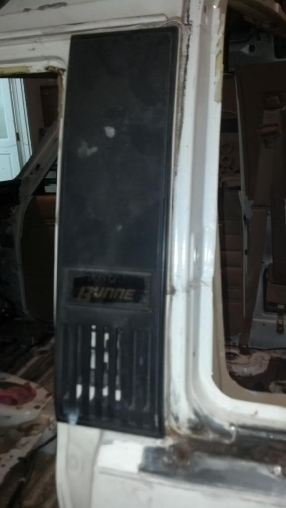

I dont know what this plastic piece is called but i need to get it off to get to all the rust.

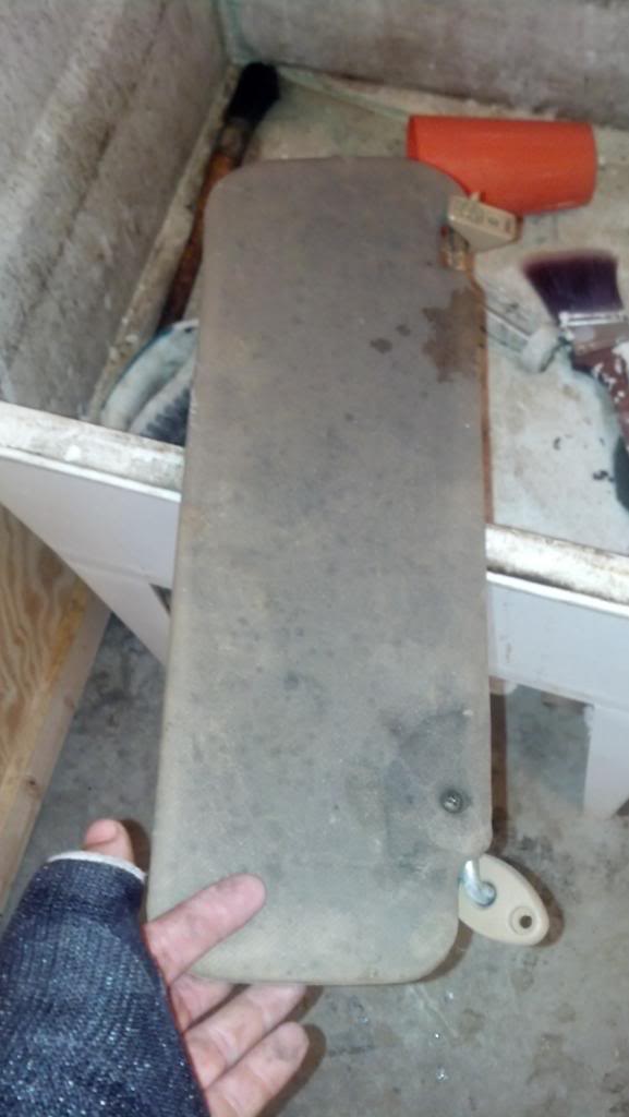

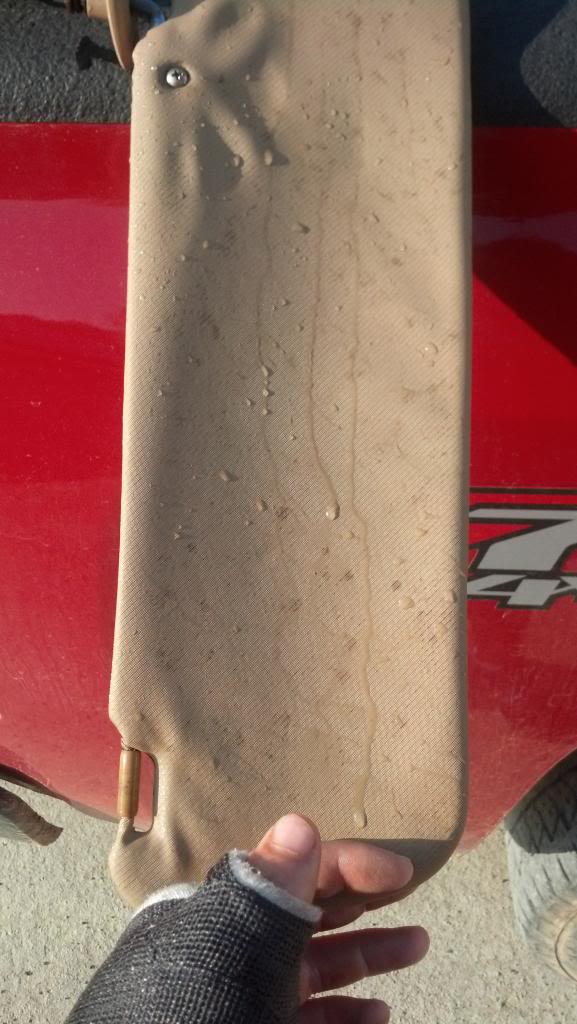

Sun glare blocker flip down things cleaned up with some purple power but i still hated the brown so it got sprayed with the same black thats on the dash. Forgot to take one after i painted it tho.

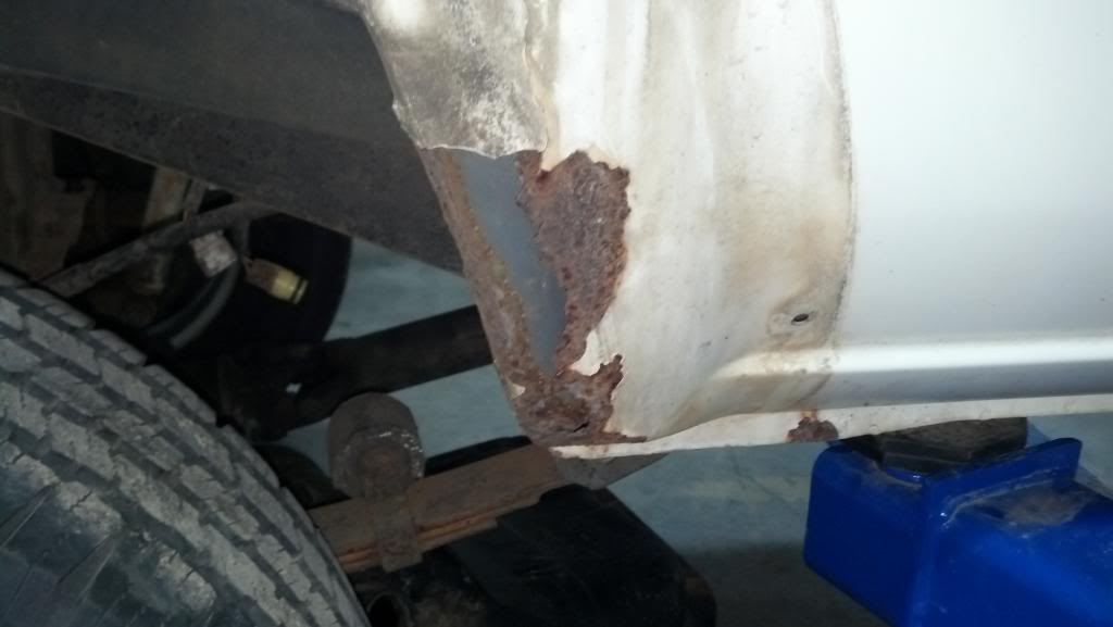

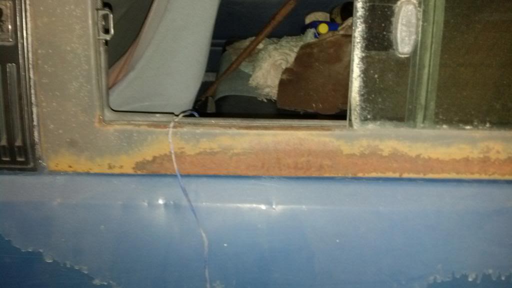

IDK what to do about these back quarters. I'm debating on either fender flares, patch panels or have my buddies dad fab something up. I just want the rust gone and solid metal back in, it doesn't have to be perfect since.
I had the same problem with rust on my drivers side rear fender. Like you, I have little to none body experience. A buddy of mine done the sheet metal work. The pics are in my build thread. After getting done with the rest of the here and there body work and paint, the fenders were the part I was most satisfied with lol.
Old Apr 16, 2013 | 08:22 PM
  #30
Gizler00's Avatar
Joined: Aug 2007
Posts: 3,276
From: Pennsylvania
You could tub it i you wanted. That's what I did. Check out my build thread, I think I have pics of it in there. If not I can send you some. Where are you located? I'll help anyway that I can.

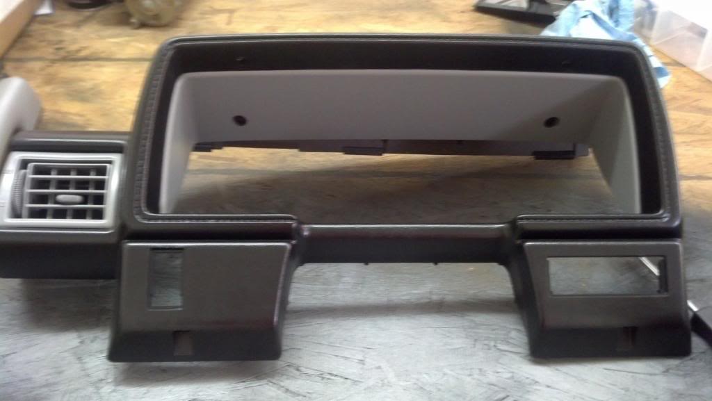

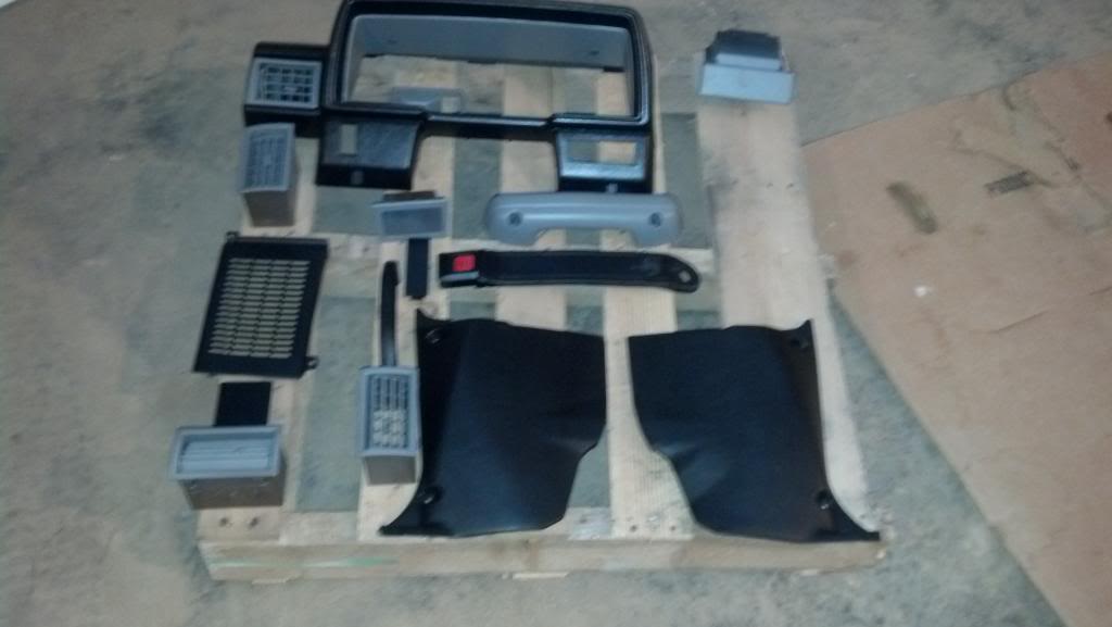

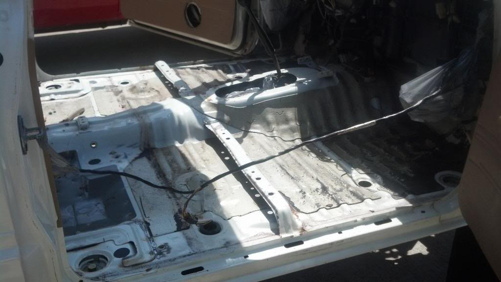

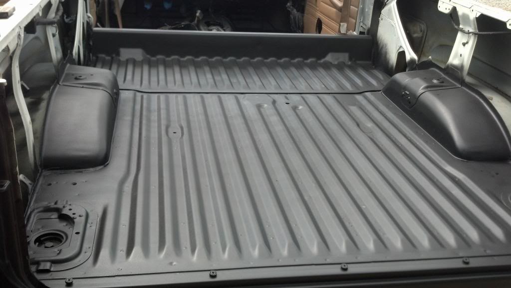

Got the rest of my dash parts painted, rubber trim pieces, floor pans, the bed, and took the doors off the parts truck and got them painted as well. I'll post some pictures. Hopefully i can get the dash back in tomorrow if i can get some help from my buddy.

Before:
After:

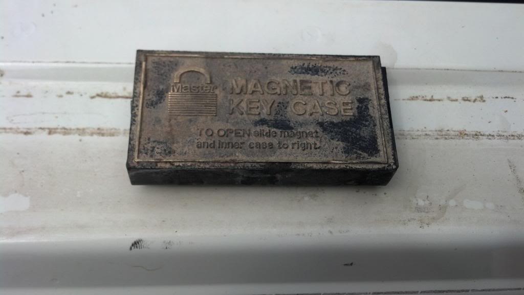

I was up under the truck working some navel jelly on some rust and found this with the key inside! I wonder how long that had been sitting on top of the frame ?

Looks great man!!! Did you remove the factory sound deadening in the wheel wells? That was a killer for me when I did my bedliner on the floor. A water leak worked its wan underneath the bedliner and started to peel it up. Im going to have to redo it at some point. Also the back area looks amazing! I might have missed it somewhere in your thread, bu what did you spray/roll on it.
Old Apr 21, 2013 | 07:05 PM
  #40
yotagoon's Avatar
Joined: Dec 2012
Posts: 59
From: Pittsboro, NC
I used a wire wheel on a drill to get the sticky stuff of the wheel wells. In the front i washed it out and where ever water was getting under the sound deadening stuff i chipped it out. There was rust under it so i had to scrub it with some navel jelly. I used the rustoleum spray. My buddy used it on his jeep and said it worked better than the more expensive stuff. It's like 7 bucks and lowes. I'll get some pictures of the doors tomorrow.
