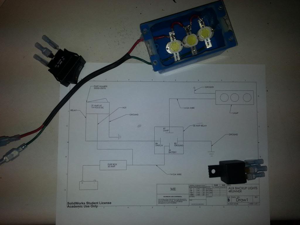

Finally got around to putting in an auxiliary fuse box so I don't have to run everything to the battery.
Got everything wired up for a homemade aux backup light as well
Just have to cut the hole in the rear bumper and mount it in plug it in

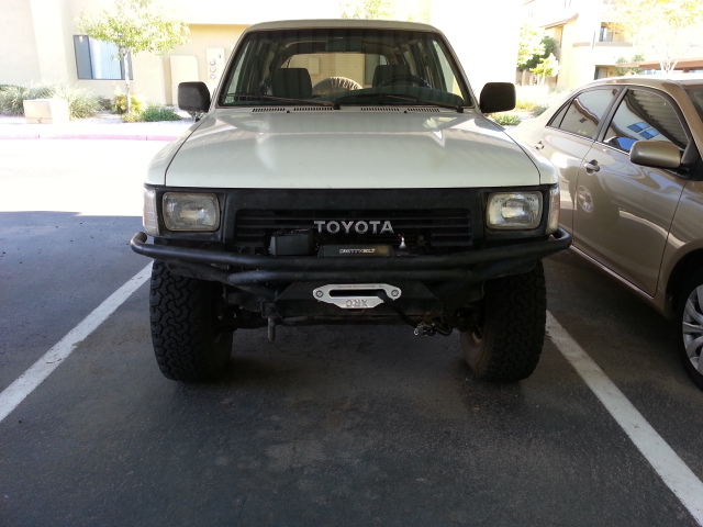

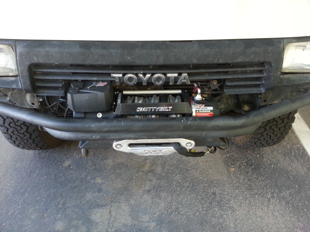

trail gear bumper, winch
So I had been looking into a winch for my trail gear bumper, looked like the smittybilt xrc 9.5 would fit, got it since it came with the hawse fairlead. Took way too long to get it put in. It is a super tight fit and still don't know if it took out my ac or not. I would not recommend that combo to anyone. Had to cut the grill too, and the fairlead needed to be upside down to fit. It was a giant pita.
Heading out today to test it out

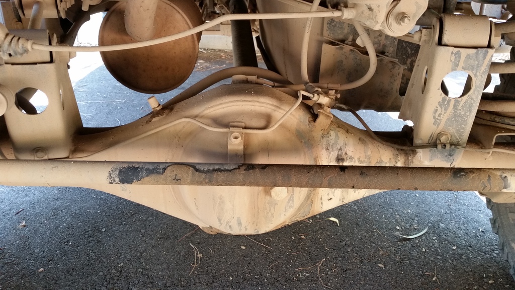

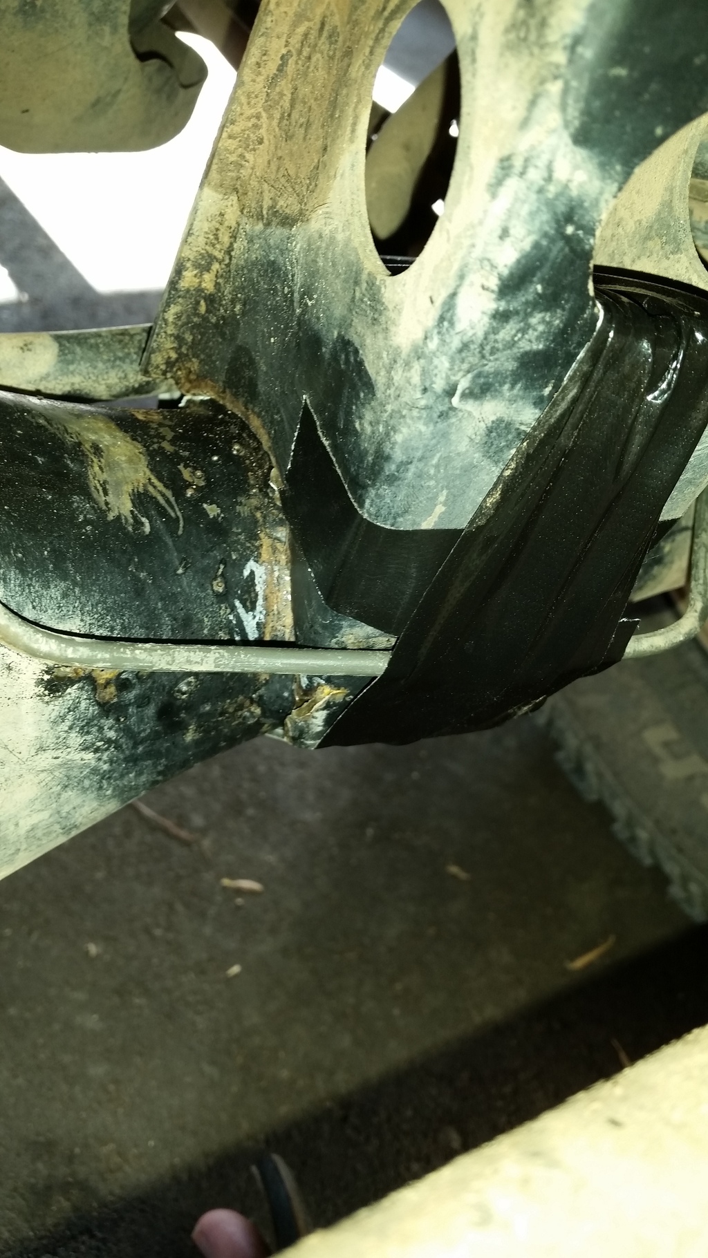

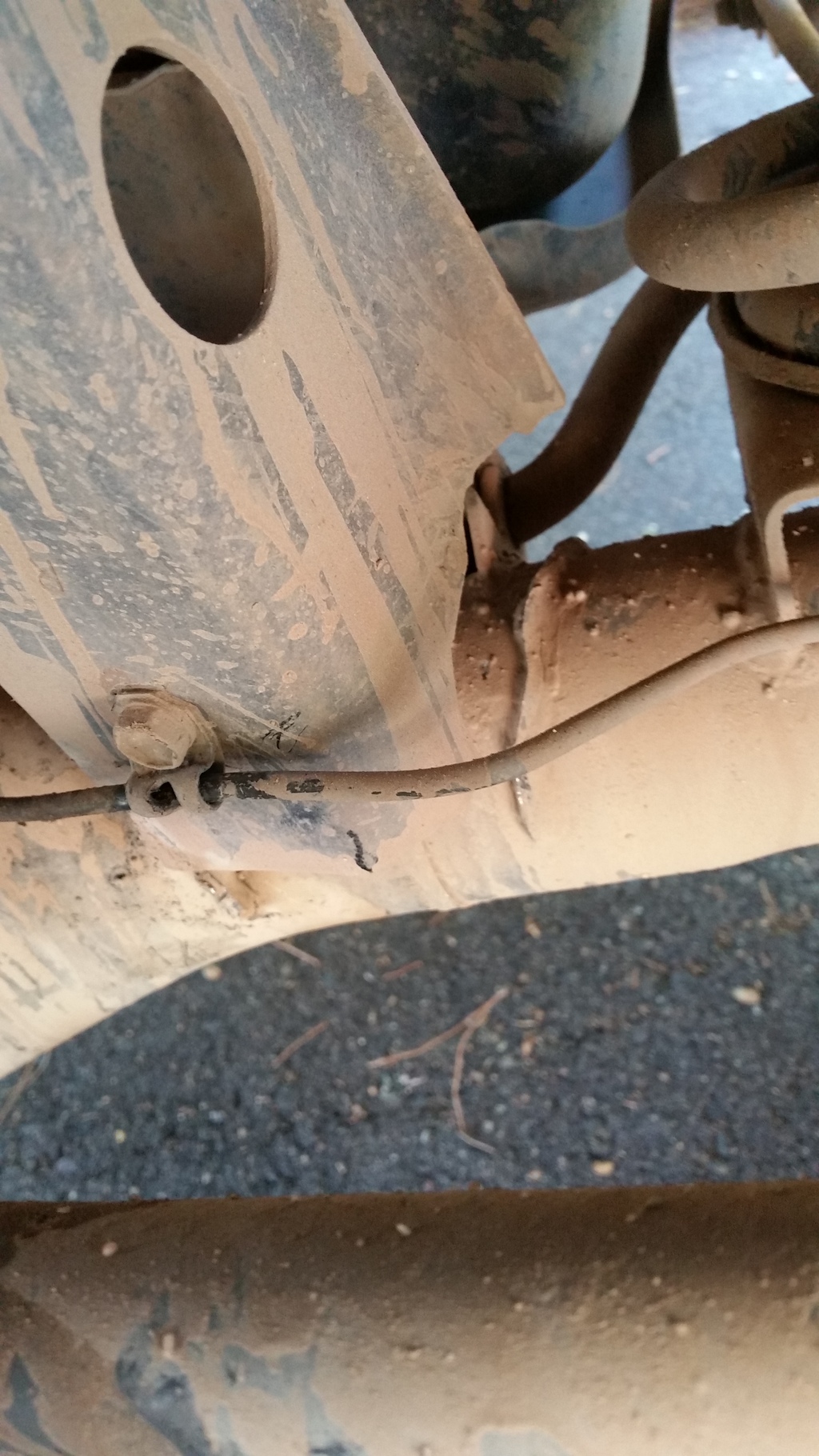

Had my rear upper control arm bracket break off my axle the other day, don't know exactly how it happened, but it did. got it welded back on
probably not doing anything, but felt a little better taping it up until I could get it fixed for real
