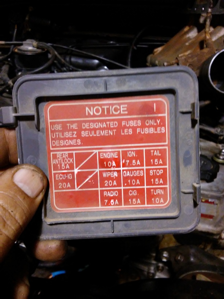

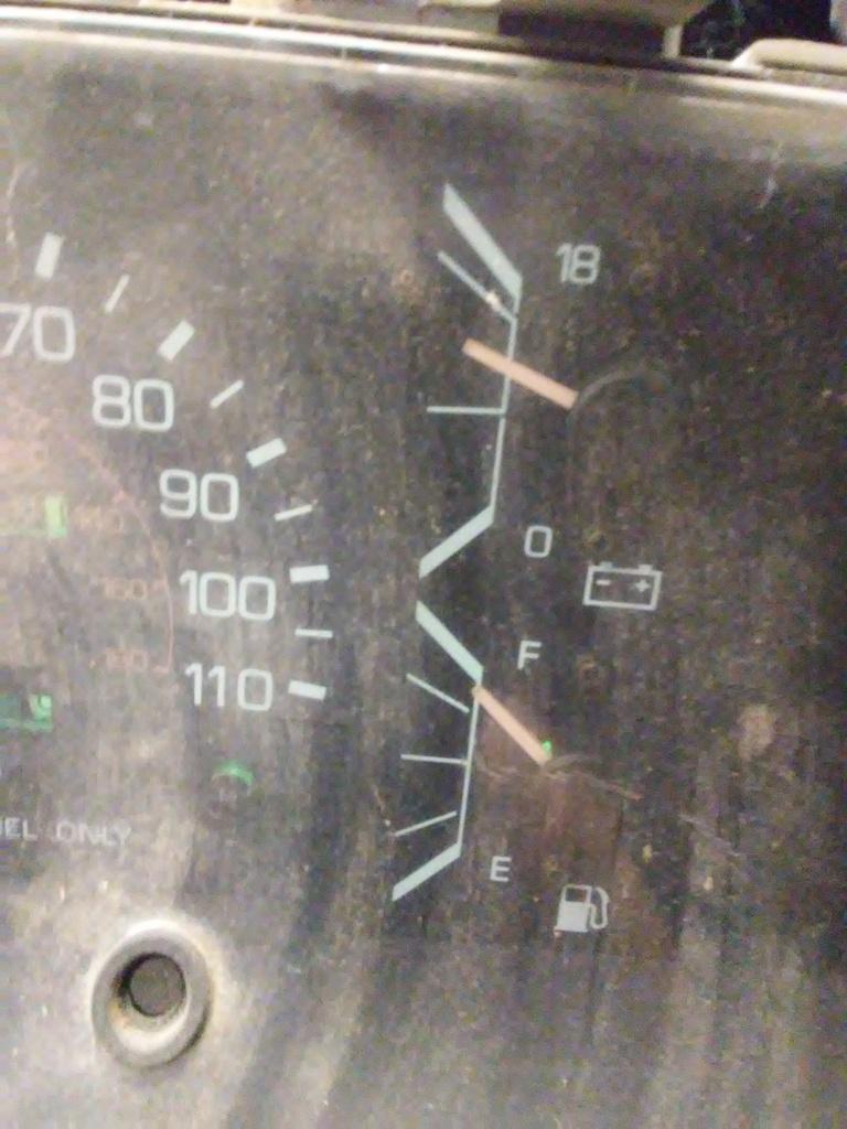

I took it on a shake down run and found a few issues. One the gas gauge was not working. I swapped in another SR5 cluster and that fixed that problem. The other problem was it would jump out of gear in 2nd and 4th. Swapped transmissions and that got that fixed.
Here is a problem I still have not found. At idle it as a rattle like a heat shield is loose. Rev it up and it goes away. Another problem is a whistle or whine. Might be a vacuum leak or a fan clutch. I will pull a belt off one at a time and see if that helps locate the problem.

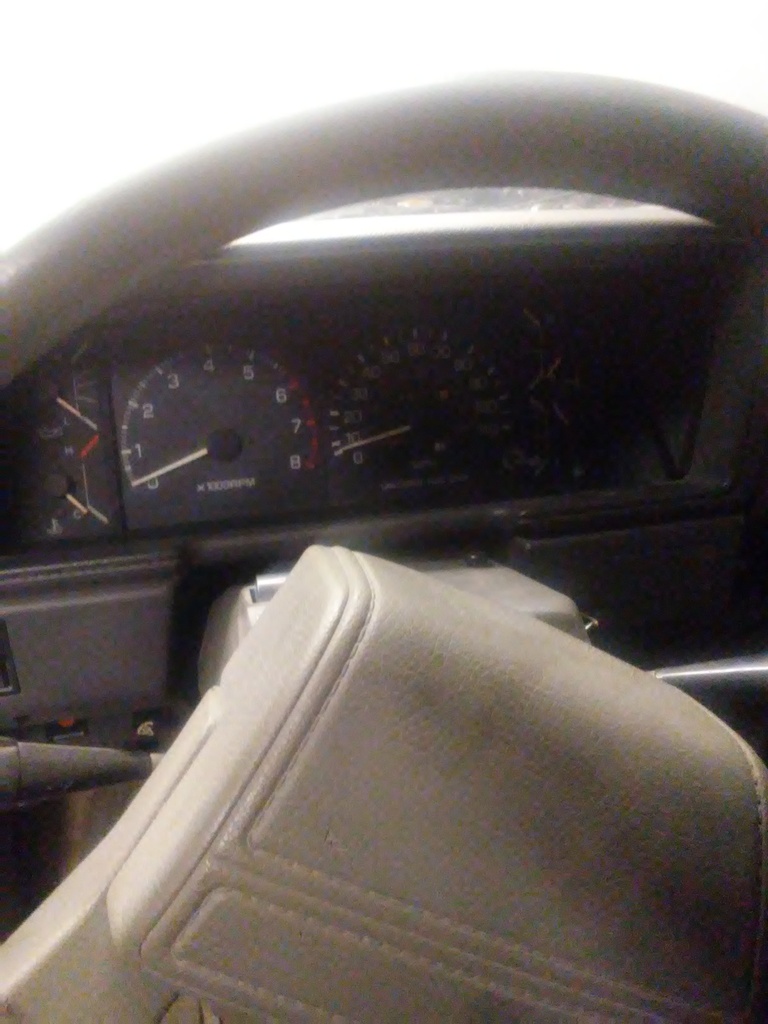

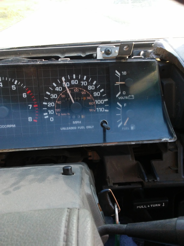

I should of caught the faulty gas gauge in the previous pictures. I took it to the gas station and filled it up to get new gas in the tank but really was hoping the float was stuck or it was just out of fuel. That was not the case. The SR5 gauge swap thread shows how to correct the mileage on them. I have done several but I have also broken a few gauges doing the correct mileage. I suggest not correcting the mileage by removing the needle. I have not tried hooking a gauge up to a drill and it would take a while to do it that way but if I ever decide to correct the mileage, it will be with a drill. These trucks have tons of miles on them anyways.
New cluster fixed the problem. At least I did not have to pull the tank and chase electrical issues. I will go thru and clean the cover and replace some bad bulbs here shortly.

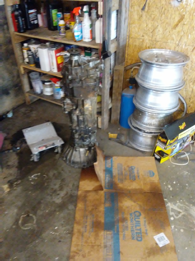

New to me transmission. If there is a way to get transmission oil or brake fluid all over the shop I will find away to do it. Of course it did not leak out when I brought it in to the shop but I walk away and fluid goes every where.

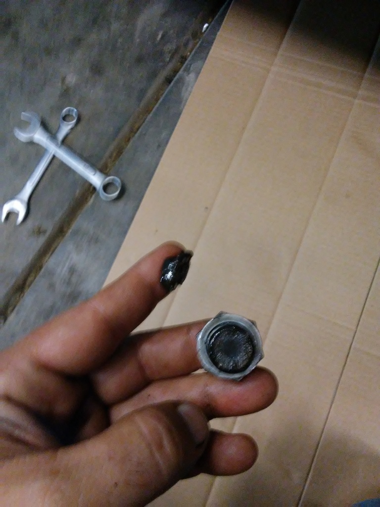

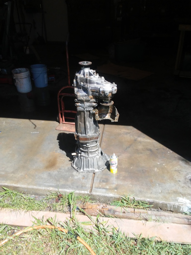

This is the transmission I took out of the red 87. One reason it was probably sent to the salvage is because of it jumping out of gear. Probably 1987 gear oil in it. The sludge that was built up in it was nasty. When putting in a used transmission, I will make sure it is topped off just to see if it is a good transmission, not putting any new oil in to it until I know it is good. Anytime I get a used car or truck, one of the first things I do is to give it a full tune up and change all of the fluids. Most times the transmissions, transfer case, and differentials the fluid is brown and most likely has never been changed.

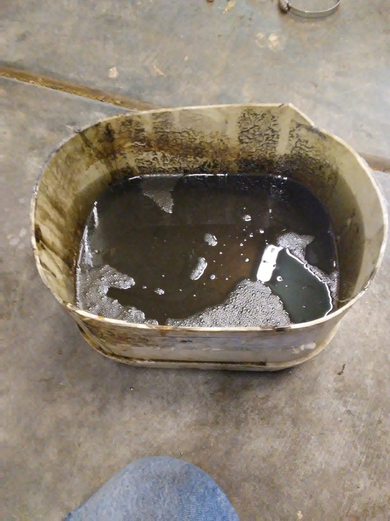

Lovely brown oil that came out of the transmission. If this were a new transmission I would go with synthetic oil but since it has been broken in with conventional oil I will stay with conventional oil.

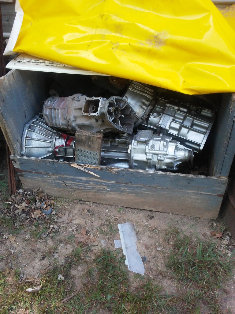

These 4 transmissions are junk. Most of them had bad oil in them when I swapped them out. One is a turbo transmission. One day I might try and learn out to rebuild them, just cant scrap them out as I know how hard they are getting to find. One day I would like to swap the out if Marlin Crawler for a new one. Might be something I would do on the 87 when I get to it.
These three transmissions have the 5th gear whine to them. I will use one just to get one movable but to drive with it whining every day, I will swap one out just for that reason. Also when in 5th gear, I will not lug the motor or transmission or do any heavy towing/pulling in 5th gear just to try and keep the wear and tear off of it. 5th is just for cruising only for me.

This transmission needs the Shifter Bushings replaced. This is a cheap and easy fix that makes a huge difference.
http://www.marlincrawler.com/transmission/parts-upgrade/heavy-duty-shift-lever-ball-seats
http://www.marlincrawler.com/tech/guide/heavy-duty-shifter-seat-installation

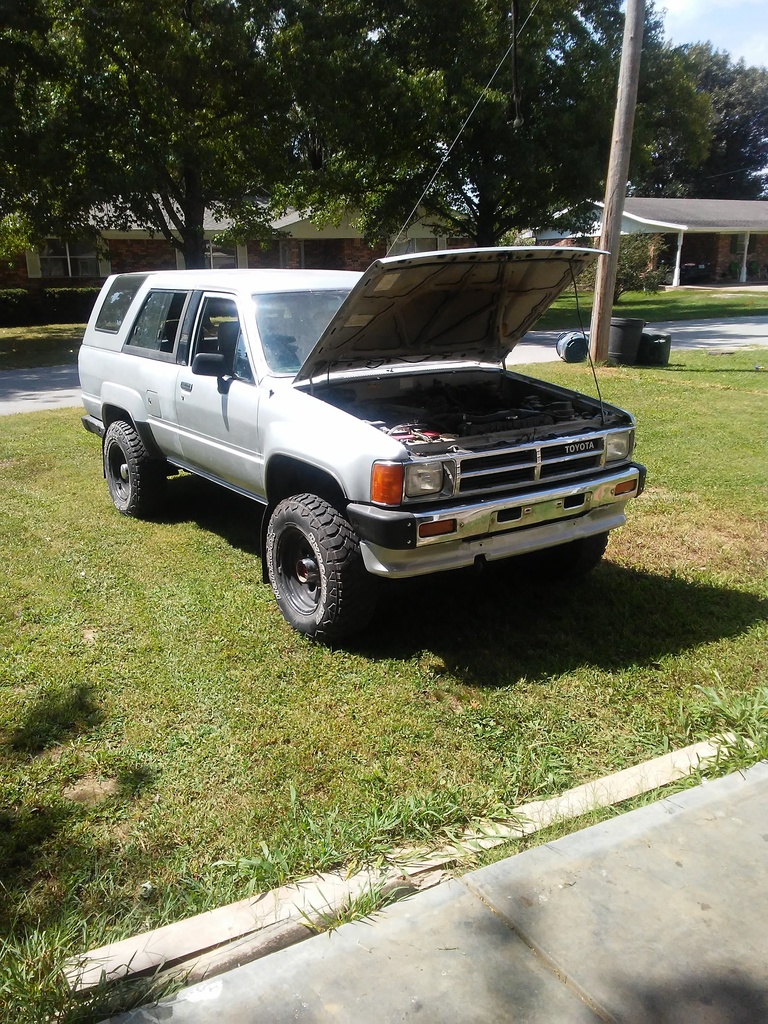

I had a friend with me and we both tried to find a rattle in the engine compartment. It is not a mechanical problem but something loose. Been there since I got here and still have not found it. The power steering and ac pulley adjusters are frozen and will not budge.
I got the new cluster in. I just have not test drove it to see if the speedometer needle works correctly. I still had to add new fluid to the transmission and it was getting hot in the shop. Got the front shaft back in as well. While working on it, I had a guy to walk into the shop wanting to buy one of the 4runners. Sure gets frustrating when they hit you with a low ball offer. He showed me a pickup for $1000 on his smart phone. I showed him the junk transmissions I have and told him that I have worked on enough of these trucks to know that they are just loaded with problems. Suggested that truck would probably be a better buy for him. It would be a big project to get it to where I would want it to be.
Gauge is in.

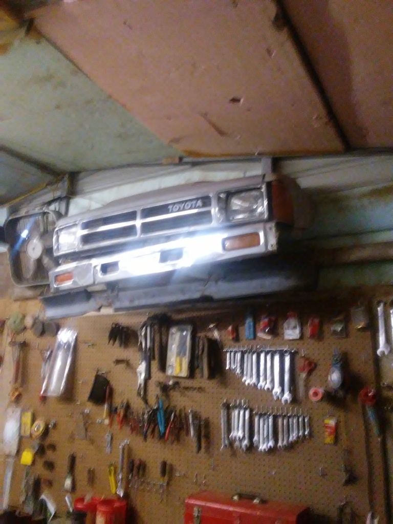

Another on going project I am eventually going to get completed is to get the front end of my wall art is to hide a bench light and maybe get the head lights hooked up to some sort of power to come on when I turn on the shop lights. I added a marker lens and head light for the drivers side. The only good thing on this front end is the grill, everything came off of rusted or wrecked trucks.

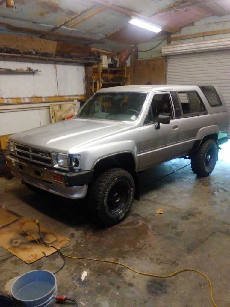

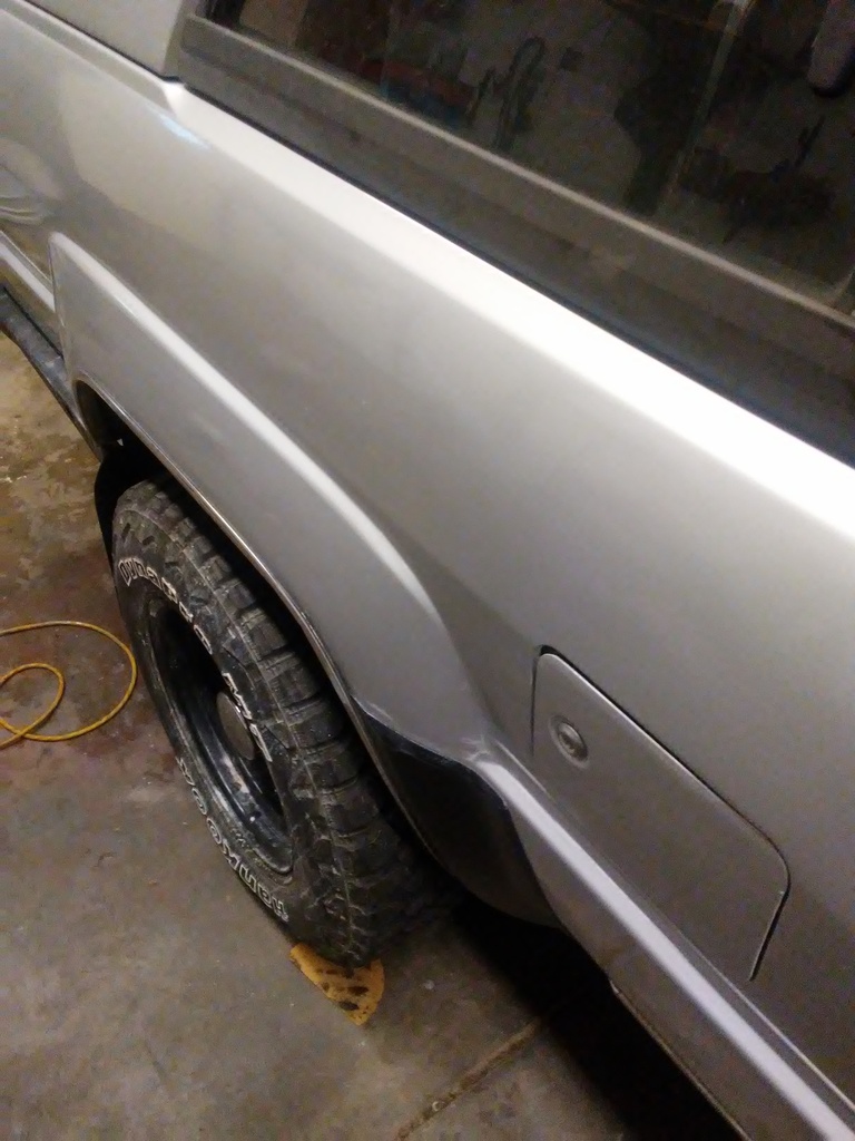

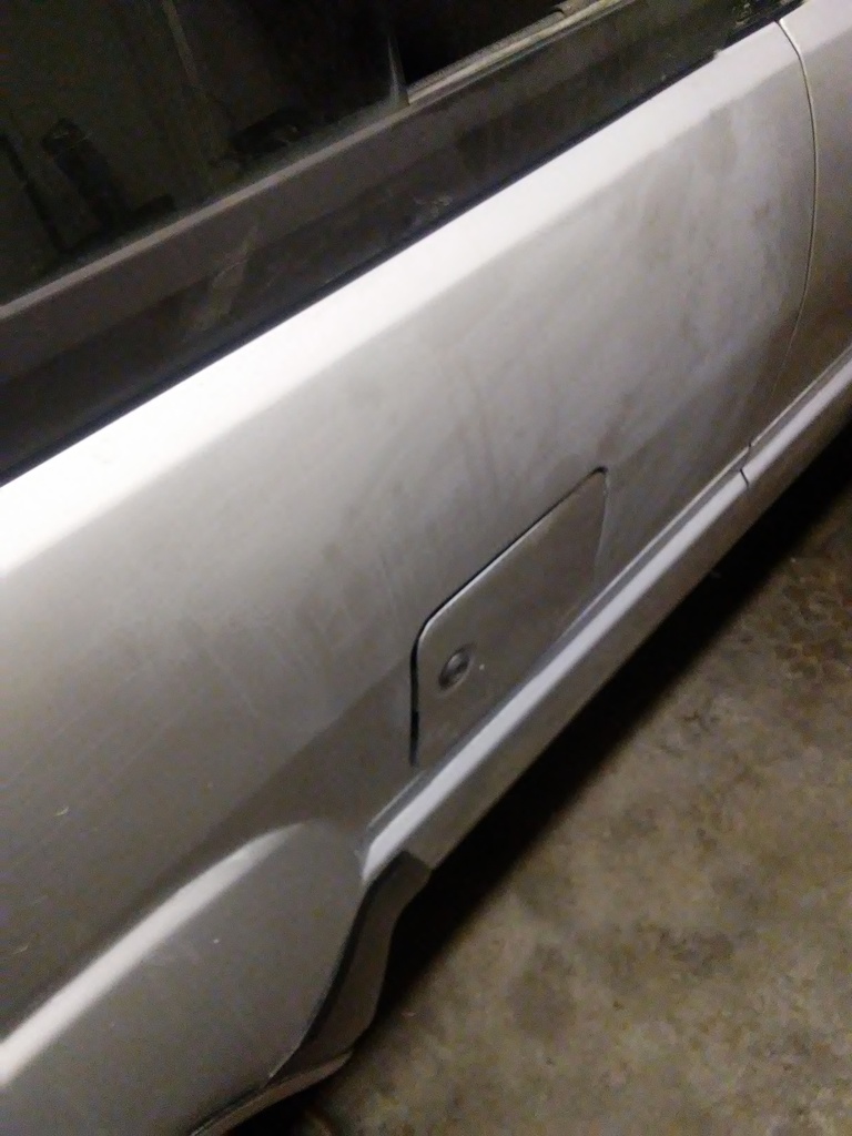

It took two days as I have been slowly wet sanding and polishing out the drivers side and hood getting the orange peel smoothed out.
Not sure if you can see where I worked some orange peel out with sandpaper but here is a before shot.

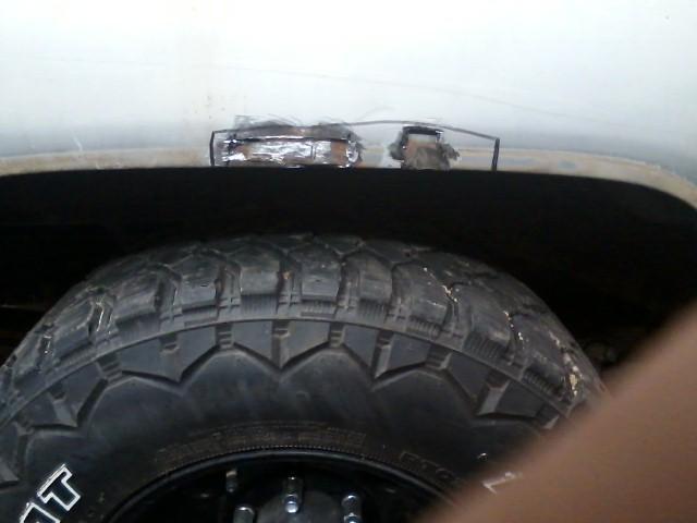

Here is an after shot but wanted to show where I had to send this truck to a body shop and have them to repair a rusted section that was about half an inch wide and 2 inches long. One thing I like about body work is when done correctly, it is rewarding seeing like no damage ever existed.

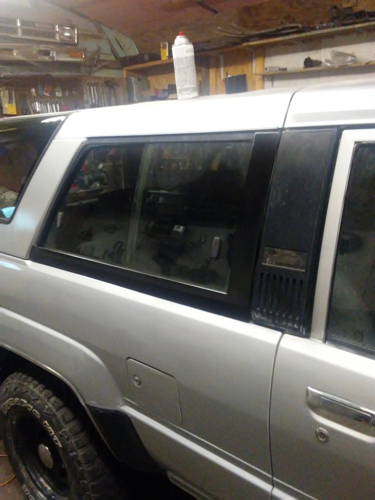

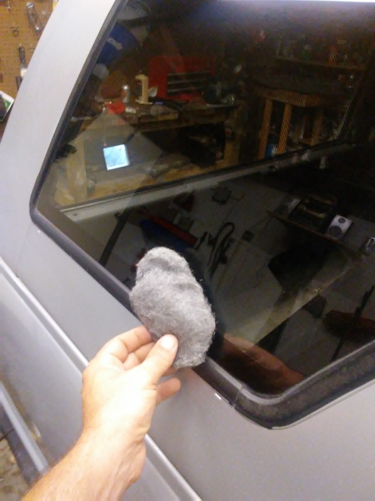

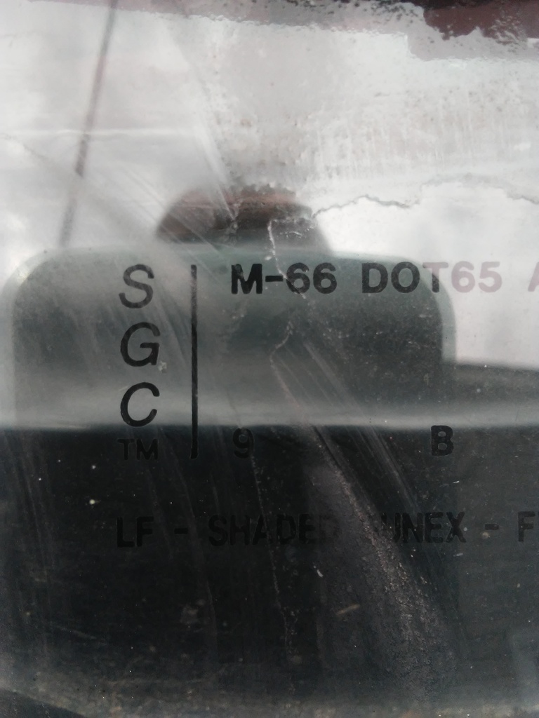

A friend of mine showed me the using "00" steel wool can smooth out some glass and give it a cleaner and smoother look.

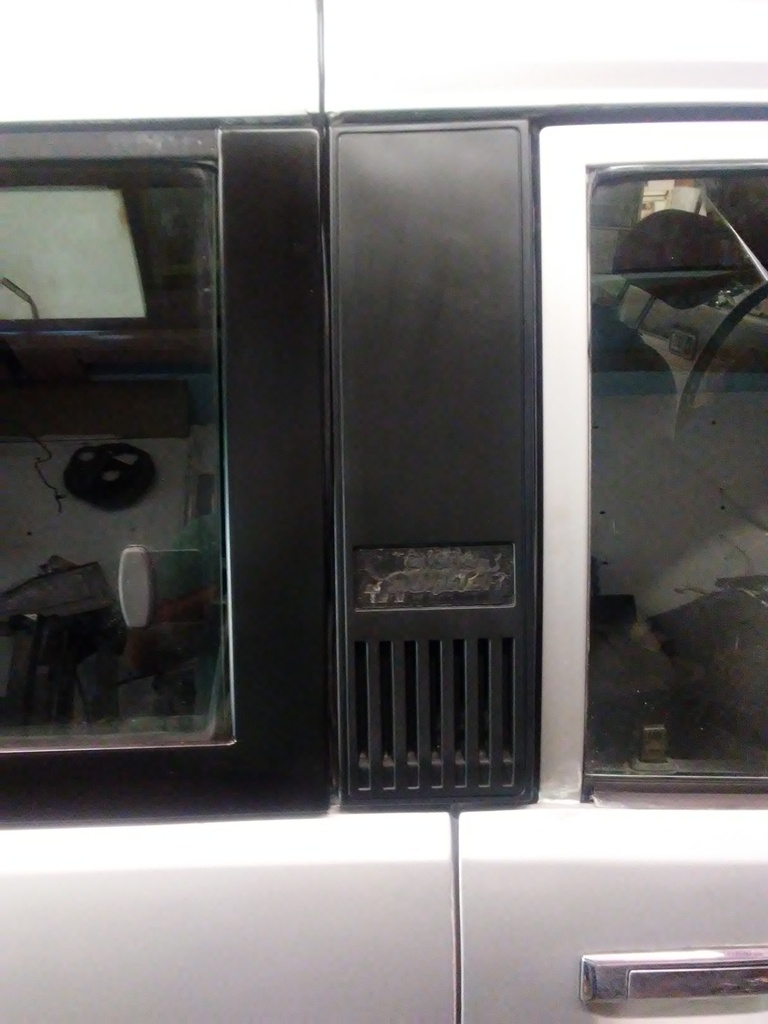

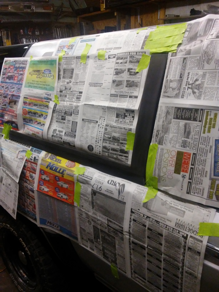

Masked off the "L" trims and got them painted.
Painted and working on other trim.

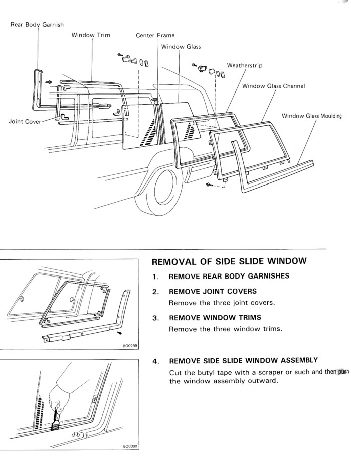

L Trim Removal steps and how I do it when I have to remove them.
To get the L trims off, you have to remove the whole window from the inside. On Passneger Side, I have my feet in the floorboard and knees in the seat, I place my left arm across the top and apply pressure from my elbow to my fist. Applying a little more with my elbow and start breaking the glue tht holds the window in. I try to keep all of the glue on the glass portion. I use a putty knife to help. Once I get the top seperated from the cap. I hook my arm thru the window to keep it from falling to the ground. Once the glass is out, the L trims are just bolted to the window part which will be visble when out.

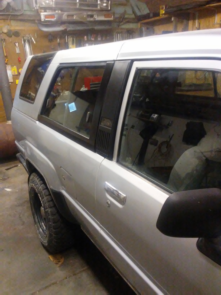

I got the B pillar trim painted. I will need to go back and touch it up as a bug got on it when the paint was wet. Looks better with the trim painted. Still have to work on the badges.
Got both the B pillars trim painted. Will get the badge installed at a later time.

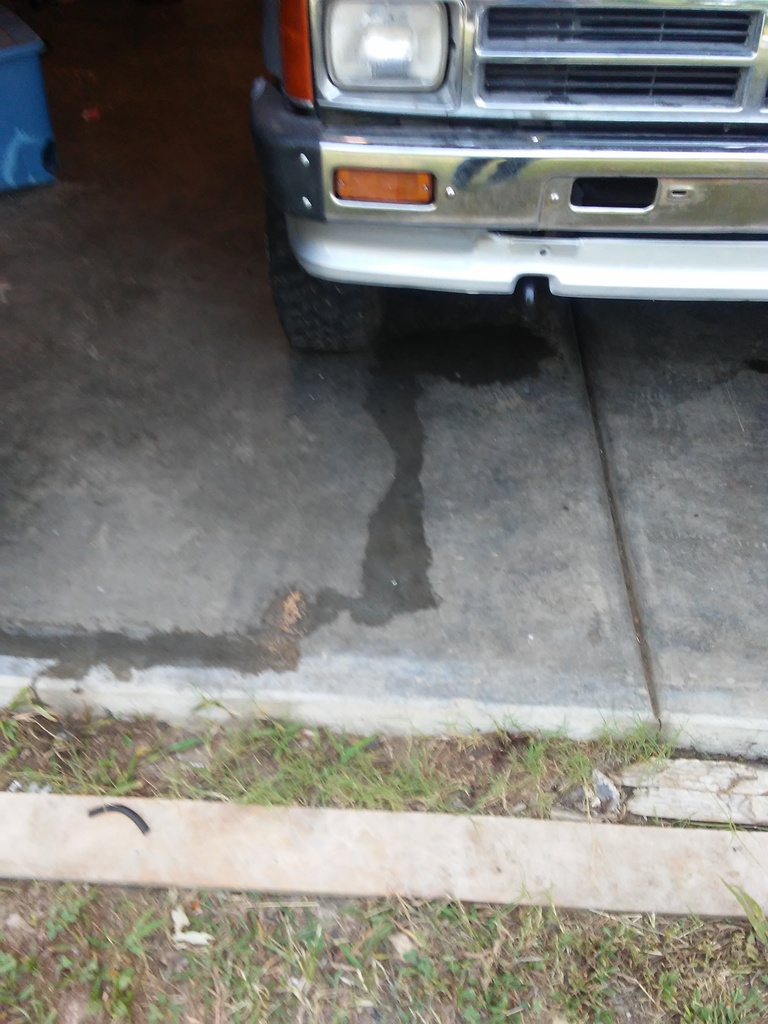

Not what I wanted to come out in the shop and see this morning. I will deal with it later and see what is going on. My brother found a nice 94 pickup and wanted to know if he should get it. I talked him out of it as it would be me working on it and those would be emergency situations to get it back on the road. I know any 20-30 year old truck is loaded with problems and he would not want to spend the money and time to do it right. I really suggest if you want to get one of these trucks or even like my old Ford, it is best to tear one down and bring it back up. Not something he is not willing or able to do.

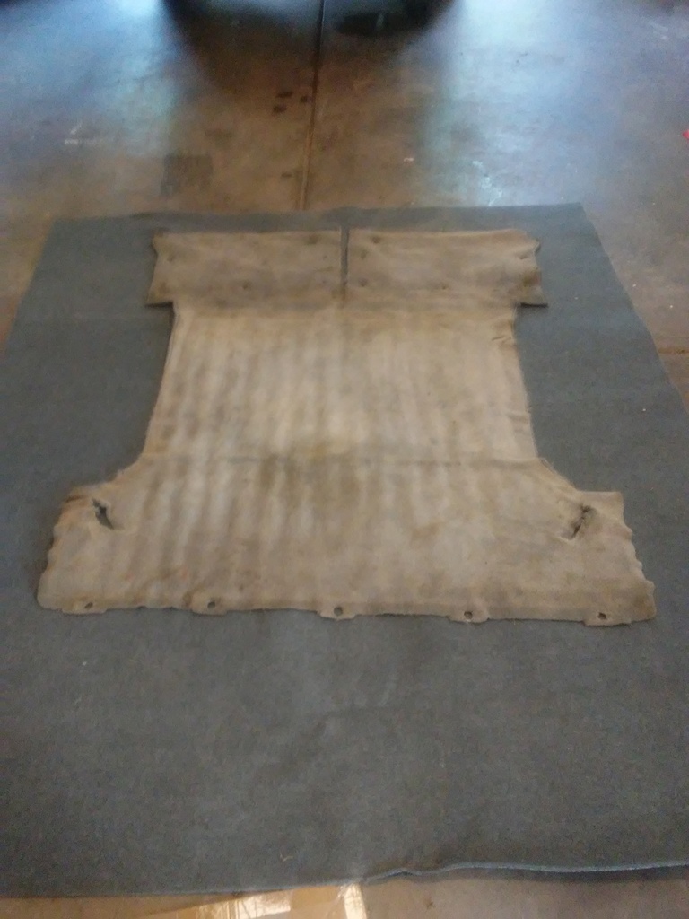

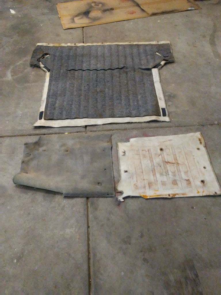

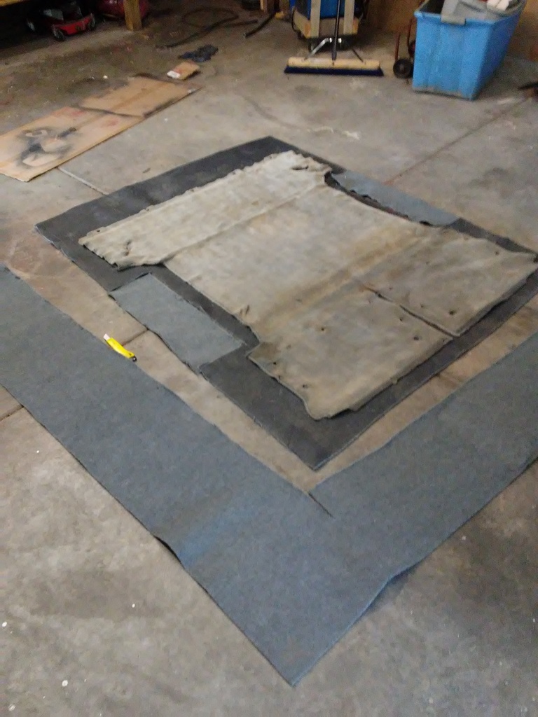

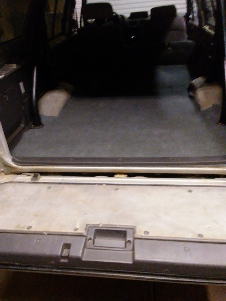

I have looked everywhere for gray carpet. I could of gotten it off of a carpet dealer but it is expensive and even they dont do an exact fit. Any replacement carpet will be about 2 inches all the way around. For the cab, I would only use an aftermarket replacement as it will have the contours formed into it. For the trunk, I suggest getting a piece for about $30. If they have a remanent piece, most shops will just give it to you. Finding and exact match is nearly impossible.

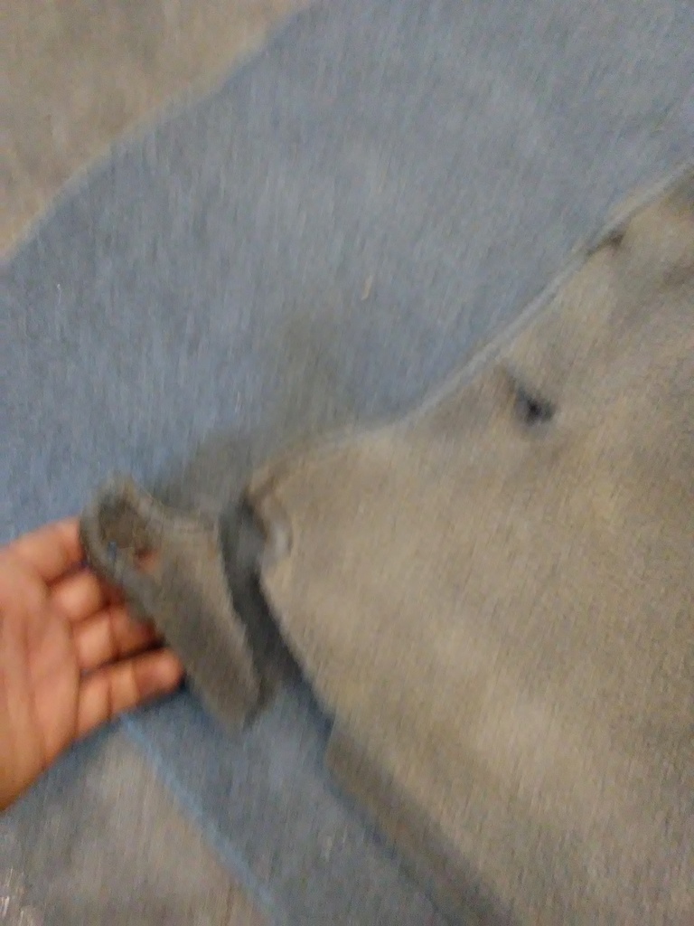

Here is a sample piece I took from the original carpet and sampled against the stores pieces. I probably went to 20 different stores trying to find samples from mom and pops to big box stores.
I cut wide from the old carpet and using it as a pattern. You can see the 50 different shades of gray that the old has faded from.
I cut the seat backing off and will use the original as padding and noise reduction.
Old floor piece installed with out seat part as the old carpet will and has shrunk alot.
Got old under the new and will save your knees when crawling around trimming.
Just have the new piece laying in. It is getting hot so have the ac cooling the shop and need go get some new razor knifes from Dollar General.

It may look several shades off from the original but there a so many shades of gray out there, this color was the closest that I could find. Once the back end is together, it is seperated from the seats and will not be noticeable. The tail gate and fender pieces will stand out and will see what I can do about blending them in a little better at a later time.

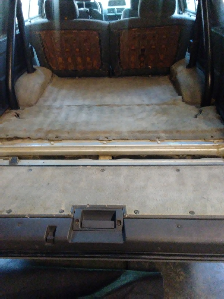

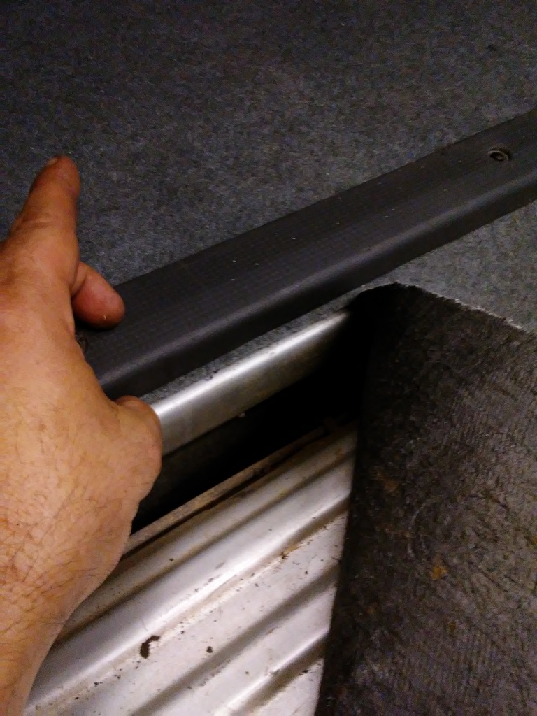

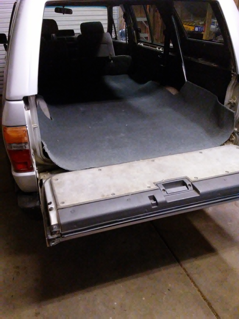

Here I am cutting the excess from the rear with the trim holding it down. Where my middle finger is, is where Toyota would have it cut to. I am allowing for it to shrink.
Here I am doing it a little different then Toyota did it. Toyota has the foot of the roll bar under the carpet. I am putting the roll bar on top of the carpet to help hold it and to try and give it a cleaner look from my trimming. I slid the edge of the carpet under the side panels to hide the edges.
Got most of the back end done. Still need to work on the front and work on getting the fender covers trimmed in. I am going to try and use some interior paint on the fender covers that I used on the side panels to blend it in a little better.

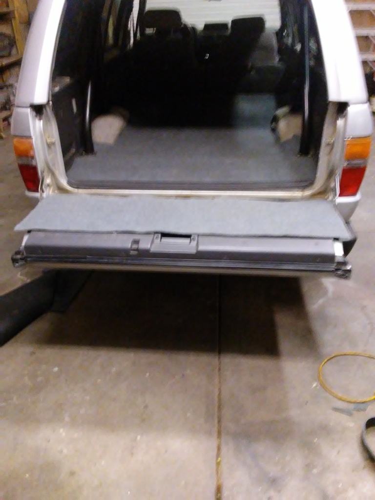

Here I have an excess piece for the tail gate. I will see what I can do to cover the tail gate. Not sure what and how I will do it.

The piece on the tailgate is from the same piece I am using on the trunk area. Not sure why the colors are so far off from what they actually are.
Been helping a friend on his truck and got a picture of the kick panel fuse cover for the 89-95. I will add this to my 88 Runner build for a future reference.

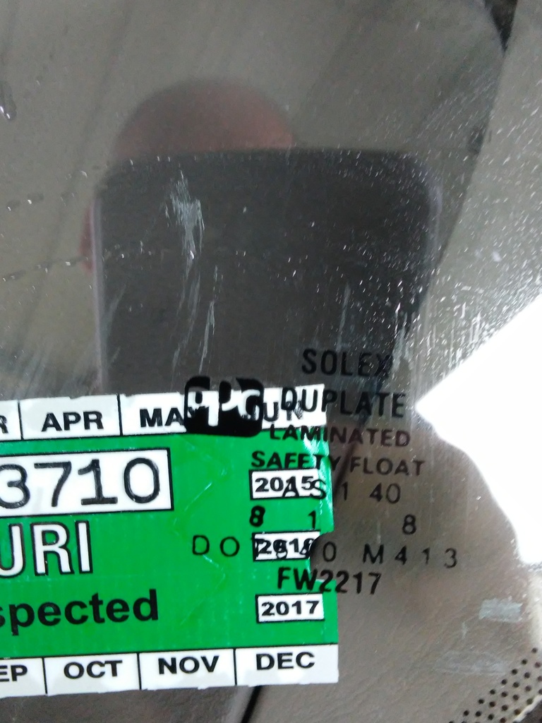

I was looking at another members thread and he is having issues with his windshield. Would like to see what others replacements and the kind of luck you guys may be having. Here is my SWAG, Scientific Wild Butt Guess. I am not sure what brand Toyota uses as all of mine have been replaced. I cant blame the wife for the cracked glass as it has all happened to me. I drive at night with little to no traffic and when on interstates, I do not tailgate. When on the interstate, if you watch traffic will be bunched up and then there will be a dead spot of no cars. I either get in front of the traffic or slow down and get in the dead spot where there is no cars. Not always possible but can be done in most cases.
I recently traded the Nissan off for a RAV4, it was her turn to pick out the next modern car, it came with a new PPG brand glass and it is the worse for getting cracks. I am getting a crack a month and figure I will be replacing it in 6 months or so.

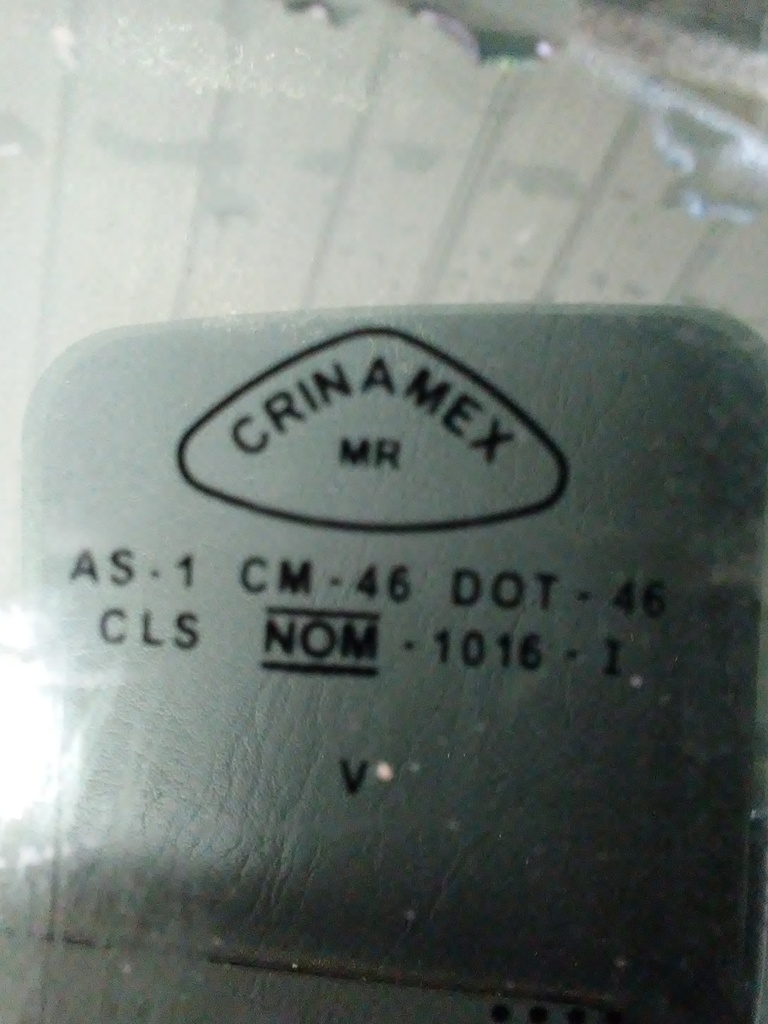

My 01 Runner has a Crinamex and I have had this windshield for about 6 years now and still no cracks. It should have some as I know it has taken some hits. Never heard of the brand but has been a great one for me.
The 88 Runner has a SGC, another brand I have not heard of but has been a good one. Getting rained on at time of picture.
Old Sep 9, 2016 | 10:43 AM
  #199
old87yota's Avatar
Joined: Jun 2013
Posts: 3,112
Likes: 582
From: Portland, Oregon, USA
I still have the original windshield in my truck. It is a LAMISAFE windshield that has some pitting but no cracks after 30 years of use (but I only have about 80,000 miles on the truck).
Old Sep 9, 2016 | 12:48 PM
  #200
Terrys87's Avatar
Posts: 11,787
Likes: 28
From: Anderson Missouri
Thanks old87yota...That is what I was hoping for. It might help others in determining a windshield to go with for their next replacement. I worked in a body shop for a time and we swapped out what I thought was a good windshield. After putting a new one in, I could see what a difference in appearance and visibility it made to the truck. I never paid attention to the brand until I got this PPG windshield. From my own experience, it is not from my driving that is causing this windshield to get chips and cracks. I am thinking it is a poor quality windshield. I tried to get a good picture of the pits in the paint or grill of one of my trucks and all of them looks like they have been driven thru a sand blaster. Just part of being a daily driver. Factory paint will hold up better then a re-paint and even those are pitted. Shows what the windshield is really going thru.
