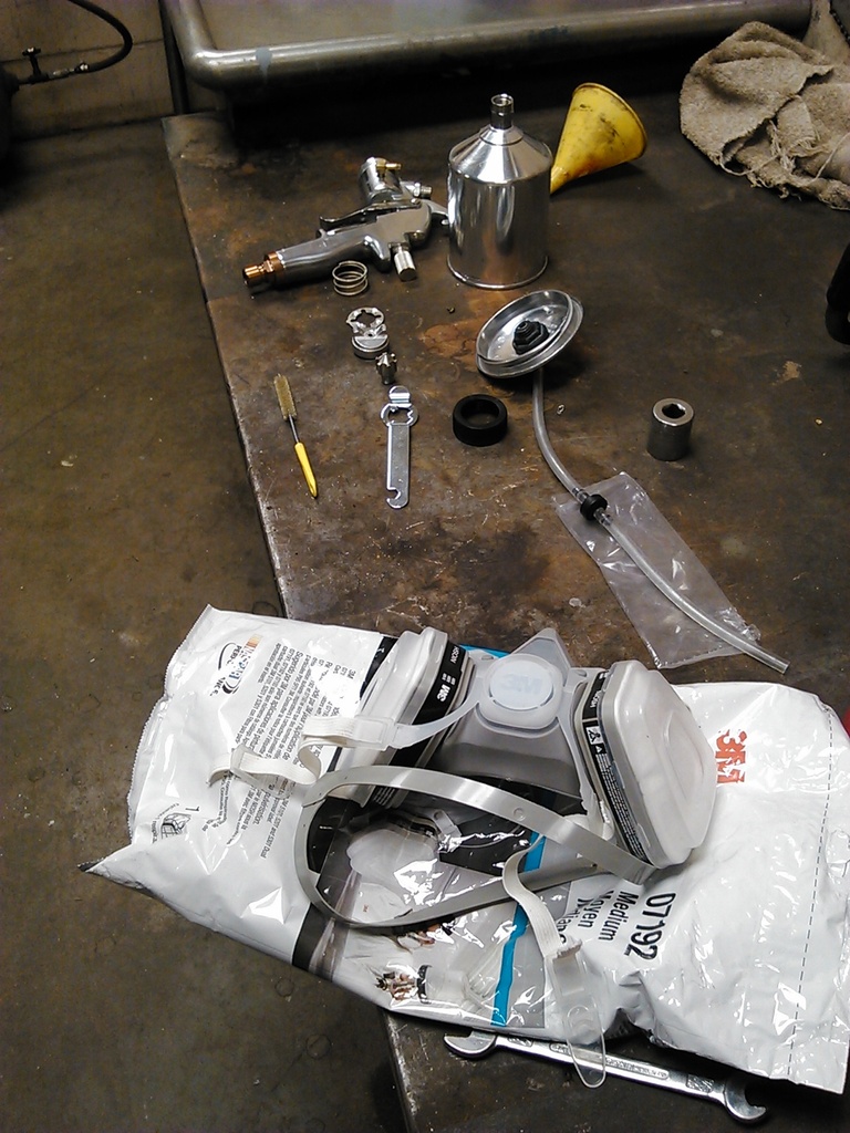

For a primer gun, I just get a cheap gun and don't spend a whole lot of time on cleaning them up. Probably a reason I have so many laying around. When it comes to my paint gun, I do spend a lot of time cleaning them up. I didn't clean one up one time and when I was ready to paint, I had the paint mixed up and was ready to paint but it would not spray right. Lesson learned on that. Now I let thinner set in the gun for a few minutes and then spray it out.
Later on I will tear the gun down and clean it up completely and especially before I mix paint up for the next spraying. I will run thinner threw it and see if it has a nice fan spray pattern.
A gallon can is about $25 or the 5 gallon can is about $40. Find a local auto body store instead of the big name part stores for thinner. So much cheaper and you will use a lot for clean up.
I pulled the trigger assembly apart earlier and now letting things dry out. The nozzle has holes about the size of human hair. I let all metal things soak in a can of thinner and then scrub them down. Cleaning up afterwards takes a lot of time. Also invest in a mask when painting. Primer I don't always use a mask for small jobs, but painting I do. For a small paint job and good ventilation you can go without a mask for a few minutes. Justin was not wearing one earlier in the picture but if he would of been painting a big part, I would of had him to mask up.

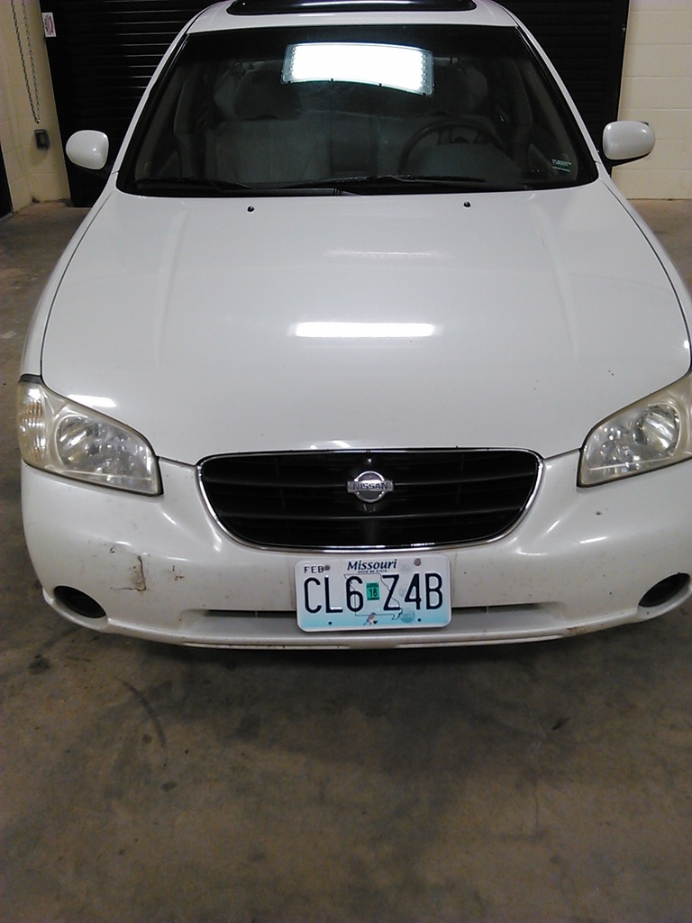

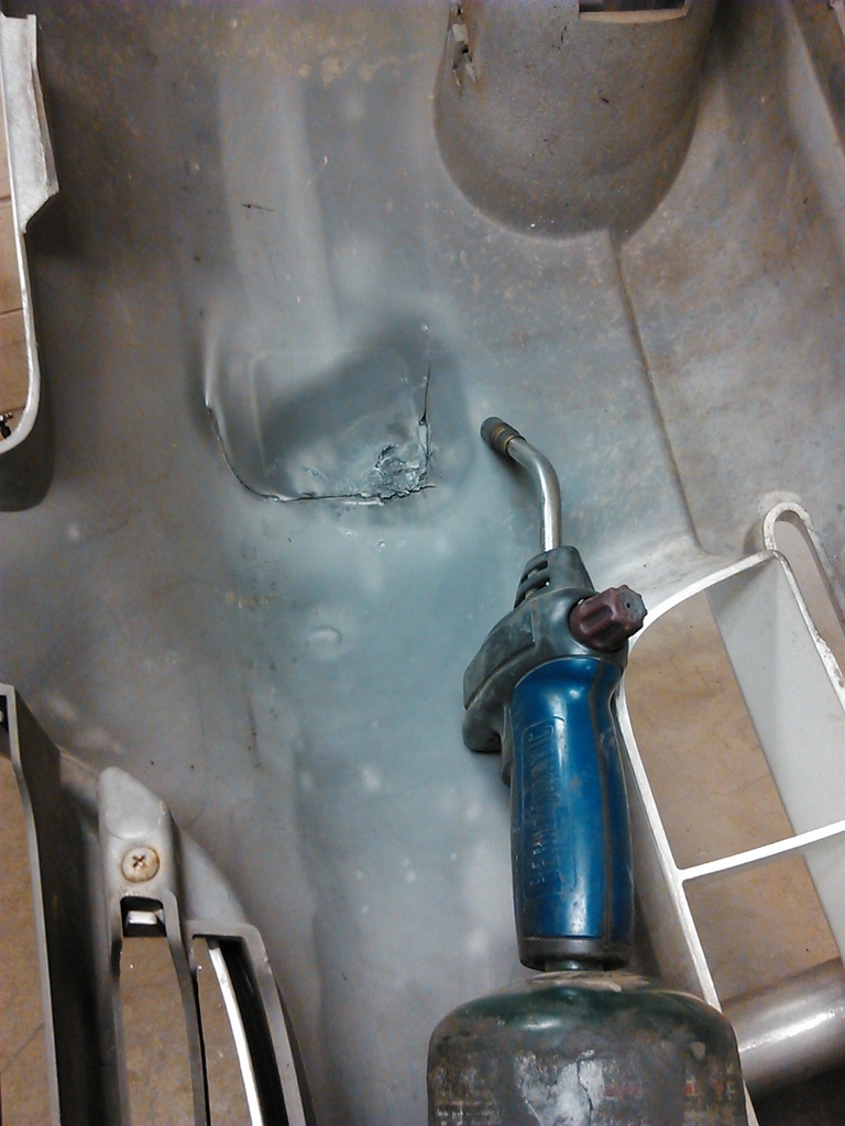

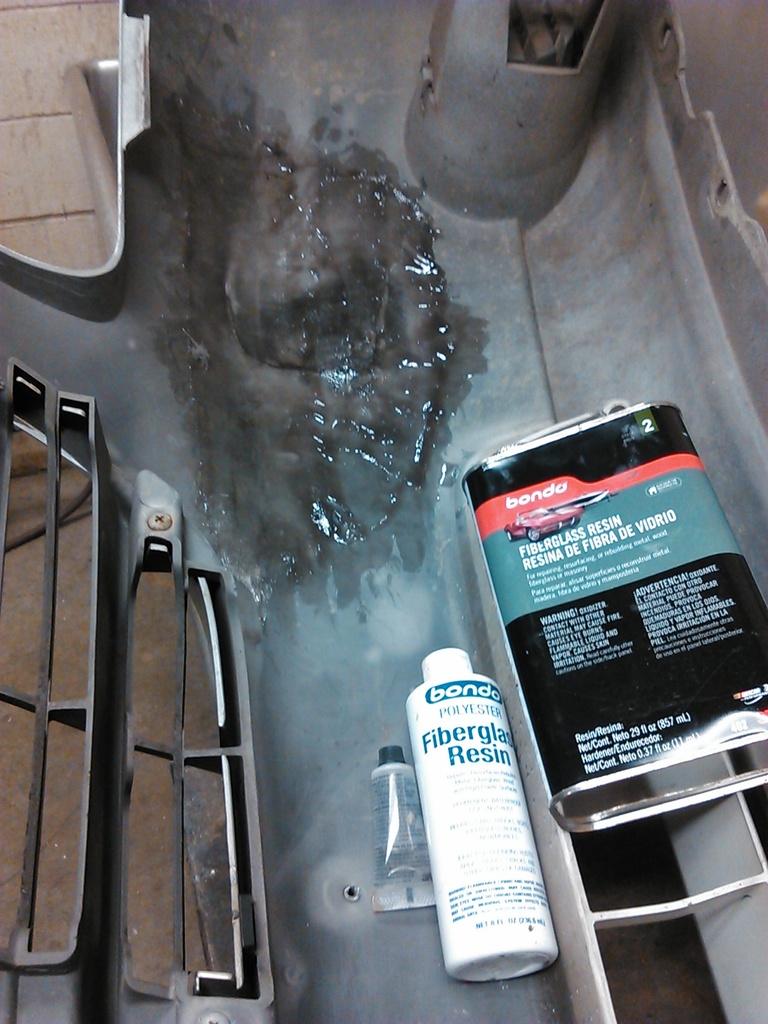

Here is the hole in the bumper.
I pulled the bumper off and with careful use of a torch I worked the plastic back into shape and then supported the rear of the damage with some fiberglass.
I need to get a heat gun but was able to work it with a torch. Add that to the list of a thousand tools I would like to have.

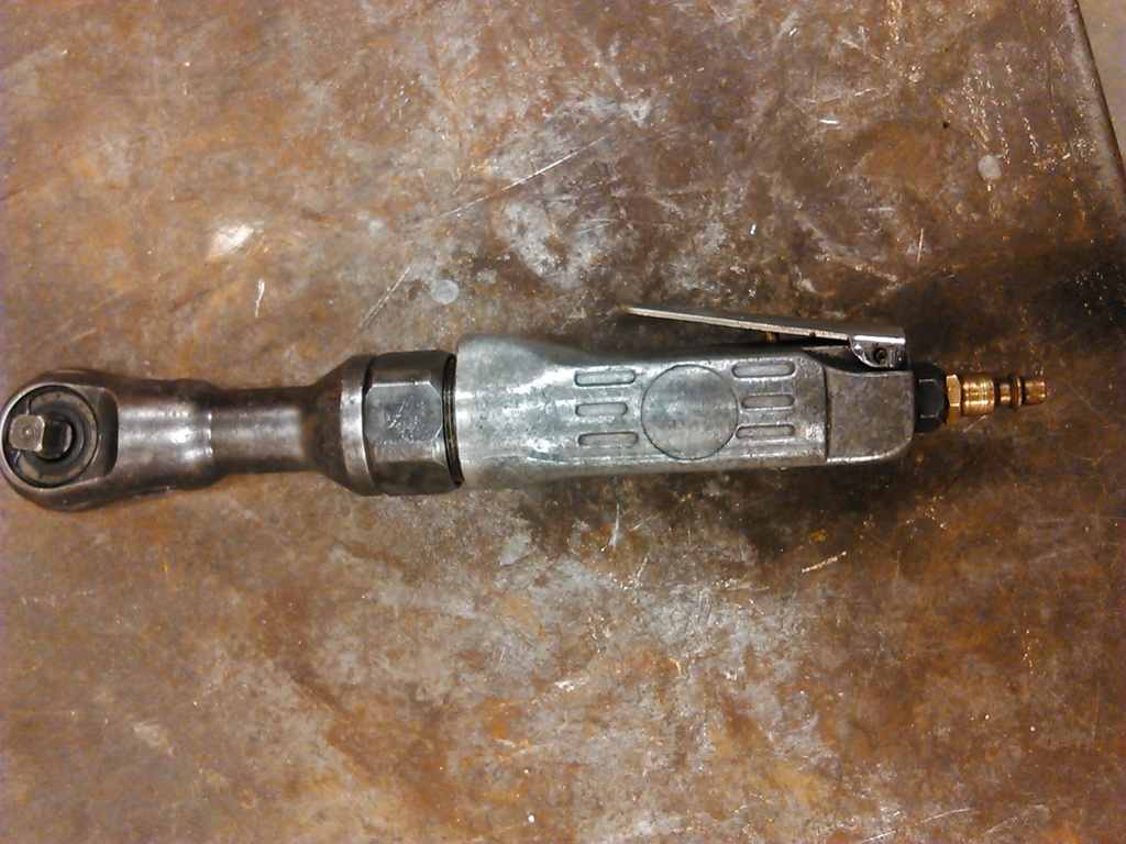

I always thought an air socket would be cumbersome but he has shown me how it can speed some things up. I found this one for $2 and it was really rusty and looked terrible. I figured I did not have much to lose so got it. After about 30 minutes of scrubbing it, cleaning it and disassembly, I put some WD-40 in it and put it on the air hose and it worked like a champ. I oil my impact wrench with Marvel Mystery Oil and did the same with it and used it on a few nuts and bolts on a motor I have setting in the shop and could not be happier with it.

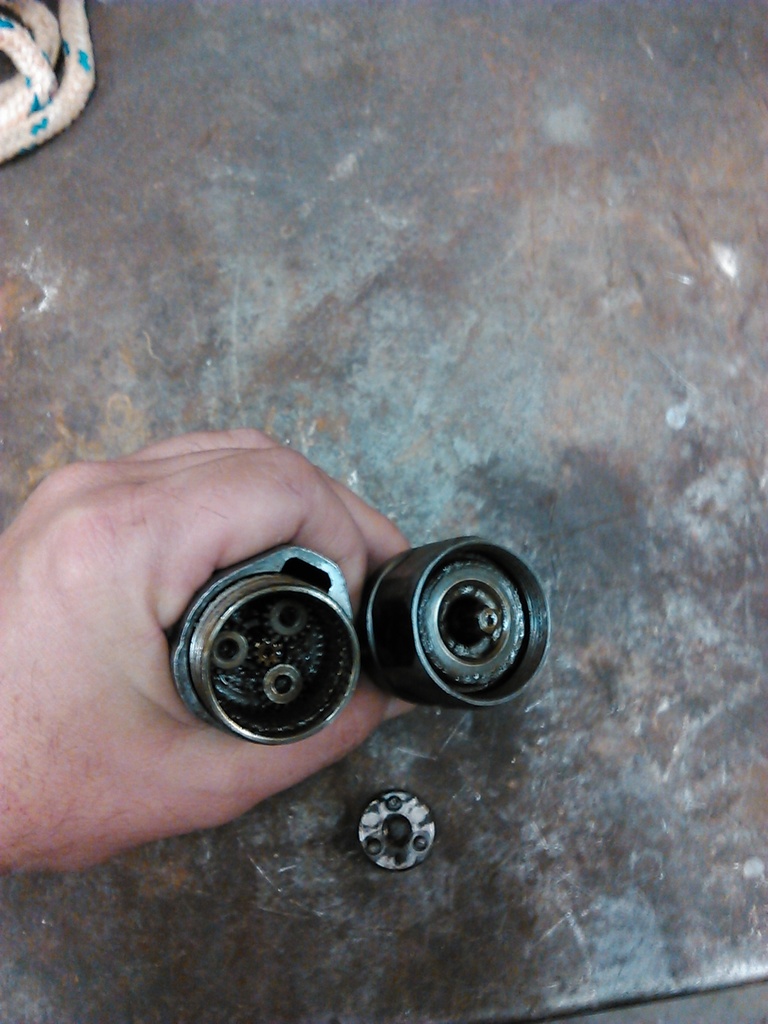

Here it is cleaned up. It was bad. I do need to get some longer extensions for it for some jobs I have done in the past.
I have seen impact wrenches get gummed up with moisture and the oil inside of them. Basically that was the only problem this one had. I did not get into the head of the ratchet that has the c-clip on it but have on other hand ratchets in the past. A good cleaning and lubricating and it is working great. Some reason just like taking something that is broken and getting it to work again.

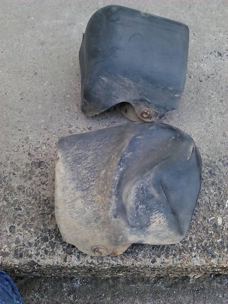

I went to a new salvage yard today as I was passing thru another town and they had one Toyota in the yard. It is an 89 Runner, what is left of it as it had been hit pretty hard on the passenger side but it did have the passenger side rear end cap that Toms truck has been needing. The bottom one is for the drivers side and is bent up. I got some of it straightened out and will have to use some heat to get it halfway back into shape.
Both will need to have a bolt or a stud for the top side as they were rusted up and I was not able to save them. Even thought the bottom is in bad shape, these parts are starting to get hard to find and will work until something better comes along.

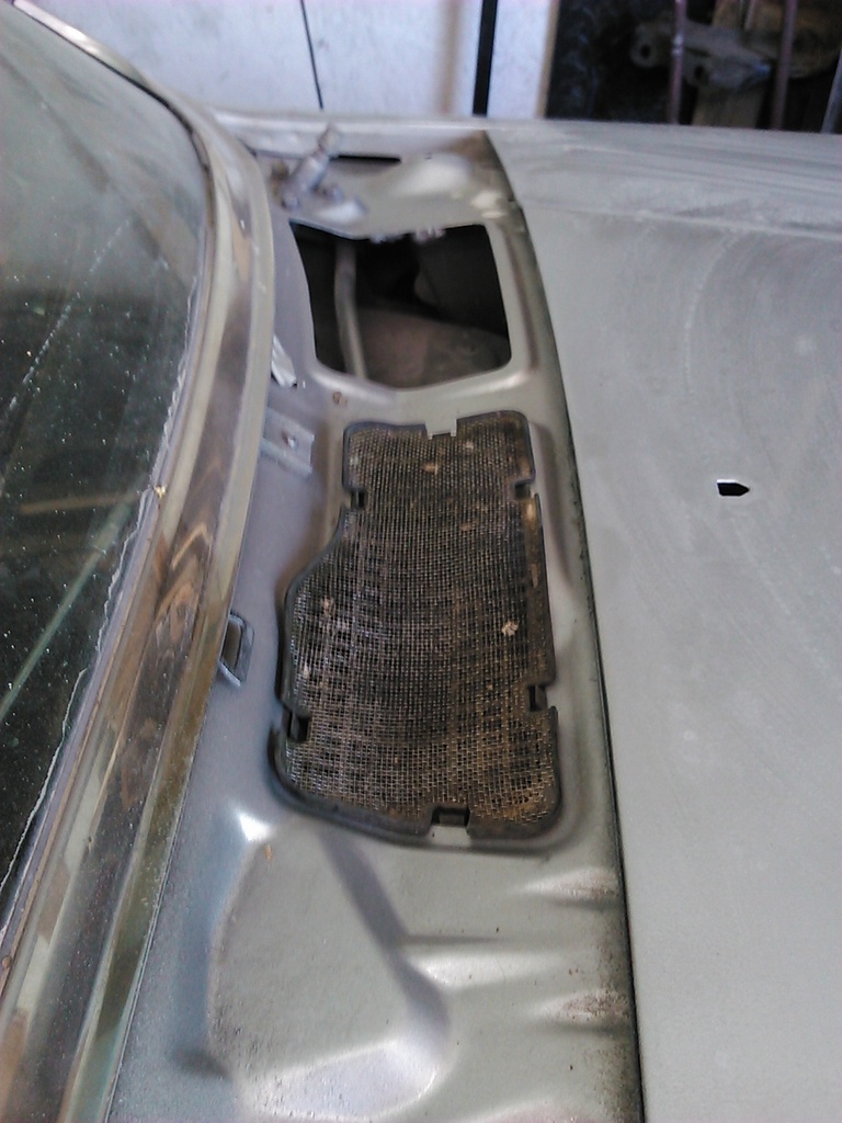

It has been a couple of weeks since I have gotten out in the shop. I few years ago I was changing a tire on a tandem axle trailer and I was using a hi lift jack and I got in the way of the handle. The moment I realized it and tried to get back out of the way the handle moved and thumped me in the jaw. A little while after that I had to have a tooth pulled due to the damage and it caused lots of damage. Been having to go to Little Rock to get that looked at and will eventually have to get it taken care of.

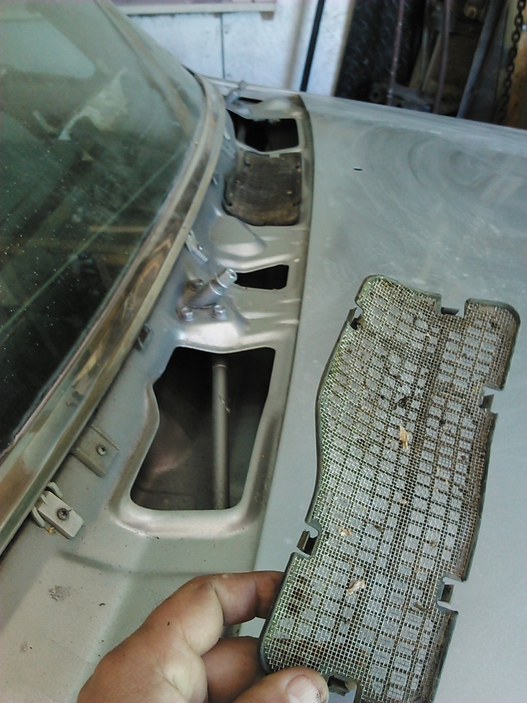

Some trucks come with no cover for the cowl, a cover for the cowl but no screen on the cowl and a cover with the screen. I got some covers with the screens and got them installed. This will help with this issue >>> https://www.yotatech.com/forums/f116...trucks-286766/ on getting trash in the vent system.
Cover with Screen.

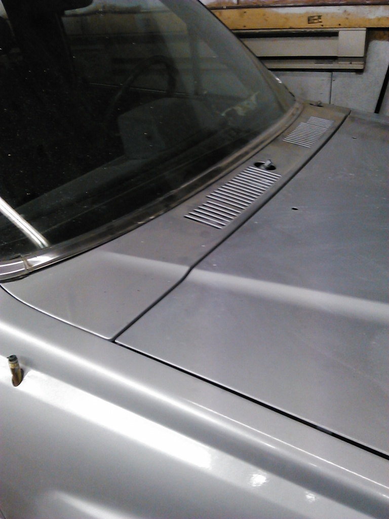

There is a large factory hole on the drivers side that has no screen at all on these trucks and debris can still get in.
Got the cowl on.

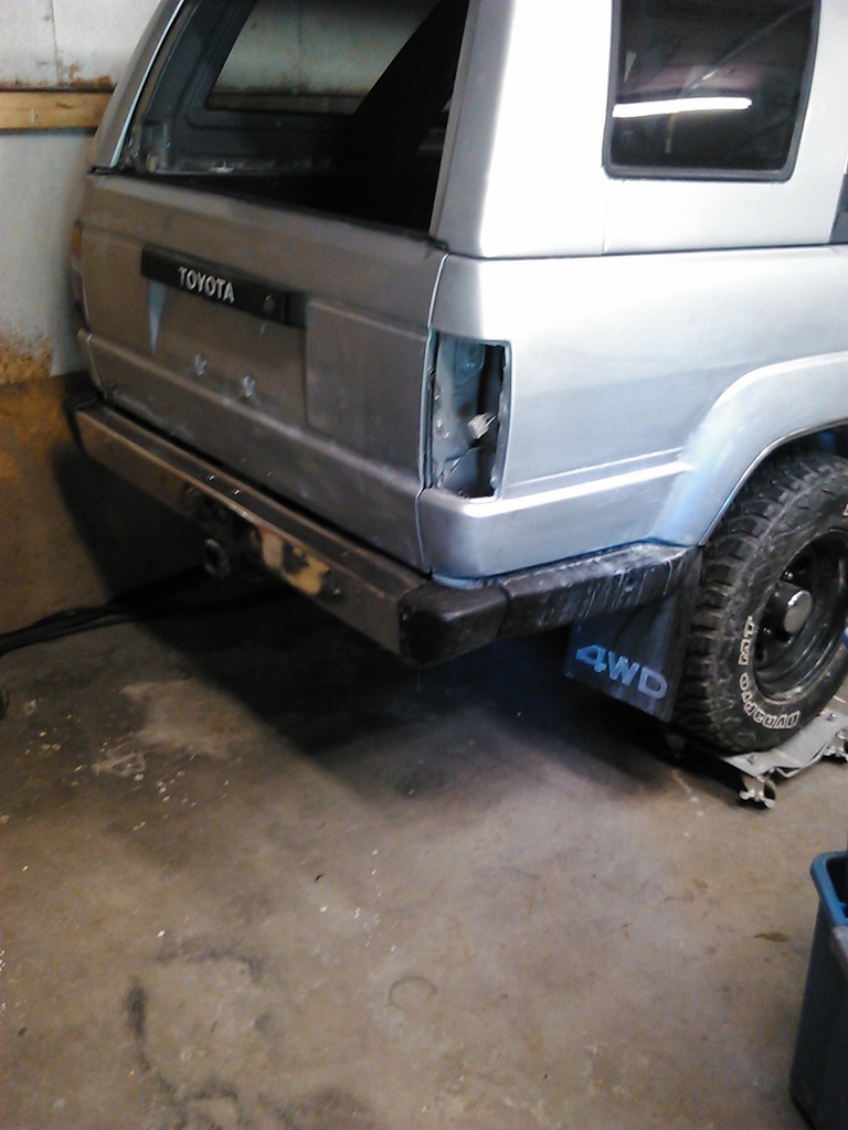

Starting to get the rear bumper on. Most of the bolts broke off that hold it to the brackets so will have to chase some of them down.
