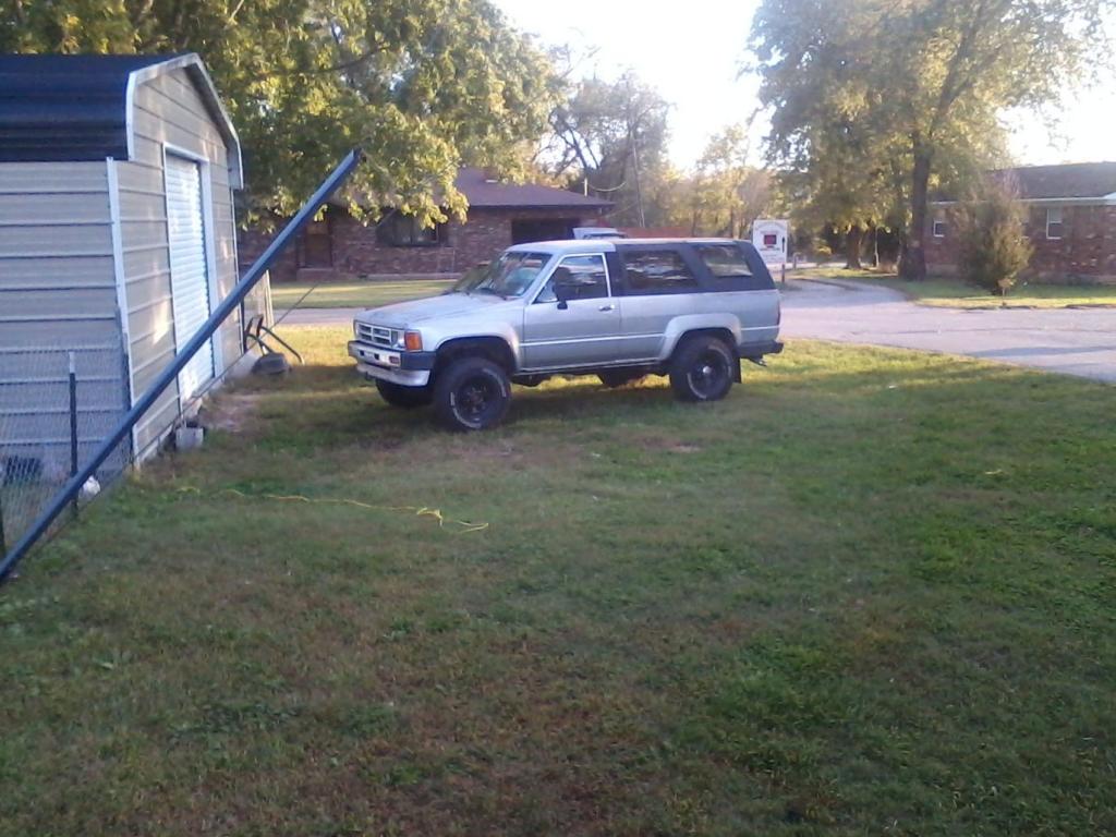

I did a pickup for an 86 extra cab pickup for Tom and he wants to get this runner in the same shape as his pick up. The runner is in great shape but as all old trucks, there are going to be issues. It has a noisey transmission or transfer case, one rust spot, a few dents in the roof, a dent in the right bumper area. It is a base model and will be adding several SR5 options. I will go thru the ventilations system, painting the top to match the body color, and I have already found a wire crimp in the horn wiring and sure there is other issues that will pop up.
Front and side view.

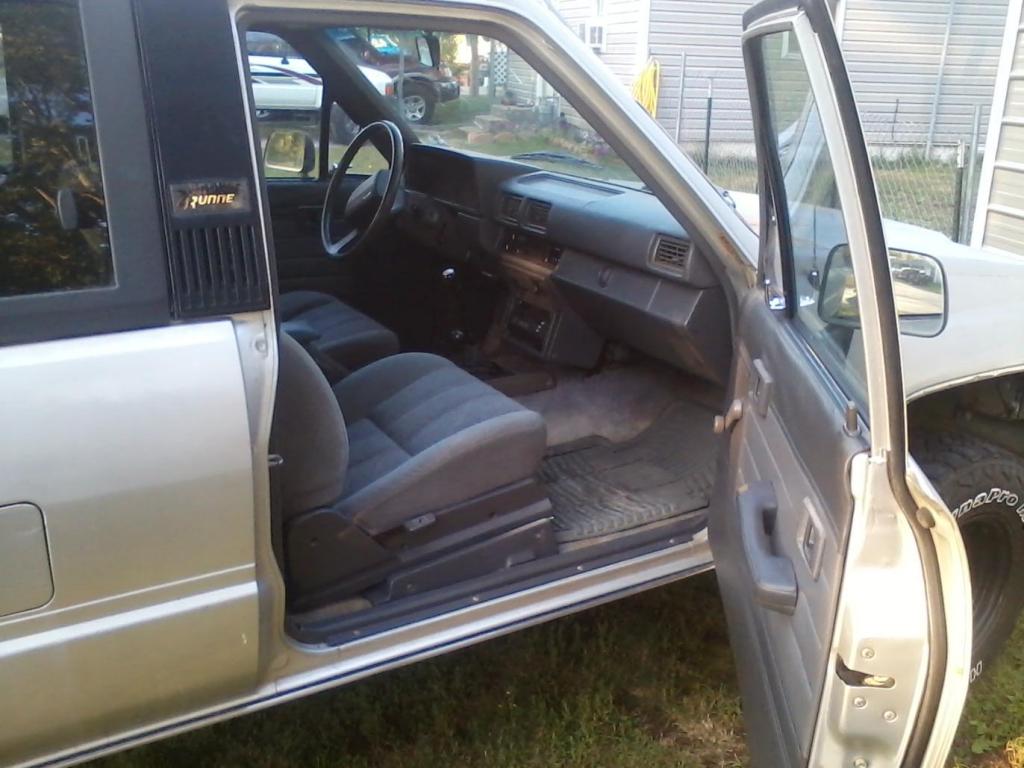

Interior

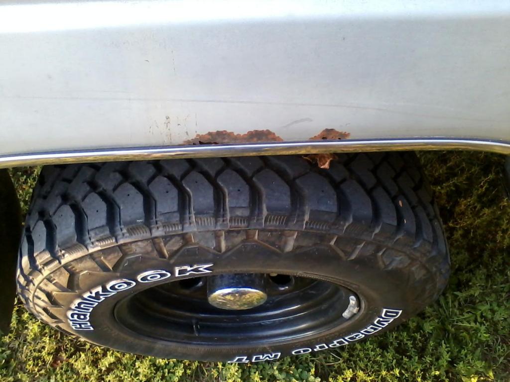

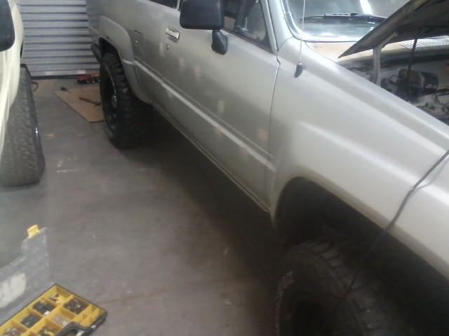

Worse area.

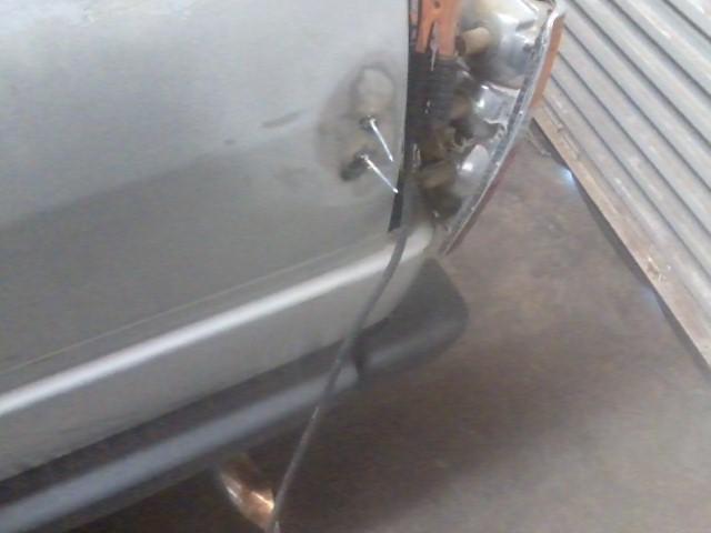

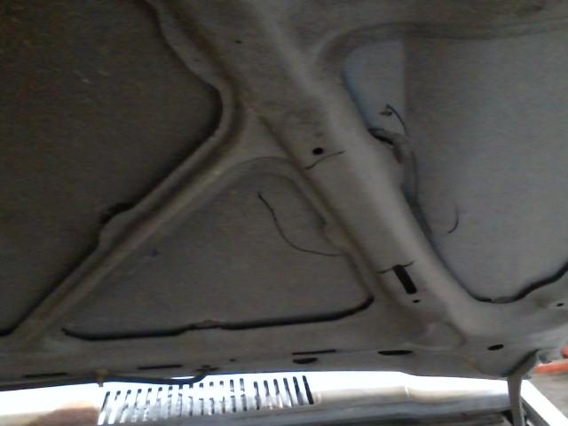

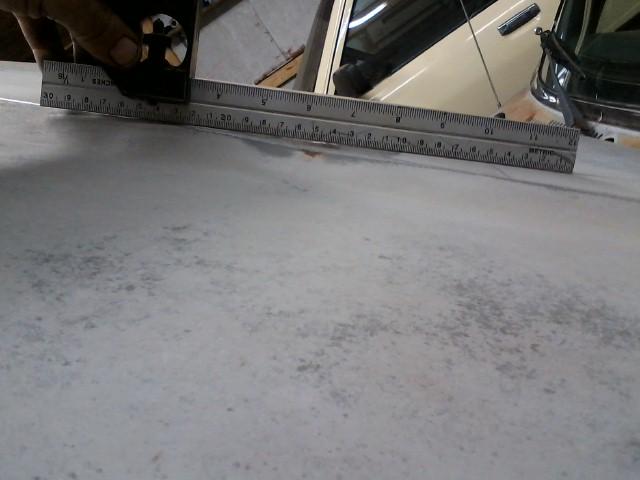

Got the infamous hood dent. Not sure what causes it. The small circle is what you see, the big circle is what you cant see. I welded some nails to the dent and used vise grips and a hammer to pull the dent.
I am unable to work the dent out from the back side with a hammer and dolly due to the bracing. Dent is circled.

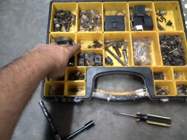

I know which screws and bolts go where and have plenty of extras. For some one that is doing a restore for the first time, do a better job of keeping track of your trim pieces then I am at this time. Harbor Freight sells these container that is great for this stuff. I have several more of these containers full as well. Extra tabs for inner fenders that I grab when in the yards.

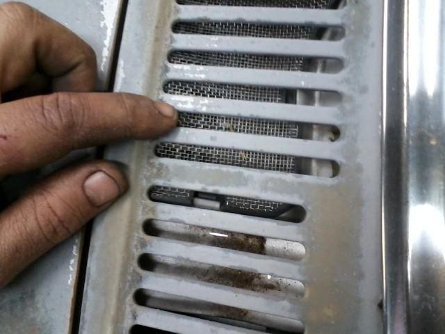

Some trucks have no vent covers, some have just the black vent cover and some have the black vent cover with the screen over them. When I pull the inner fender off, this truck had very little debris from the windshield cowl behind the mud flap. ( Mudflap is missing on this truck). One job that I wont do on these is pull the windshield trim. It is a royal pain and the trim will damage easily. I take it to my local windshield shop and let them pull it. They even struggle with it.

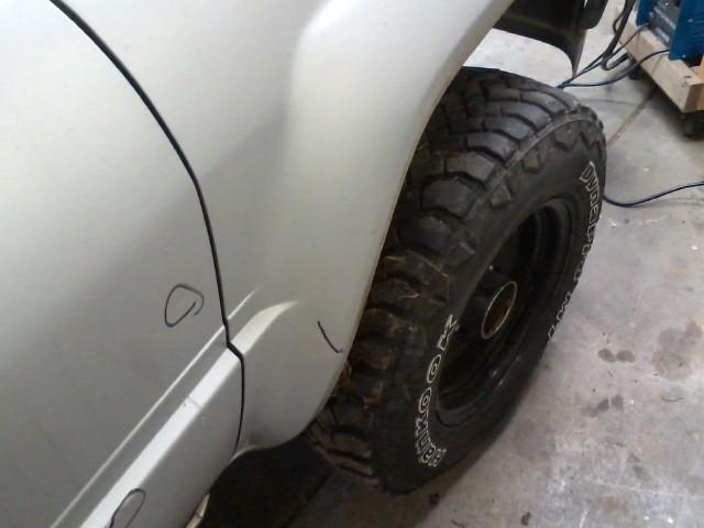

One small crease in the rear of passenger fender. Not bad. One dent in each fender and one in the hood. The door does have 7 door dings in it and they are very minor. I will post a picture of it later. Always good to mark the dents as once it is in primer, filler and such dents disappear but show up with first coat of paint. Also good to have a picture to know where they were.

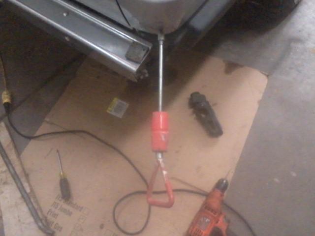

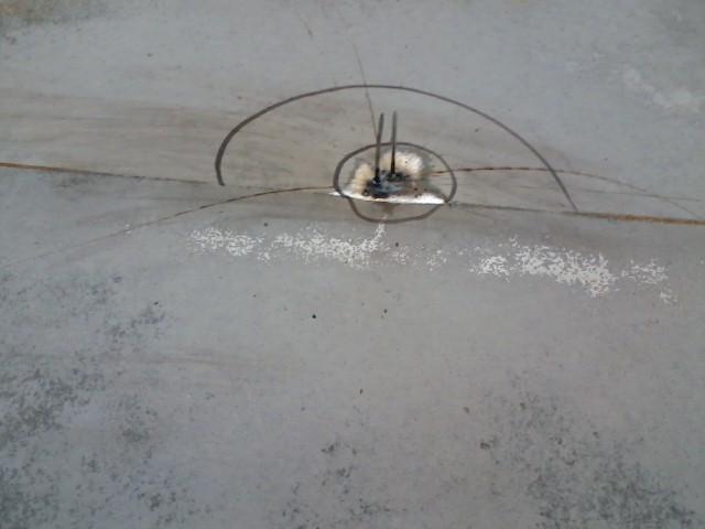

I worked on the biggest dent. My welder wont reach to that side of the shop where I dont have a power outlet so I still use the drill and pull style when is needed. I have two small holes there and will be filled up and be ok. This is on the right rear quarter panel.

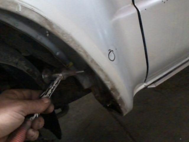

I am working on a dent on the drivers rear side. There are braces on the inside that will not let me push the dent from the inside to the outside. It is not deep at all. There is a deep dent scratch at the bottom so will be treating this as one single dent when appying filler.

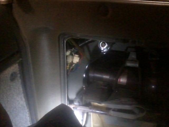

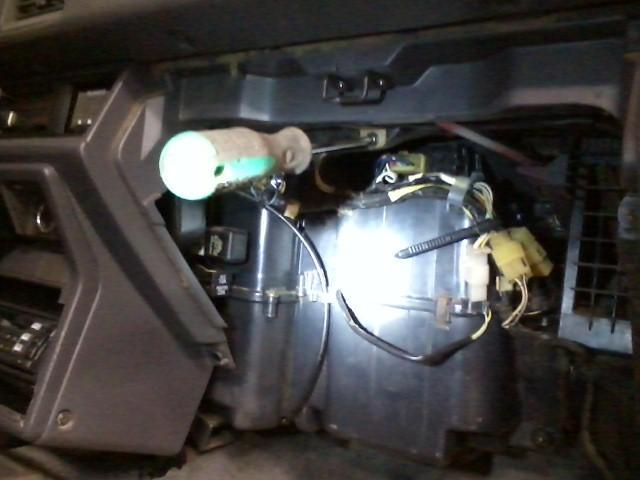

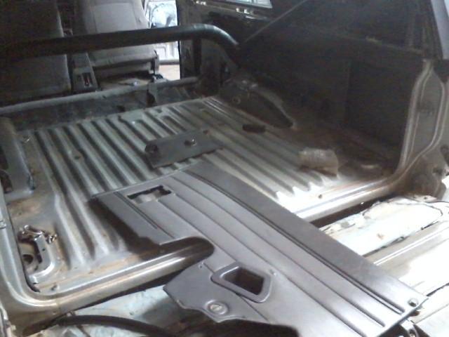

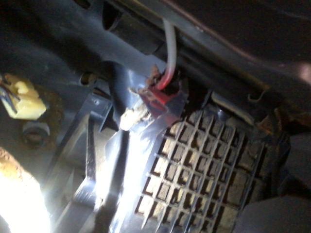

When removing the interior to try and access the dent, I found some wire crimps on the wiring. Later on I will be adding insulation inside the panels and will see what is going on at that time. I have yet to see one of these trucks with some kind of wiring butchering on them and this is a well cared for truck.

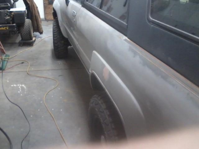

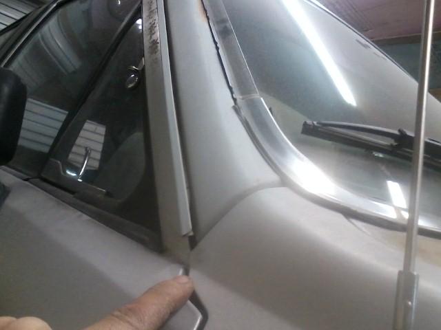

Silver paint in the 80s and older tradionally was the least durable paint. Someone in the past tried to cover the metal with primer. Primer is not a long term protective cover. It is porous and will eventually come back with a vengenace. The roof top is all primer and I will get some pictures later showing that it was cover in primer and where rust is starting to come thru. The surface rust on this truck has not done any damage. Would not of went much longer until some bad damage would of happened.
Here you can see where they masked it off and primed the A pillar and roof.

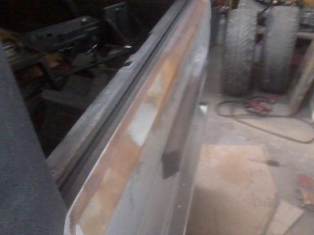

Here the rust looks bad, but a few minutes with 180 grit sand paper got to good clean metal.
Here the rear quarter the paint is dead and falling off. The door is still good solid paint.

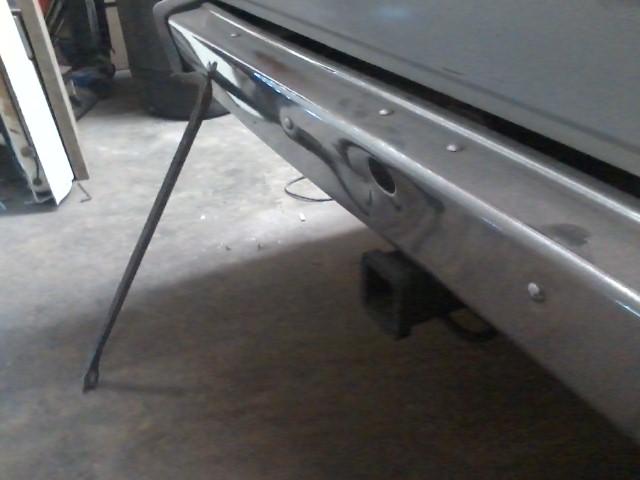

Just posting up some minor damage I have found. It took a bump on the drivers side bumper. There is a small crease below my fingers and the drivers side filler panel is showing 1/4 of it. Meaning the I will need to pull the bumper bracket out a little or replace it.
Here I am showing where the bumper is supposed to be out and is showing about 1 inch of the filler pad.

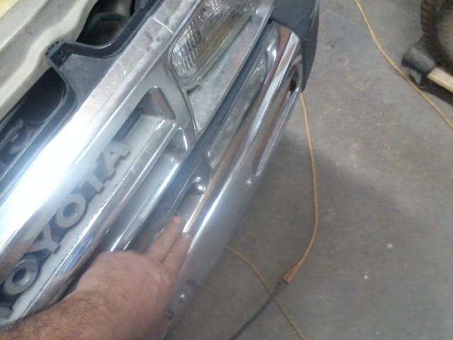

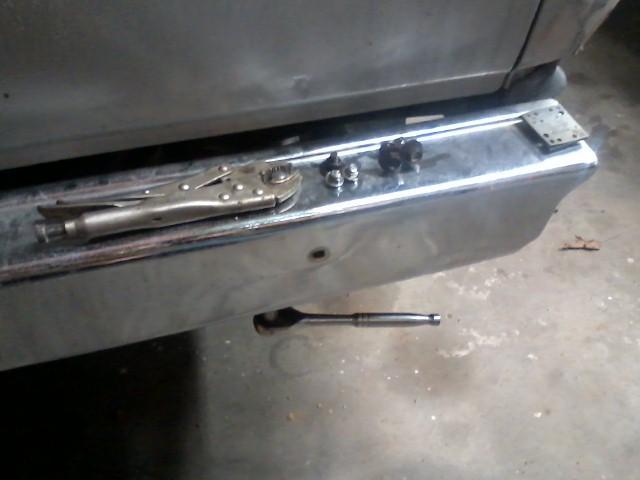

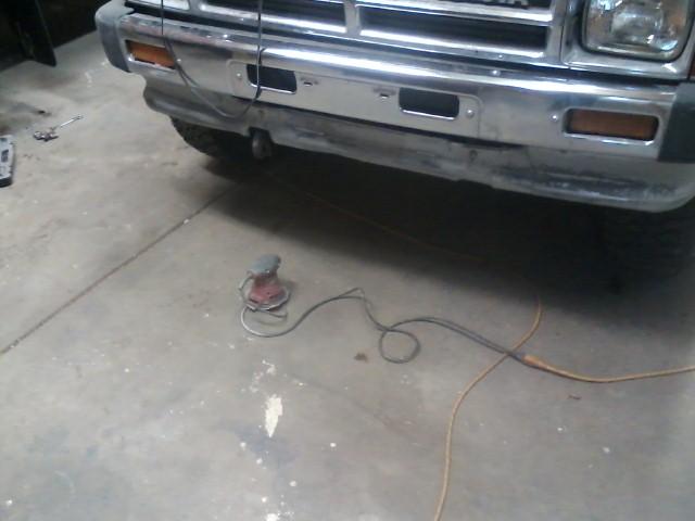

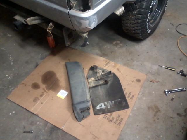

Started on the bumper. Even after soaking the bolts in rust dissolver some still broke which is common. Toyota metal is not the greatest. I would rather the bumper bolts break then when I have to get them out with vise grips. The square shoulder will wallow the hole in the bumper and then you can just remove the nut.

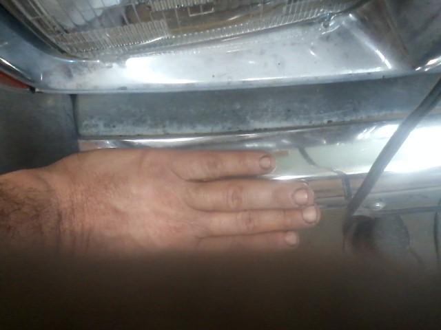

I like chrome but will not use it on my trucks. I took the chrome trim off and the rust isnt as bad as I thought it was going to be.

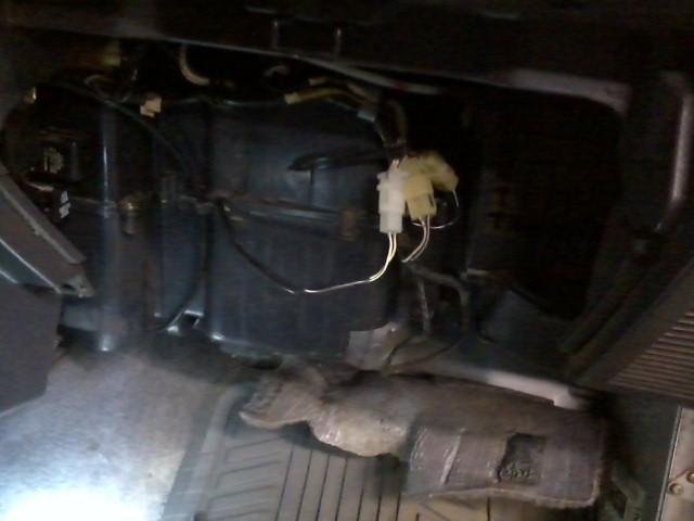

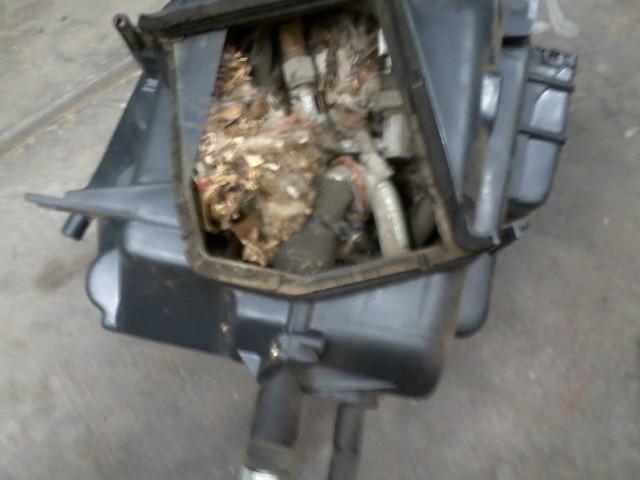

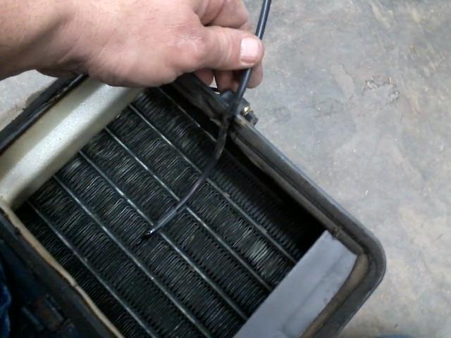

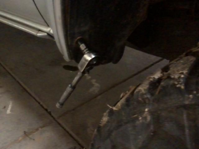

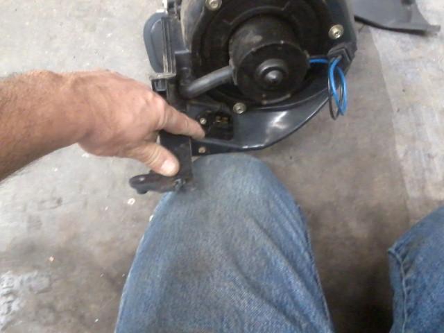

I am sure some think that because I start out with junk trucks that a mess is to be expected. The more I work on these, the more I am convinced to start with a junk truck and assemble it from scratch. I have owned and worked on nice trucks and have mentioned it in the past about how bad used trucks in general get. This one is no exception and it has had an easy life in its past. I am not knocking it just want to make aware of things you cant see. Carpet, fuel system, EGR, dirty sensors, and the list could go on if I thought about it and I havent even see those systems in this truck and would not be surprised.
There is a thread on the 89-95 on how to clean the air conditioning system on those and I might make a thread on it later using the following pics.
Remove the nut and bolt that is holding the smaller line to the inner fender for movement in next step.

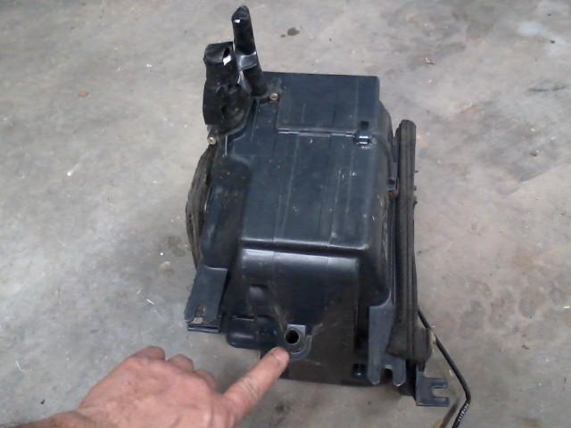

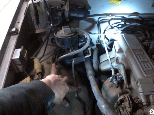

Loosen the bolt that my thumb is pointing at and remove the fuel charcoal canister.

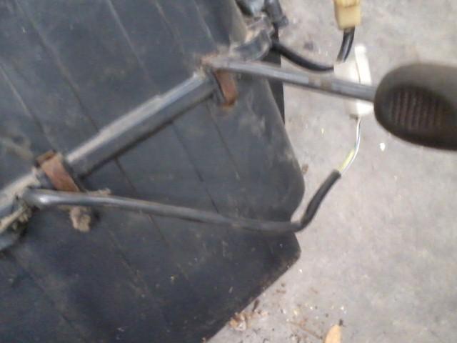

Remove Canister bracket. This will give you access to the AC Lines.

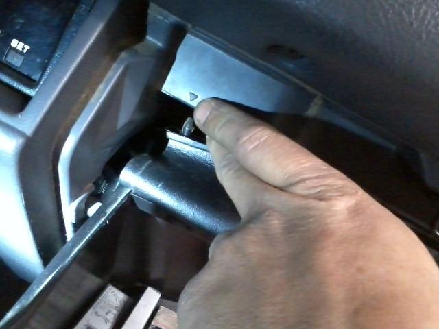

Remove glove box and then remove the lower black bracket.
Remove PE pipe. Above my thumb will say PE. Remove the screw by my pinky to get the pipe out. Slide to the right, tilt down and pull left.

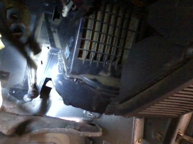

Disconnect 6 or so power connectors to the ac evaporator (Evaporator or condenser, someone correct me and I will edit the name to what it should be) and I use electric tape to cover ends of metal lines and to the below named part.
Pull the assembly out of the dash. There is a drain hose attached that is not showing. This is common of what you are going to find in the ac system.
With a screwdriver in the slot of the metal clip, just pry down. There is 4 or so clips and remove the 5 or so gold screws that hold the plastic box togheter.

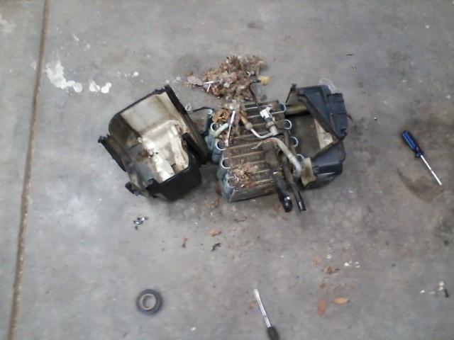

Seperate the box and I use an air hose to get as much of the dirt out as possible and then wash the coils with hot soapy water. Here you can see I have the lines covered in electrical tape.

Before you pull the blower assembly out, using some spray paint or similar will make getting the cable to where it needs to be when reinstalling later. It will be covered up so it can stay on for the next time you need to remove components.

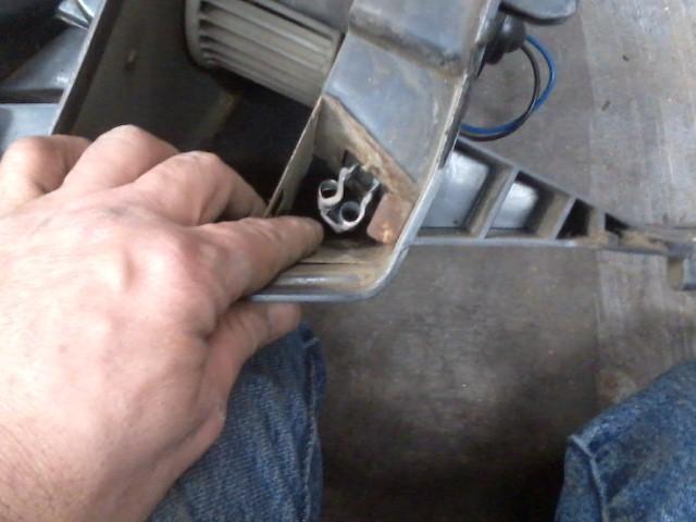

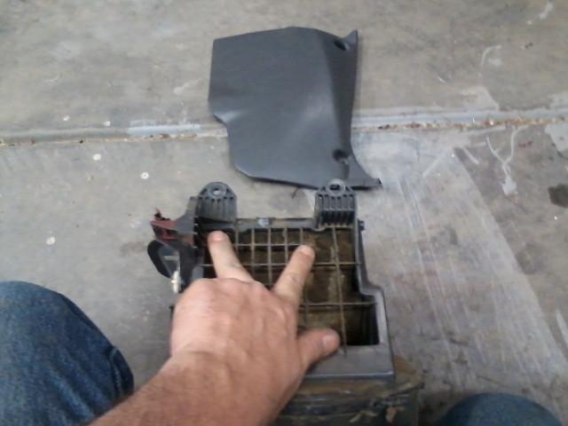

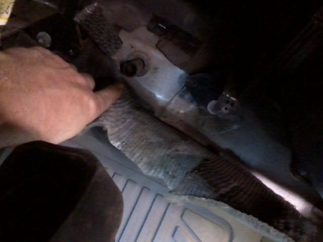

To remove the blower assembly, remove the passenger kick panel. Where my top two fingers are, you will need to get a 10mm wrench and get two gold nuts off. This will be the hardest part to do but is easily seen. Then there is one screw under the carpet you need remove and the assembly can be worked out.
Once the blower assembly is out. Check to see if you have a 3 or 4 pronged blower resistor. This one is a four pronged and it does make a difference as to which resistor you need.
This resistor has been replaced recently. Most will turn to dust when touched if it is worn out. I did not touch with my fingers to keep from getting body oil on it and causing a hot spot on it and wearing it out faster. It should be solid. Will disentigrate if bad,

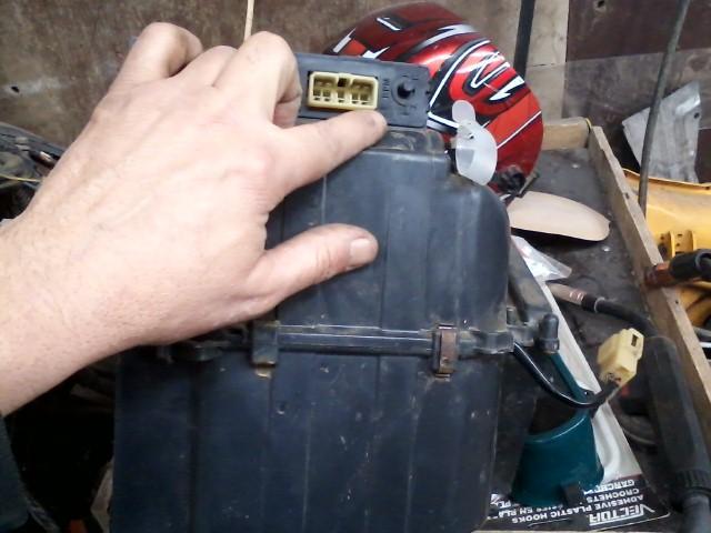

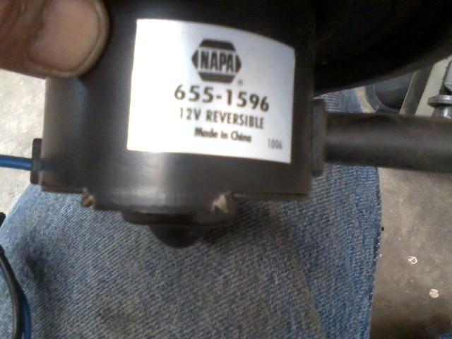

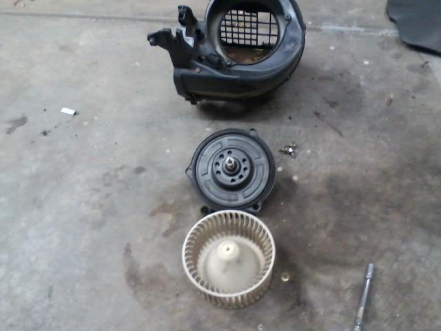

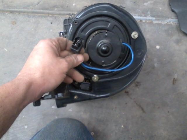

This motor has the correct connector on it but is not a Toyota blower. It is a part store blower and I will reuse it.
Besides the wire and connectors looks, I see the part store name on it.
Remove one nut that holds the fan blade on and the three holding the fan assembly in and just use an air hose to get all of the dirt out of the blades and the motor will have dust in it as well.

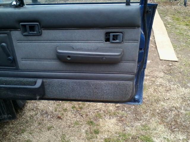

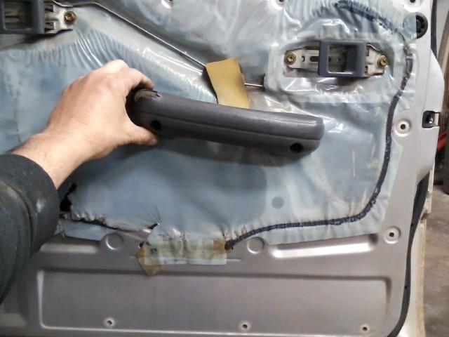

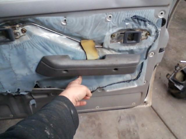

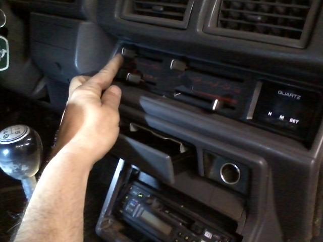

An easy upgrade. A while back I was asked about switching arm rest. You dont need to move the plugs the screws go into, just switch armrest.
Plugs I am talking about.
Small armrest.
Big armrest. On a runner on the passenger door, the back of the arm rest will be flush with the rear passenger door handle.
This is my 86 but what it would look like installed.

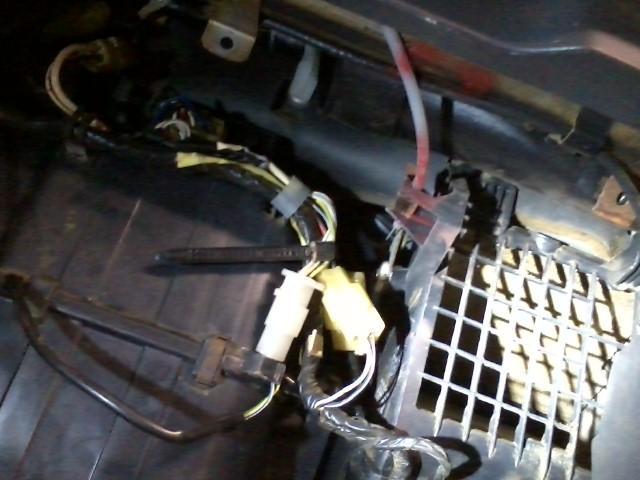

After cleaning and reassembling the ac evaporator, make sure this cable is routed out of the box. It actually goes inside and there is a cutout for it.
Same for this one.

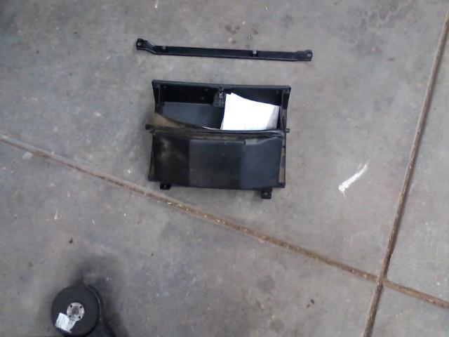

When sticking the evaporator back in, dont forget to hook up this drain hose or you will have a wet floorboard.

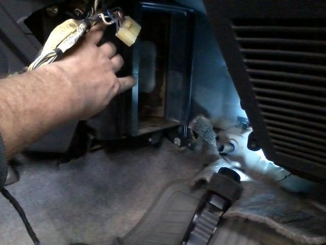

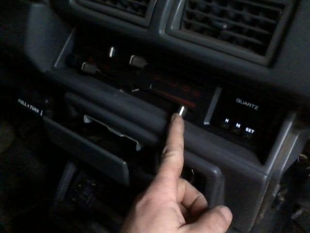

Before putting the evaporator in, slide the botton cotroller to the right to get access to the heater core and see if there is any dirt there. The evaporator caught the dirt on this one but is still worth checking.
With the lever to the right, you can get access to the heater core. I could not get a good picture of it you can see inside with the right angle and feel in there as well.

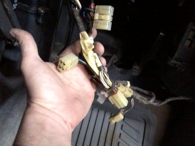

Re connect all power cables and screws are located below carpet.

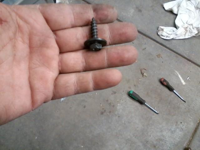

The screw driver is showing the PE pipe with the phillips screw that holds it in.

Install bolt that supports the ac line.
Reconnect the ac lines to the firewall.
Reinstall your charcoal canister making sure the vent tube is routed correctly.

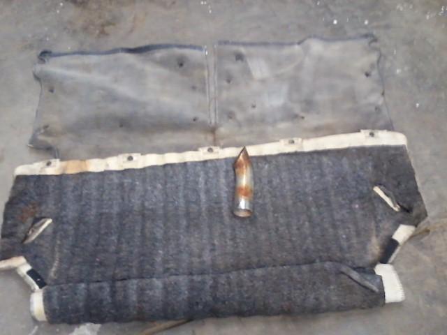

I am pulling the interior from behind the front seats to the tail gate. So much easier to paint and work on when the interior is out. I plan on pulling the top off and it will be stored outside. My tops have sat outside all summer long and it wont take long to prep it for paint. This truck has a rear heater in it and that can be a problem with the water hoses and having leaks.
First I pull the rear seats and the rear carpet. The rear passenger carpet I just roll up to the front seats. The muffler tip has a future as a soup can, glad to see it go. I thought it just looked terrible from day one. You can buy a rear carpet kit but I get a scrap piece from a carpet store for about $20. The kits are $100 plus and you still have to trim them.
Start by pulling the panels from the front to the rear as they overlap.

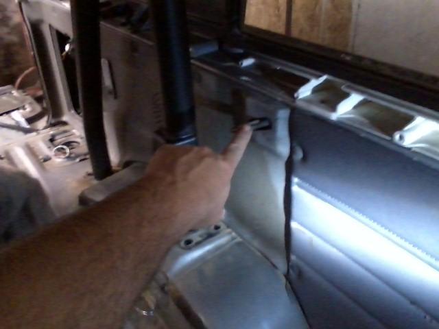

Do NOT try and pull the rear side panels with out loosening the roll bar and sliding all the way to the rear and then tilt forward. The panels are so brittle that they will snap when you try to get them off of the seat latch.

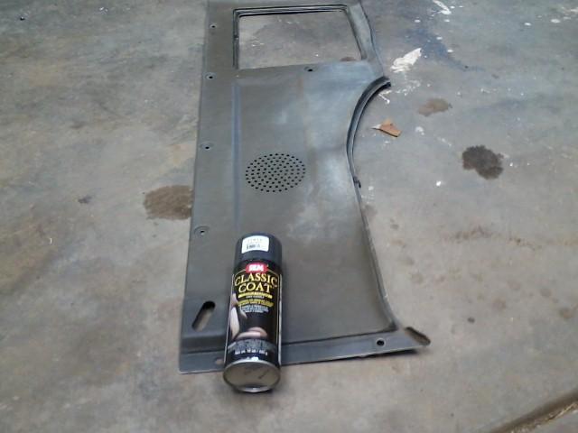

These panels fade and bleach and start to look white and green. For dark gray interiors I use SEM brand paint that is off of the shelf and is close to Toyotas color. Bottom left corner is a test spray to see if this is the color I will use. I will need to look at one of my other threads to find if this is the correct color.
