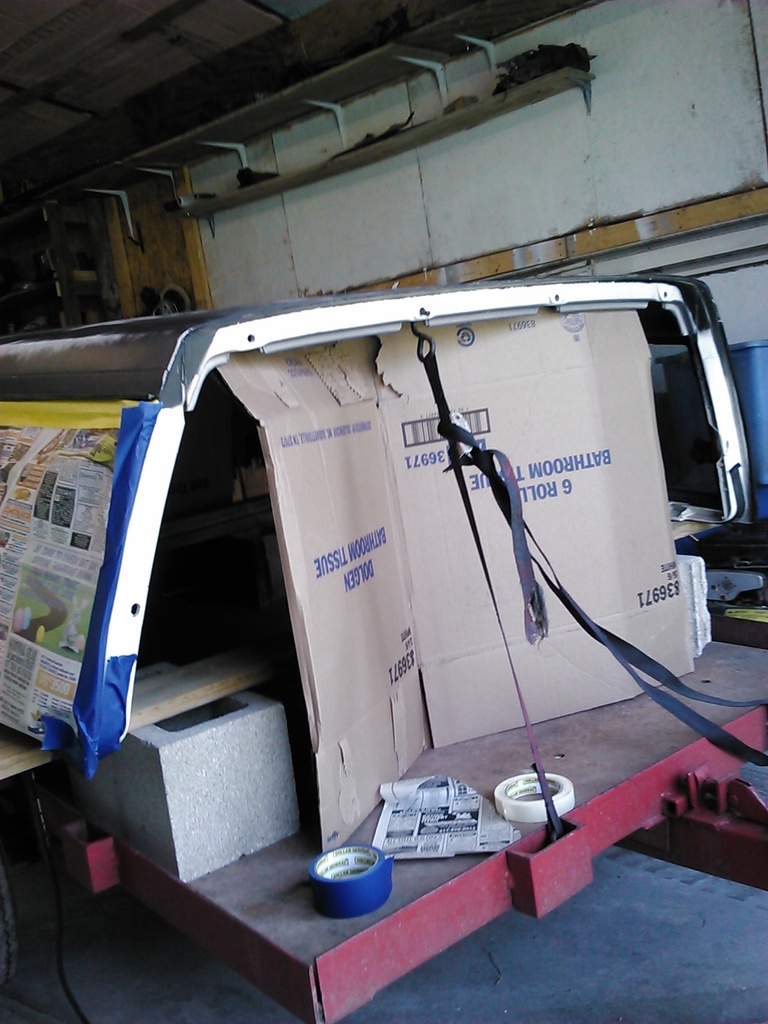

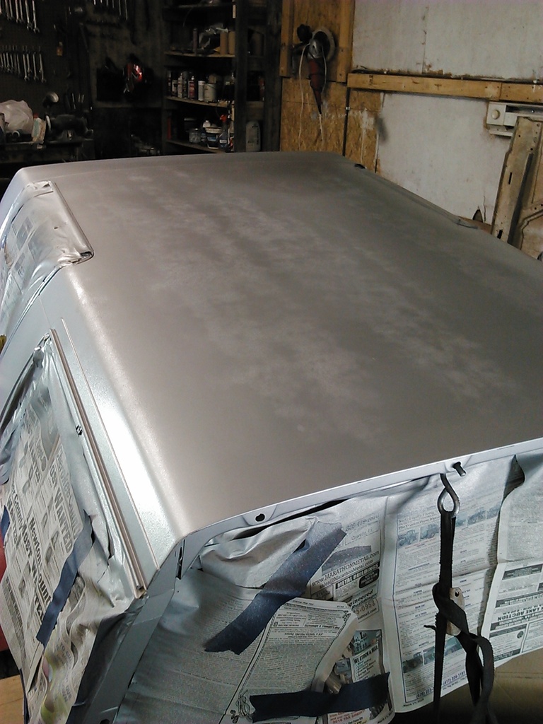

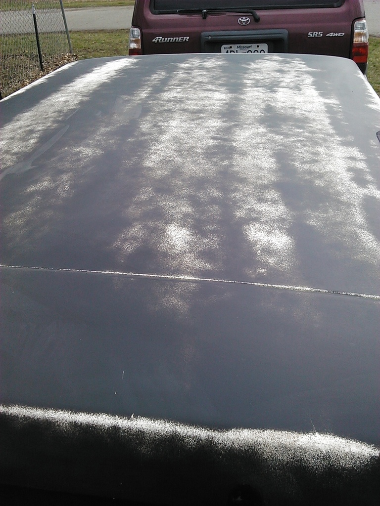

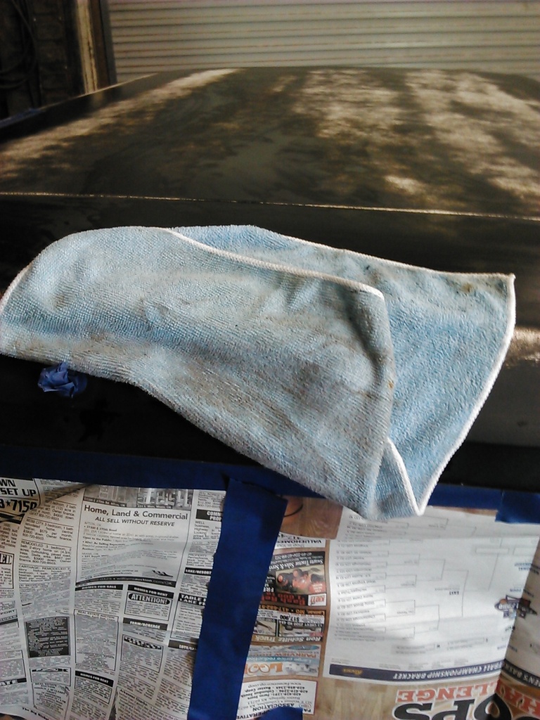

Went to get the top ready for paint for tonight. I could rub my finger across the top and still get a film on my so gave it another good scrubbing. I then rinsed it off and dried it with an air hose and water still kept coming out of the crevices. I will let it sit in the shop all night to make sure it is good and dry.
This is an hour after cleaning and drying it off and took the air hose to it again and what still came out. In the above picture, you can see it is down to the fiberglass. This top really has no rough texture to it at all. I have seen some that have a really rough texture to it.

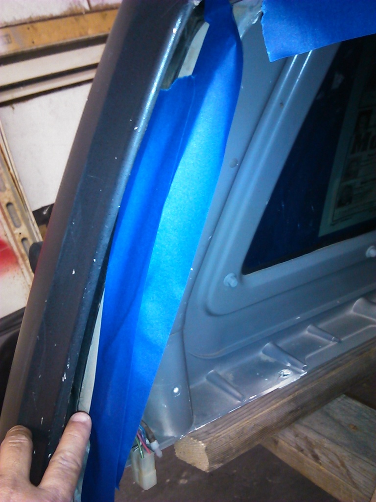

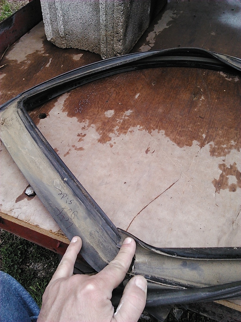

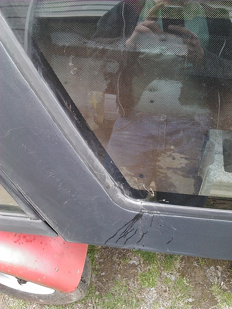

Just to avoid getting overspray on the seal and to eliminate some masking, I remove the rear window glass rubber. You can see how dirty they get. Also in one of the previous post above, I show what I use to lubricate the rubber seal. This one too needs a good soaking in silicone spray. It puts a lot of friction on the motor. This one is dry and rough. I will give it a good cleaning and lubricate it up when I install it back. It is easy to remove and install. I do mark which side it goes and direction but it is easy to figure it out.

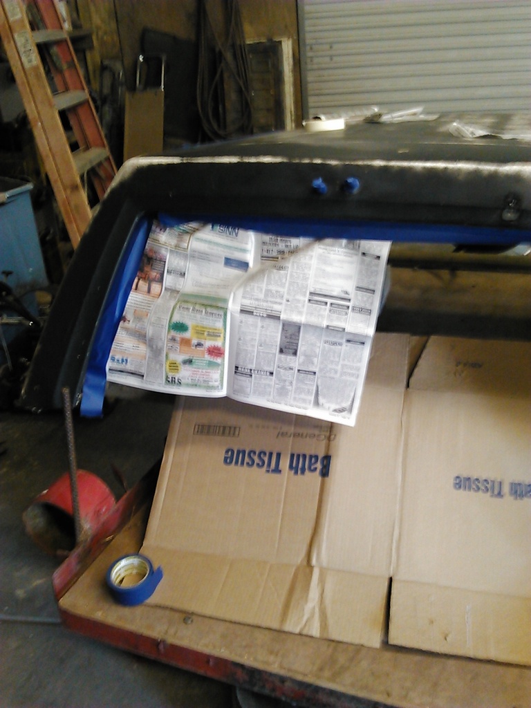

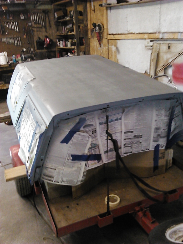

I mask to the inside so as to get good coverage. I will cover up where my finger is but just showing how I mask.
Just starting to get it masked. I also use cardboard on the back side for support.
On the front I do the same thing. I am going to paint the hidden to the body color as well. You can see in the corners there is black. It looks like Toyota did not spend a whole lot of time of getting things crisp and clear. I am trying to clean it up a little and make it look a little more professional. Cant be worse then what it is.
I use a wet cloth with a ounce or so of thinner to degrease. It finally got some of the dead paint off.

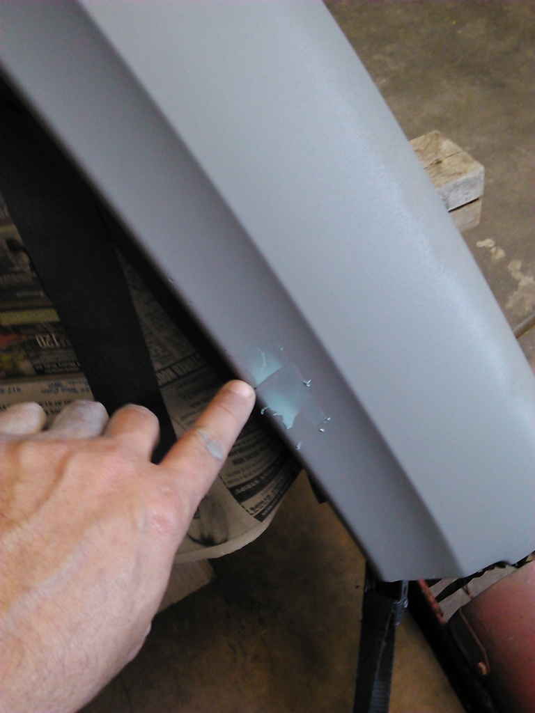

Here it is in sealer. Some do not care to use sealer. I suggest it. It would take several coats of paint to cover the black. I put on a light coat sealer that probably had 50% coverage and then went with a second coat to cover everything.
One thing I like about sealer is that it gives you a chance to fix some issues. The half moon where my finger is needs fixed. Just a scratch. The rest is excess filler that I will clean off. I will touch up that area and then hit it with some primer and get it painted here in a few minutes. By the time I get the scratch fixed, the sealer should be dry enough to paint.

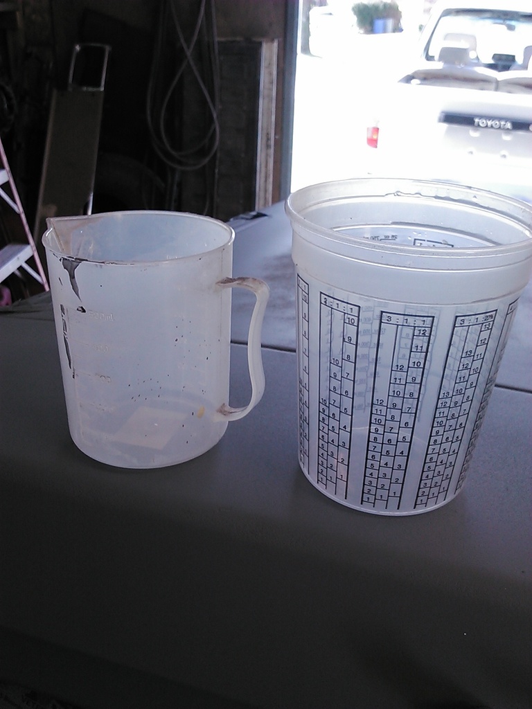

My dumb butt cant figure out all the lines on a mixing cup. You have so many different ratios such as 1:1, 2;1, 3:1... I have been showed several times and still get confused so I use regular mixing cups. A 3:1 is 900/300 to me, I can understand the so much easier. The clear coat is 4:1 so 400/100 on this.

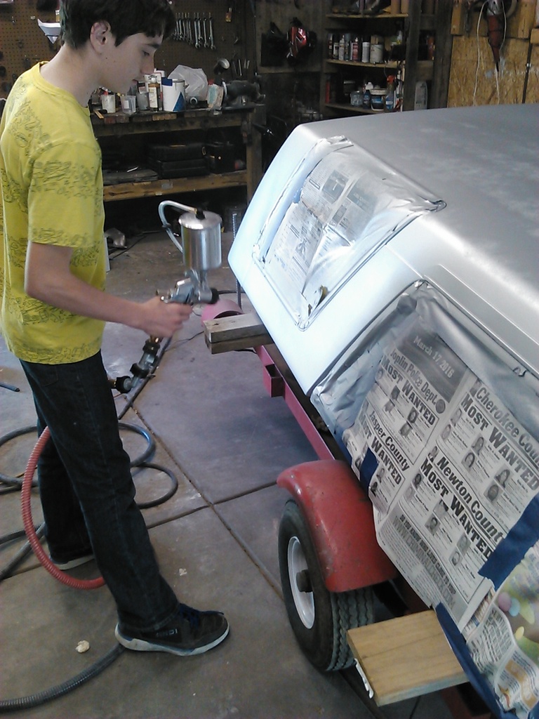

It did not take long for Mr. Justin to come along and say he liked black tops better. It did not take me long to tell him I thought he was nuts. lol I am sure Misty dropped him on his head when he was an infant, but she wont admit to it. I let him spray some clear coat on the side and he did pretty good. I had him to practice on some card board and to get the idea of when to pull the trigger and to let off.
He has sprayed primer many times but that is easily fixed. I was a little nervous letting him to do the side but he did a great job. He has rattle canned many of his bicycles and other things and when he got done, he admitted that running a paint gun and all the motions involved was tougher then he thought. I was not brave enough to let him do the top as keeping the hose up and the strength in his arms would probably wear out before he got it done. Painting horizontal surfaces can get to your arm quick.
