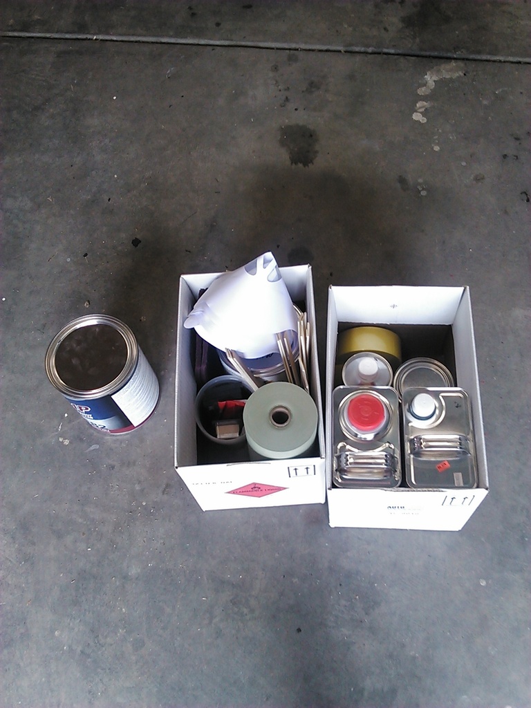

I had some extra time built up and took a week off to get some things done around here. One of them is to get the runner painted. Today and tomorrow will be trying to get some of the final body work done and ready for paint. Tomorrow will be mostly getting the shop cleaned up so as I can paint in it. Cleaning the shop and getting the dust blown out and ready to paint is a big job in itself. It would be so nice to have a dedicated paint booth but that is just the way it goes.
Saturday is when I plan on painting. I will have a friend coming over that used to run his own body shop and is going to show me what I need to do to get clear coat to lay down nice and smooth. Clear coat is the one layer I have problems with. I have never run paint, but I have run clear coat. Another problem I have had with clear coat is that it will either lay down nice and smooth or get orange peel in it and that takes a lot of sanding to get the clear smooth. So much nicer when it goes down smooth.
My friend is getting a blower or something new that is supposed to be at his house on Friday. He says it heats or dries the air before getting to the paint gun. He says it makes painting a lot nicer. I will have to wait and see what it is and does and will try and get pictures when we paint.
Saturday will be paint day if all goes as planned and then next week will be getting everything back together and checked out. It wont take long for me to get things together but the little details and checks will take some time.
Here is the paint and a few things that will be needed.

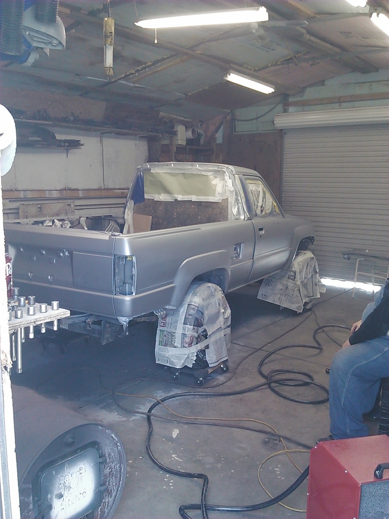

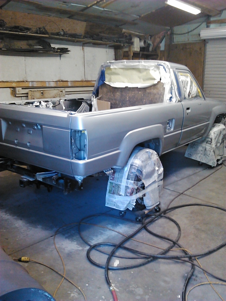

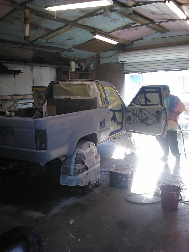

I had to move all the things I don't want to get overspray on so threw it in the back of the 85 for now. I am sure some might think it is just a bunch of old worthless parts but there is plenty there. SR5 cloth panels. 3 great dash pads, and several other things.

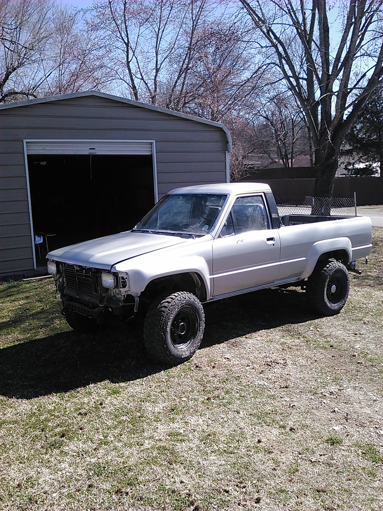

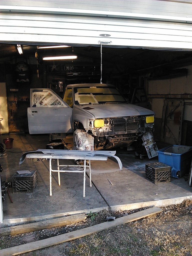

Was wanting to get it painted Saturday and after 12 hours in the shop, we were beat. A guy I work with and his brother came to help get it painted and wanted to test their new spray assembly. Here it is masked off waiting to get it painted on Sunday.

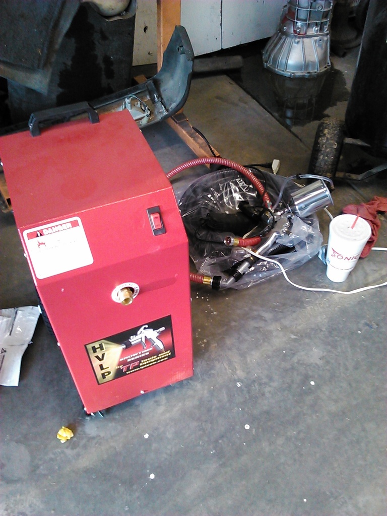

Here is the spray assembly. It is all self contained. It dries and warms the air before going to the spray gun that comes with it. A great little system.

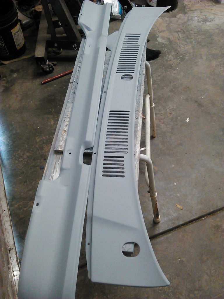

Primered the cowl, gas tank cover and valance.

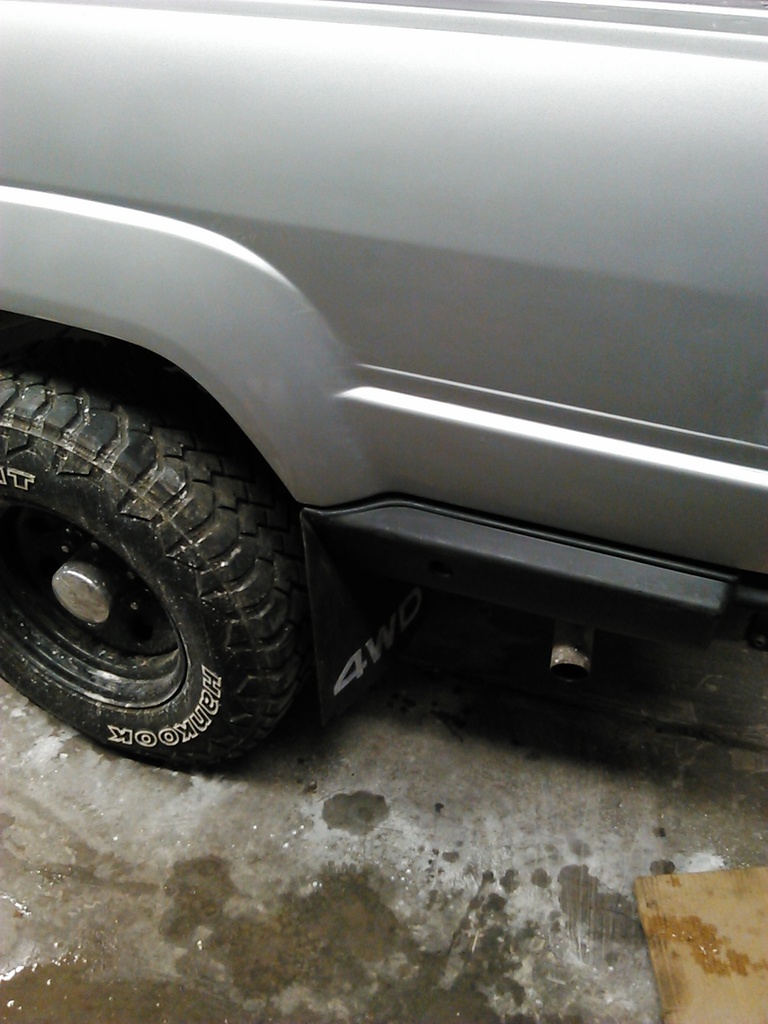

Painted the jams.

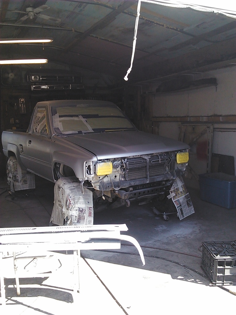

Here it is in base coat.

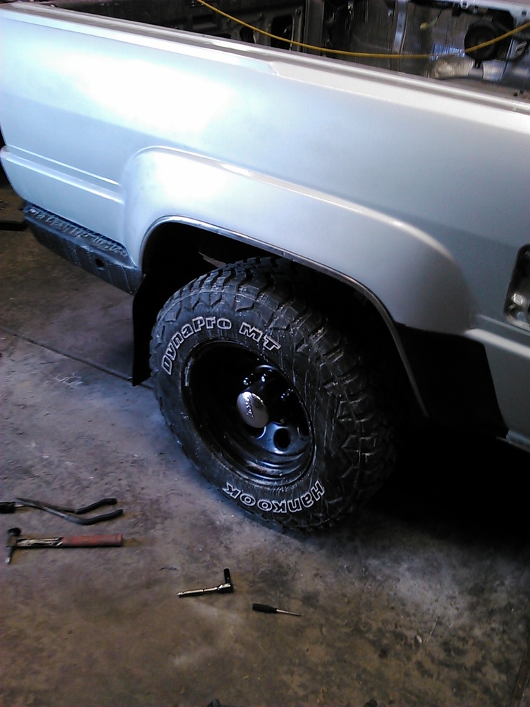

In clear coat.

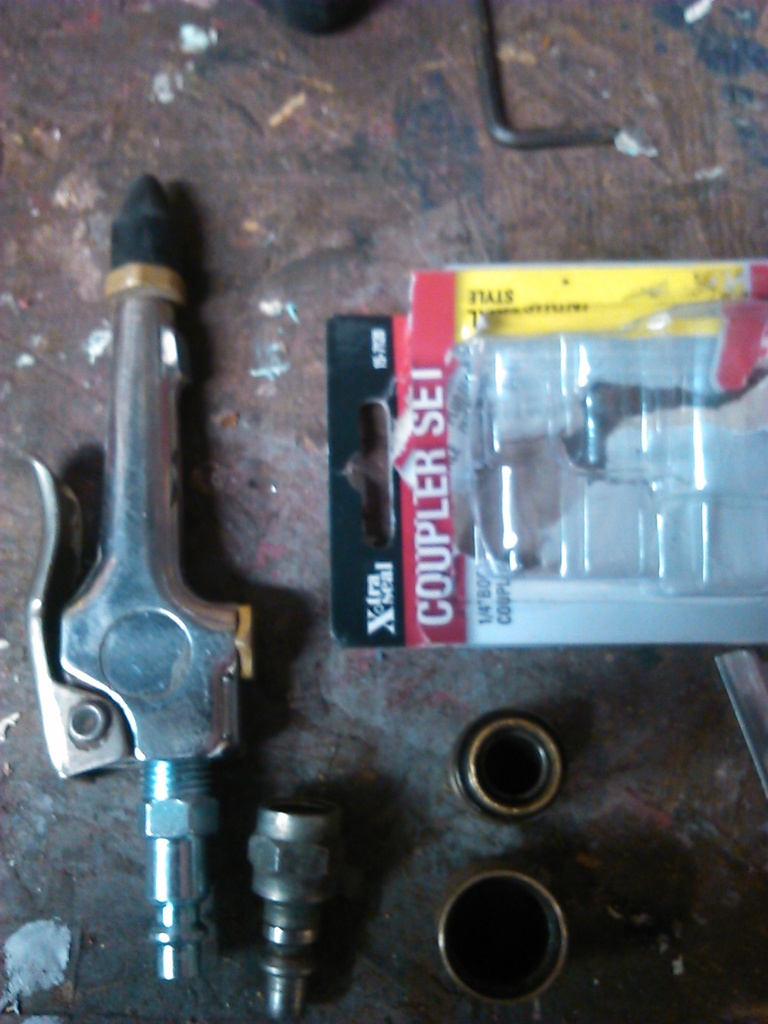

One of the delays I ran into yesterday is one of my coupler broke. I had some spare hoses and they were the other style connectors. I am going to convert all of my hose connections to this set up. Mostly a reminder for me for which one I want to go with.

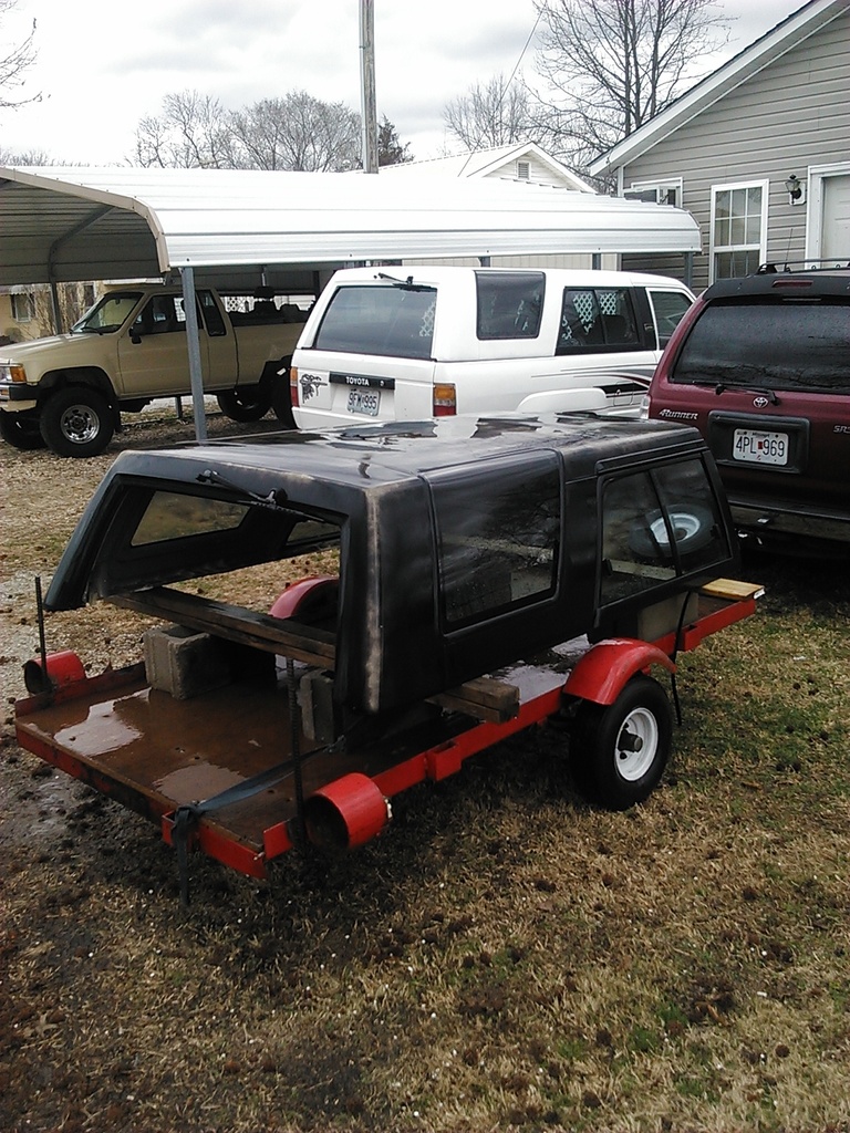

I did get the shop somewhat cleaned back up and let the runner sit outside and idle for quite a while to get rid of some of the old gas out of it.

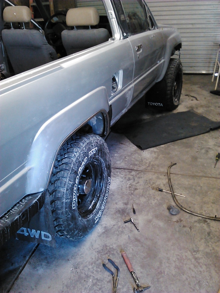

Got most of the drivers side color sanded and buffing it out. While waiting for my door clips to come in, I will start getting some of the other parts on and ready and try to keep this project moving. Will be painting trim to black. One of the rock guards has disappeared on me but am sure it will show up when I get some of the other parts out of the back of the 85.

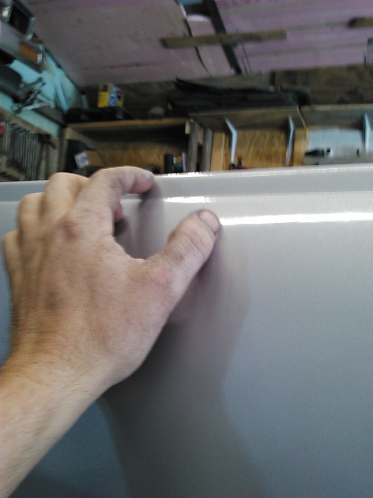

Several people are worried about painting. Getting the paint down is easy from my experience, it is the clear coat that can be the problem which is normal for having orange peel.
What I am trying to show is where my thumb is I have the clear worked down. Where my pointer finger is still some orange peel. It is on edges and that is where if you work it to much, you could burn thru. I will work with it a little more, but I would still rather have some orange peel then burning thru the paint and down to metal.
Getting one perfect like it was the day it left the factory is not easy to do. This is what should cause more concerns then painting. Factories have million dollar shop and paint booths to do their painting in. Just want to show my painting is not perfect and if you do your own truck, it may not be perfect but it will still be a lot better looking then most trucks you will see on the road out there. If it was perfect you would not want to drive it. I still moan and groan when I get a rock chip in mine, but if you are going to drive one every day, it is to be expected. A newly painted truck is also a magnet for shopping carts and is one reason I always park away from every body when out in town.

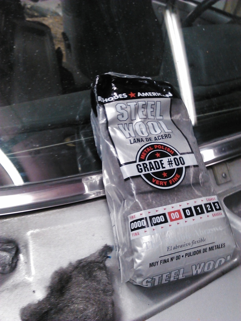

A friend of mine showed me using Grade #00 Steel Wool is great for polishing out chrome trim and used it on a spot on the side glass.

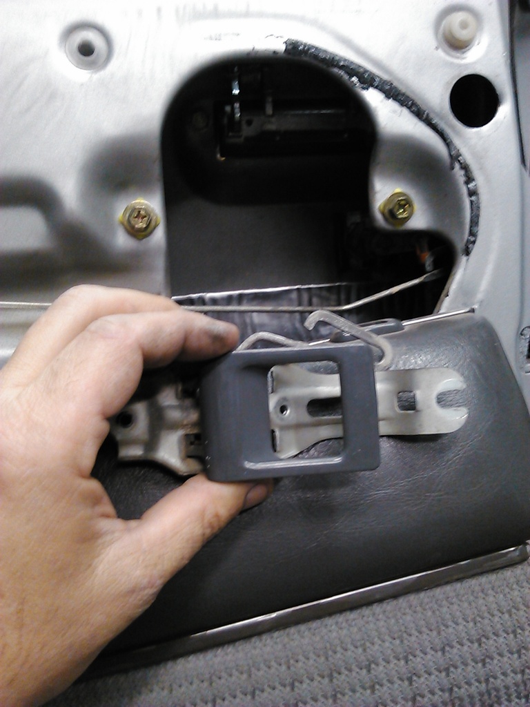

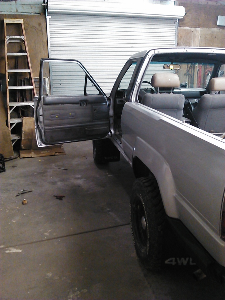

I had to run to Joplin to get my door hinge pieces that I pictured above. I checked an auto body parts store and they sell trim clips but not door clips. I will check ebay for some at a later time. The dealer had one package sealed and one not sealed. I left the dealership and got a few miles down the road and could not find it. Luckily I found it in the parking lot.
I store left and right parts in the door and another thing that can make reassembly easier at a later time.

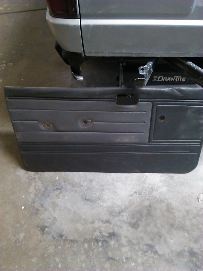

I am using SR5 door panels from a pickup for an upgrade. The only difference is a runner has a door latch release on the passenger side only and has a cut out for the door handle. I wont cut up and possibly ruin a hard to find door panel. I just removed the rear door handle. Only a true Toyota enthusiast is going to know that it is not correct.

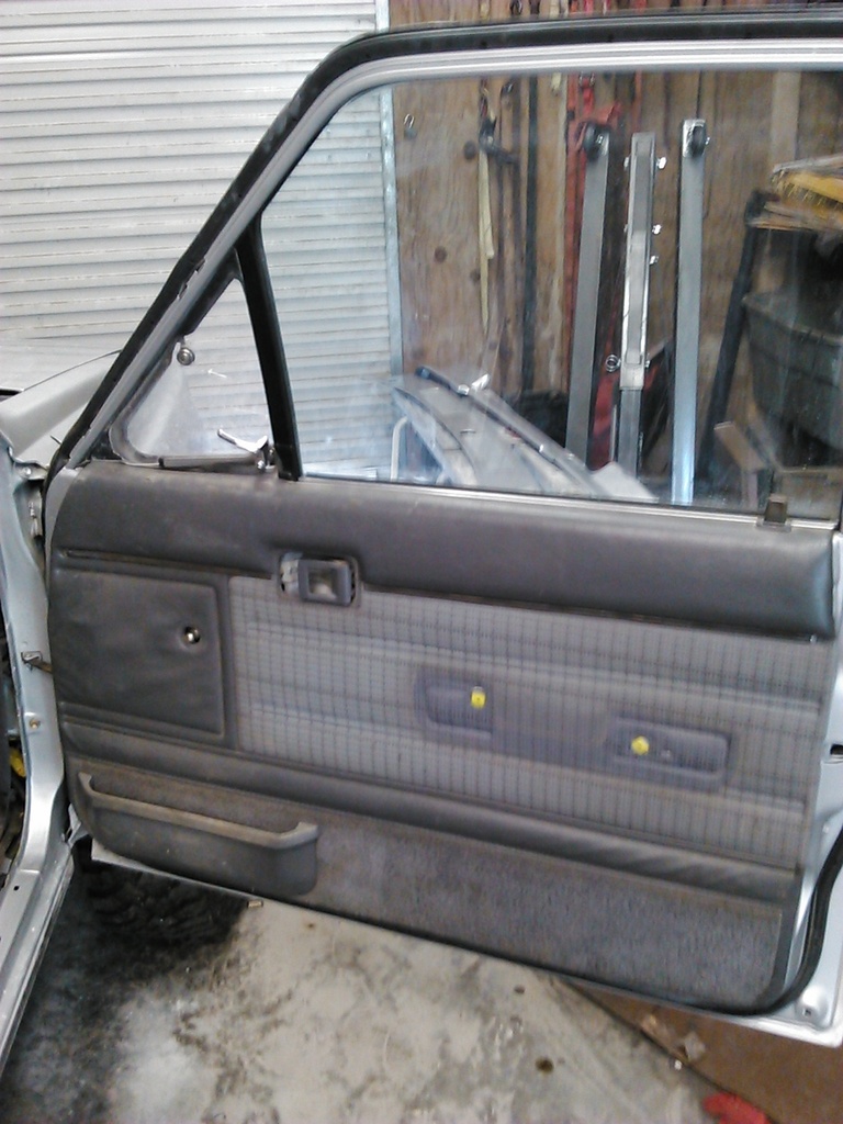

Here is the door panel on. I will give the panel a cleaning in a little while.

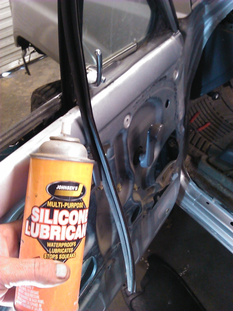

Getting the door panel on and while I was at it, I lubed up the window tracks and makes a big difference on the ease of the window rolling up.

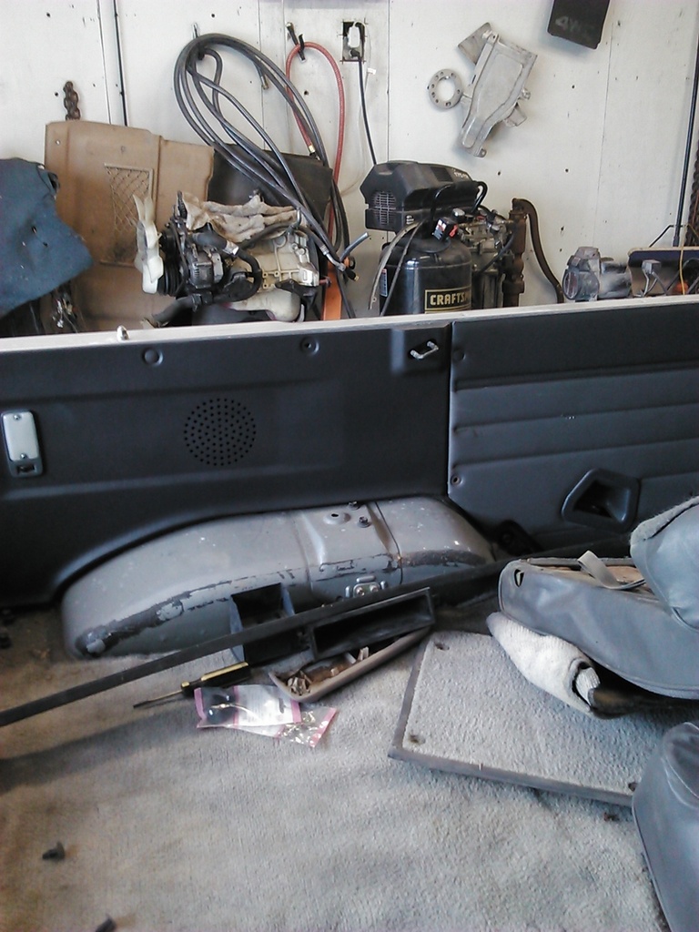

Some outside shots. I have the rear seats just in the back end. I need to get some interior paint for the rear panels.

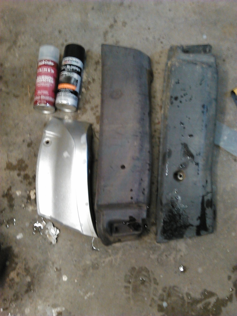

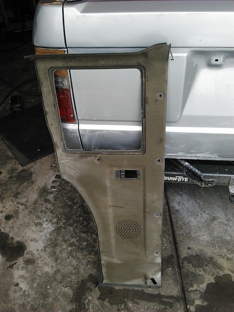

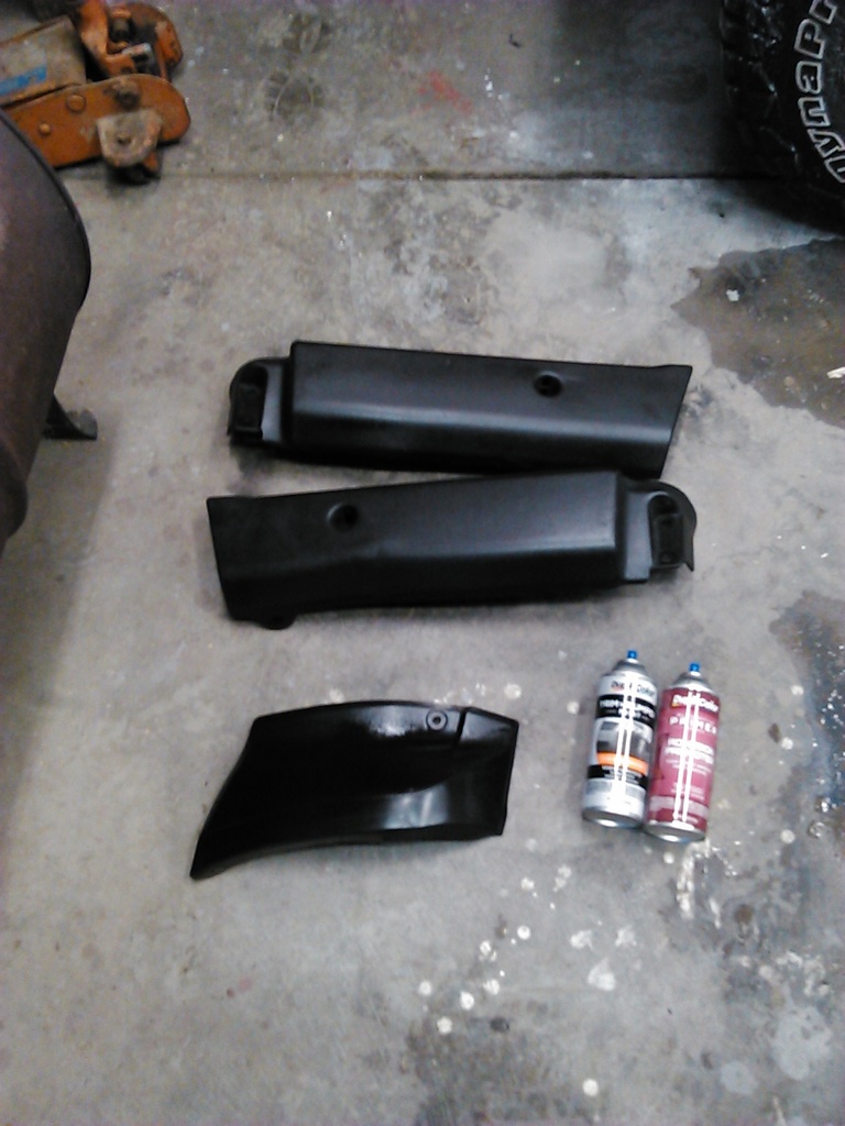

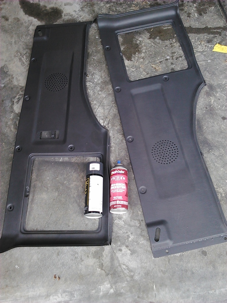

Starting on the interior. The rear panels have turned from gray to green which is what most look like.

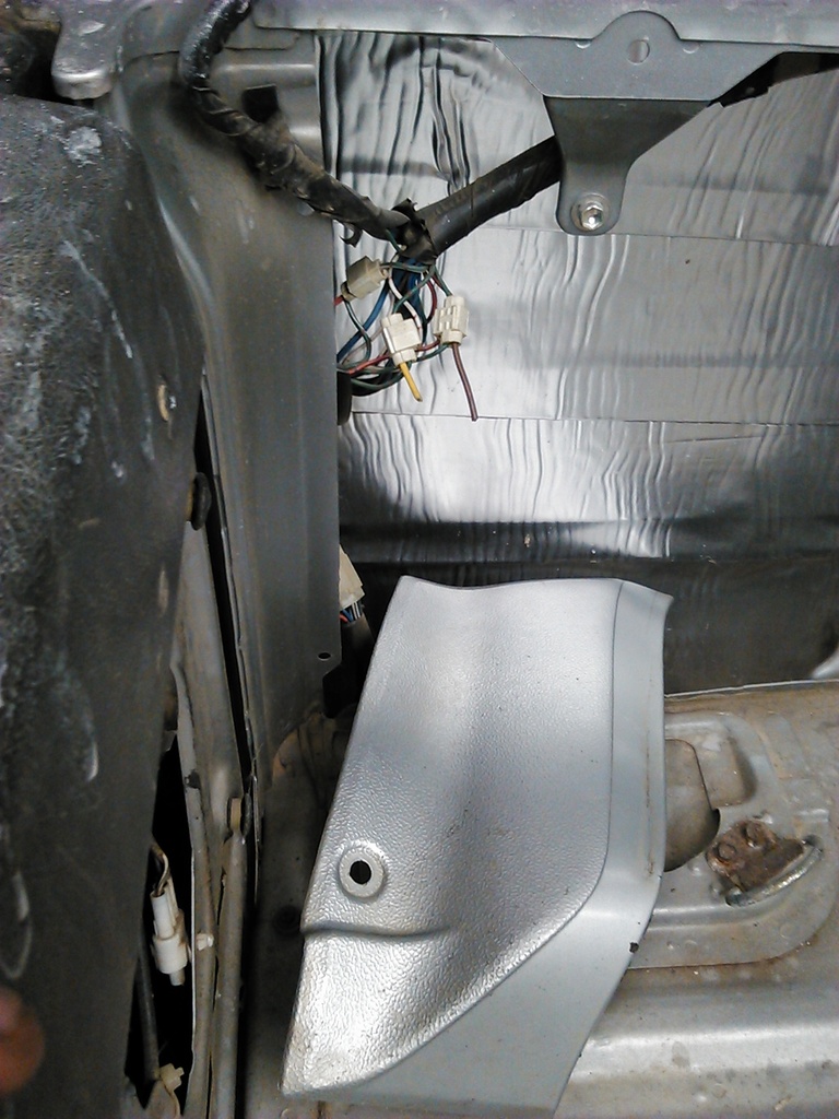

Got them painted.

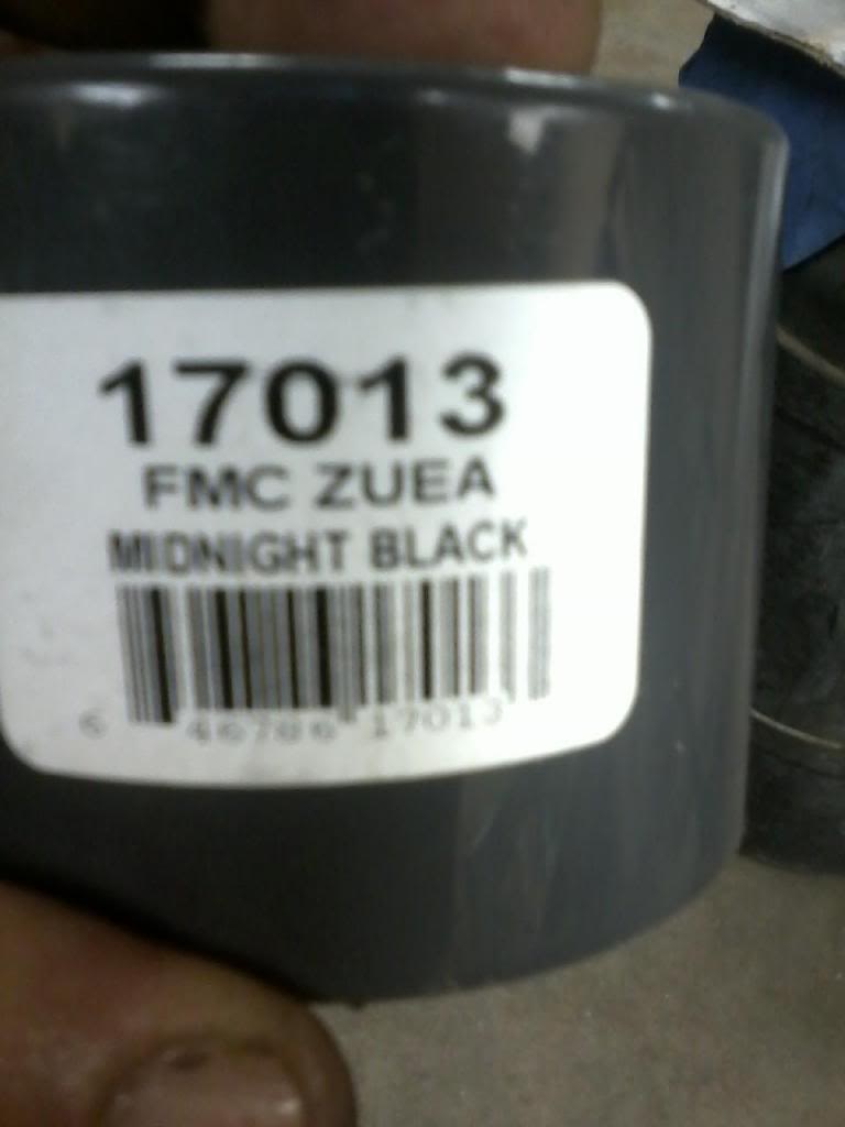

I got them installed. Not a perfect match but far better then what it was. I use a SEM interior paint which is close.

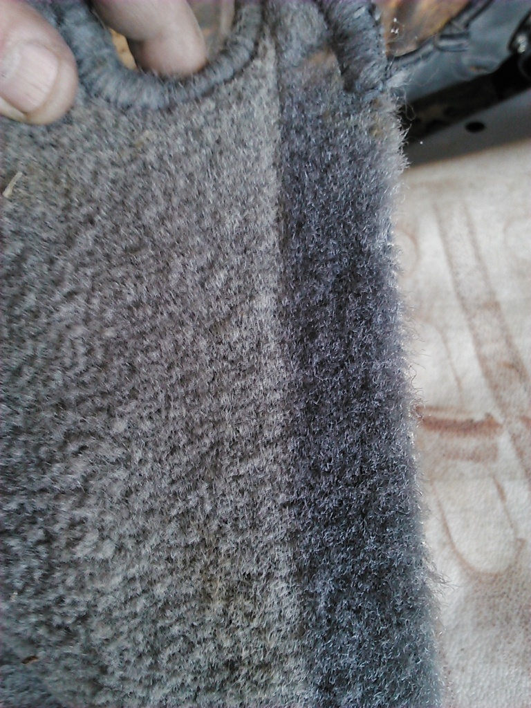

I washed the carpet and it still has a ton of sand in it. I did shrink on me so I will be replacing the carpet with a remnant from a local carpet store. Here you can see how much it faded.
