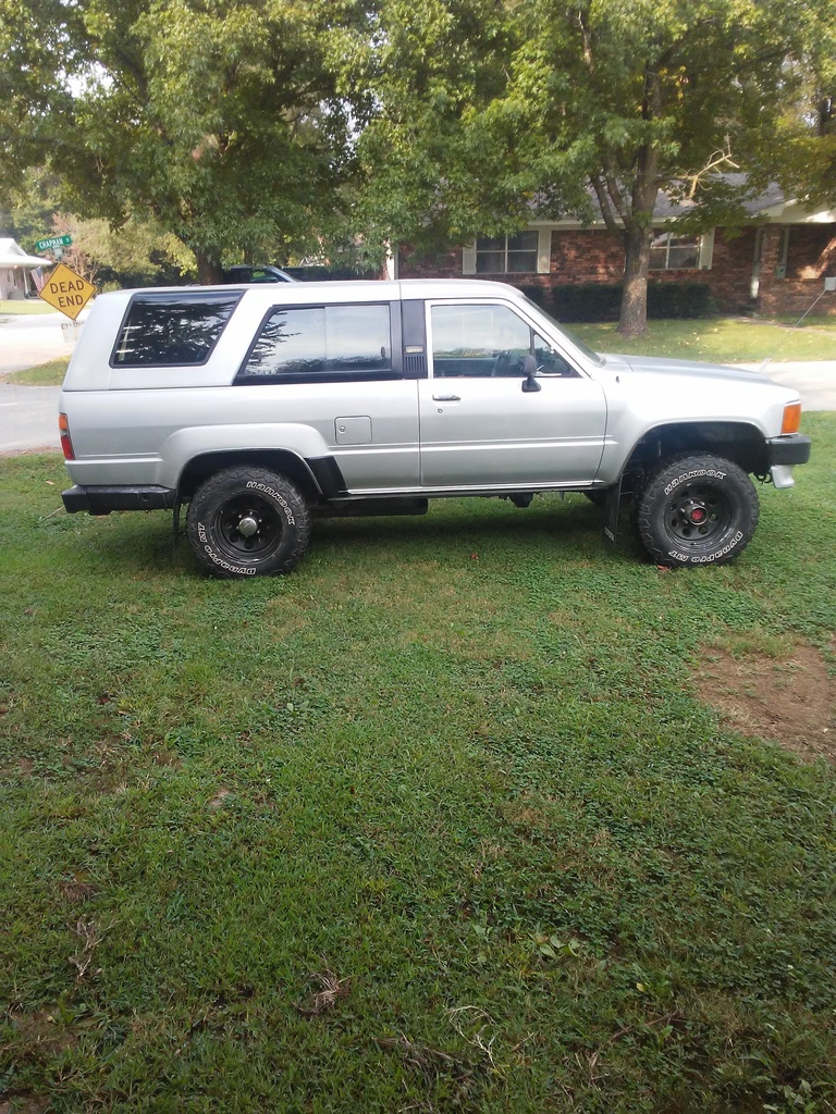

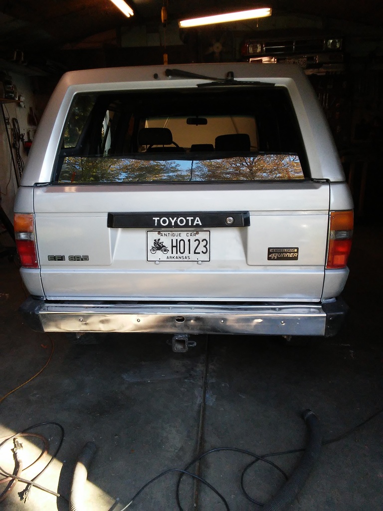

The other day it was raining hard but wanted to get a picture of what it looks like with the ZUK mod.
Before.

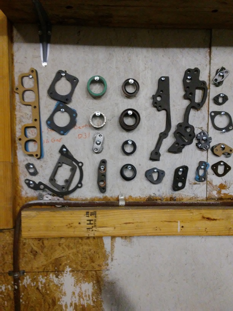

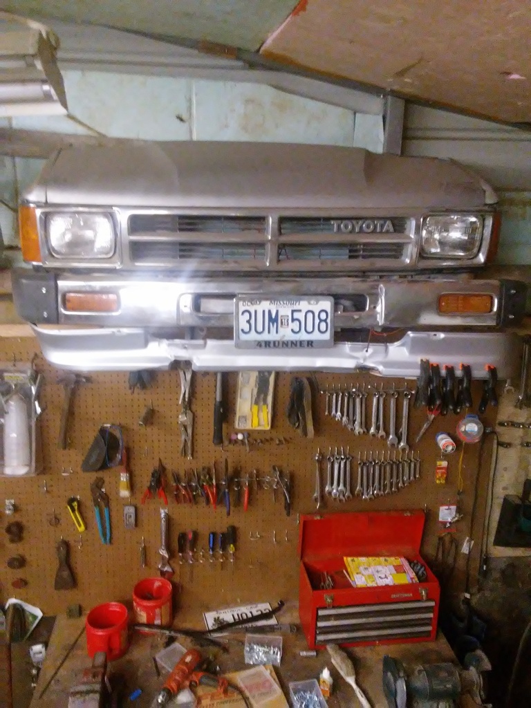

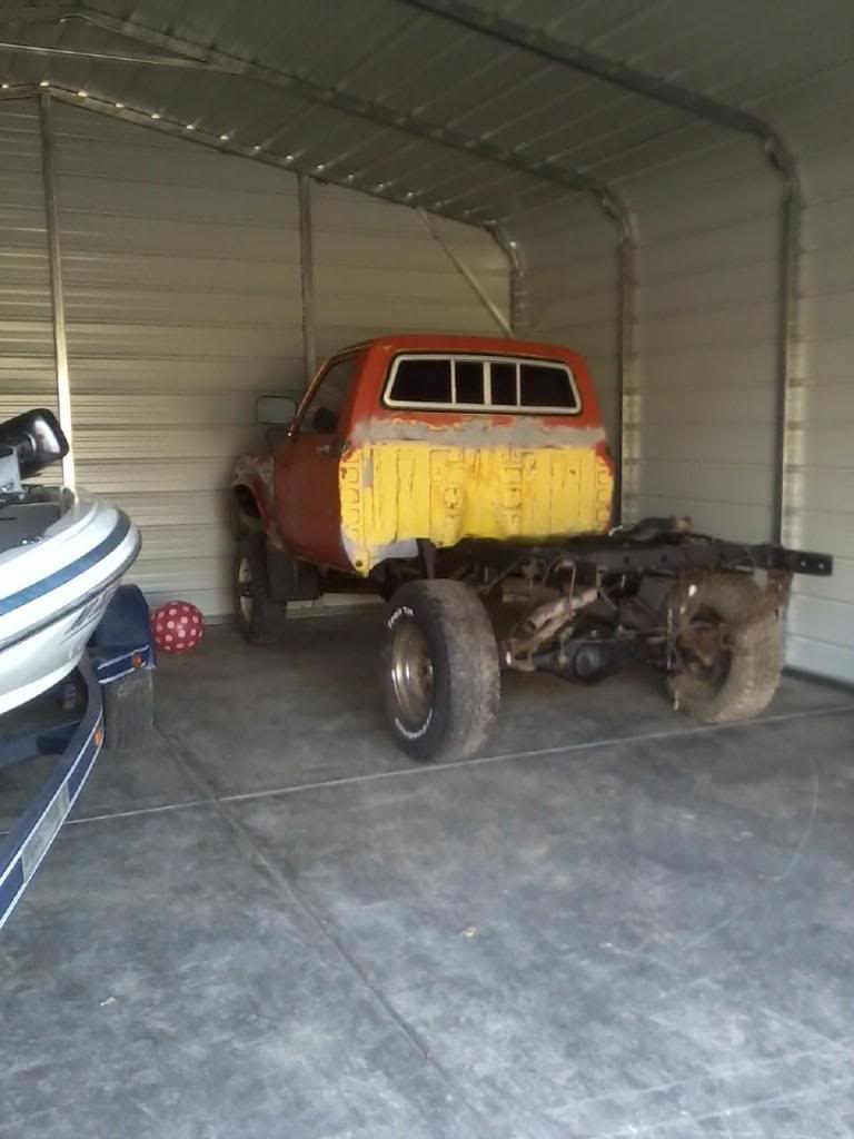

With the runner getting a Timing Chain installed. I decided to do some organizing as I do have a busy winter planned. This summer was to hot and I am starting to like winter when I am in the shop. I can get it warm in there with the stove and it has to be in the single digits for it to get to cold to work in there. I had 3 tote bins for the tear down of the runner and just have 1 left to get all of the final pieces on. Nothing major, probably a days worth of detail work.
I plan on flipping a 2 wheel drive 86 standard cab when this runner is out of here. It has some front end damage on it and if it doesnt have any frame damage, I will fix it. Still have not gotten my 76 Super Cab home just yet. Hope to get it next week. I want to pull the motor, transmission, and fuel tanks and start going thru them. The 88 Runner is getting carbed just as soon as she gets around to getting a Webber for it. Once those things are done, I plan on pulling the red 87 runner in and start tearing it down and getting it cleaned up and back together. Spending time in the shop is starting to make my pants fit again. They were either shrinking or I was putting on the weight. I am looking forward to some cold days and I can spend a week in the shop for one of my vacations this year.
All of the pieces on the front end is made up of junk parts. I need one more bracket for the valance and will get one eventually. I got the valance in a little better shape and painted it, got a passenger marker light and the end caps. Eventually I will take the assembly down and install a bench light and might try and make the head lights work with the flip of a switch.

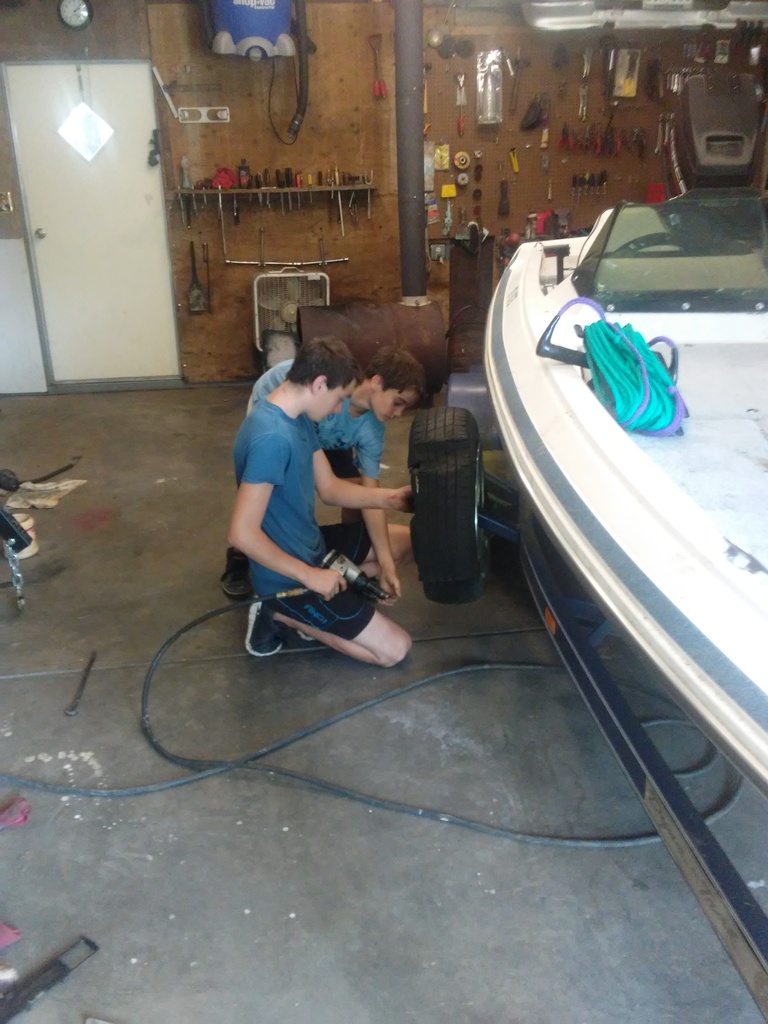

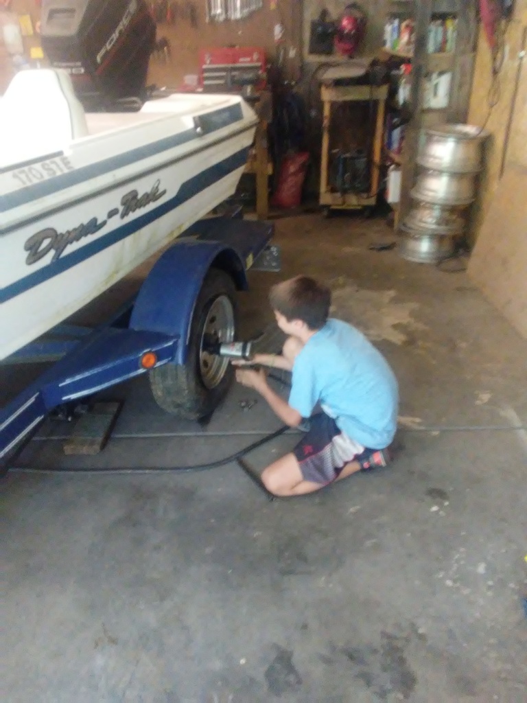

While the runner is getting a Timing Chain in it, I had to swap out some tires on the boat. For trailer tires, I like to get a set that are half tread. Not to be cheap, which is part of a reason but the biggest reason is so that they don't sling rocks like a new tire will with lots of tread. Even with fenders on a trailer, they can still sling one pretty good at times. Hope that might give some thing to consider when buying trailer tires.
Getting the boat in the shop and being able to use a jack on concrete is so much nicer then trying to get a jack to move around on the grass or gravel. Anytime the brats get a chance to run an air tool, they are on it quick. Which was fine with me as changing a tire was not at the top of my excitement list. It does get them involved with using air tools. I am slowly getting more air wrenches built up and want to start getting them involved in other things.
Hunter doing one tire.
Justin doing the spare and other tire.

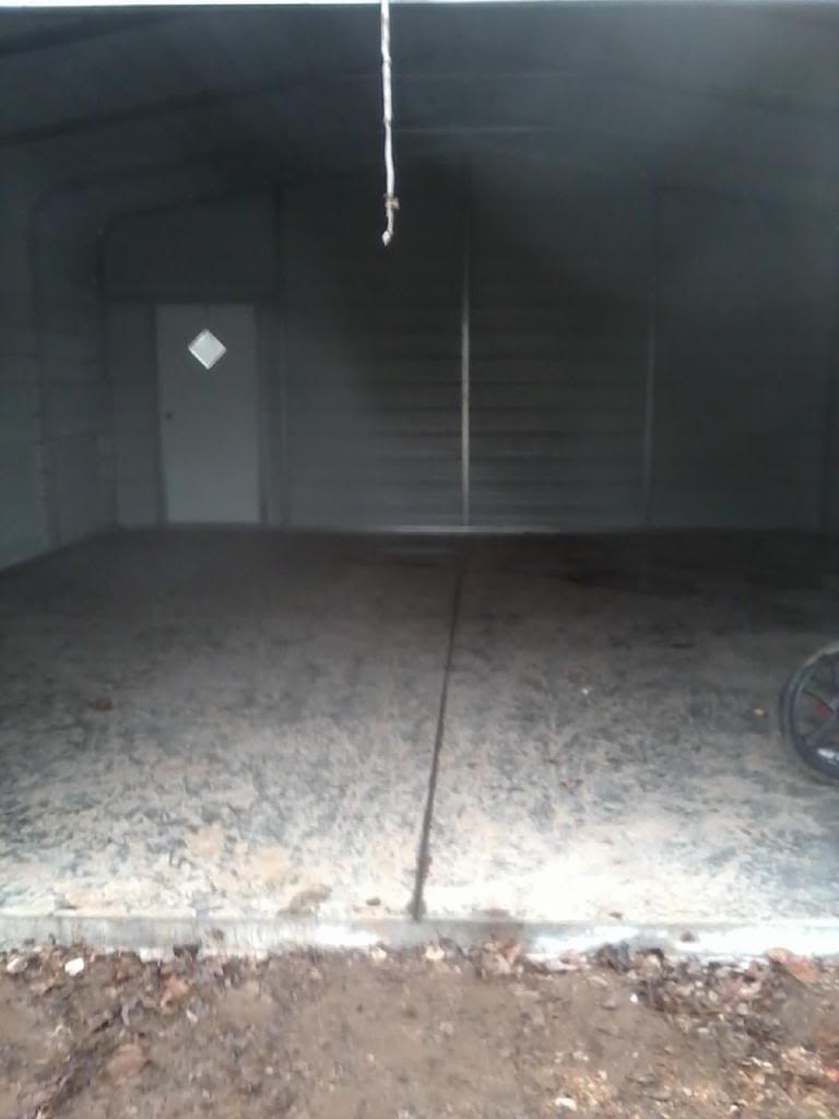

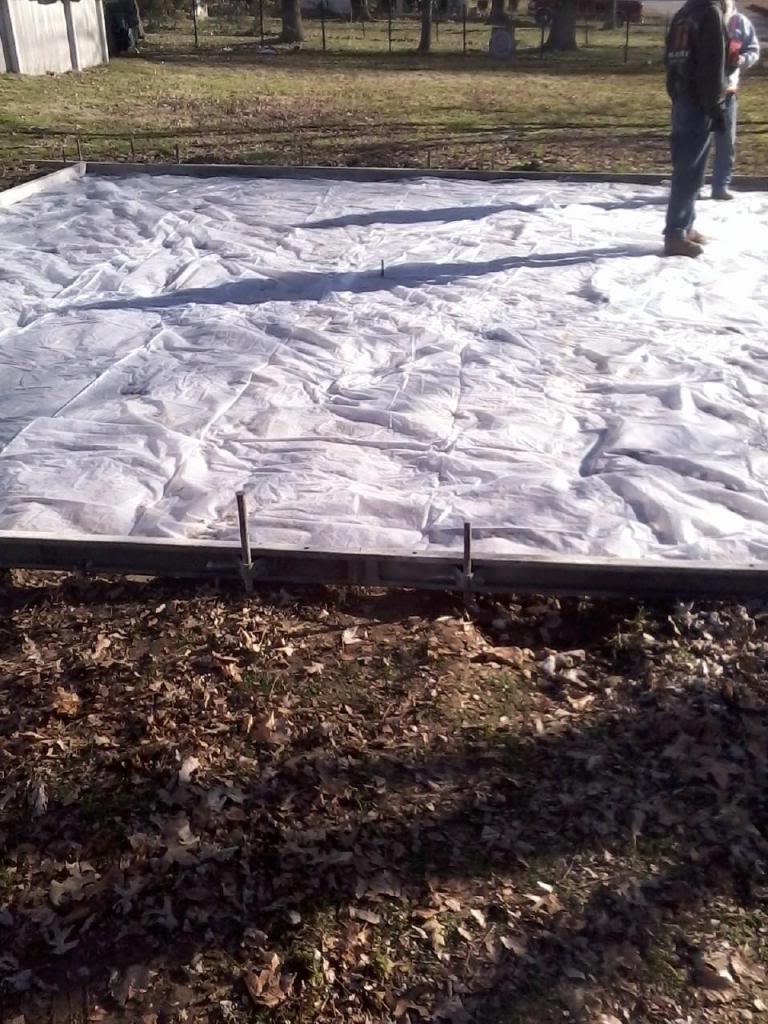

I am going to make this my shop experience post and will be adding a lot more information as I get some pictures. Things I wish I had known of.

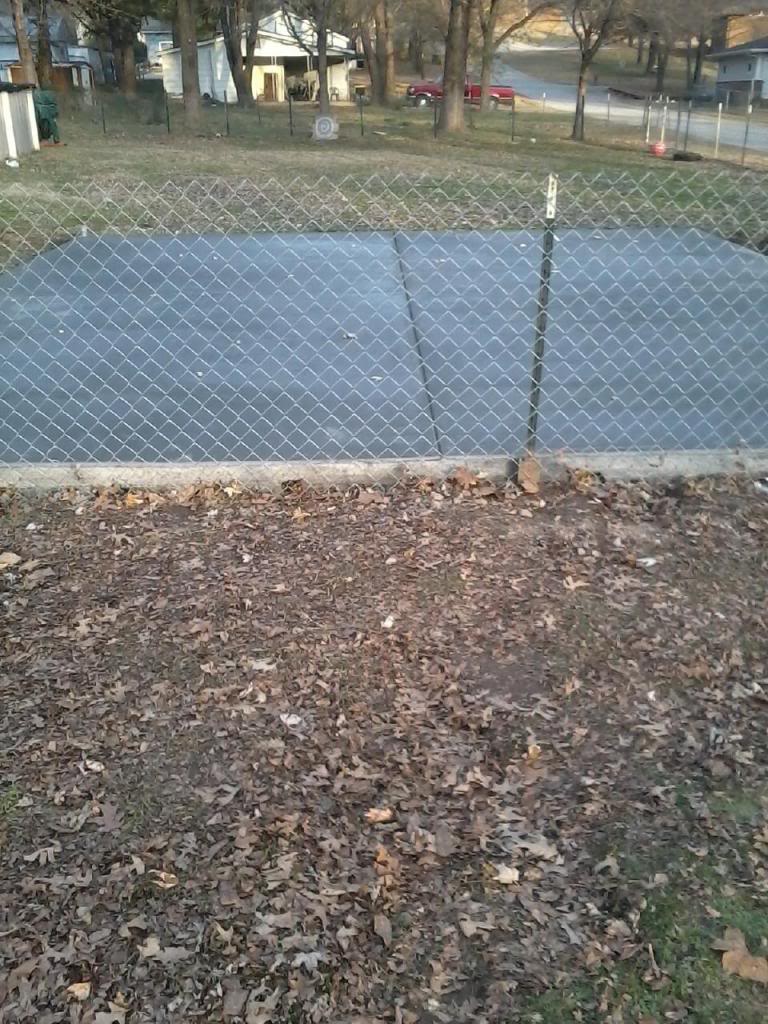

My brother was in construction and saved me on this little bit of information. When having a shop delivered as I did. You have to get the concrete poured in advanced. Getting concrete poured in my area does not happen over night if you are hiring it to be poured and layed out professionally. I would suggest having someone doing concrete to do it as it has to be spread and they can figure out how much to order. I was not going to get mine poured for another month but the guy called me late one night and said he could be out the next morning. I jumped on it so as not to have to wait another month.
They were just going to pour it and it would of set up in about 4 hours and been done. My brother said to put plastic down so that the concrete would sry slower and be less brittle. That slowed the cure time down to about 12 hours. I did not have enough time to get rebar or any wire mesh down with such little notice. Wish I would of known of that ahead of time. Put down plastic and rebar if you have the chance.

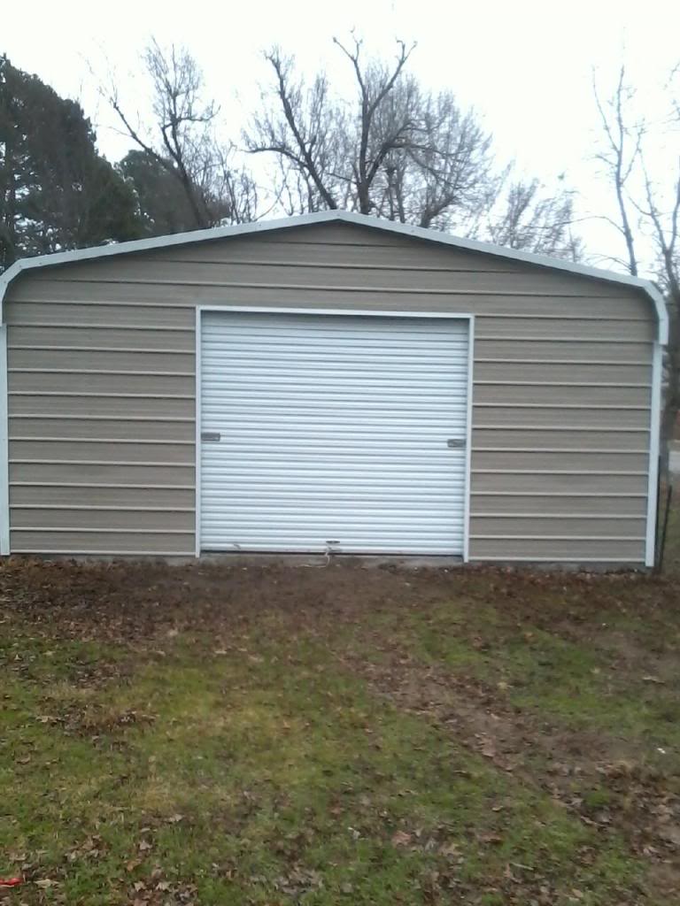

I got my shop from Carolina Carports. They wait until they have several orders in your area and then ship them all at once on the same truck. I am very happy with my shop but if I was doing it again, I might would of had a shop built from my local hardware store. It was about $200 more but I thought a metal building would be better. Looking back, I would of not made that the only reason. Carolina Carports uses odd ball distance from their metal supports, which in my opinion is so that you have to buy their products to finish the interior. When having a shop built, I would suggest having an extra 3 feet on one end or the side to allow for work bench, air tank, tool chest... as they all eat up floor space real quick. My shop is a two car shop. I wish I had went with a 2 1/2 size shop to allow for the space needed for work bench, tool chest and things like that. Another consideration I had not thought of. After working in the yard, I was just happy with concrete to work on.

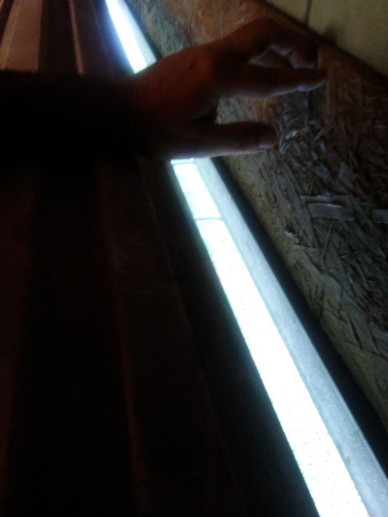

Do NOT get the roll up door. I thought I would not want the rails for the standard garage door hanging over my head. WRONG!!! The over head rails would not be a problem. A standard garage door seals all the way around and is insulated. A roll up door is not insulated and has a bid gap at the top to allow for the door to be one big roll. I will get some pictures later on and you will see why the roll up door is a bad design in my opinion. Something I wish I had known of. I would never get a roll up door again. You will see why at a later post.

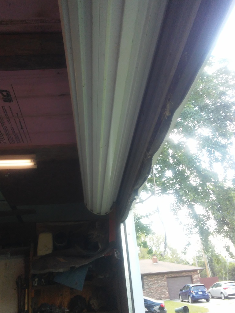

Here is about a 6 inch gap between the door being down and the wall. It is a big draft area. I have a piece of plywood that lays on top and cuts the drafts down but wish I would of went with the standard garage door.
Here is the door rolled up. No way of insulating it. I do have a piece of rubber mat that will help when I put the door down but it does not cover it all.

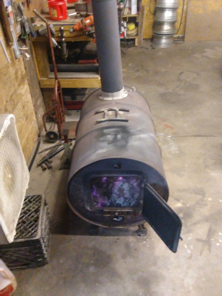

Great heat source. Wood heat will have my shop warm in about 1/2 hour. I start a fire and go back in and have a cup of coffee and by then it is usually warm enough for me. Dollar General provides plenty of card board for me to start my fires. I just buy a rick of wood from some one locally and a rick will usually last me the winter. I got my Barrel Stove kit from Orschliens. Instead of running the stove pipe straight up for better draft flow, I run a long section up high enough for the smoke to get momentum and then curve to the side. This prevents any roof leaks.

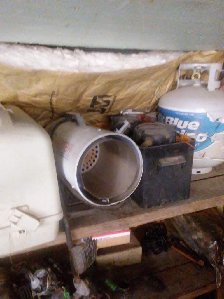

I have used a kerosene Torpedo heater in the past. Kerosene is expensive and wont last long. I used red diesel in it instead and it was cheaper and did not put out any fumes. Red diesel is tax free or about 30 cents cheaper but worked just as good as kerosene.
Here is a propane Torpedo heater. It worked all right but since getting the stove, I have never used it.

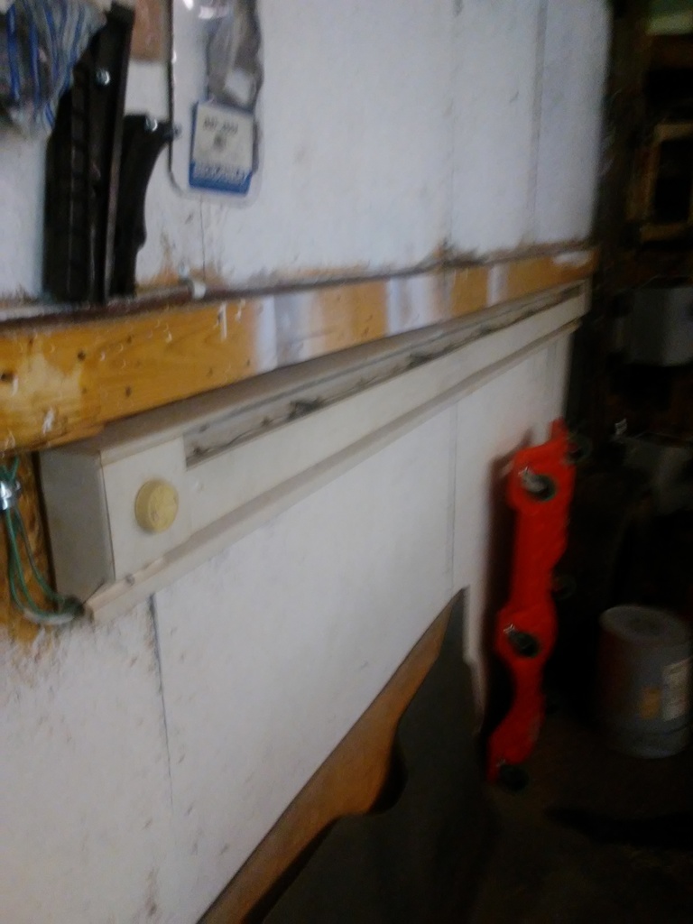

220 Volt heater. Works but is too expensive to use. I will be removing it in the future.

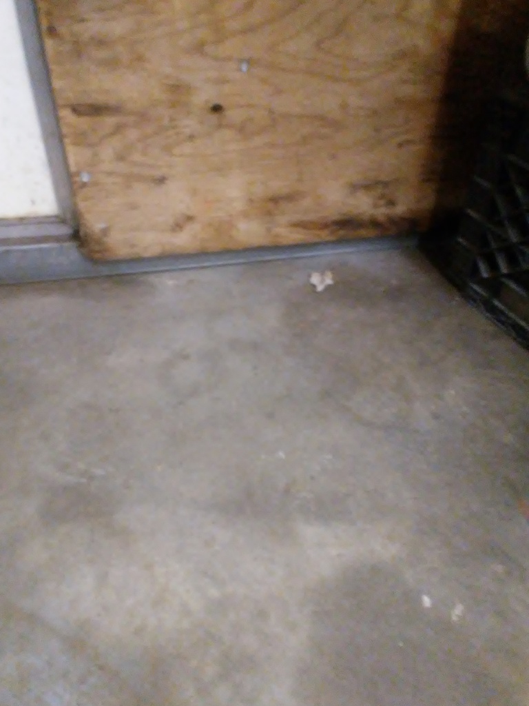

I left a 2 inch gap between the floor and the wall so as I can wash the shop out and have plenty of water on the floor when painting.

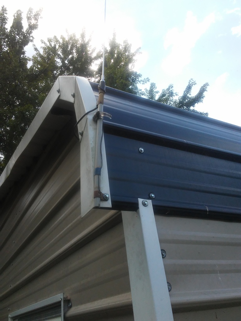

I can only get about 2 channels for my radio inside. Here I am temporarily using a Toyota antenna. Will work on this at a later time. Metal buildings dont do well for reception.

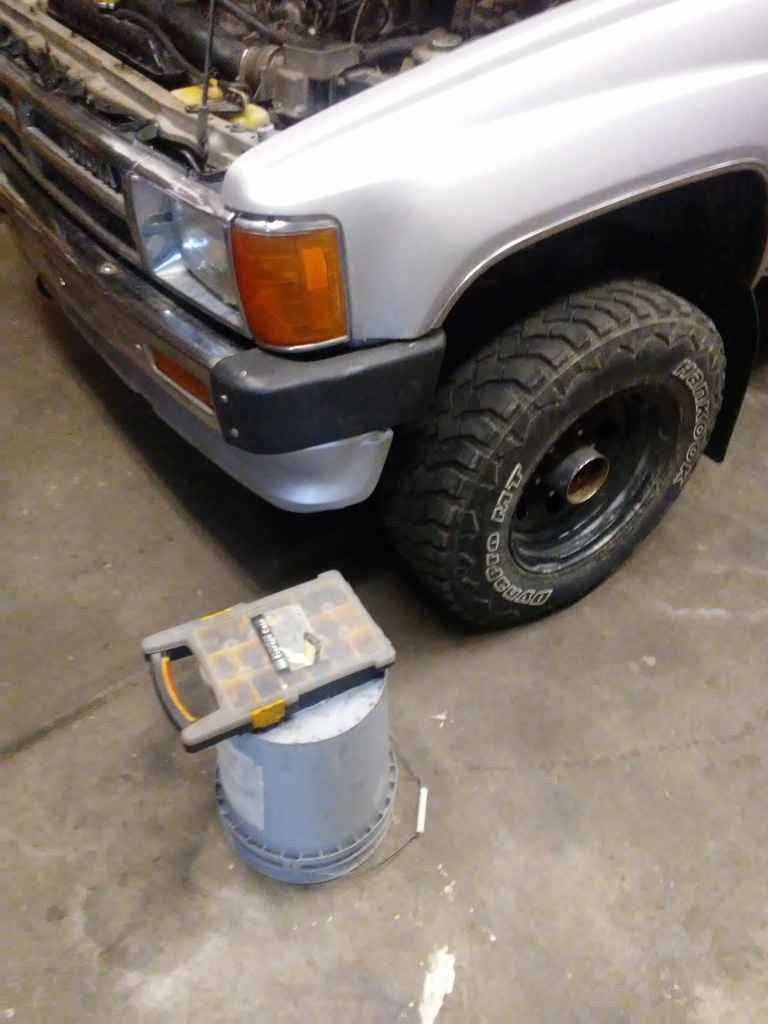

I found a better lens for the drivers side and got it installed. I always put nuts, bolts, and screws back in their places when tearing one down. I also keep a HF case for the odd ball pieces. I went and could not get the lens to go in. After looking into why it would not screw in. I seen I had left the screws in their place. I also have a bad habit of grabbing one of my cases that I know that has the pieces in it and taking the hardware out of them.
Screws installed, Doh!!!
Lens installed and cases I use. Harbor Freight cases I use and in different pictures of my shop, you can see I have bins mounted on the walls for nuts and bolts. Each time I am at the yards, I always grab extra nuts and bolts. I have a 5 gallon bucket that still need sorted but they would not fit into the bins. One time Jason was out here and I gave him a 1 or 2 gallon container of nuts and bolts and he did not realize how handy they are until he had them. If you are doing a major tear down, it is really worth the extra time to grab them when you can.

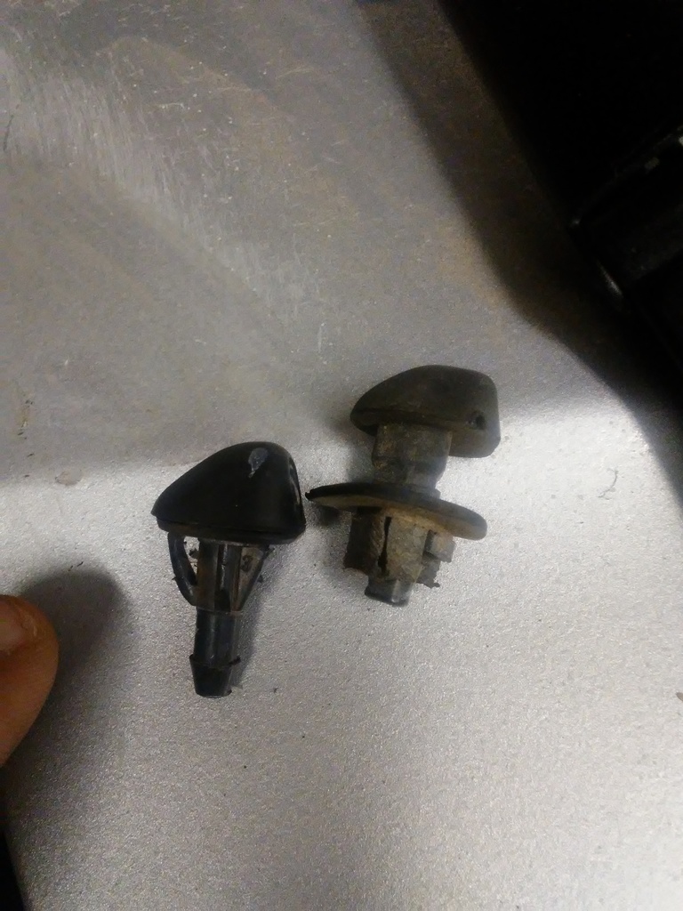

There are two styles of wind shield washer nozzles. The one on the left is the one that I prefer. It just has a squeeze tab. They are interchangeable. The one on the right uses a skirt to hold it in and I have never gotten them to stay in when I have removed them. When in the bone yards, I try to get the ones on the left when possible.
A quick reminder for me how to remove them. The tab faces toward the front of the truck.

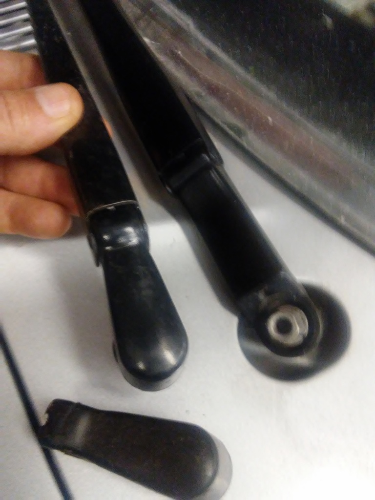

I knew about the two different styles of wiper arms but actually forgot until I went to put on the covers for the bolts. Some use a flat cover and most are missing. The other style is the ones I like better as the covers can not blow off. I will see if I can find some flat covers or get the other style wiper arm.

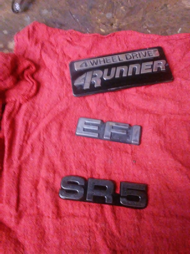

Been doing the finer things to get this truck wrapped up as it going home on the 19th. Several things fixed on it and see if I can recall what all was done. Timing Chain, dent in floor board,transmissions (2), paint and body work, repaired some butchered wiring, tachometer, fixed wing glass, inclineometer, cloth door panels, better rear bumper, cleaned intake system out,dome lights, zuk mod, cleaned ventilation system out,sound deadening, and sure there are some other things that I have missed out on.
I have worked on many of these trucks and this is just some of the things that most of these trucks need. Steering, suspension, ac, motor work, exhaust, brake work, windshield, door sills is still needed on most trucks. When I see someone says they find a truck for x amount of dollars and wonder what all is needed, hope this build will show just some of the work that is needed.

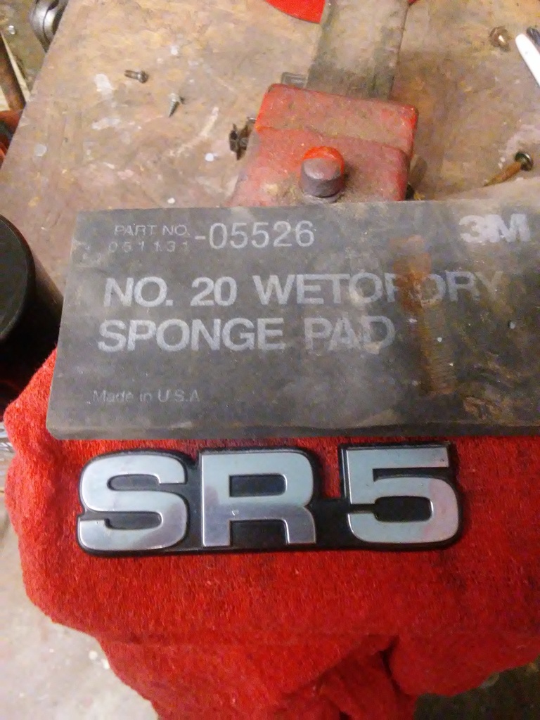

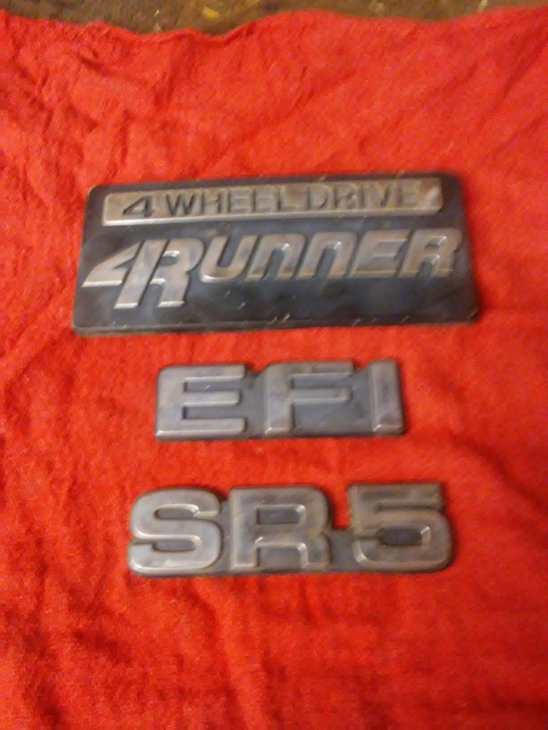

Dull Badges.
Here I took and cleaned the badges and. Put a light coating of black trim paint on.
I took a sanding pad, wrapped it with a shop cloth and while the paint was still tacky, I scrubbed the paint off of the chrome.

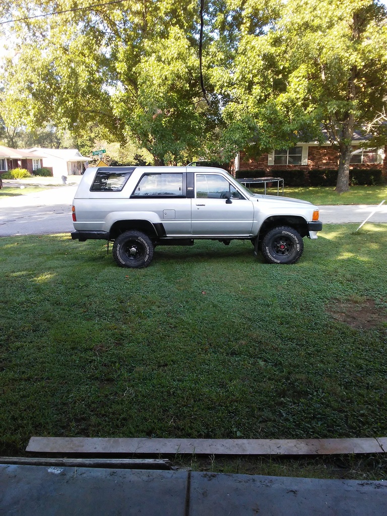

Later today I am going to go buy a 86 two wheel drive pick up 22r. It will just be a fix and sell. Not sure when I will get it home as I want to get Mistys runner out of the shop before I bring it home.
What it currently looks like now.
