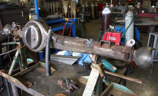

My journey has begun. I have pondered an SAS for a long time. The axle I have was out of a neighbors 83 pu, when I lived in NH. So it has moved a lot in 10 years. Now that I can weld I am diving in, plus I finally saved enough. So here goes.
Truck 1988 PU 4 cyl 22r-e, as it sits now, 3' rancho lift F&R
281,952 K miles, 33/10.5/15 BFG's. Although i will keep the 33's for a bit longer I am thinking of going to 5.29's in anticipation of eventual 35's, we will see. My SAS is a 3 incher. 5' shackles in the rear should keep it level.Name:  TRUCKRED-1_zpsd36963cd.jpg

More pics obviously to come.

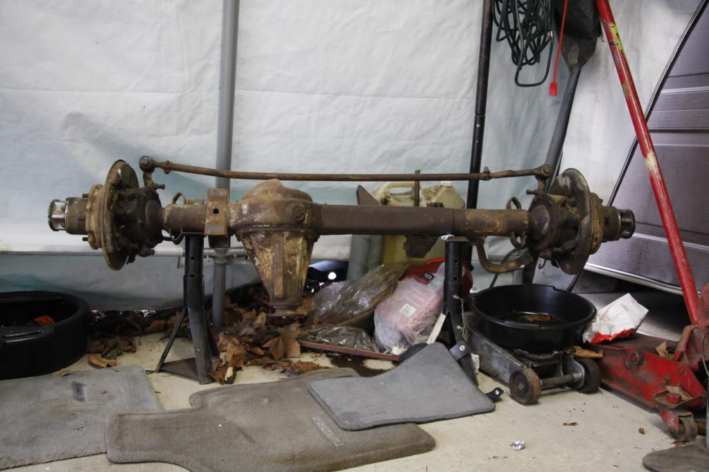

I guess I could post the few that I have so far.Name:  _MG_2918-1.jpg
2 years ago.

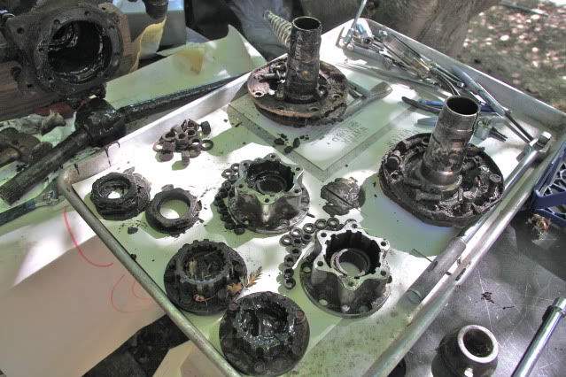

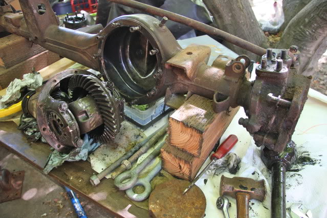

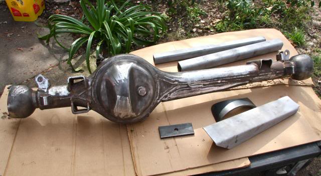

Last few days.
Dang cone washers

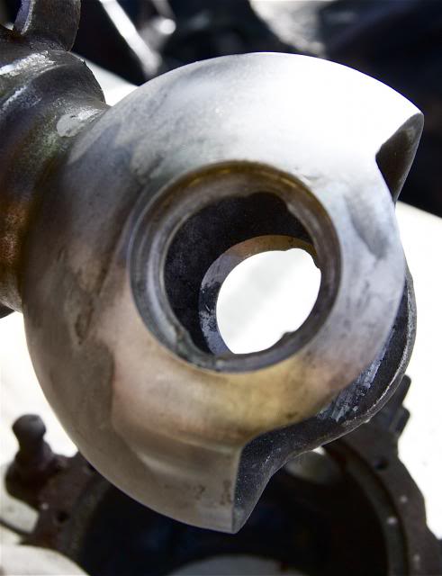

A little cutting and grinding.Name:  IMG_1587_zps44b1f830.jpg
And tube for the front axle being pondered

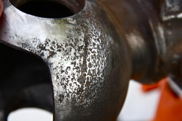

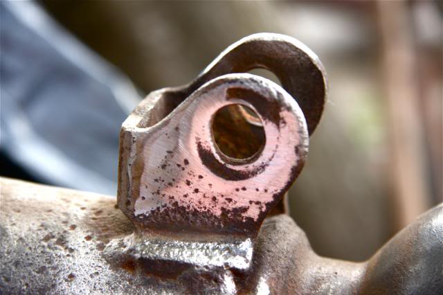

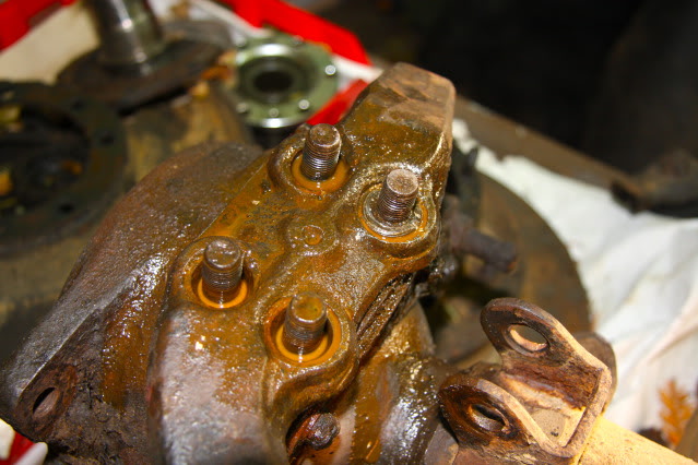

Looks like I need to replace the shock mounts. Looks like say the creeper knuckle ball gusset kit. The Knuckle pitting I think I will use jb weld and then super smooth then paint? We will see.Name:  IMG_1588_zps4fbb0a2a.jpg
Old Mar 15, 2013 | 05:49 PM
Teuf's Avatar
Posts: 5,592
Likes: 24
From: Dixon, Ca
Or I could TIG in some washers to the outside of the mounts. We will see.

Not sure if you think you'd need it, but there's also Marlin's knuckle gusset kit
http://www.marlincrawler.com/axle/fr...kle-gusset-kit
I went with it just so I wouldn't need to weld more on my axle if I started doing more extreme wheeling and went hydro assist later.

Thanks, That gusset kit I have seen. That goes over my budget a tad. I may and try to fab something up instead.

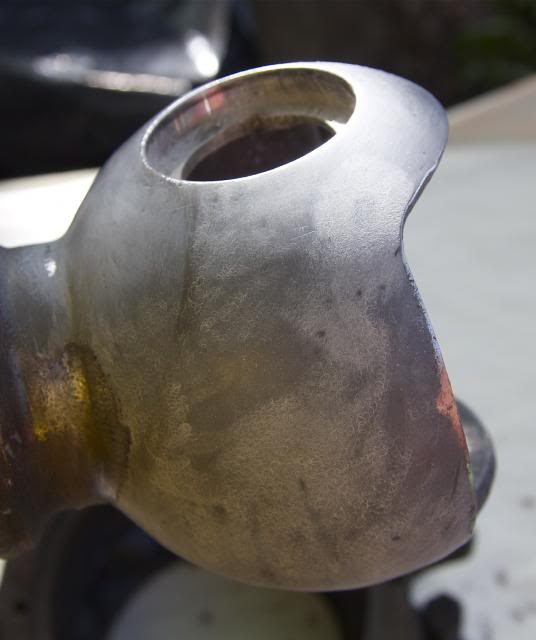

The truck they came from had been damaged in a fire. The carcass sat in a field for about 3 years, then I traded a dead cherokee for the remains / the axle is what i wanted.
A little JB weld yesterday afternoon

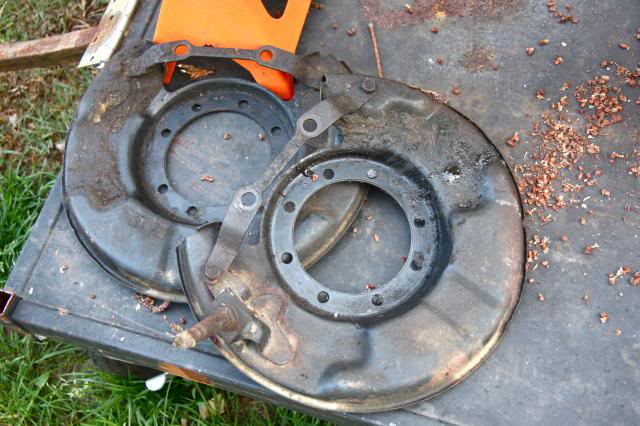

I am cutting down the dust shield for the ring only.

This afternoon it will be 24 hour cure time for the JB weld. I will finish the surface at that time.

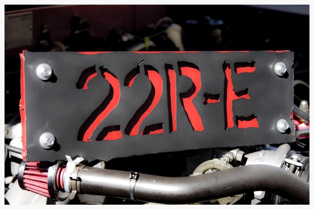

And as a gift to my truck I made a little plaque for her. Not sure where to put it.

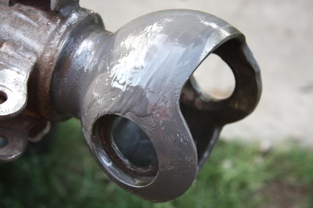

Looking smoother.
