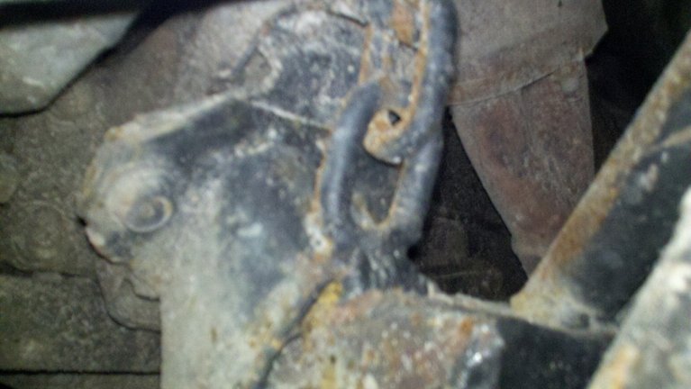

I did some dual cases with twin stick and a hand throttle . This was a GOOD add on

Well I thought to myself ,What could a tired 22re motor need ? Yep, a set of 35" boggers

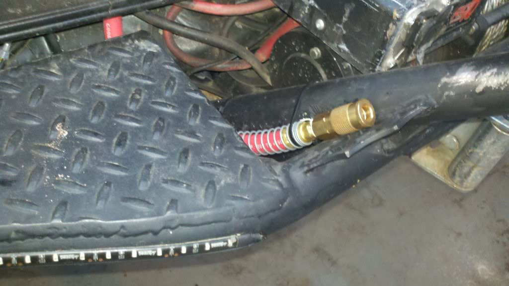

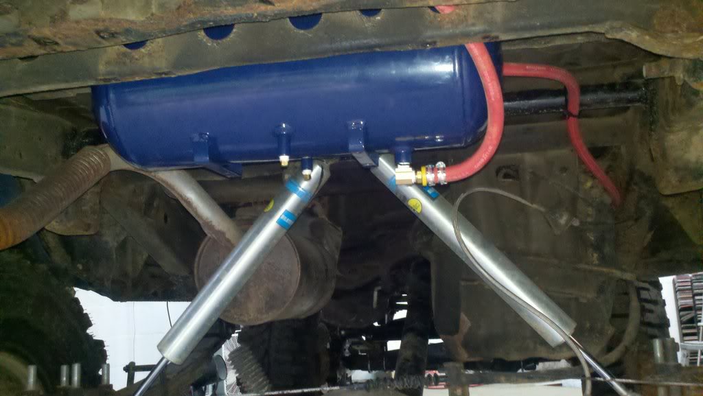

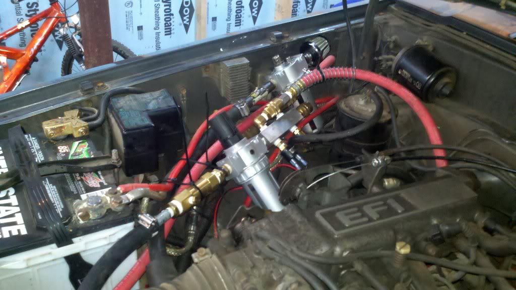

I added a on board air system for airing down
Baby air tank!
Rear outlet
Front outlet

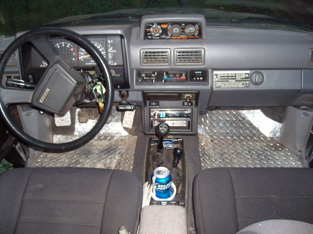

Did some cool diamond plate floor mats

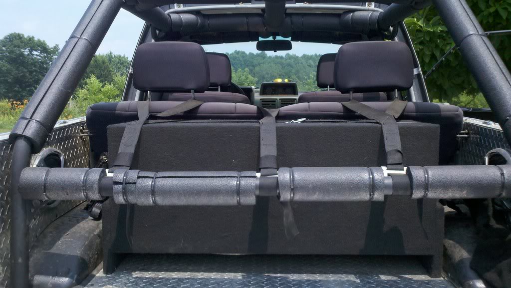

I bought a 4x innovations cage kit in dom and had a better welder than me burn the welds . I did tack them
seat belts for the kiddo's

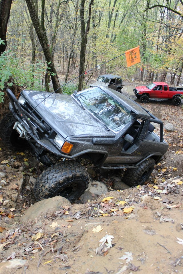

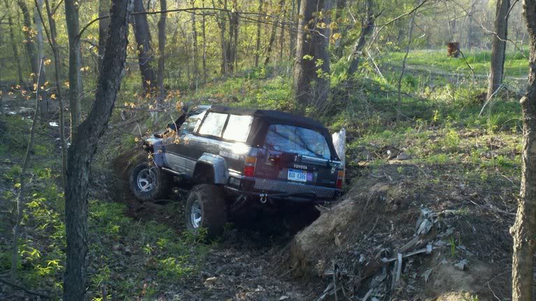

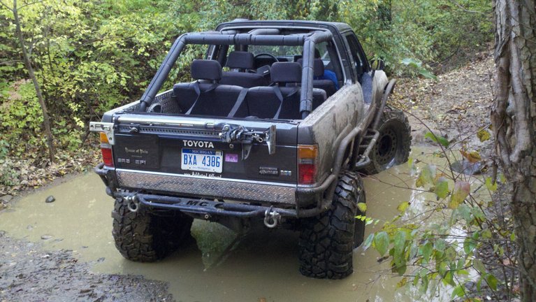

I did manage to get it stuck every once in a while!

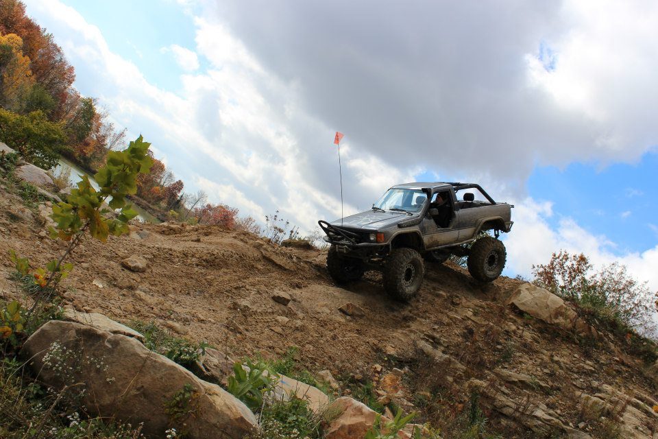

Most of the time it rocked!

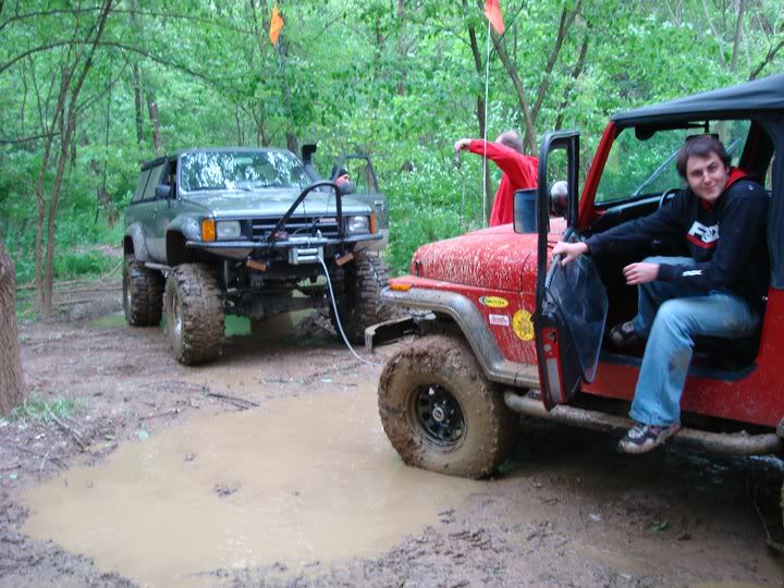

I even helped a Jeep out!

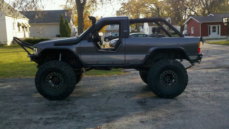

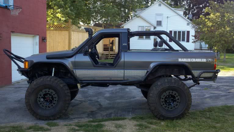

I wanted new shoes for it so I went big ! 39.5 Pitbull Rockers
They needed some beadlocks so I went with Trailworthy Fab recentered H1's. By the way these are the cheese!!!!! I can air down to 0psi if I want. I cut the living daylights out of the fender areas and firewall and finished it off . I also added some tubing to the fender areas for added protection.

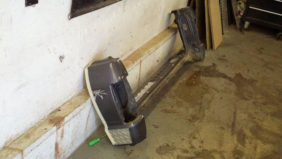

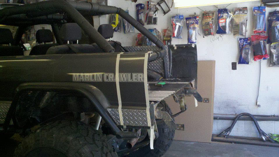

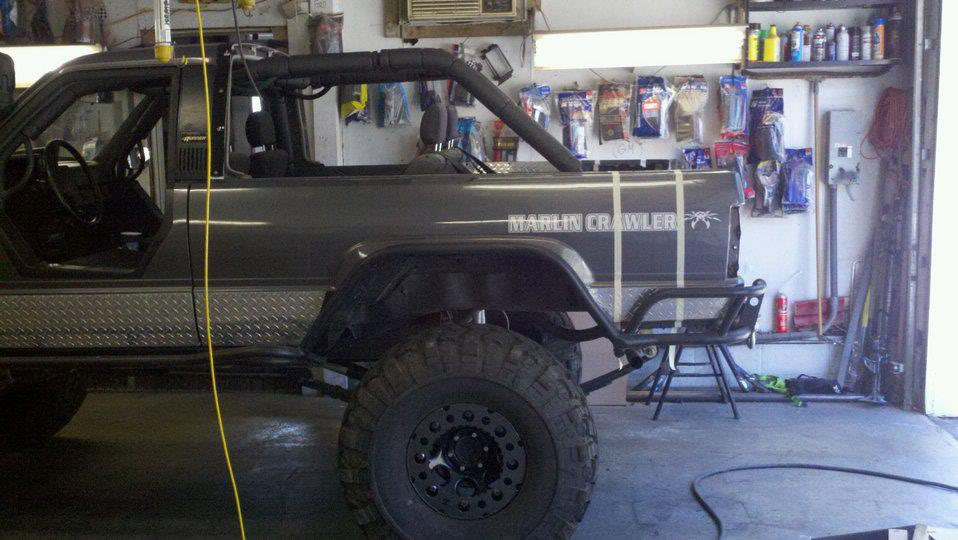

I was tired of dragging my butt on every obstacle so Off with about 12" of rear!
No turning back!

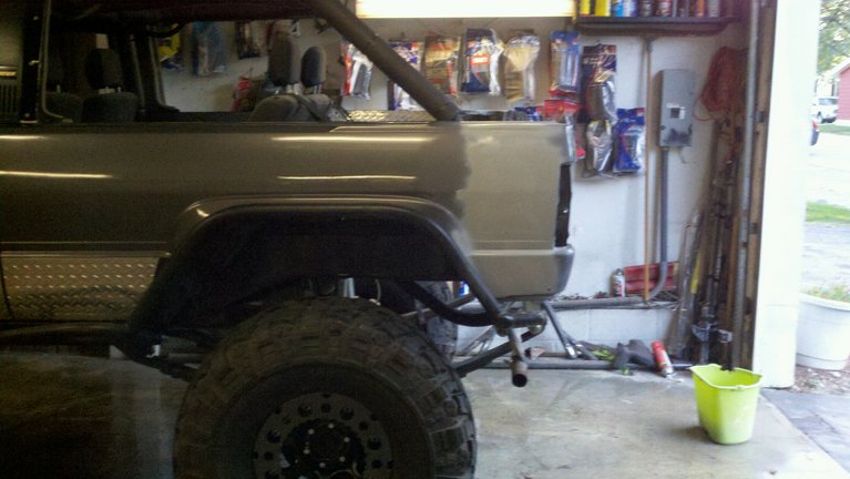

welded and primed
Done!
This mod was not fun! I also moved my shackles back 1 1/2 " for a better angle and so the tailgate will open.

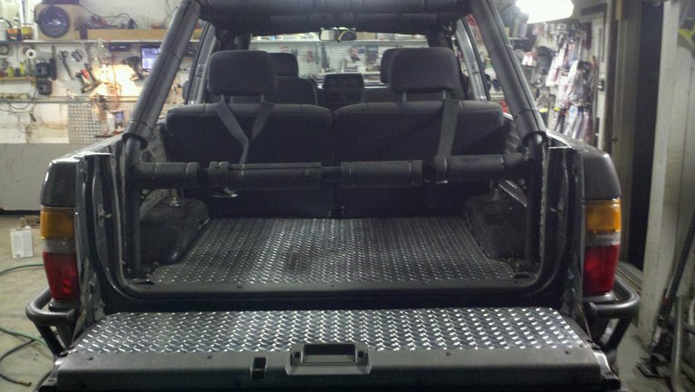

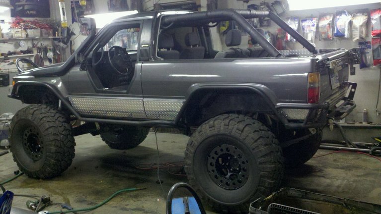

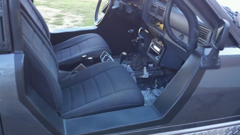

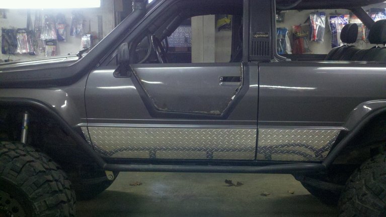

I cut my factory doors too !
Before, TOO LONG!
After, Just right!
The doors cut
She rocks now!

thats a serious piece of machinery. ive seen a few people go dual transfer cases... thats that all about? whats the purpose and what do they do?

The dual cases allow you to crawl in a lower gear. It makes my truck able to have power and not kill my clutch. Excellent mod to do !

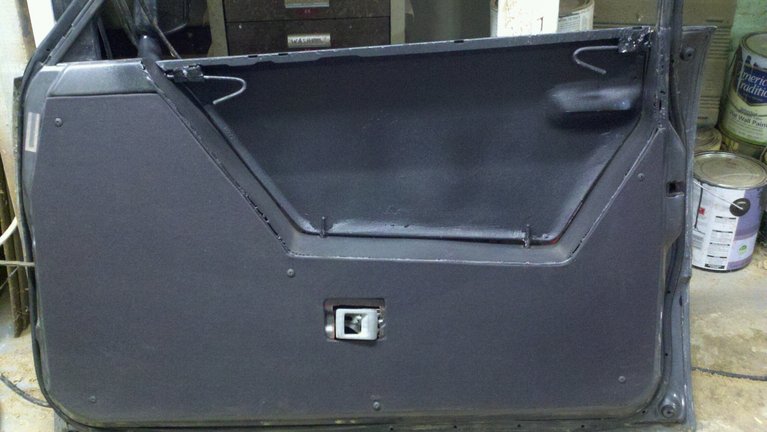

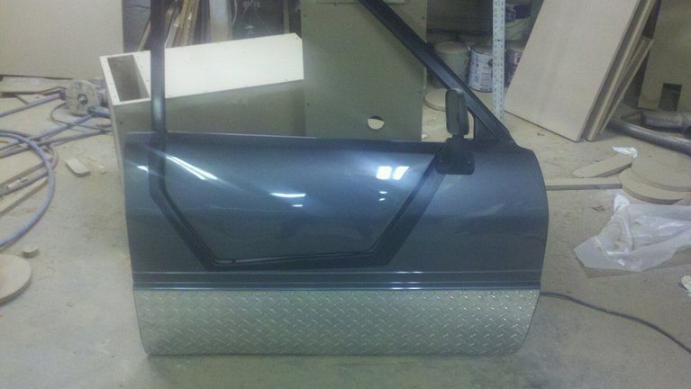

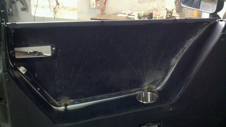

I was thinking it would be cool to use the piece I cut for the 1/2 doors and make them whole again. I welded 1/4" rod to perimeter of the insert (after trimming 1/4" off the entire cut for clearance) . Then I welded 2. 1/4" rods for locating pins . I drilled matching holes in door and used plastic snap grommets The top will have a spring loaded lever to pop them into place. I will make some jeep style vinyl window inserts for the top and hopefully I will have convertible doors.
The backside

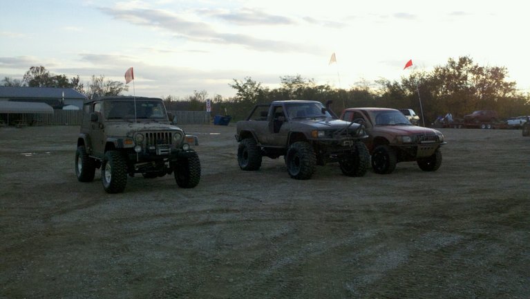

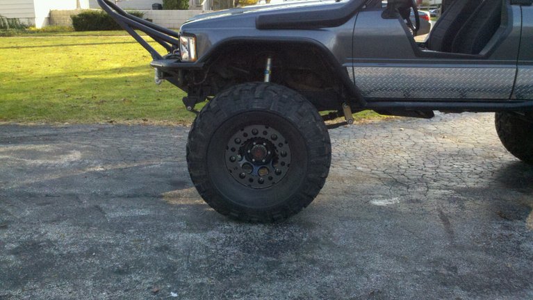

Here is my truck next to a buddy of mines Tacoma on 31"s. His truck is sick! It's a long travel with a bed cage ,supercharged 3.4 with bypass fox shocks all the way around. It is a dune screamer and excellent Offroad . He cant follow me through the rocks but pretty much everywhere else! Mine not as tall as you think . I still easily fit thru a standard garage door.

I finished the door inserts by fiberglassing the handle opening and keyhole. Then used some duraglass filler for the next layer and finished it off with some rage gold filler . Sanded it all smooth and primed and painted them. They turned out great.
Old Feb 9, 2013 | 04:57 AM

ive never seen anything like that for the doors. well done. thats truly impressive.

Thanks ! I thought it would be kinda cool if I could pull it off.
Old Feb 9, 2013 | 08:40 AM
stereoguy's Avatar
Joined: Sep 2009
Posts: 199
Likes: 9
From: michigan
Here is the back side with the latches.
