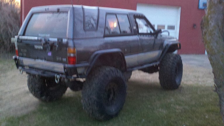

Sorry about the fuzzy pic, I guess I should have had my coffee before taking it. The front of the window insert slides in a awning rail so it is super sturdy and watertight.

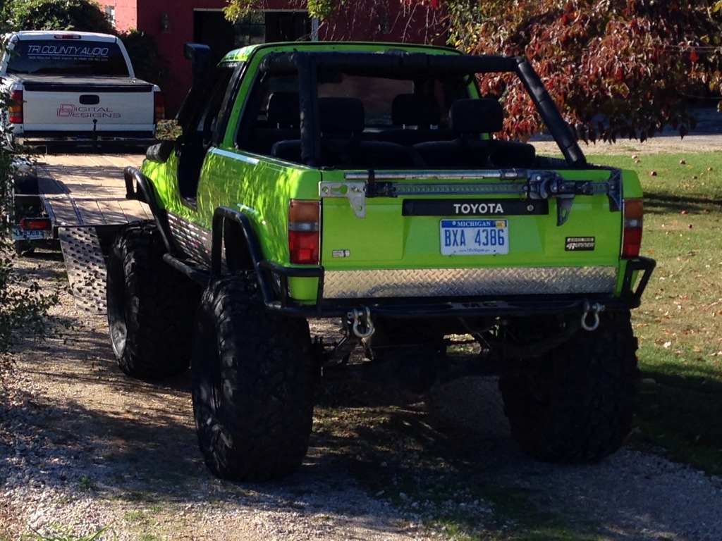

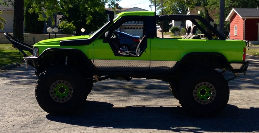

It's been a while since I posted the constant change to my runner. Here are some things that have changed .
The truck was a little bland so I painted it bright zombie brain splatter green

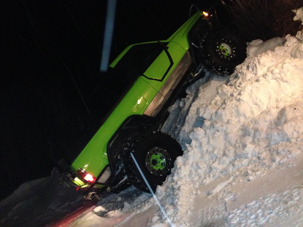

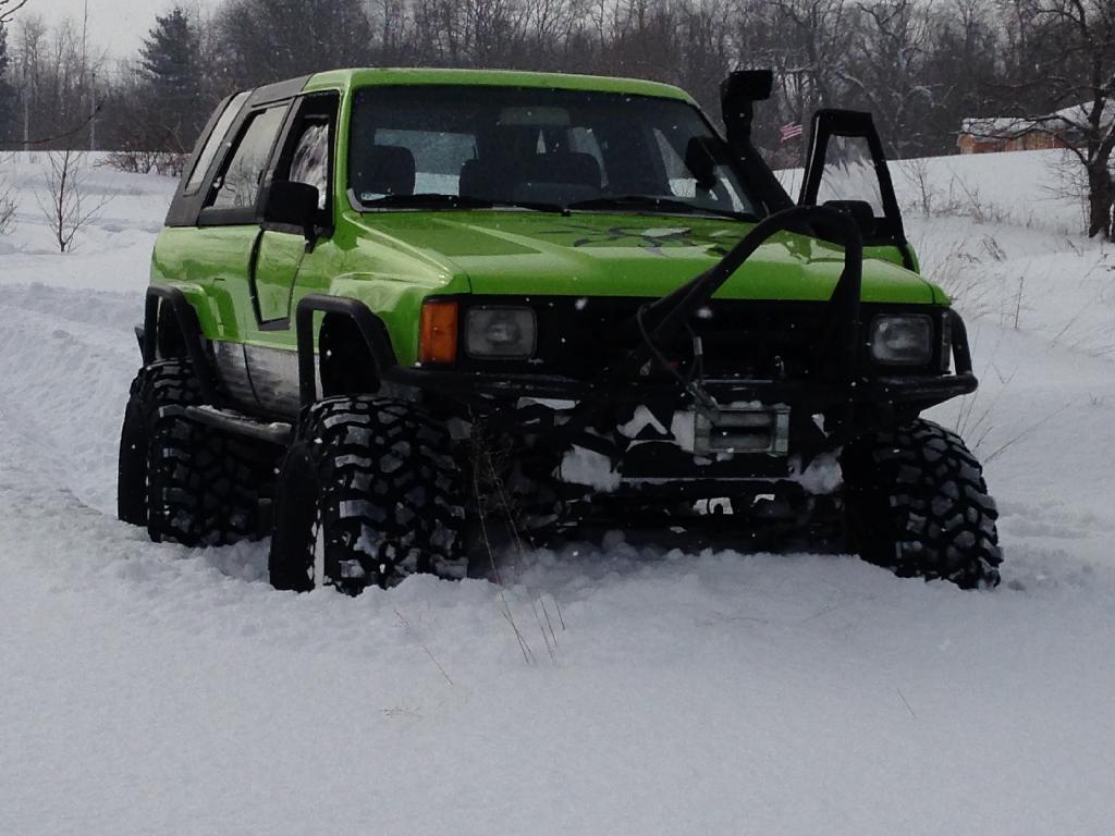

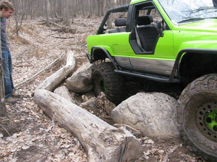

I think it turned out nice! I had some fun this winter too

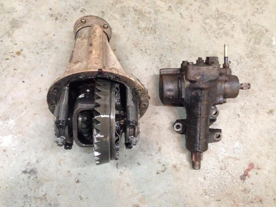

I was a bit hesitant to add a locker to the front. The truck did so well even with a open front I liked the challenge . But I went to a park that showed me it's weaknesses and I pulled the front diff and steering box.
I used the camo method to pull the diff ,it worked great .

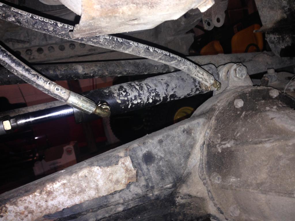

I can't find the pictures of the steering box tapping for the hydro assist but I used the video on YouTube and followed that and it worked perfectly. Here is the final result.
The hydro assist is a trail gear kit ,it worked out great!

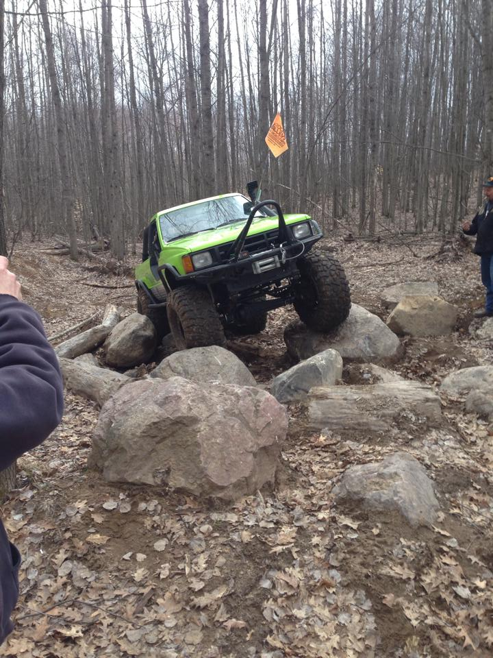

I did run a cooler in front of the radiator it's not huge but so far is keeping up. I also drilled out the restrictor in the stock p/s pump to 13/64ths and this sped up the steering a lot . I chose a spartan locker up front ,I have heard good things from these we will see I guess. So far the steering is great 2 fingers and the locker is amazing ! I am finding that I just walk through obstacles that were hard before.

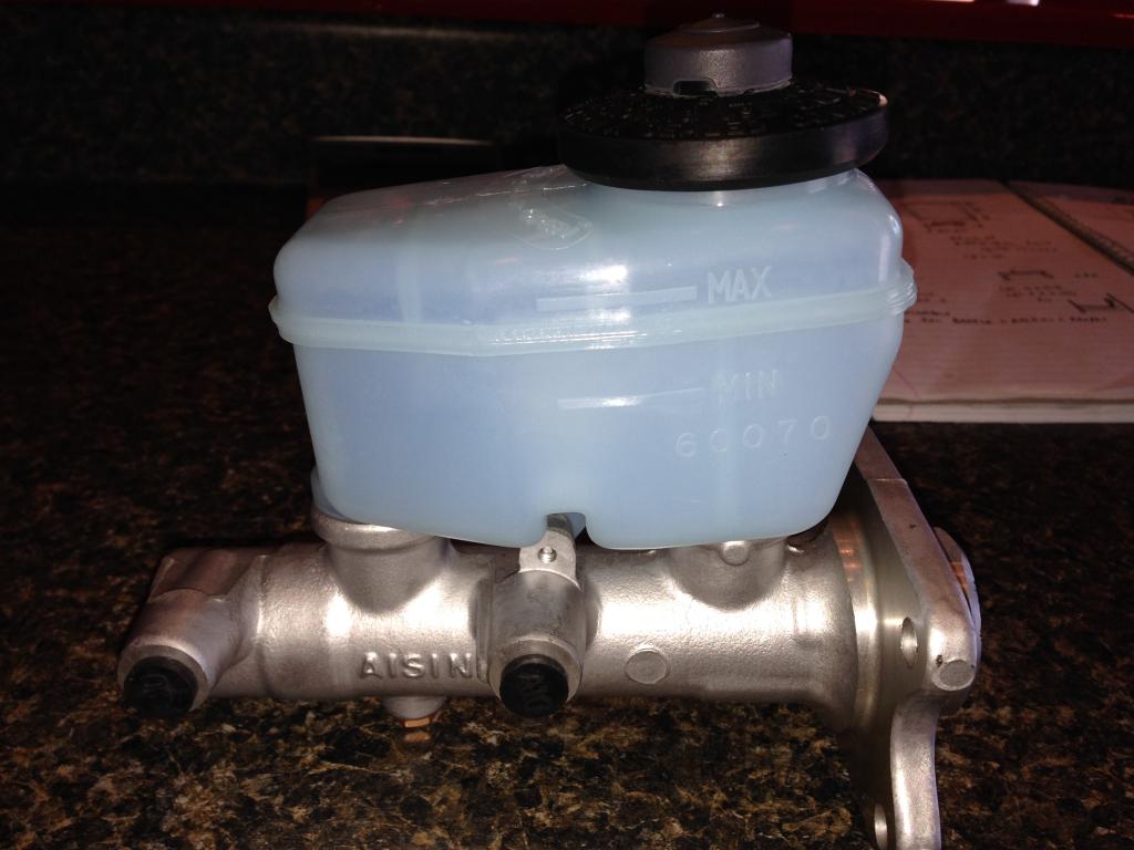

My brakes have kind of sucked lately, so I am going to replace the master cylinder with this one from a fj80 its a 1" bore so it should rock ! I got this one off trail gear's site , it wasn't too pricey and stopping is at the top of my list of things to do good!

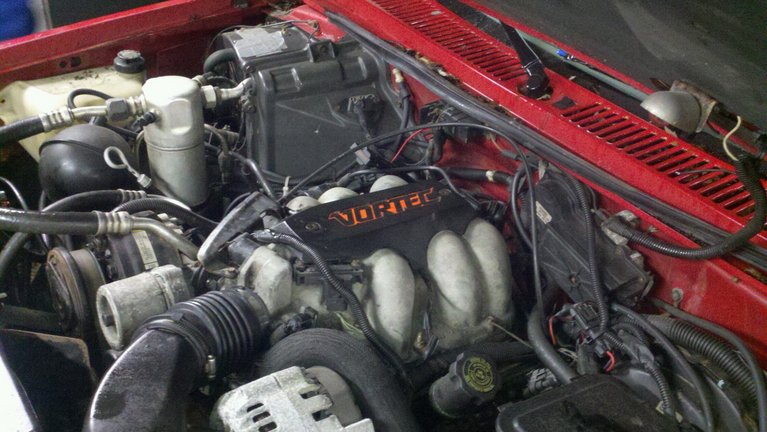

I haven’t been here in awhile. Here are some things I have done to the truck.
4.3 Vortec MORE POWER!
