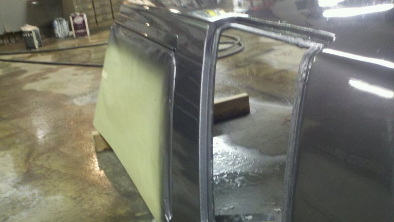

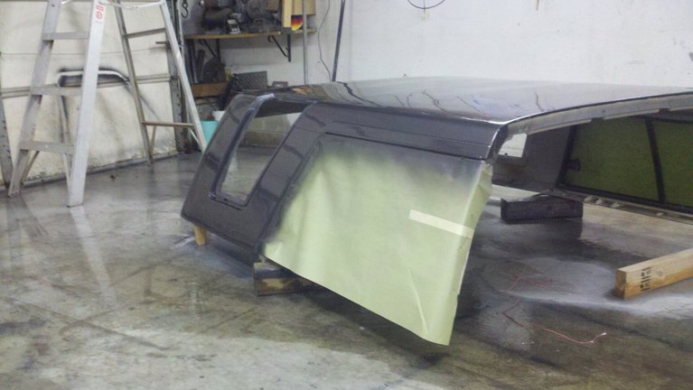

I seamed the top together with fiberglass and sanded everything down. Sprayed high solids primer on and sanded that down . Then basecoat and clearcoat I am going to have to sand and buff this tomorrow cause of a big run but it should look sweet when I'm done. After I wet sand it with 1500 grit and rub and buff it I will tape off the window openings and shoot some black so they look factory. Then I will cut the corner windows out of lexan and bend them with a heat gun. I am going to try to just fill the window tray with black silcone and set the windows in . Without any screws. We will see if that works!
The top all painted
Shiny!

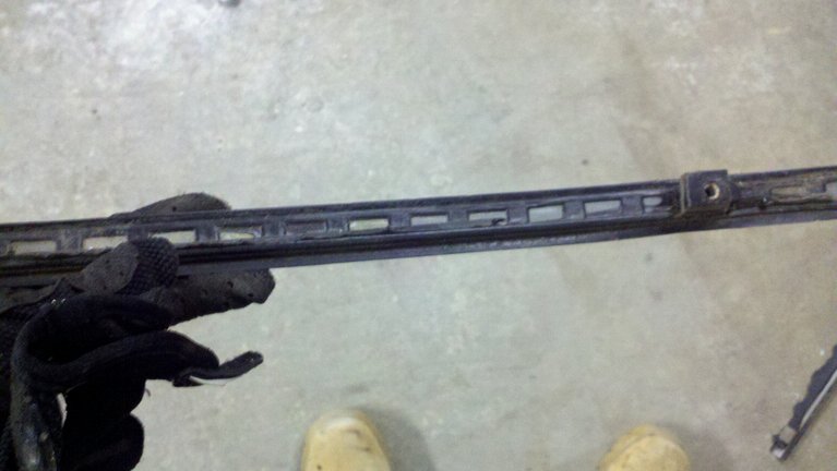

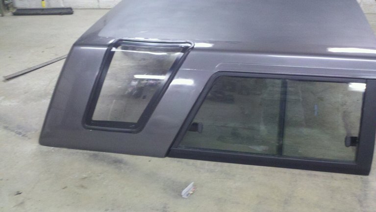

Well I'm finally finishing the top. I traced out my window openings and cut out some 1/8" lexan and used a heat gun to bend it. I have never seen anyone use the factory trim for their windows so I thought "why not try it"

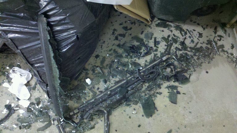

Step one break original window
I cleaned up the glass from the tracks

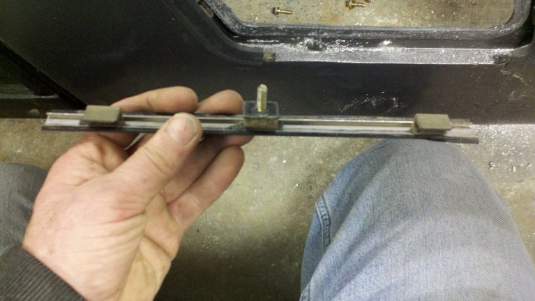

The spacers and original mounting holes slide in a track I cut the track down on the top and bottom piece only

I assembled the track and slid the lexan into the tracks . It fits like the original window did! I siliconed the back like factory did and let it dry. After the windows dried I filled the window tray with silicone and bolted the window into place.
Looks like factory now!
It's not perfect but it's close to factory looking instead of no trim like all the others I have seen.
I cut 12 " out of the top ! It looks factory again.

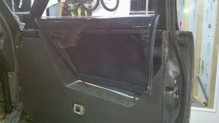

The windows velcro in so i can open them really easy if I need to.
