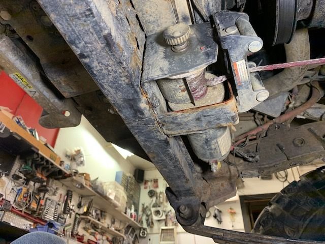

I finally got my suck down winches done. They work great! It's nice to be able to pull the front or the rear down as I need. Here are the controls and the harbor freight 2500lb winches i used.
winch controls
front winch pull point
front winch It's tight
rear winch

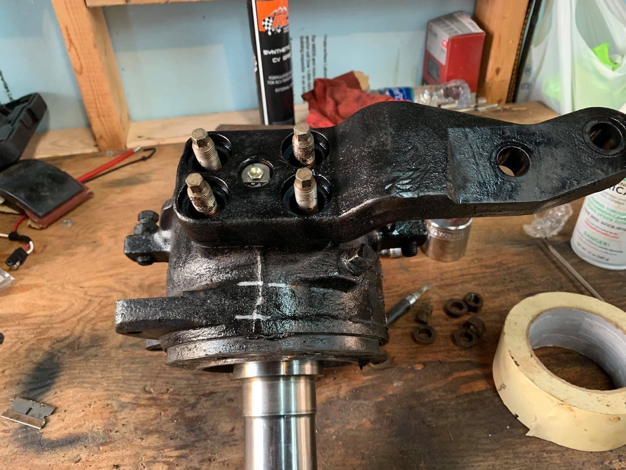

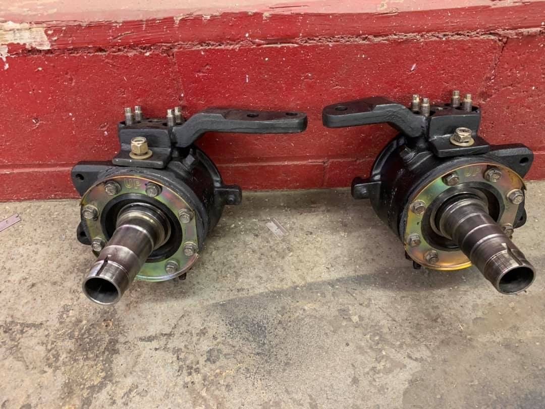

I got tired of having to tighten my steering arms all the time so i was either going to get the 6 shooters or try the 5th stud mod. i figured i will try the 5th stud mod 1st. I blew up a dirty 30 axle at the bell the last time out so I figured a new set of RCV 30 spline shafts would be the trick! I also went with the trunion eliminator kit at the same time. I had a not fun time getting the trunion elim. kit shimmed up on one side. Too tight or too loose. I used a belt sander to finally get it right. i sanded on of the shims down a bit.
yuck!
snapped at the bell
new rotors and bearings. All cleaned up.
mark for my 5th stud
trunion eliminators
all completed!

Looks good! Is the 5th stud a bolt coming up from the bottom, or did you put a stud in?
Old Jan 1, 2020 | 07:28 AM
  #69
stereoguy's Avatar
Joined: Sep 2009
Posts: 199
Likes: 9
From: michigan
I put a bolt in and tack welded it from the inside. No more loose steering arms!

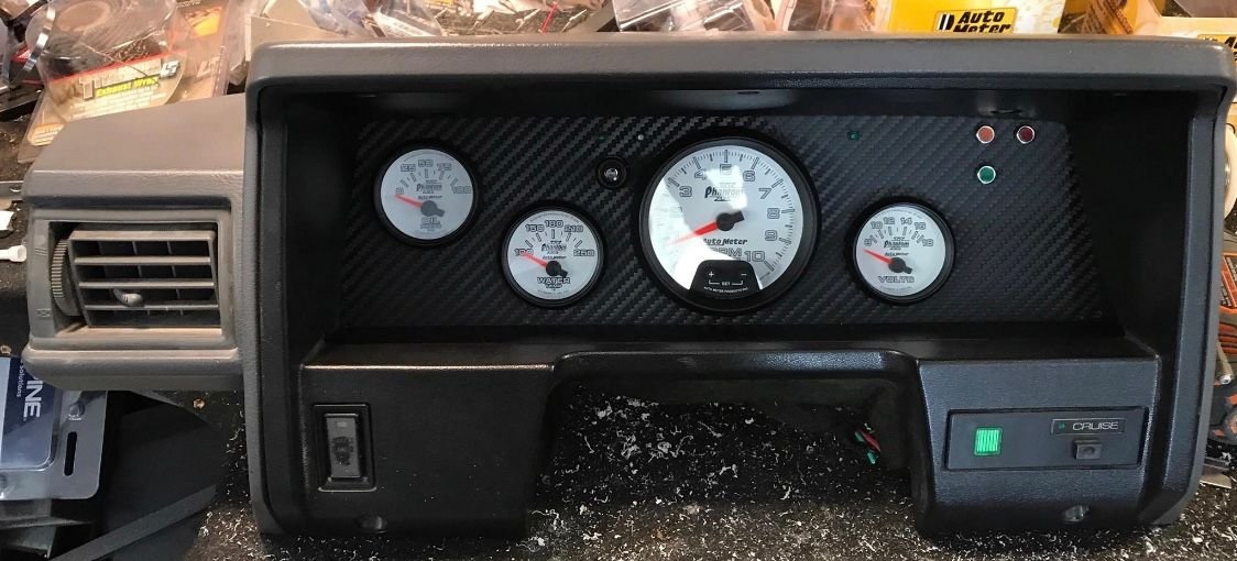

After I did the 4.3 swap I decided to get rid of the old gauges. I made a plate and added some Autometer gauges. I added a sheet of carbon fiber for some bling! I love how these look and they are very accurate! No more tapping my dash so the gauges work! I even have turn signal indicators(small green indicators),high beam indicator(small blue light)
fun times The back side
it fits great
,check engine light(the yellow light)oil light(red light)4wd indicator(green light)
sweet

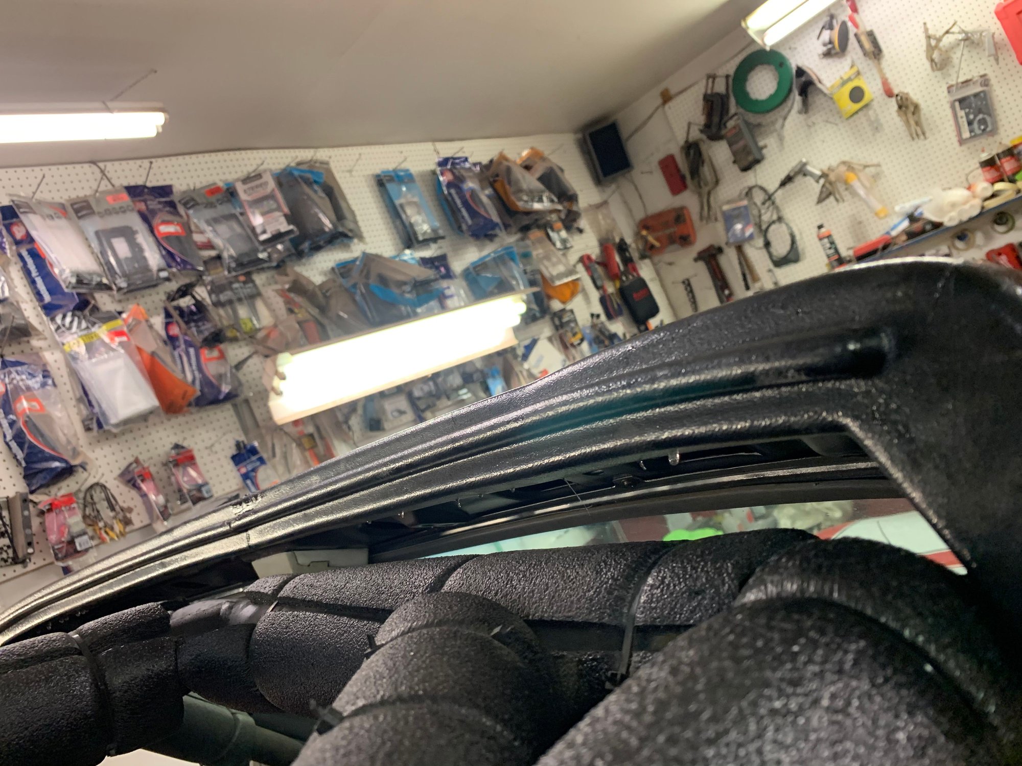

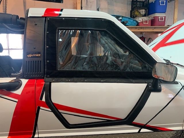

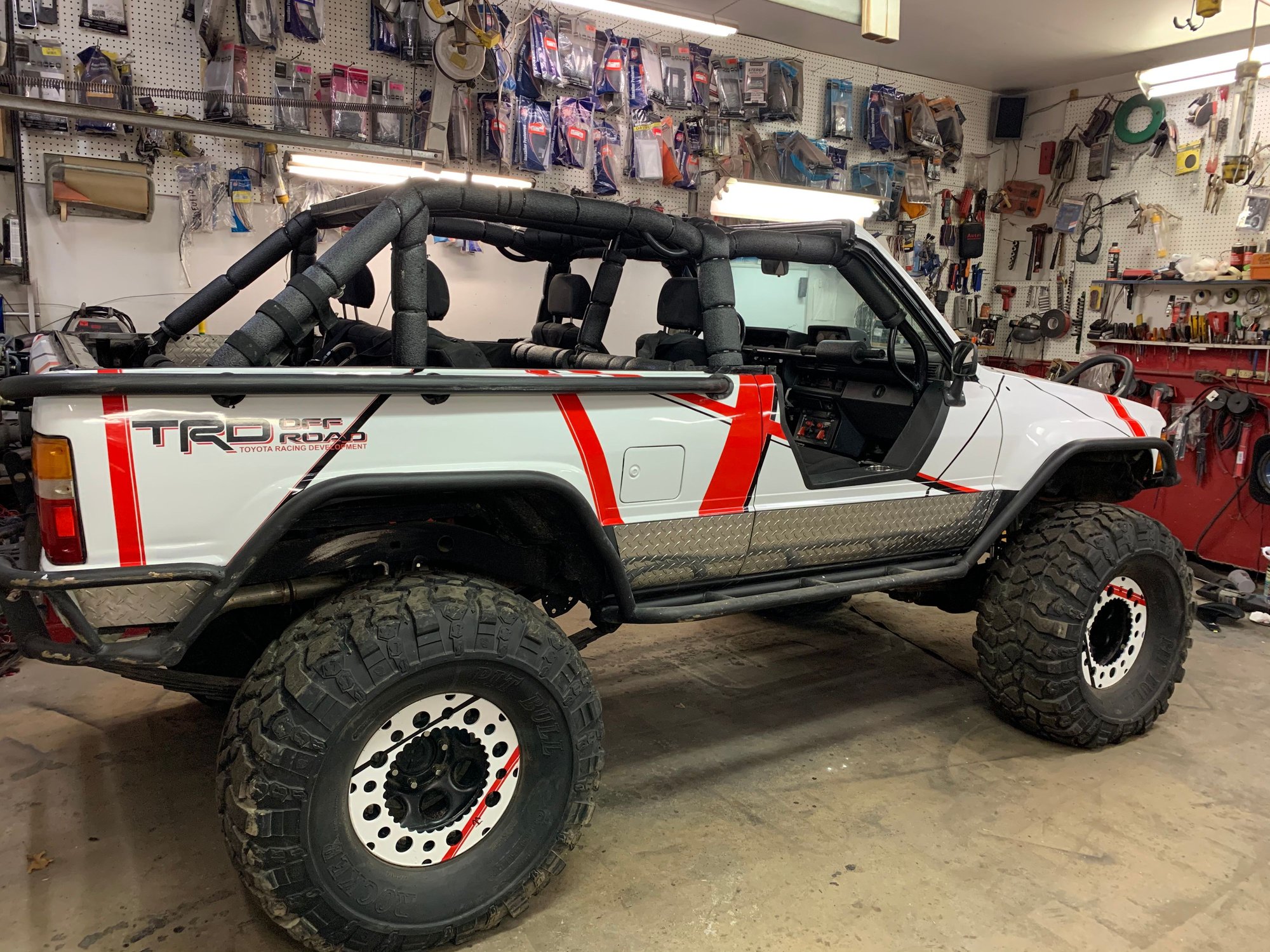

So I decided to finally do the hardtop conversion to this truck. Here is the truck with the top back on https://www.flickr.com/photos/161937.../shares/vH81rK
Old Jan 10, 2021 | 07:51 AM
  #75
stereoguy's Avatar
Joined: Sep 2009
Posts: 199
Likes: 9
From: michigan
Conversion
Top off
Old Jan 10, 2021 | 07:55 AM
  #76
stereoguy's Avatar
Joined: Sep 2009
Posts: 199
Likes: 9
From: michigan
Now to make the mounting pads and rail for the front seal
Top rail
Capped end and location pin
Weatherstripping
Mounting base and pin hole
Old Jan 10, 2021 | 08:02 AM
  #77
stereoguy's Avatar
Joined: Sep 2009
Posts: 199
Likes: 9
From: michigan
This turned out sweet! I was jealous of the back seat passengers having the sun. Now I can too! The top has L brackets in the 4corners to bolt back on if the weather isn’t so nice. I can put the hardtop on and off in about 5-10 minutes.
Finished and topless
All done
Old Jan 10, 2021 | 08:08 AM
  #78
stereoguy's Avatar
Joined: Sep 2009
Posts: 199
Likes: 9
From: michigan
And ..... The top back on. 😁. A convertible 1st gen Toyota 4Runner!
Top back on!
Almost not noticeable.
Old Jan 10, 2021 | 08:17 AM
  #79
stereoguy's Avatar
Joined: Sep 2009
Posts: 199
Likes: 9
From: michigan
I did have to tie in /weld the windshield pillars to the cage. It was bugging me seeing the body flex a bit going down the road. Also the rear mount is tied to the cage for rigidity too. No flex and I’ll probably never run the top much but if I want to wheel on a muddy day I can run the top and door /window inserts and stay dry. I couldn’t find anything when I was looking to do this so I figured I would post it and maybe give someone else a head start. The front rib is from a mini truck convertible top kit. I bought the whole kit but that’s all I could use. It still had to be cut in 1/2 and spliced together but it worked. Just some homemade L brackets and bolts and some flat steel to cap the rear ends and a welded bolt for a locating pin. It took a day to do but I love it!!!
