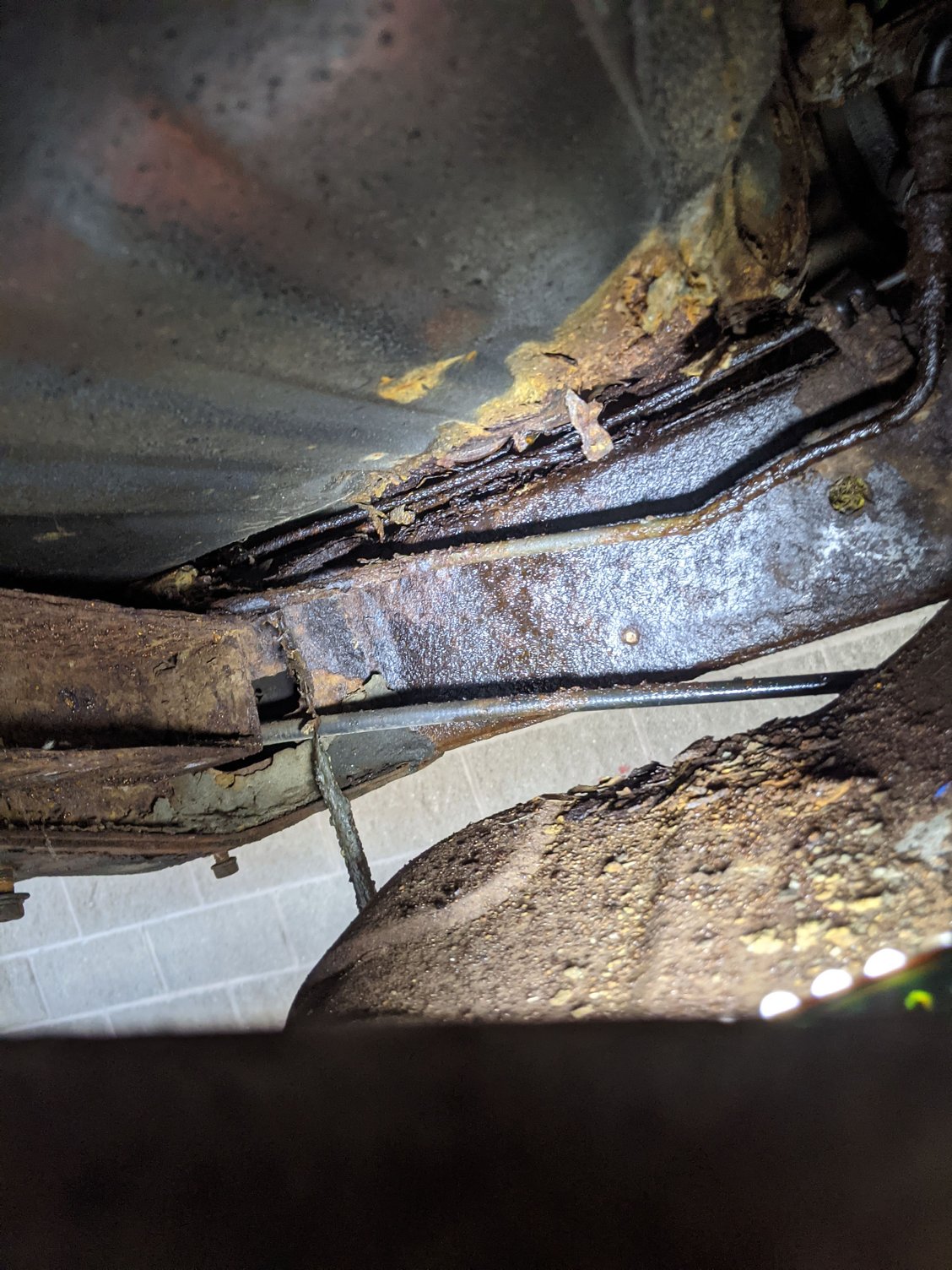

Thanks guy. Finally got it on a hoist. I don't have many pictures, but I got the clutch free, it engages the wheels so I might get away with driving it until one comes in the mail. I started grinding the rust off the frame, and luckily there is no rot. I've been able to get a bit done. I'll probably have to take the body off sometime and grind the the top where I can't reach.

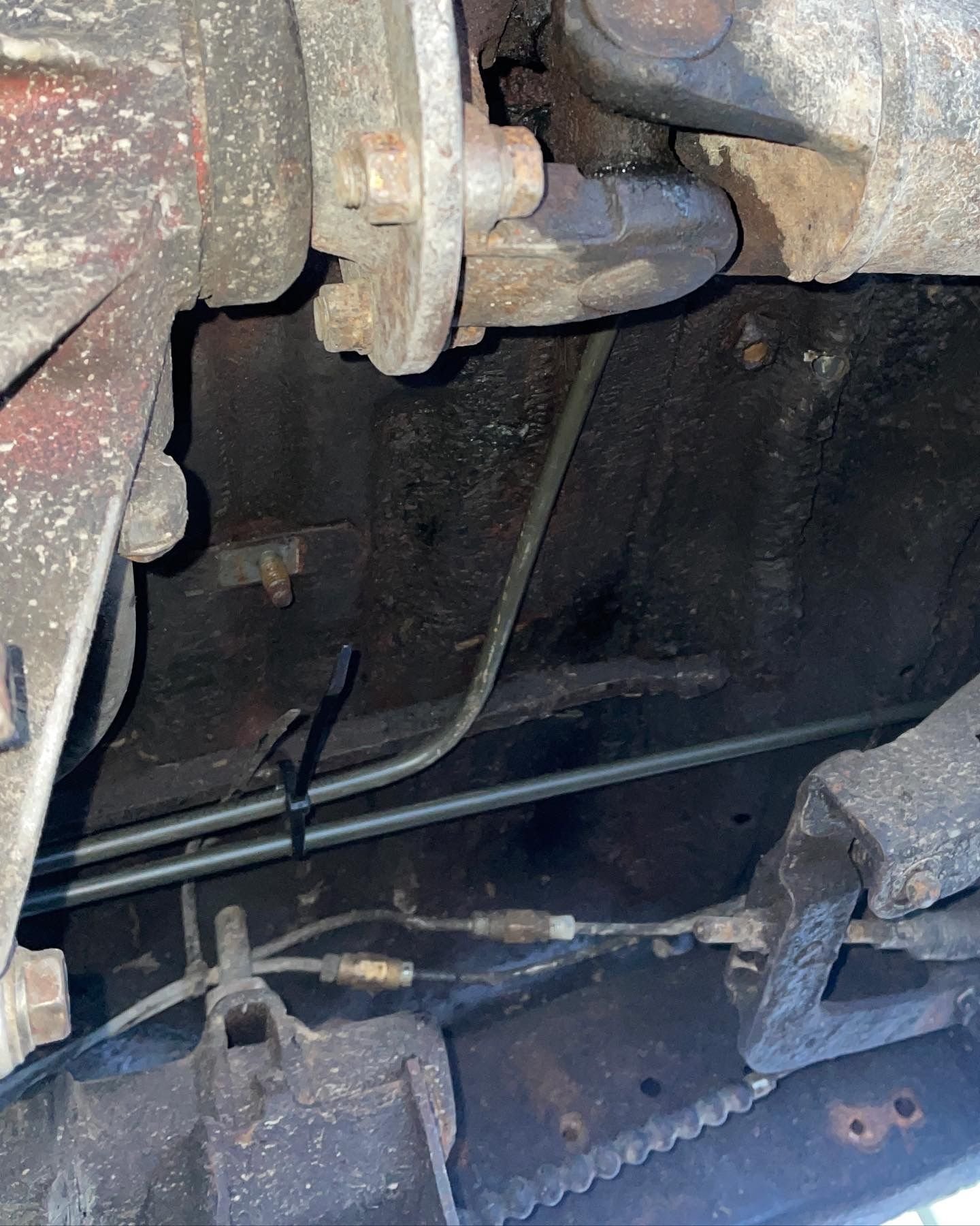

I've also dropped the tank and pulled out the rusted brake lines. They were replaced before, and the original lines were still there, along with the new rusted lines. From the fuel tank and up, the lines are good, so I'' just be replacing the lines from the connector by the tank.

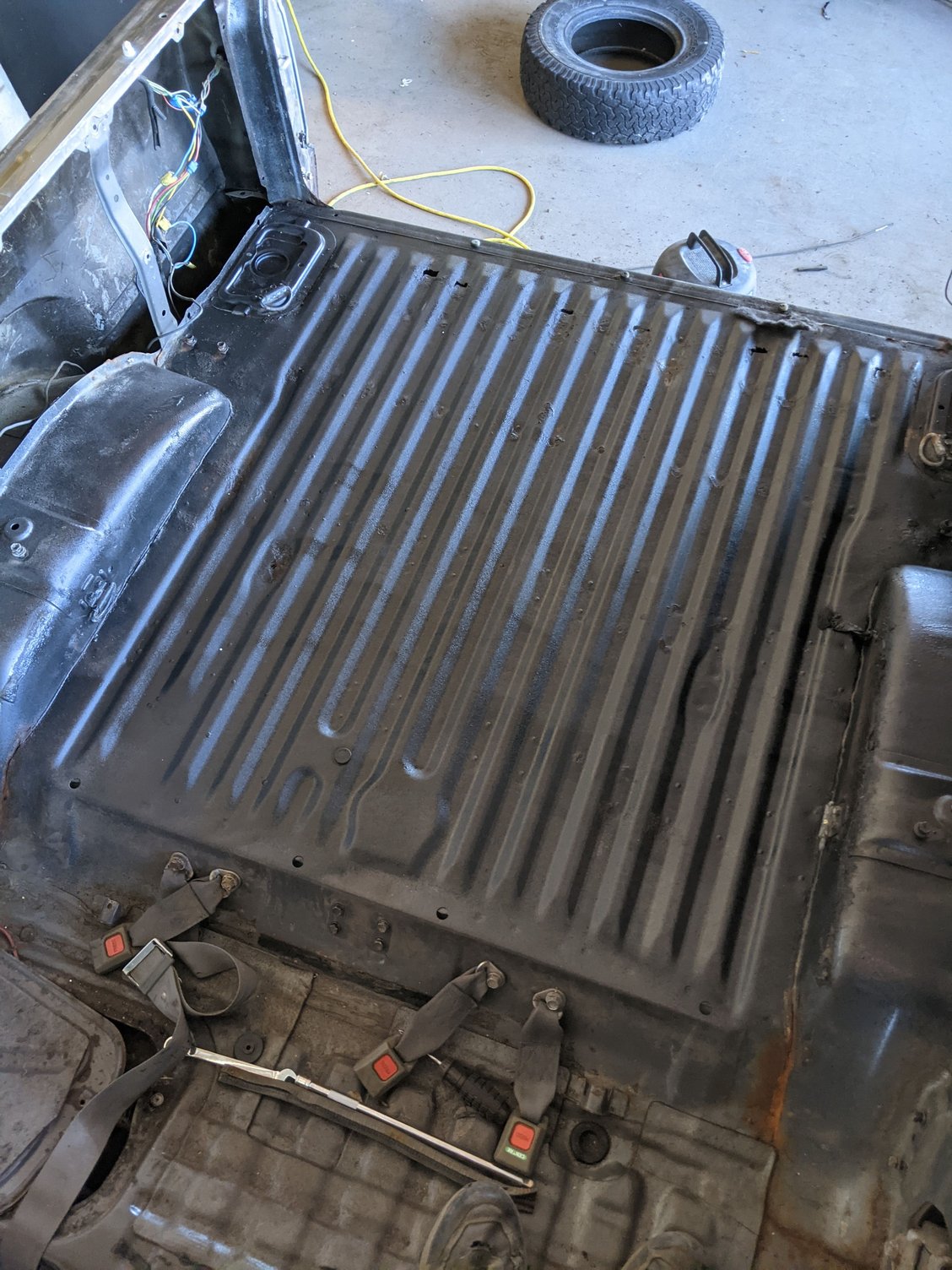

Now that the frame is done I've started taking the interior apart, only had enough bedliner to do the back part. I still have to remove the sound deadening and cut out the rust holes.
And hopefully the carpet comes out clean

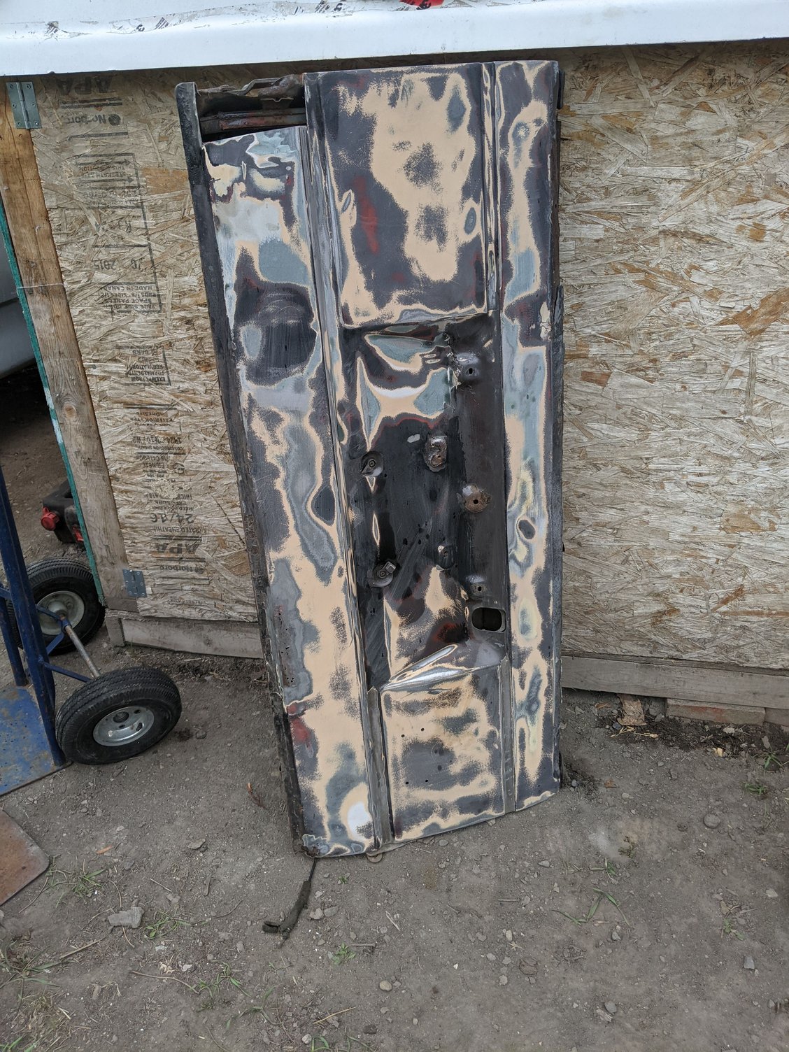

Over the weekend I brought the tailgate home to sand down and primer, dug into some rust so I'' slap some more bondo over that and call it a day.

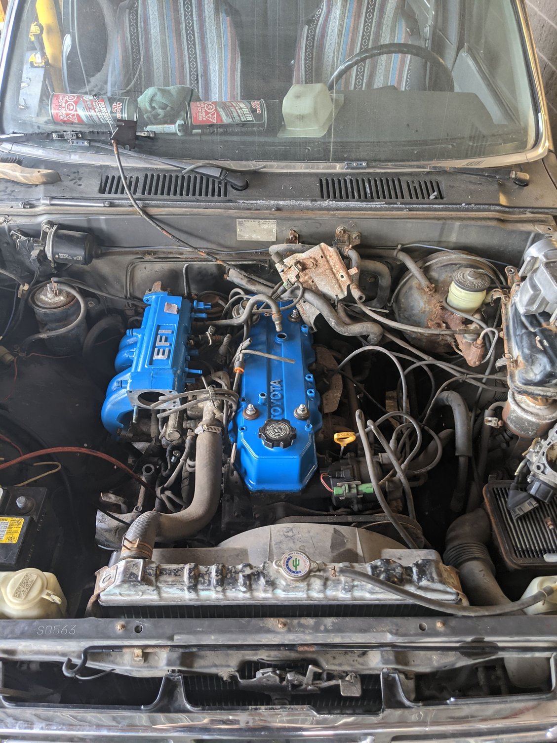

Next up, I didn't like looking under the hood and seeing a crusty engine:
so I painted it:

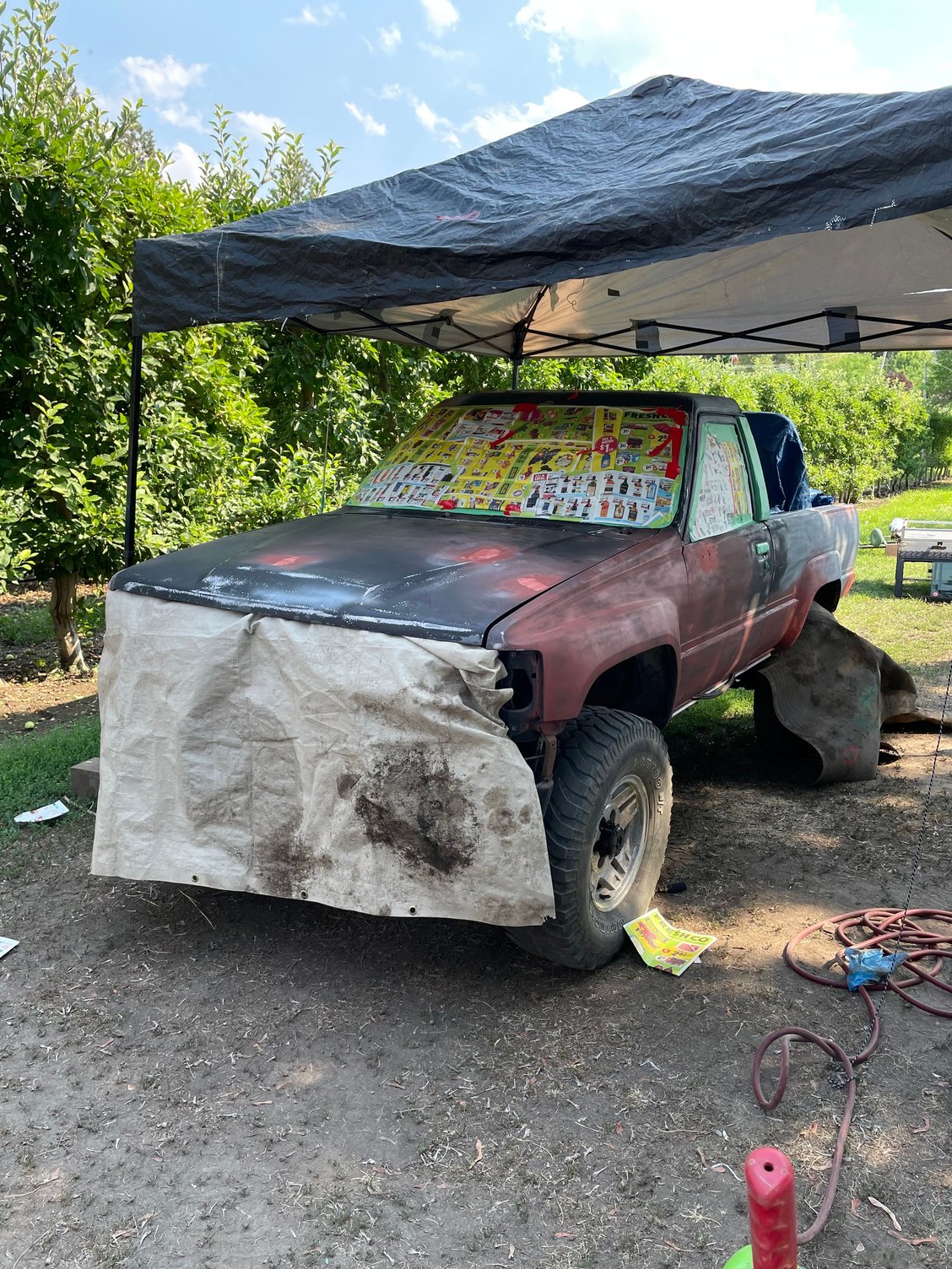

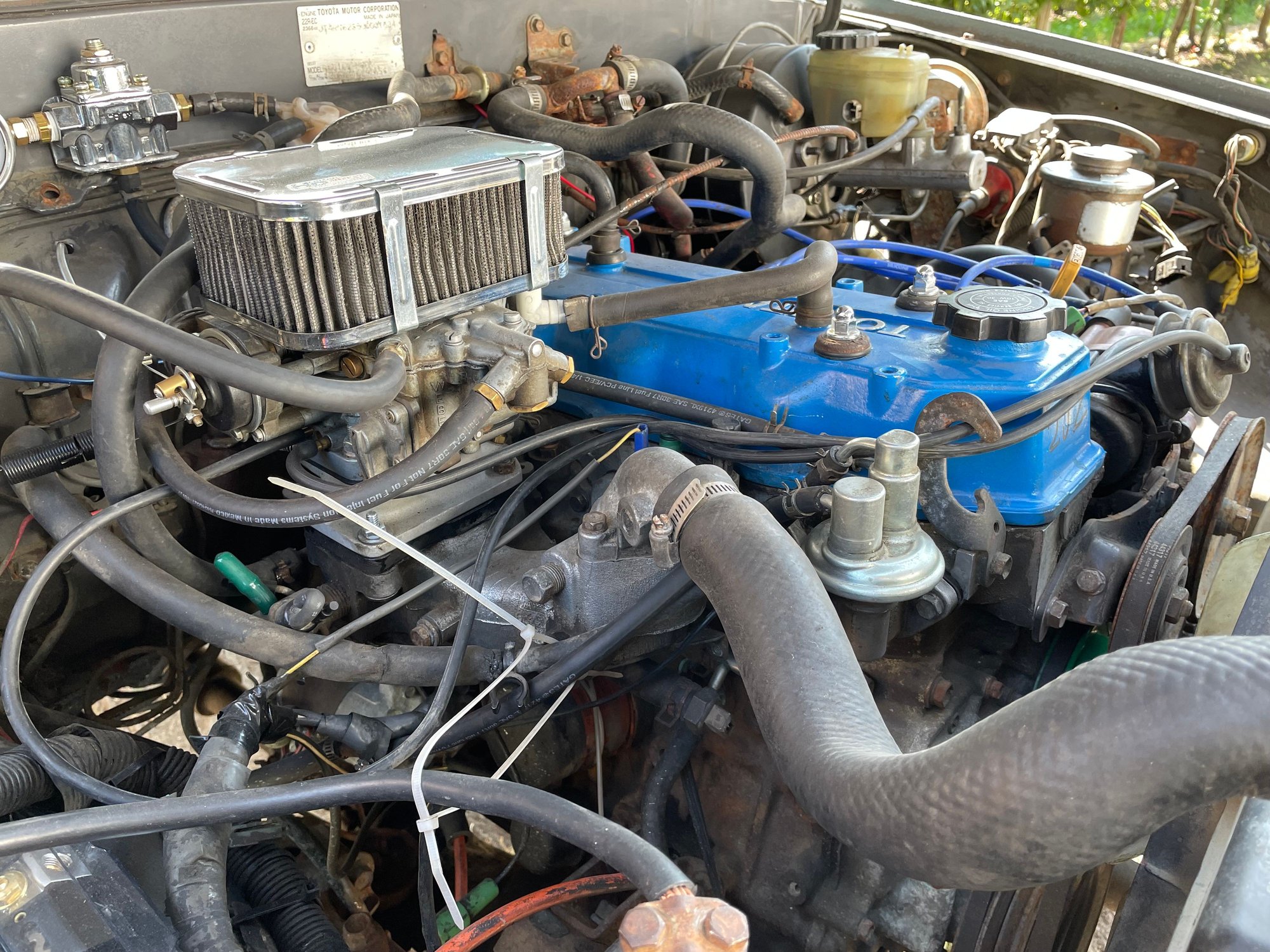

Well it's been awhile. The 4runner has definitely changed a lot, I've also been driving it for about 3 weeks.
First off, I've swapped the non-working EFI for a weber 32/36 carb.
I probably could've fixed the EFI, but this was easier
Runs decently, still could use some work. Now, I didn't want to drive it looking the way it did, so I painted it rustolium grey.

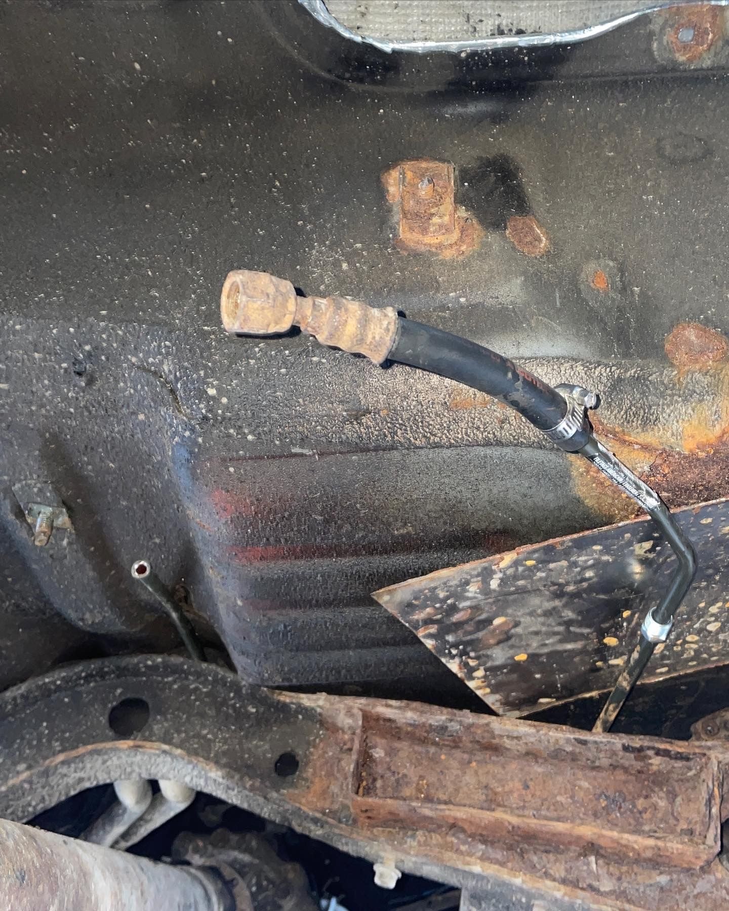

As of today, I've dropped the fuel tank and pulled out the 36 year old crusty fuel lines
Old lines
