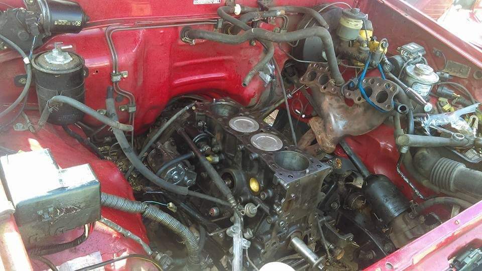

I put a new tank in and there was a fuel leak somewhere that I didn't notice and when I went to start the truck the starter sparked and my harness went up in flames
Old Nov 28, 2016 | 11:05 AM
xxXblargXxx2's Avatar
Joined: Aug 2016
Posts: 4
As you can see this is the damage that occurred
all of the little hoses and all the wires were melted
