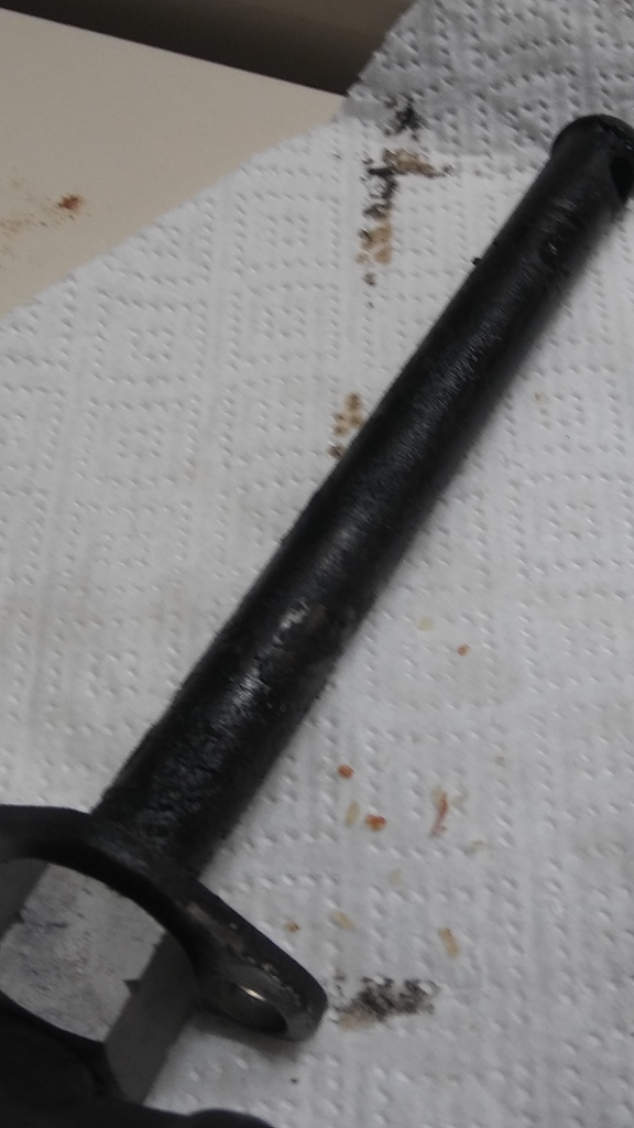

Definitely lots of carbon build up. Thanks for pointing me somewhere specific. Going to clean this up now & see what else i can find that's dirty. Hope that will clear this light and problems. Thanks again

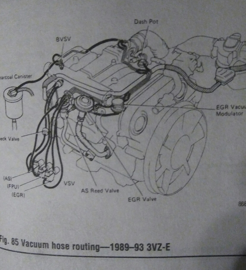

Went and grabbed a new vacuum gauge tonight after cleaning the egr pipe and cleaning the plenum as best i could. Ran out of light before i could really dive in. Drove it 25 miles before the cel came back. This is my first toyota. Got it a few years back and its been up and down quite a few times. Bear with me while i figure out whats what. Its a new system to me. My dad and I rebuilt the motor and ive done some transmisson related work on it, but every new thing that breaks is another thing i have to learn about. I haven't pulled the catalytic converter yet, but that's not a bad idea. I'm sure its not in tip top shape but i just haven't gotten there yet. This thing was my project until my chevy transmission took a crap but i like this thing when its running right. Going to clean up the plenum better tomorrow and try to isolate the issue with the vacuum guage.
The three parts bottom left (attached at the wheel well),how do they come out? I didnt want to just start tugging on them and didnt see a way to open the mounting bracket. (As)(fpu)(egr)
Do i need to remove the whole bracket before i can remove individual components?
I think everything else i've located except the charcoal canister but I'll find it once its light out again I'm sure.

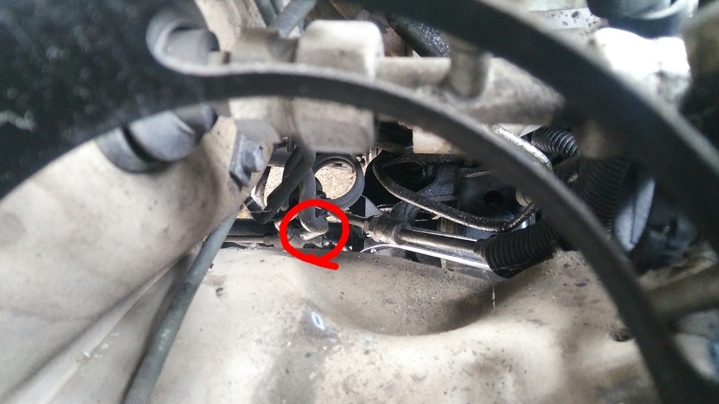

Modulator was a little clogged so i cleaned it out and the lines between it and the throttle body. Pulled the plenum last night to clean it and the throttlebody properly. Found a bad bvsv with a cracked line. Also when i pulled my canister the evap line wasnt connected at all and the line itself is falling apart.
I'm guessing this line pictured here is where my evap canister goes back to the tank, yes?
If so ive got the bvsv ordered from toyota, and am a plenum gasket and evap line away from being able to put it together and see where it stands. Thanks for y'alls help.

I can't tell from your picture; perhaps this will help: http://web.archive.org/web/201003261...76evaporat.pdf
The line from the BOTTOM of the Evap Canister is an air intake; it just runs down and dangles near the engine mount. The line back to the fuel tank does depart from the top of the canister.
By bvsv could you mean "bi-metallic switching valve", often called the TVV "Thermal Vacuum Valve"? (They're the same thing.) The TVV sits between the Canister and the throttle body; it's closed when the engine is cold, open the rest of the time. This allows the fuel vapors to get sucked out of the canister into the intake.
