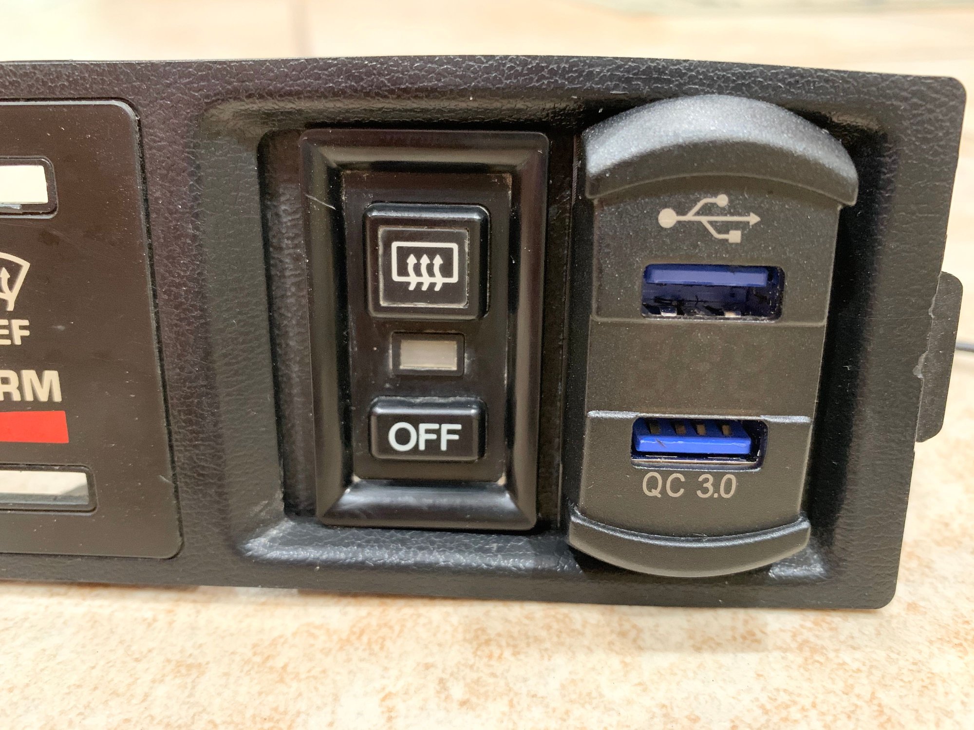

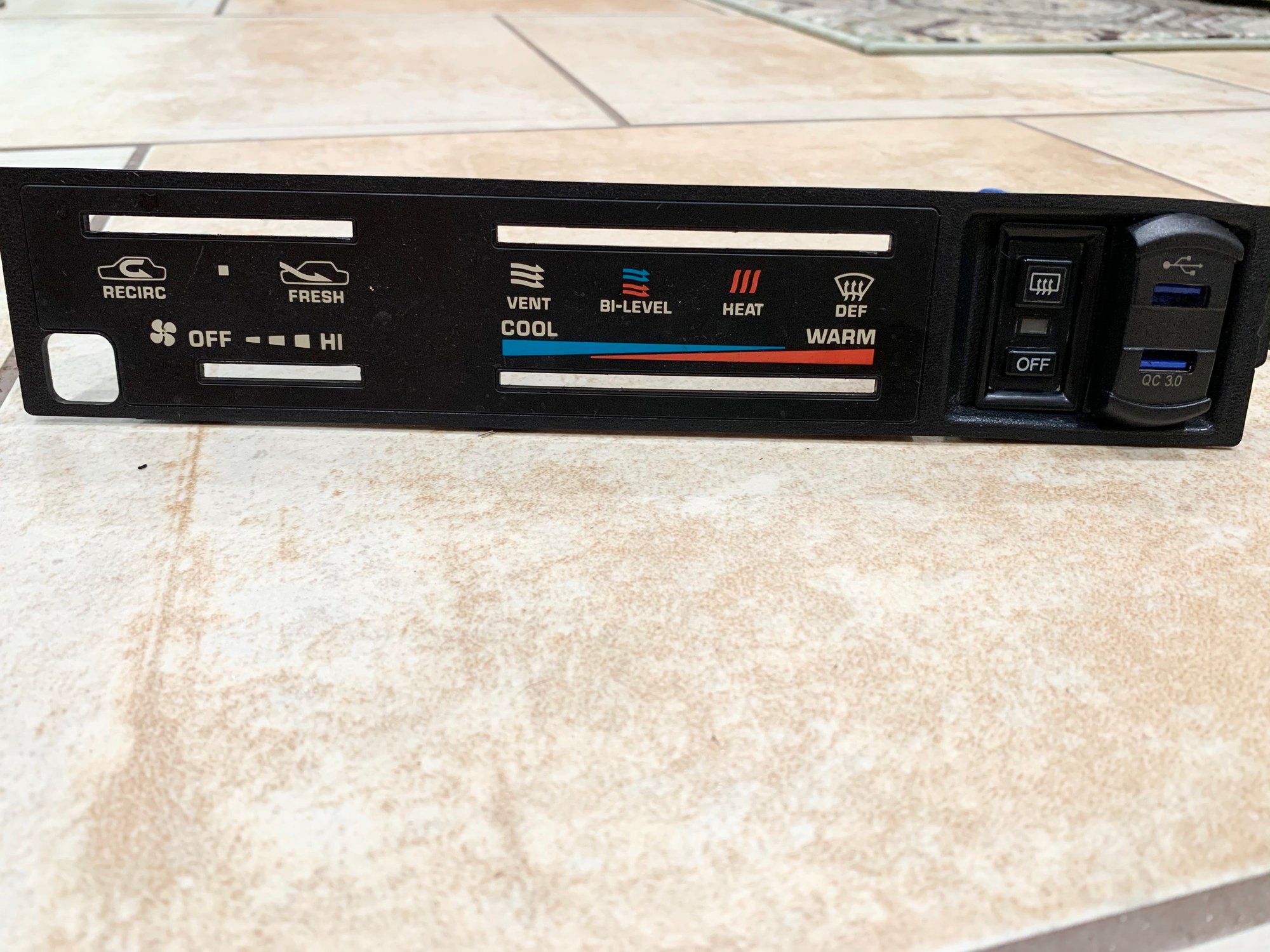

Today’s mod... replacing the factory clock to make room for a defrost switch relocation and dual USB ports with a digital volt meter

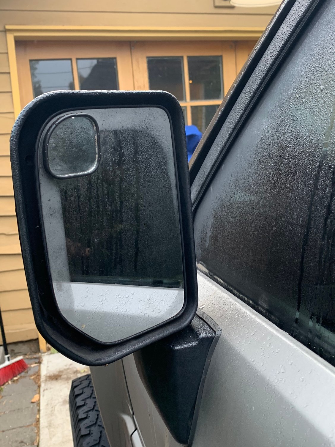

More updates...
cold weather testing the mirror defrost - check!

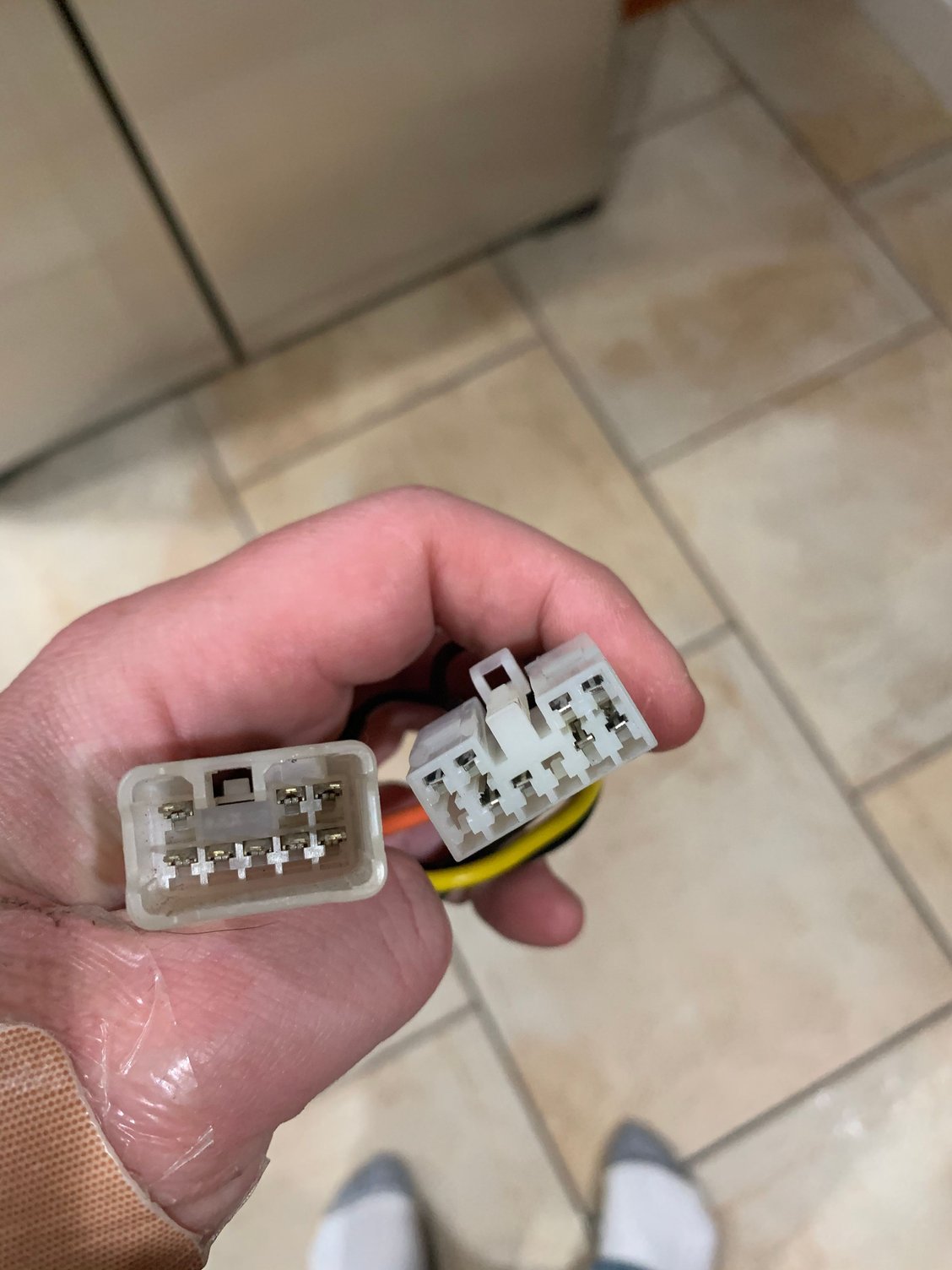

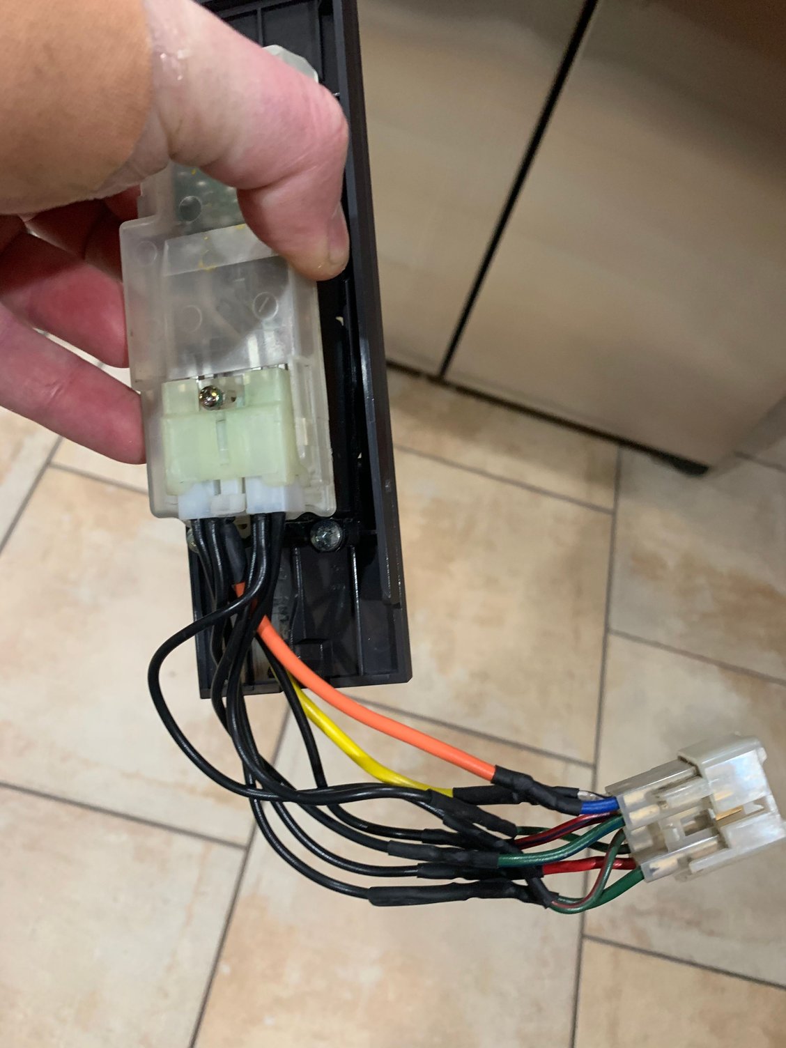

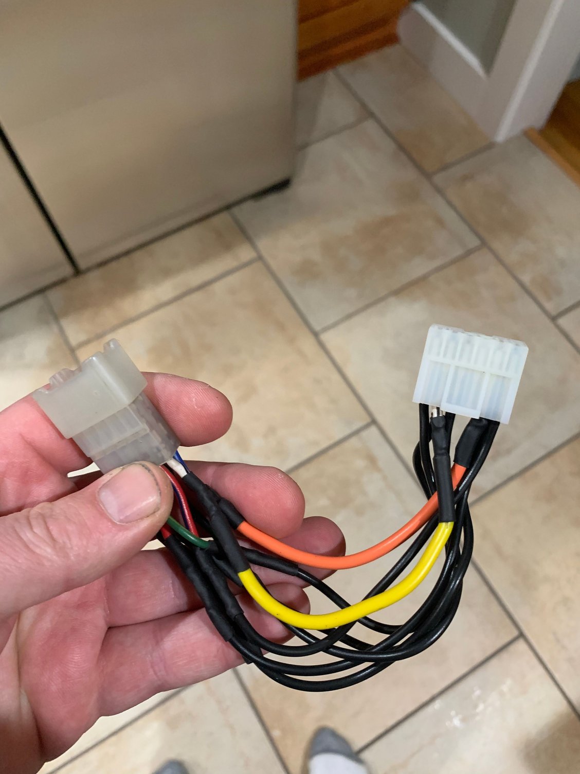

There’s been a lot of interest in my 2nd gen arm rest/switch swap. Here’s how I did the wiring for both sides... I spliced the 1st gen plug the harness for the new switches.
the driver side second gen switch uses the same plug as the radio harness adapter.

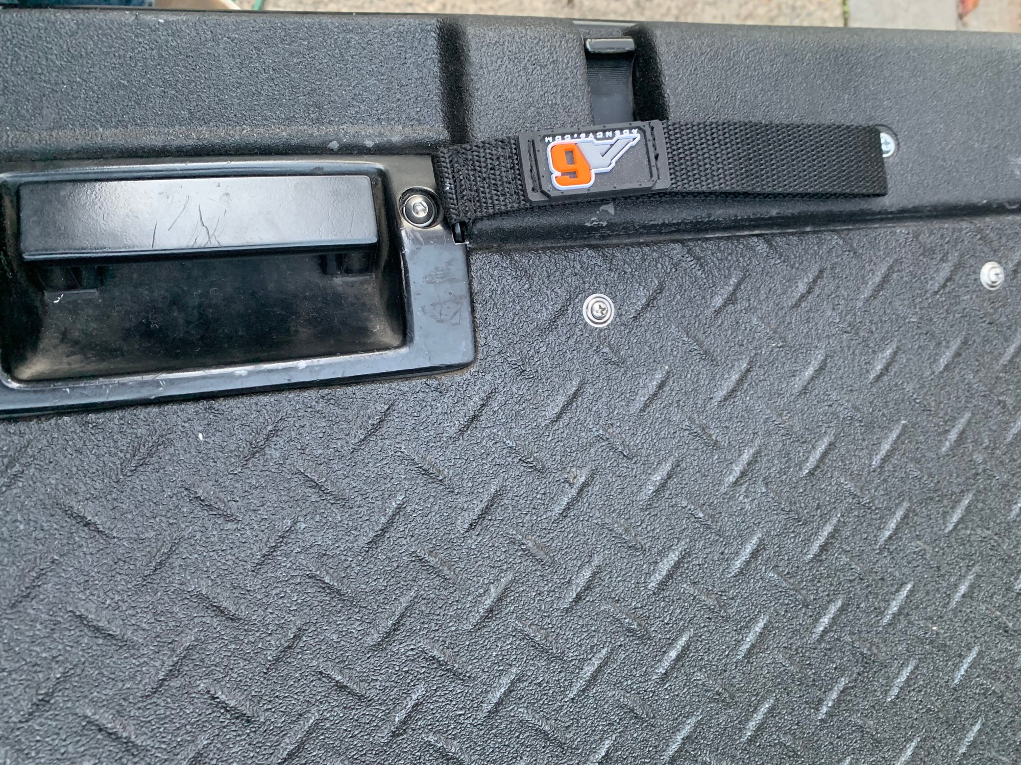

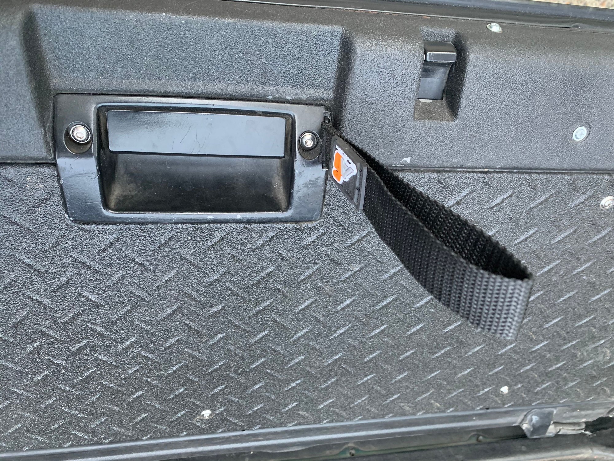

Today’s mod: pull strap to aid raising and lowering tailgate when camping inside. Folds flat
