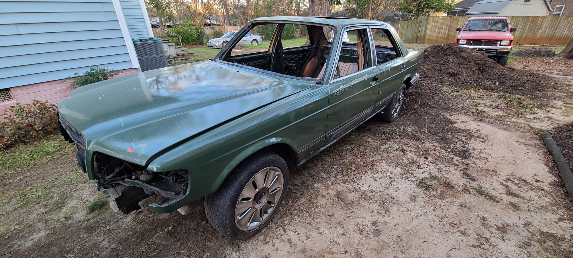

And so it begins. Brought home a 1983 Mercedes 300sd to pull the motor from. Got her for a screaming deal on the condition the po got to strip everything other than the engine bay and drive line.
Engine starts real easy and idles smooth, drove her on and off the trailer but no further as the transmission is pretty sloppy.
Only problem with screaming deals is that i haven't saved enough yet to buy the kit from doomsday diesel, so I can only go so far at this point. That said I'm pumped to finally get started!

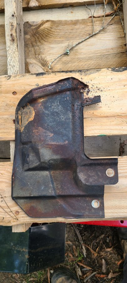

Since I updated earlier in the week I figured I'd post some pics of what I'm working on.
Engine bay is gradually emptying, after i did each bolt out of the accumulated sludge.
This afternoon i removed the heat shield protecting the steering column and discovered a bunch of rust. So bad the forward bolt hole was completely gone. The a-arm is also pretty rough looking. Im going to have to investigate with a wire wherl and see if i need to replace more than just the torsion bars....
And the last picture is the pressure line for the power steering, I can't brake it loose to save my life. And I can't even be lazy and leave it because I discovered it to be perished and crumbly where it was closest to the engine. Though fortunately it hadn't started leaking yet.
