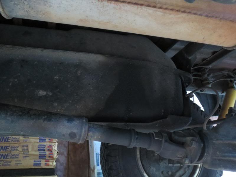

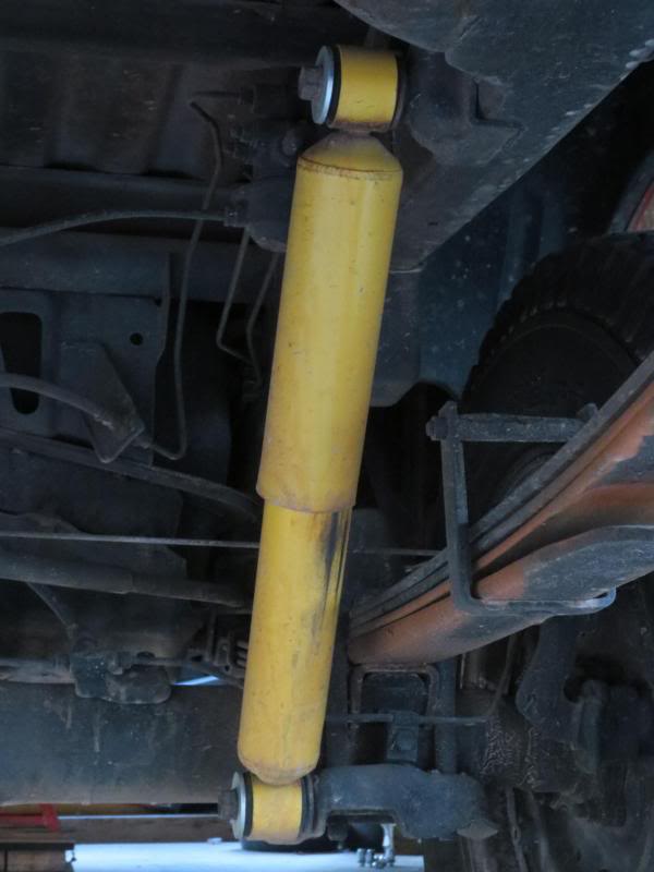

The rolling was getting pretty bad so i jacked her up to investigate and here is what i found, all round.
Good news: The hub i rebuilt is solid as the day it rolled off the production line; no fluid leaks.
Bad news: Rear right shock is toast. Pics incoming.
Don't know if you can really see it in the side pic but it is no longer straight, hence the wear marks.
Worse news: The shocks get here next week and i have no other transport for the time being... that roll is doggone unsettling, diagonal wobble would be more accurate i guess. And I'm fairly sure this also explains the pulling to the right. We shall find out when i get it fixed.
Oh i take that back, my gas tank leaks... I have never owned one that didn't
Or is that grease thrown up from the drive shaft?

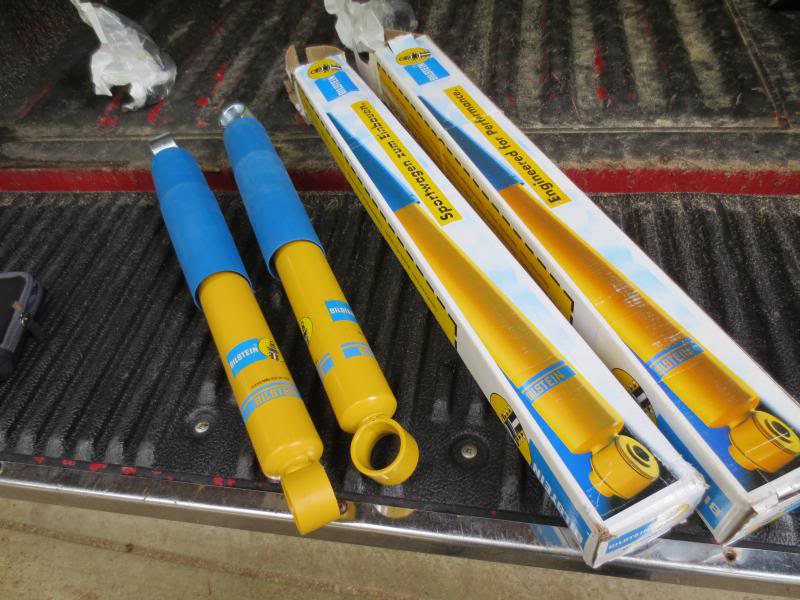

After a week my procrastination paid off, just paid for 2 bilstein HDs for the rear at $66 each. With free shipping from Amazon. Just as well I'm getting tired of beating my tail up on the roads around here.

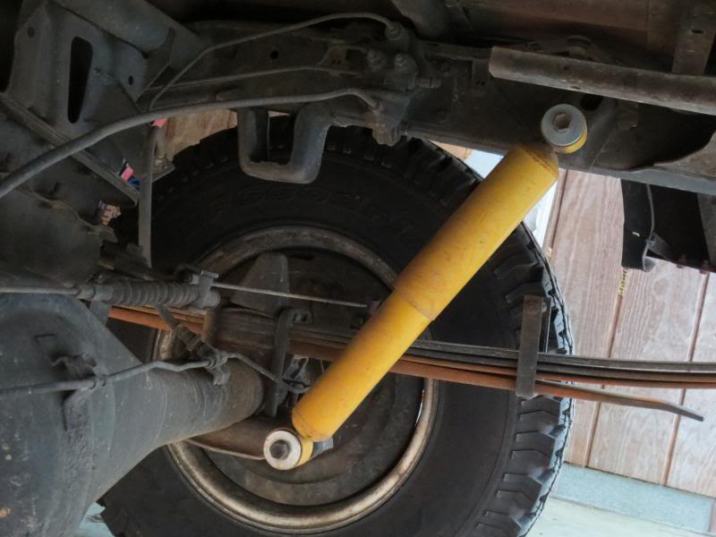

Some good news and some bad news:
The shocks are in. Easiest job i ever did once I put my brain in gear.
Yes this doofus did mess up a simple little job like this! In removing the old shocks i had to hang on my breaker bar under the truck... so not really thinking about it i decided they needed to go back on that tight. Yup, snapped the head off. Luckily it backed out real easy. 2 Days later i found a fine pitch metric bolt in tractor supply of all places? The shocks take a m12-1.25 x 50 bolt if anyone else needs to find one.

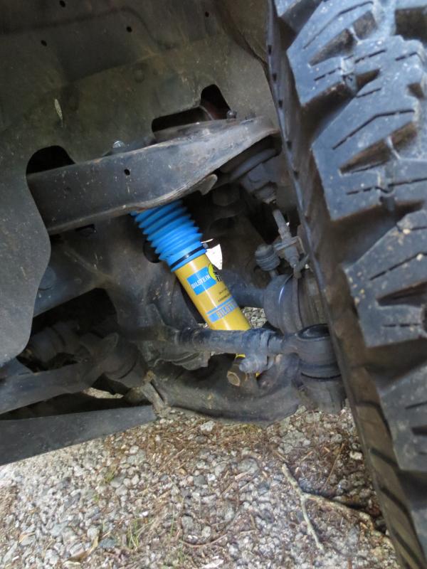

Okay Pics. I'm slow and lazy :p
Bilsteins installed all around and new calipers on the front. No pics of the calipers, you all know what they look like.
The back shocks went in real easy, but the front ones were a class act. Red locktite allover the bolts. I picked the truck up with a bottle jack placed under the box-end wrench if that gives you and idea of the problem.... However we did get them off eventually and got the shocks in. Rides a lot stiffer in the front now, none of this rolling in the turns like a slinky.
Replaced the passenger side brake caliper which i should have done back in December when i did the drivers side.

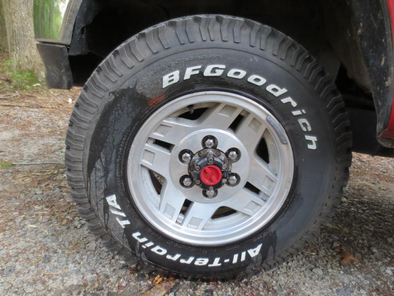

Oh and my buddy hooked me up with an un-named and now unavailable substance to clean my rims. Nice and shiny now.
Got back and went in for an alignment and discovered the source of my ditch fascination. Passenger side was waaaay off. Unfortunately we couldn't fix it as my rear cam bolt is frozen and the tie rod ends were liberally coated in some more of the PO's favorite substance. Red locktite!!
