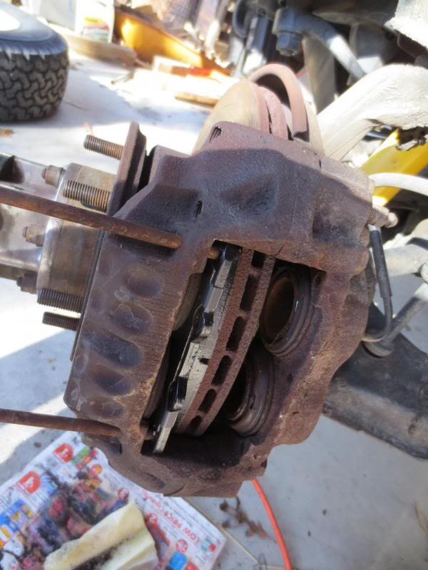

I was just looking at my brake system, and - granted its been a while - it doesn't look the same as the one on my previous truck of the same year. Is there any measurements i can take or something to determine if it has already been upgraded?
The caliper in question:

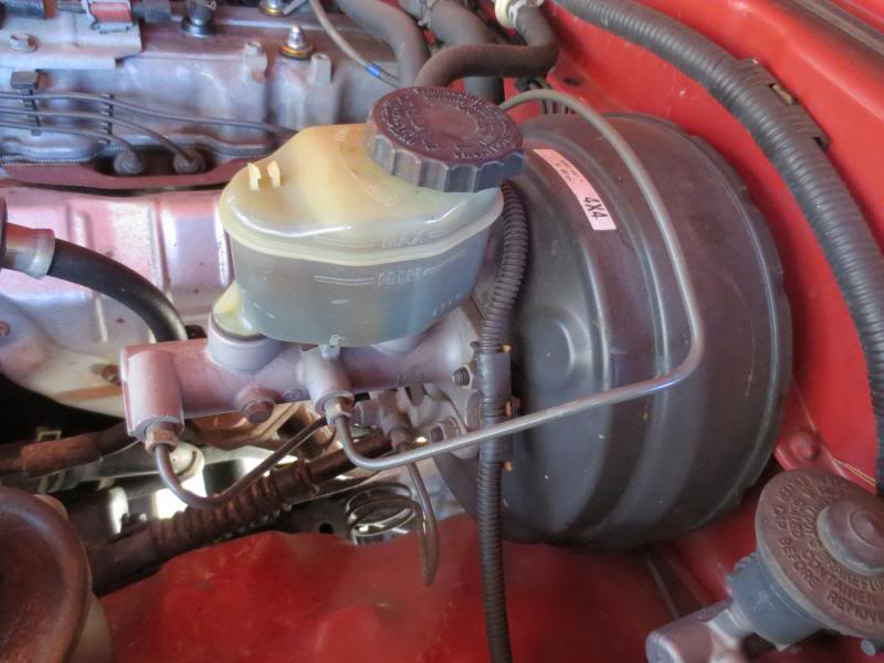

The MC (which is fairly new looking):

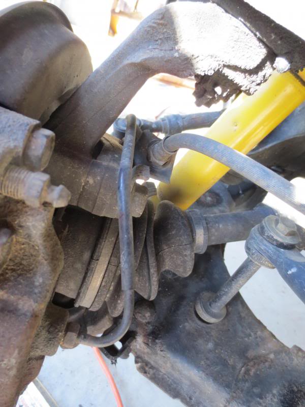

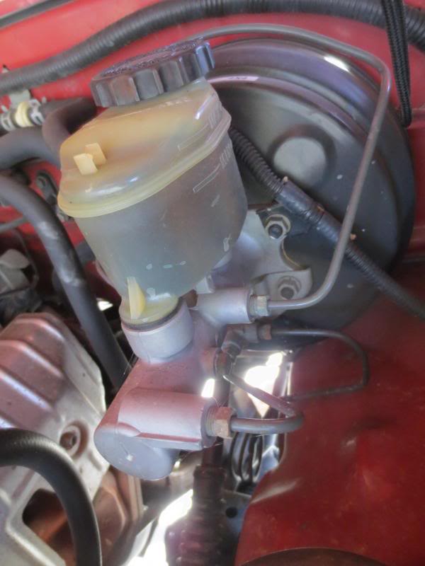

The bore looks a lot thicker than in the pictures in my other truck which is one of the things that makes me wonder.

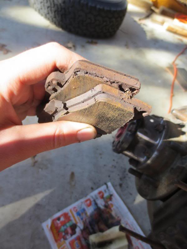

The drastic pad thickness difference:

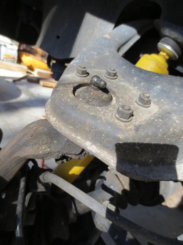

And finally something unrelated but which i had never noticed before; my passenger side upper ball joint is a sealed unit, the drivers side has a grease zerk...

Your MC looks to be the 15/16th bore from the V6 trucks (could be wrong on the bore but it is the bigger one) A really good upgrade is the 1 inch bore FJ master cylinder. Your calipers could have already been upgraded to the v6 ones, When u order the new calipers they will tell you if there is any difference between the part numbers for the v6 or the 4 cylinder. Don't change that hardline for a soft line. Its a hard line to prevent any pinching or damage to the brake system. When i remove the calipers i undo it at the soft line to hardline union so as not to bend the hardline. It is much cheaper to make new hardlines than it is to get them pre-made. If you have a flaring tool and a small bender (think i paid 60 bucks for both of mine including the pipe cutter) you can watch a youtube video on how to properly flare the lines.
As for your balljoint. looks like PO likely just replaced one ball joint instead of both of them. Not that there is anythign wrong with that. Put when it comes to steering and suspension i usually replace things in pairs.
EDIT: If you look around the MC it might be stamped with some numbers, when i replaced my MC it was stamped with bore size and most of the 1 inch bore MC's are stamped 1"

As for your balljoint. looks like PO likely just replaced one ball joint instead of both of them. Not that there is anything wrong with that. Put when it comes to steering and suspension i usually replace things in pairs.

Well it has a big "1" stamped on the side, so thats one upgrade i don't have to do.
As for the caliper... i guess i'll pull it and take it with me to the store and match it. Should it be fairly obvious when placed side by side if its a v6 or 4-cyl caliper? I'm kinda torn on whether or not to do them both at the same time, i mean sure the other one has some surface rust, but it works fine. If money wasn't an issue i would go ahead and do it, but at probably 50 odd bucks a piece there are plenty of things the truck needs that i could buy with that cash.

The only difference you will see is the pistons in the caliper. the 4 cyl is 2 big pistons adn 2 small pistons. the V6 is 4 big pistons. I would replace both calipers at the same time. if you replace the one it will likely pull to one side when your braking. Also always change both sides pads when you do the brakes. don't just do one side and not the other.
4 big pistons, 10-4.
I always change both sides when i do pads, but in this case i'm just going to do the one caliper. If it pulls... well then i'll pony up and do the other side, but at this time of year especially i can't really afford it.
