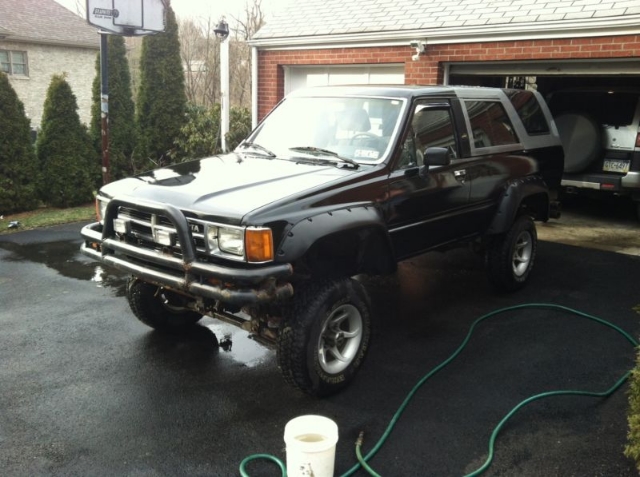

Last December I traded in my 2000 Limited 4Runner on a new car for my wife. Then I sold my convertible (98 GST Spyder) as we prepared a down payment for a new house, which moved my 04 STi to my daily driver...once we moved I was ready for a new toy that gave my STi a break, combined my need for 4wd functionality during colder months, and top off action for the warmer ones.
My search ended in late April when I picked up a fairly nice 89 4Runner. I hopped on a Greyhound bus from Cincinnati to Pittsburgh, and drove my new 4Runner home. It looked like a pretty nice rebuild...but there are many things I would like to make this truck my own.
It was a frame off restoration job - advertised as NO rust...there is a little bit in the bed, and some surface rust underneath. Frame is two years old, it's solid but also has its fare share of surface rust...and the dude was a chain smoker, which he failed to tell me. So, there is work to be done, might as well start a thread on the progress.
Here is the PO (original owner) transformation and the way I took delivery of this classic truck:

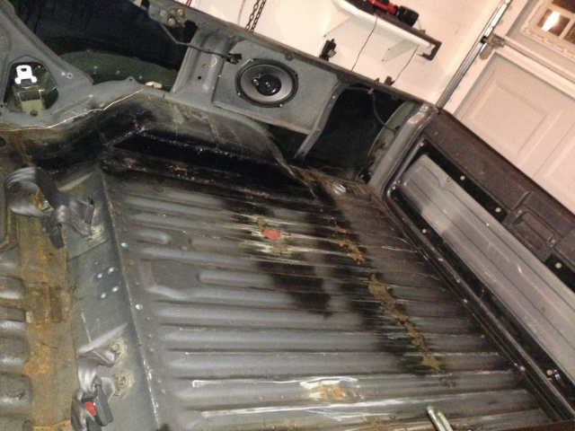

So, chain smoker = interior clean out. I took everything out, and it's all undergone extensive cleaning. For about two weeks the only thing still in the truck was the drivers seat and dashboard. I've dismantled the rear seats and soaked the cushions hoping to eliminate odors, same with headrests. All fabric has been washed, including the carpets. I'm going to attempt to dye the carpets as well, give it a fresh and clean look.
I also discovered some surface rust and a rust hole the size of a nickel under the carpet in the rear. I'll be working on sanding all of this down and prepping for paint - bed liner in the back sounds like a good idea.
When the PO restored the car and swapped frames he also did a lot of welding to fix, what I assume, was large rust holes. They seem to be holding up okay.
Stripped down:
Bed:

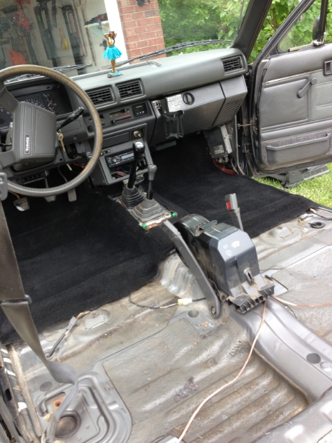

Carpet treatment

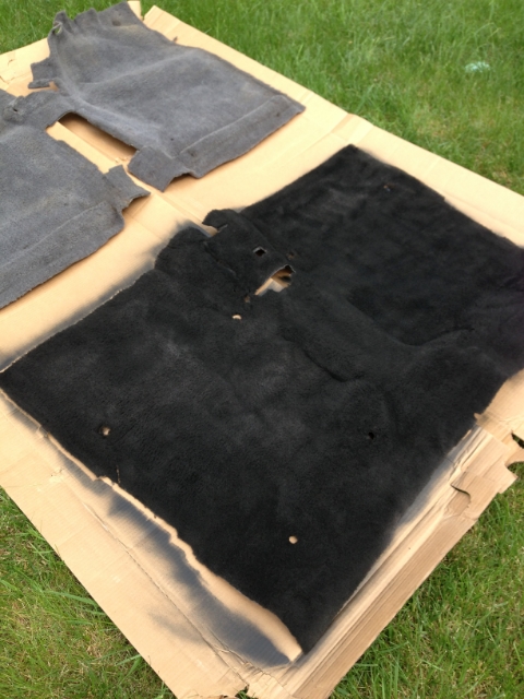

I decided I'd try my hand at painting my carpets after the cleaning the thoroughly. I used this Duplicolor stuff after reading reviews, and at $8.00 a can I figured it was worth a shot - worst case scenario...my carpets still look terrible.
I think it turned out really well. Used 3 cans to get good coverage on the carpet. I also added a new shift boot and removed a lot of trim, cleaned it, and added bed liner to it.
Duplicolor:
First coat:
You can see what I was trying to cover up:
Front back in:
All back in:

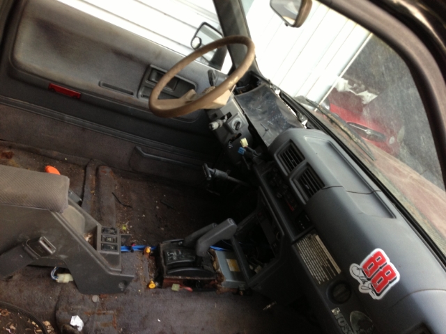

The work has been slow on my 4runner because I've spent so much time stripping my donor truck. There's something satisfying about taking apart a truck and not having to keep track of bolts or where things are supposed to go
The donor truck has supplied a few things for me - the rear mud guard under the bumper was in perfect shape, and it also came with a sturdy hitch...so I pillaged those for my use. I also plan on pulling the Aisin hubs and replacing my Warn hubs...despite the fact that the Warns are working perfect it seems that the Aisin's are just preferred by about everyone.

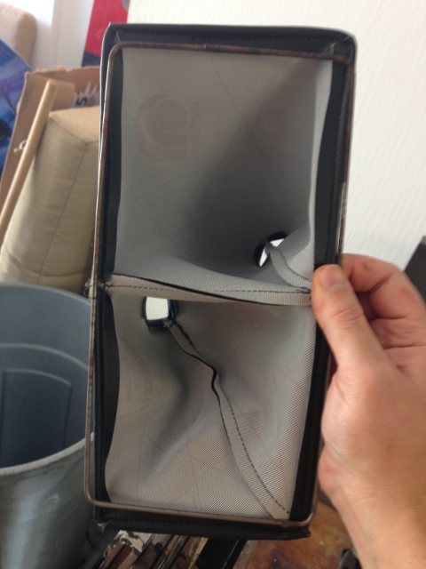

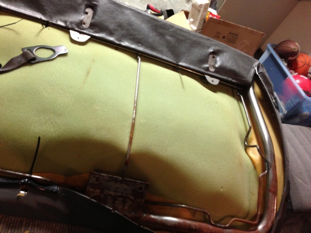

I've also started to reassemble a good part of the interior - I stripped the fabric off the rear seats, cleaned the cushions with a one week soak in soapy water, and ran the fabric through the wash...now that everything is dry and back on it looks barely used!
I also have a for sale thread at tr4.org, if anyone is curious about parts...lots I don't need: http://www.toyota-4runner.org/sale-t...incinnati.html
Reassembling back seats:

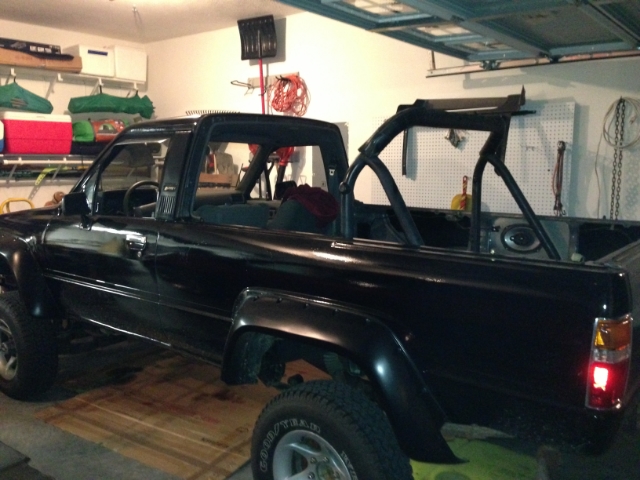

Progress on the old parts mobile, once the top is gone it will be almost unrecognizable at to make/model.

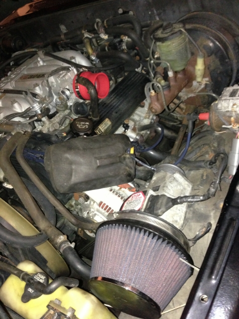

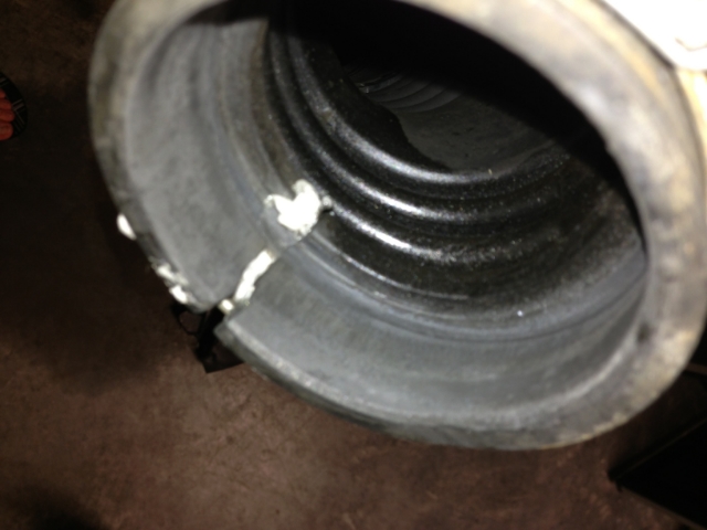

In between the time I've spent stripping the parts truck I've managed to pull some items for myself and get them installed. I also removed my front and rear tube bumpers and went back to the stock look - which I love. The parts truck also had a heavy duty hitch that I've taken off but have yet to put on my truck.

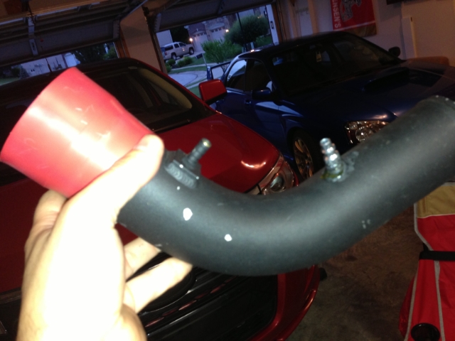

First thing I did was rig up a system for the K&N filter that came with the parts truck. If you search ISR (intake silencer removal) there are tons of ways to do this. I took bit and pieces of advice...and ended up building my own system from some hose couplers, an old front mount intercooler elbow, and some nipples (hehehehe).
When I pulled the intake off I clearly had a leak, so I knew I'd need to work up a replacement for this: Name:  null-4.jpg
I followed some posted info on several peoples intake builds, went to lowes, got some 3" - 2.5" couplers, a few nipples, and returned home...but the couplers were just way to big...and the 2.5" side was way to small. I wanted a perfect fit with zero room for leaks...so I ordered some basic 2.75" - 2.5" reducing couplers on ebay ($14 shipped). And they fit perfect on both the intake and the intercooler pipe I was reusing.

The intercooler pipe I was reusing - 2.5", had one nipple on it already, so I drilled a hole, fitted a second nipple, bolt on the inside, and some rtv sealant for safe measure.

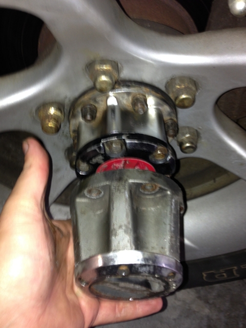

Then I swapped hubs. Went from the WARN hubs that came on the truck from the PO, to the Aisin hubs off the donor truck. Once I knew what I was doing the process took 20 minutes a side. I spent more time cleaning old grease and lubing up parts then I did on anything else.
Aisin's on and in place...awaiting torqueage:
The size difference and appearance is very noticeable between the two:
And I also love only having to turn the Aisin's a 1/4 turn, compared to the nearly full turn you have to make with the WARN hubs:

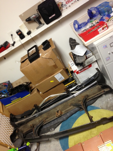

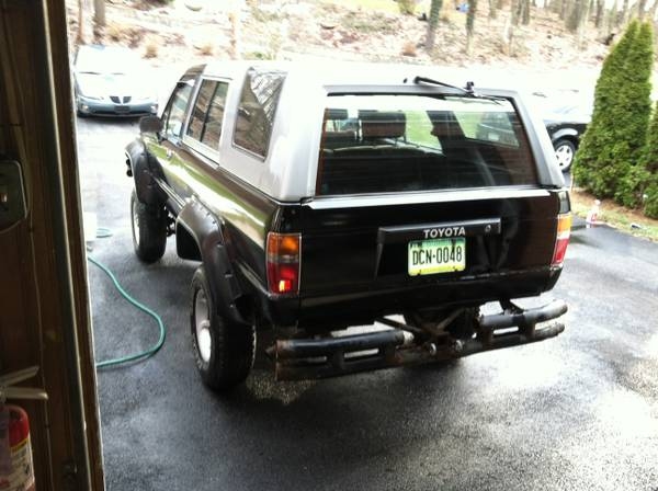

And then I finally removed the tube bumpers the truck came with. Just too much for my taste. Although I miss the feeling that I had with them on...the feeling that I can just push any idiot out of the way if they annoyed me on the road. Here is the clean look front end:
And I also reinstalled the fresh and clean back seats for my kids to ride in...but they always end up in my seat. But we all went for ice cream after a long day of work:

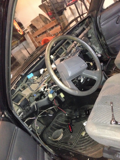

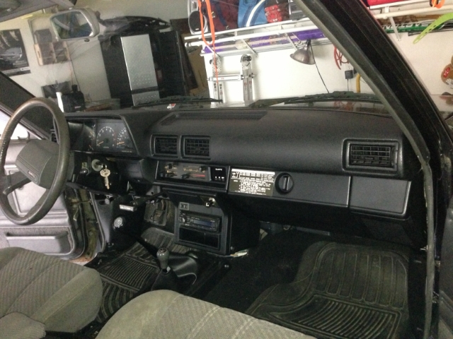

A nice Sunday with nothing to do quickly turned into the next on my project list - finishing the interior dash. It's not in bad shape, but the cracked dash bothers me and all the different shades of gray. Plus the fact that cleaning as much of this truck as possible will eliminate the now faint smoke smell - it's almost gone!
So, yesterday was removal and paint prep. We've all seen the painted interiors of our random friends ricer that slowly starts to chip off and then looks terrible. Usually because the didn't prep anything.
A good bath + wax/grease remover will go a long long way. I tested this first, just to see if I liked the outcome. As you may notice in some of the previous posts, the center console and shifter trim are now black...bedliner black. I also think the spray on bedliner will hold up better on all of these parts.
Now, I just have to remember where all these wires go...

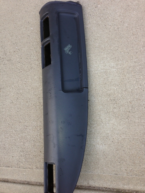

cracked dash - I'm going to try some bondo-ing first...we'll see where that gets me. Leftover tape from my hula girl (she will return)was a quick fix with goo gone:

Dash is done! Looks really good, VERY happy with the results! I also added a center pocket under my radio where there was previously a giant hole...much cleaner now!

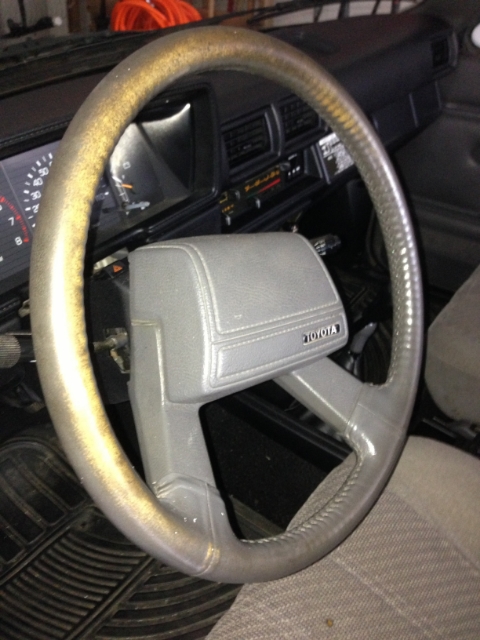

Now I just need to figure out a steering wheel solution. I have the center cap off now and it's held paint well after a thorough prepping, but I can't decide if I want a smaller wheel, or just get a cover for this old faded junk:
