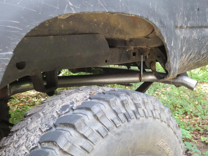

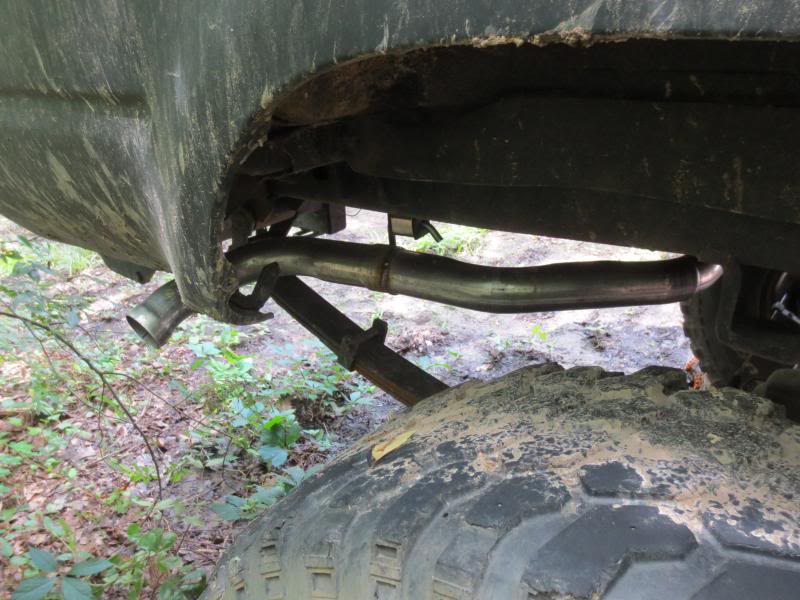

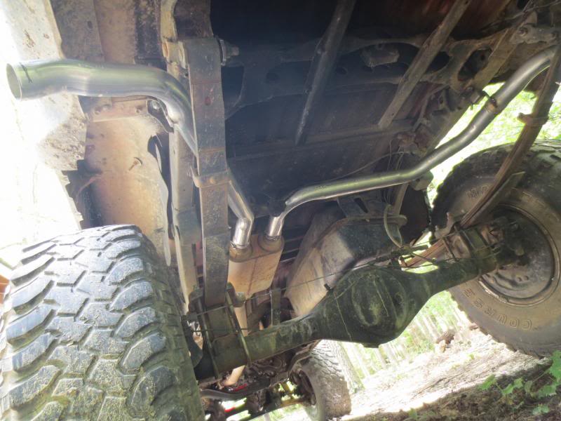

Okay here are the pics i promised.
New tailpipes:
Driver Side
Pass Side
Underneath, i think he left enough room to put a full-size spare under there if i find some mounting hardware.

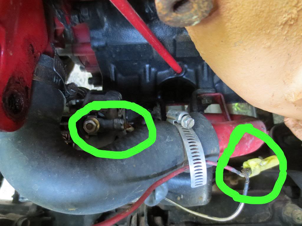

And the alternator wiring i mentioned earlier:
Don't know if you noticed, but my alt wire is about worn through. And i wondered why my battery light flashes. And the ground is sketch.
So i obviously need to do some work on that. Not sure exactly what yet but we will see.
As for the tail pipes, not sure if i like the new sound yet, but it is definitely quieter, i can actually hear myself think now. Do i need to paint them with something to stop rust?

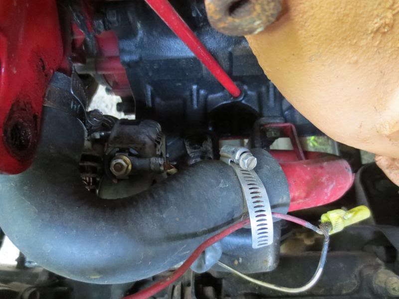

Okay, i got under the hood, and toyota threw me a curve ball right off the bat...
the alt wire goes approximately 3 feet before terminating in a black box behind the air box.
This is it closed with the alt end already removed.
Open. The alt side wire goes in the open slot and bolts over the top of that other wire.
Is that stock? Either way i'm running out of time, besides being out of my depth deciding fuse box or inline and all the circuits, so unless someone posts before i finish my breather i am just going to replace this section and leave everything else stock for now.

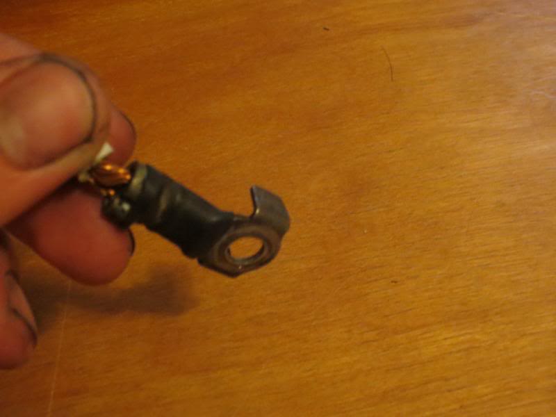

So i replaced the wire from the alt to the + box thingy, then loomed it and taped it all up nice and pretty before slapping the air box back in and firing her up.
And ...... the alt wont charge!!!
Now the only thing i changed is that where the stock wiring had a weird bunny eared ring terminal i substituted a standard one as i couldn't find one like it.
Apparently those ears are important...
At least that's all i can figure, i pulled the air box back off and all my connections are solid.
Any ideas?

Well those bunny ears are not the issue, would have been surprised if they were, but i can hope right?
The battery was dead this morning so i have a short somewhere and now i am confused stressed and rushing to figure this out before work tomorrow. Not a good combination. And to top things off i can't figure out how to get my multimeter to work.
