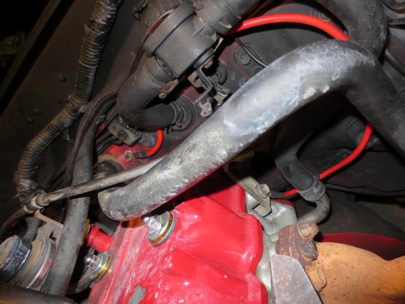

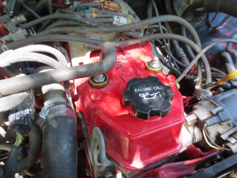

That is what the corrosion looks like, a little whiter in person but on the whole not terrible. Just irritating.

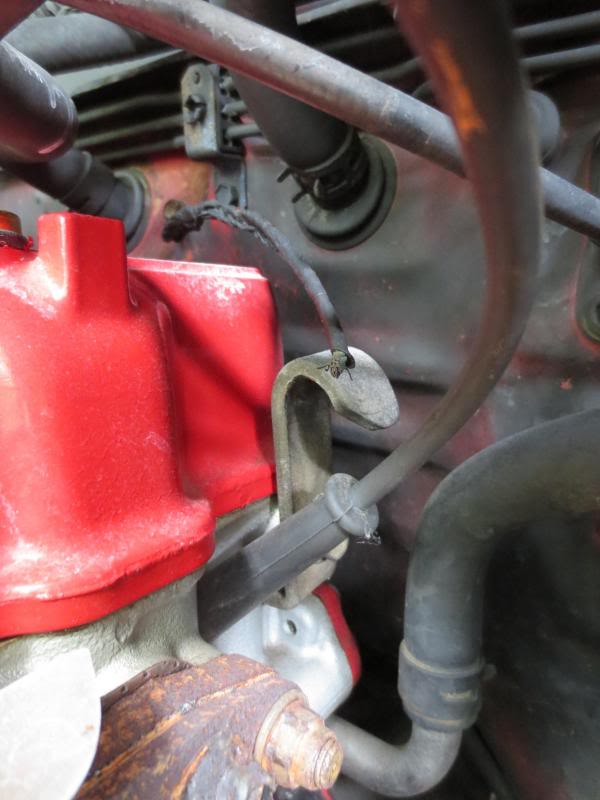

A loose cable i found tucked behind the headlight. Any ideas?
Plugging in the TPS seems to have brought my idle down a little 1k rather 1200 at startup, will have to watch and see what it does when it is warm.

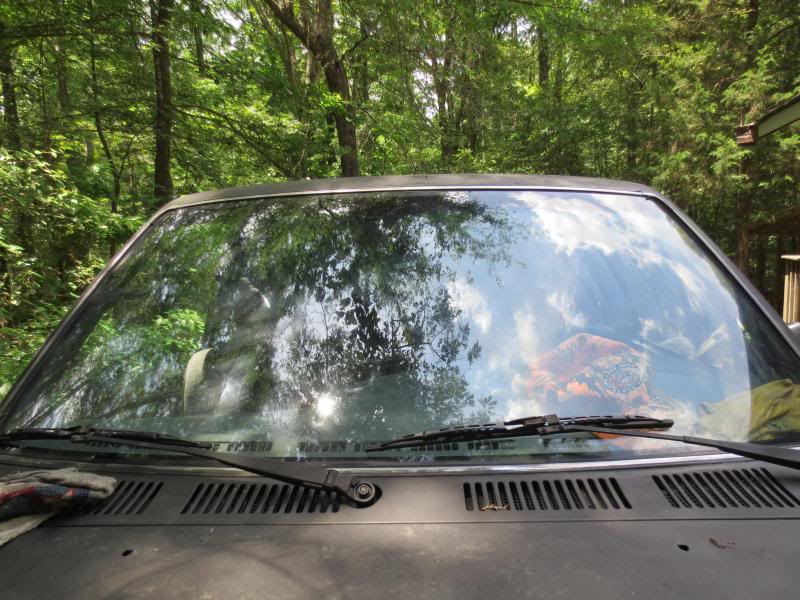

Got all the overs pray off the windows. I can see!! Also the PO had a can of red spray paint explode under the passenger seat and there were drips all over the back window(some still visible on trim and ceiling) so just removing that made a huge difference, but then removing the black haze. WOW, i like it.

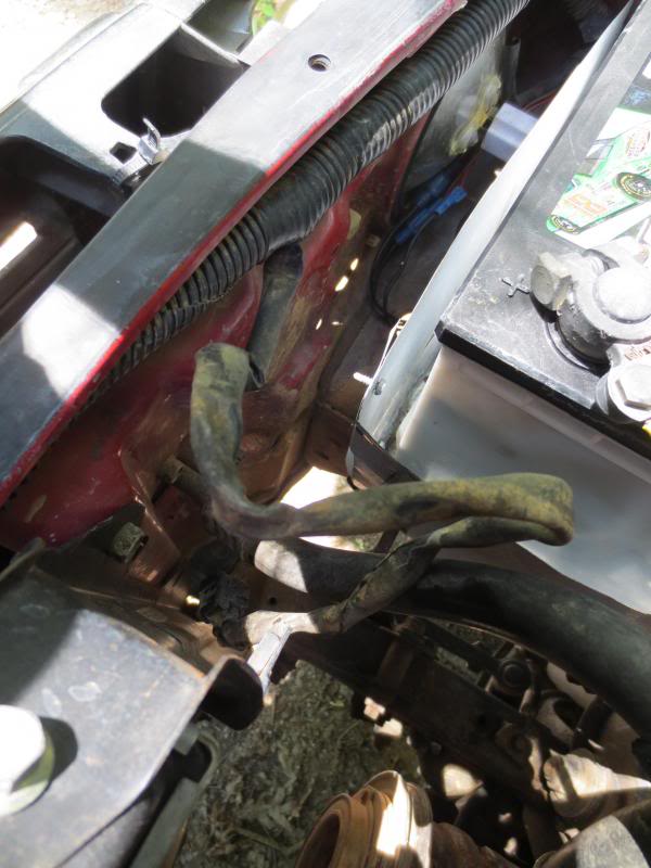

So i decided while i'm in there i will do both the battery cables too as they are not in the best shape. I'm hoping i can just un bolt those terminals and remove the battery cables then bolt new ones in(not sure if they are soldered) then i can switch to a set of heavy duty terminals at some point in the future.
The positive terminal has the starter cable, an aux light cable and the fuse box, i understand all of those.

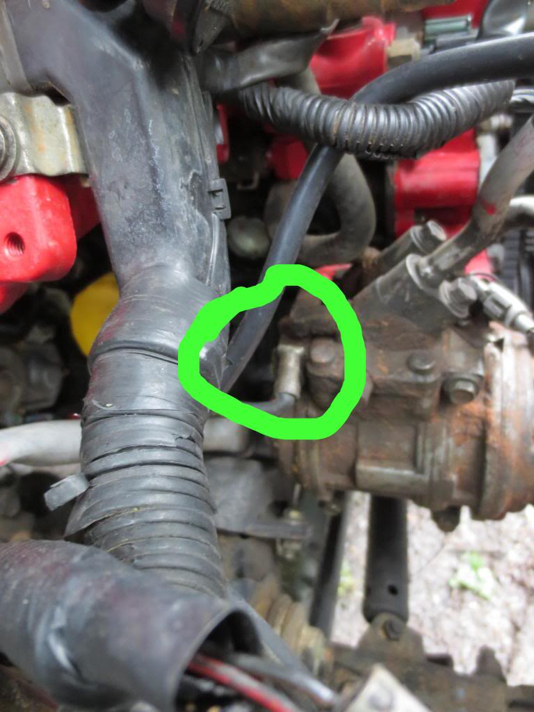

But the negative terminal has one cable, and it runs the AC unit.
I don't understand what that is. I assume its some kind of ground.
I believe that the battery ground should also attach to this terminal, correct?

I was thinking for the (+) cable replacing it with this as its cheap and locally available. http://shop.advanceautoparts.com/web...605#fragment-2
And a shorter version of the same for the negative cable(the one whose use i am ignorant of).
As for the ground cables, i thought just pick up whatever the heaviest gauge cable my local hardware store has for cheap (6 or 8 ga probably) some crimp ends and some heat shrink.
I also plan to pick up a multimeter for other troubleshooting and possibly a solder gun for future repairs.
Any suggestions or advice on this plan?

Block to firewall ground. Routed way out of the way like that because the previous ground had melted and did not have much insulation left when i pulled out the remnants. It is this long re-route that caused my running out of wire.
