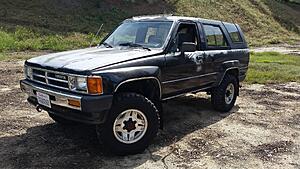

Hey everyone,
Im new here, Just picked up this 87 SR5 Runner. Not my first truck and not my first Yota. However, this is my first 4runner and 22RE.
Been using this forum to get this project DD & camping worthy and reading up to learn more about this truck. Always wanted one, finally pulled the trigger.
Currently it has a few issues but mostly in pretty good mechanical shape. So far I've mostly done tune up stuff and basic "new purchase assessment" related fixes, as it sat for about a couple years.
Once its running the way I like it to I'll start working on the fun stuff. Basically a Daily Driven weekend warrior camping setup for the fam and I.

Looks like it is in pretty good shape overall, and I love the look of the stock sr5 rims
Yeah, its in decent shape overall. body has a few blemishes but nothing extreme, no major rust! A little surface rust but that's all.
I love these wheels too, just need to find one more before I get new tires.

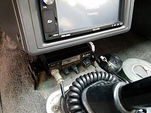

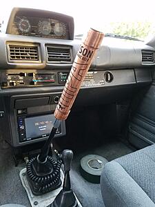

Killed some time the other day by putting my PA/CB and (Temporary) "LONG THROW" tap handle shift knob. Haha

I like the tap handle. I have been looking for a Natty Boh one to put in mine. I wish my cb would fit right there, but at the hunt club they run on high and low frequencies which I couldn't find a small sized radio to fit underneath. Guess ill just have to go to the glovebox mount again.
Thanks, it definitely needs a short shifter soon the extra height makes the sloppy shifter even worse.
The CB location is temporary until I get the center console plans set in motion.

From: Tidewater, Va
could you drill out the tap handle to where it fit down on the shifter more? make it shorter that way maybe?
It's a temporary setup. My buddy wanted me to do it. Prob won't last too long. There are other things I would rather spend time on. Need to adjust valves, front main seal needed, late model plenum swap to fix the cold start stumbles, retap exhaust studs in the head, etc.
I'll prob put more effort into the tap later down the road.
