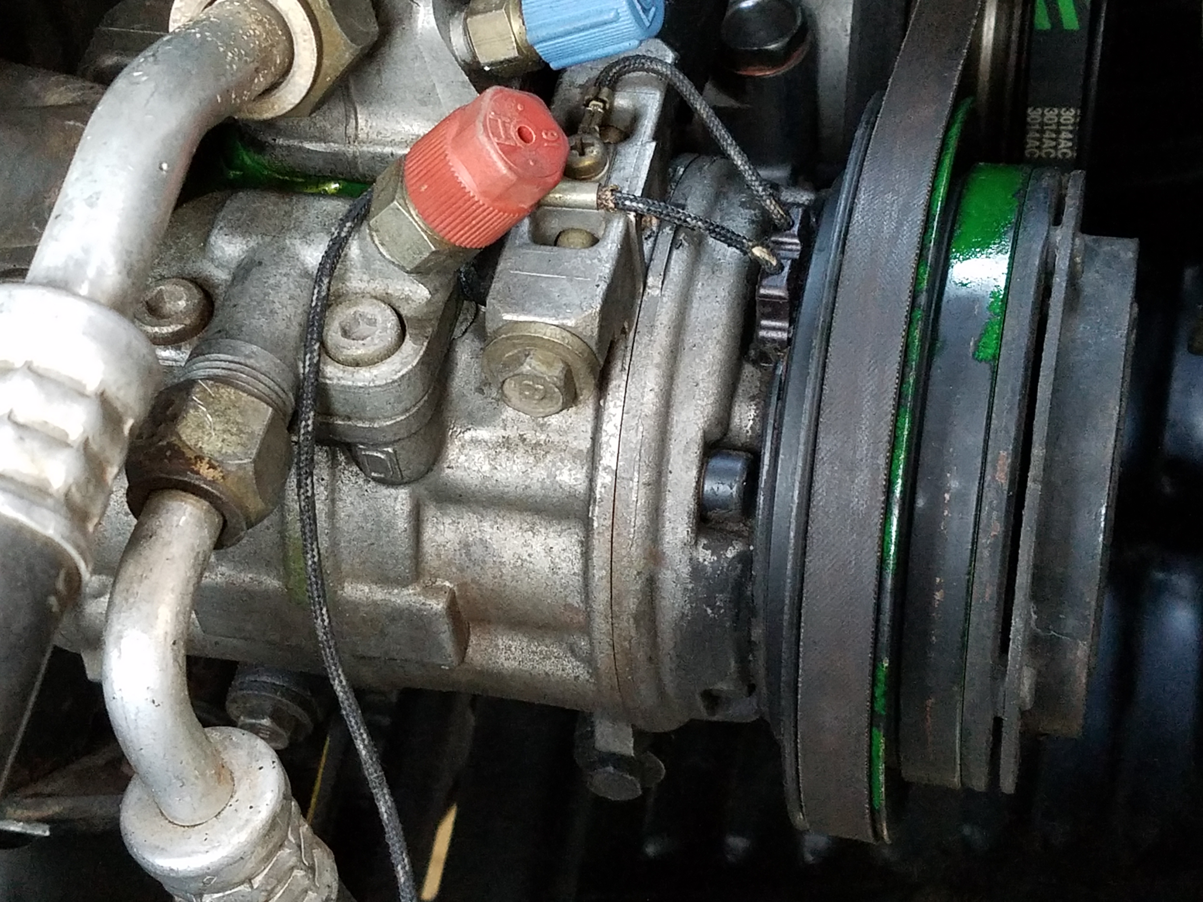

Rented an A/C Manifold gauge set and a vacuum pump to test out the "retrofitted" AC that has never worked. Turns out it wont hold vacuum so there is a leak somewhere. I have a new dryer for it but wont put it in until I find the leak. Dont know the status of the system so I guess a full system flush and all O-rings replacement is in my future. Might as well grab a expansion valve too. Or just charge it with some stop leak R134a, but I dont want to clog the system.

R134 runs at a higher pressure than the old r12 and typically will blow out the compressor shaft seal.
I tried 414b in mine and a week later the compressor seal went kaput. I would venture to guess that's the most likely cause of your leak.
Although mostly I'll advised you can put some pressure in it with an air compressor and find the leak that way. Then just change the leaking parts, and the filter drier then pull a good long vacuum to remove moistureand air from the system

Wow you called that one! Pulled a vacuum injected some UV dye and jumpped the compressor for a minute or so... Well, time to source a new compressor. I'll slowly start gathering parts to do it properly; expansion valve, new Orings, compressor, already have a new drier. etc. looks like I wont have A/C for some time.
Good call 92ehatch!

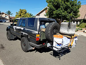

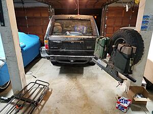

The Wilco HitchGate was Awesome! Swing out tire carrier that is mounted in the tow hitch is a great idea. Carried my ammo can tool box/first aid kit and 5Gal water Jerry can and my 31" spare. Plus it still has a 2" receiver for my hitch rack to carry the fire pit and cooler. I threw on some Autozone Cheapo longer shackles for the trip to help out with the extra load.
Loaded!

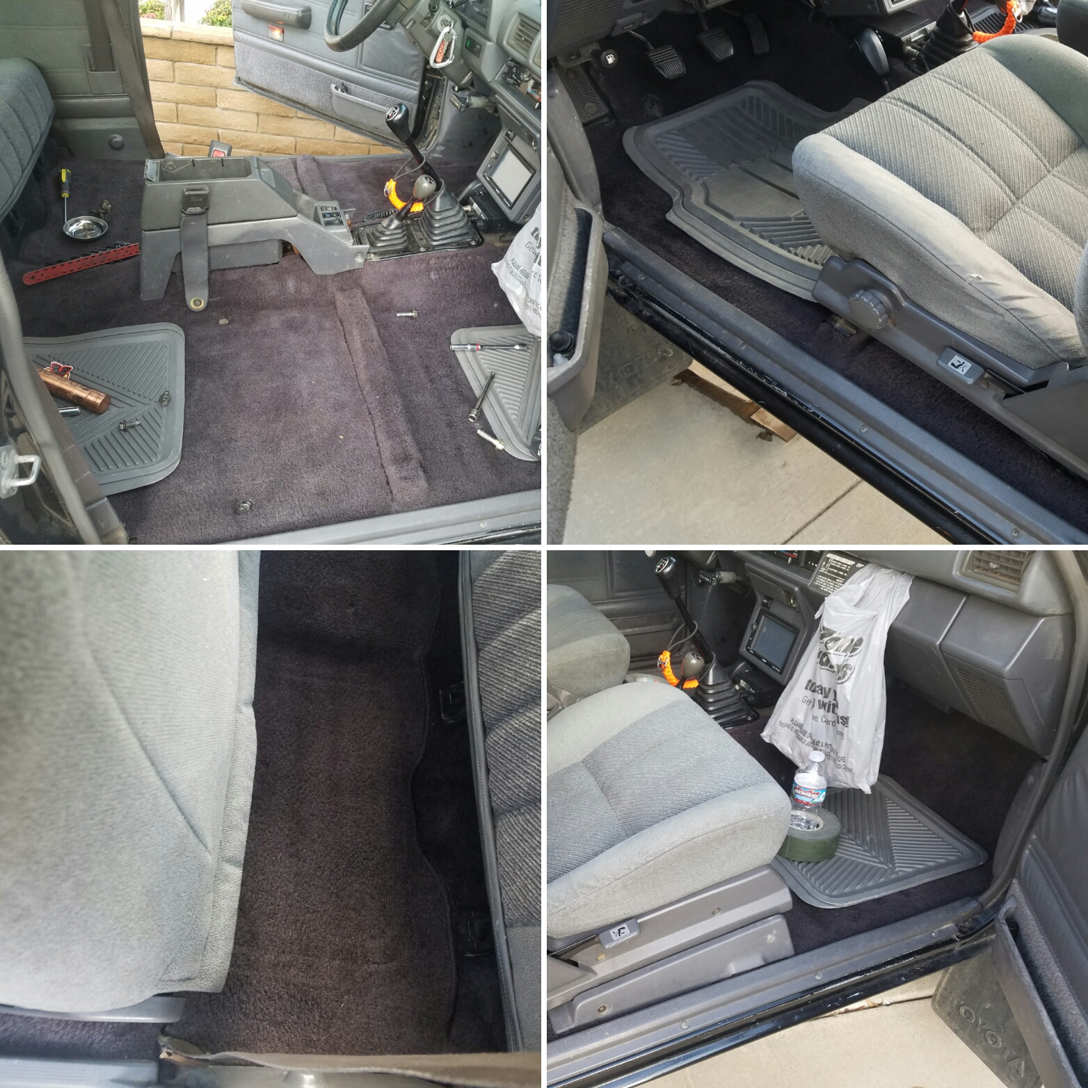

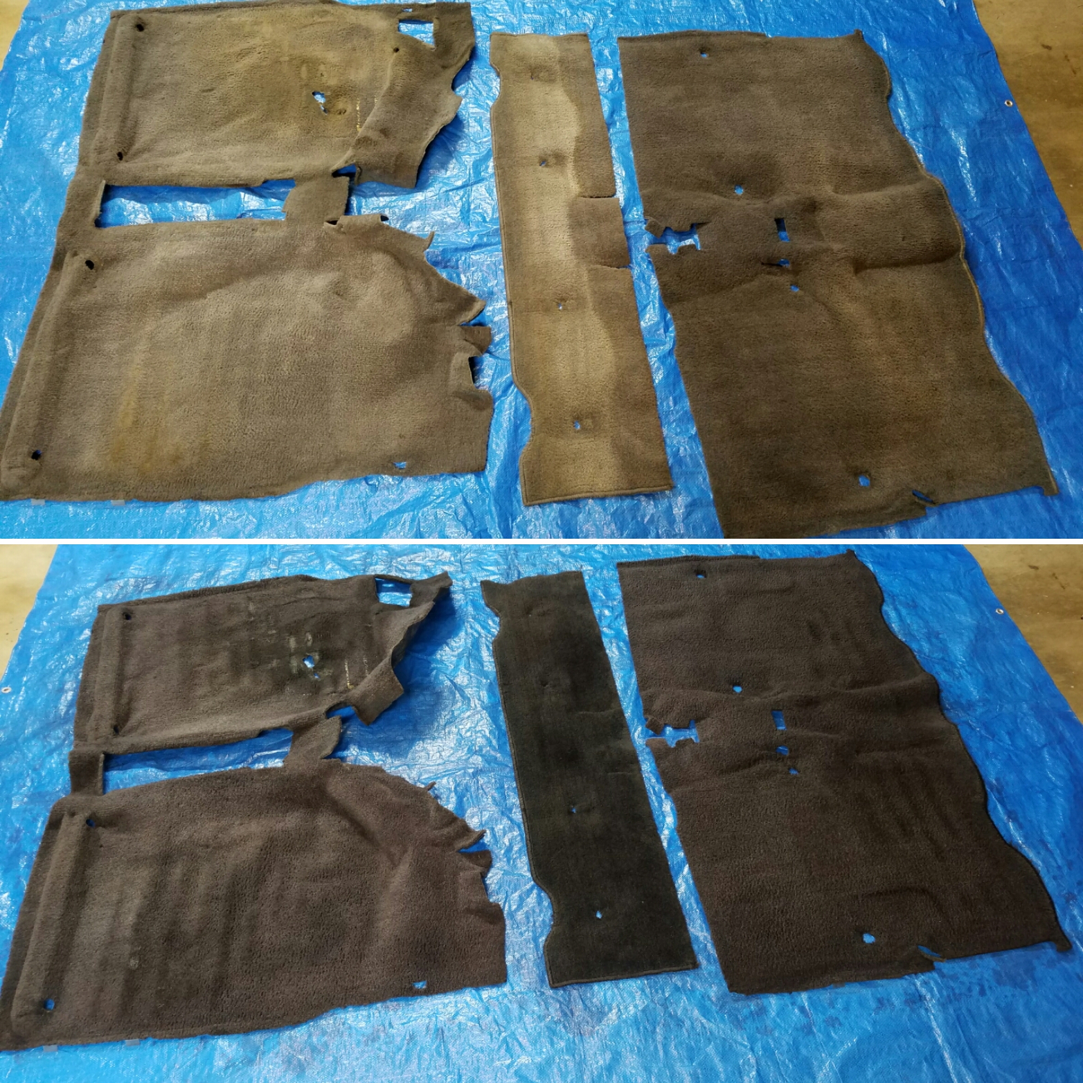

Lots of rain recently so I played in some water with the yota; went a little deep and saturated all my carpet. Pulled out the soaked carpet and did a pressure wash to clean them up a bit. Decided to grab a bottle of RIT dye from the grocery store and tint the carpet a little darker to hide some of the stains. Mixed a gallon of warm water and the bottle of liquid dye (black), applied it with a spray bottle worked it in by hand and with a brush. Dry time took longer than expected, about 2 days in the garage because it was raining.
Can't beat 6 bucks for a bottle of dye and a few hours of work. Overall I am happy with it. We'll see how long it holds up.

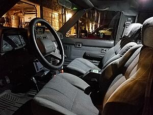

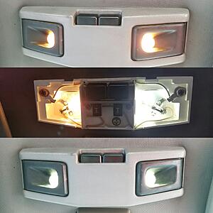

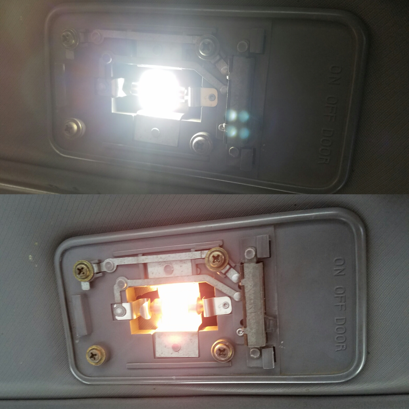

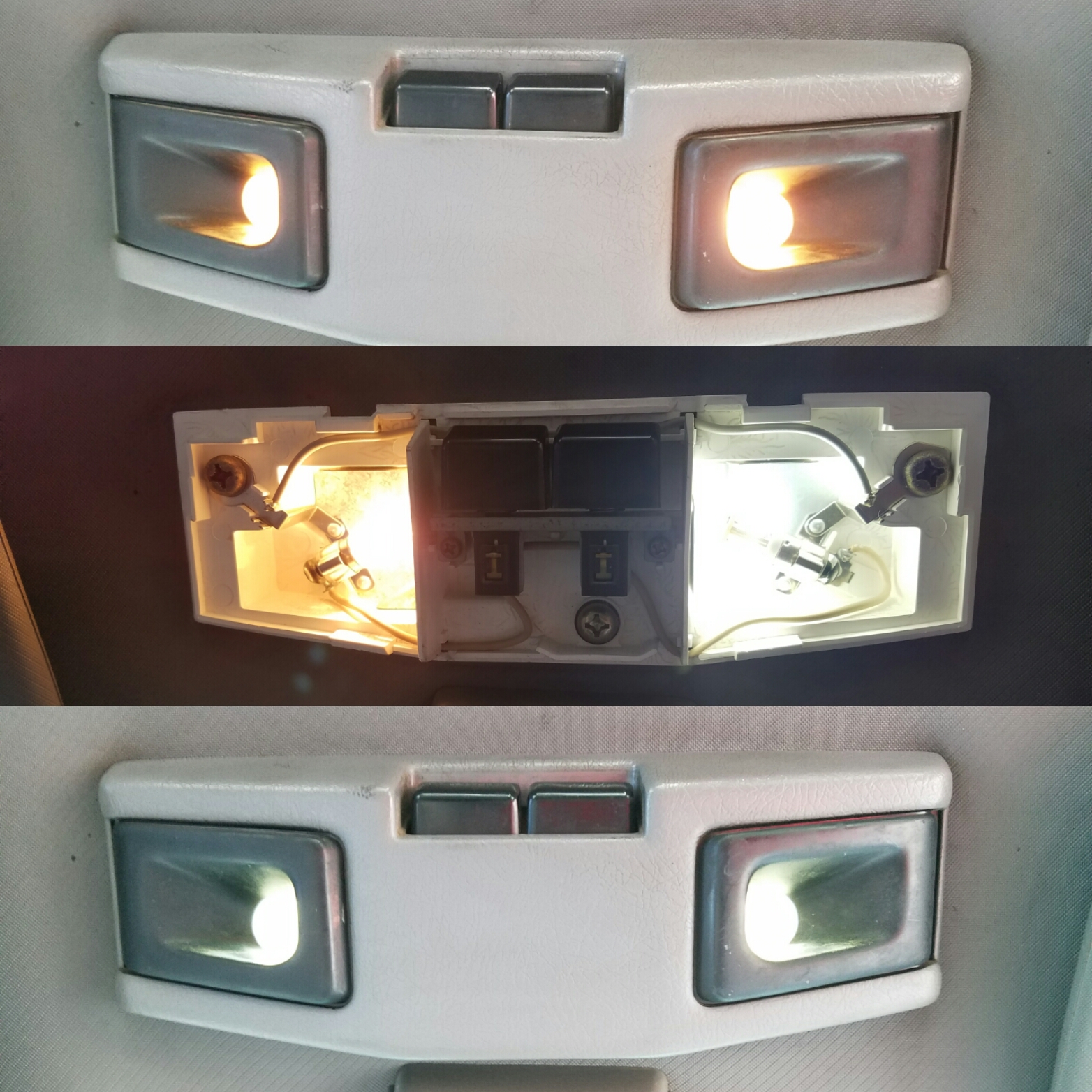

On a side note I got some LED lights for the dome, doors, cargo and SR5 Map lights from superbrightleds.com - The interior is VERY bright at night now. I also ordered some cheap red LEDs from amazon to test out in my gauges. Pack of 20 for 8 bucks. 194s. I'll throw a pic up when I get them in.
SR5 Map light. Ba9
Dome Light 80 lumen 4 LED festoon.
This is just the dome light on.

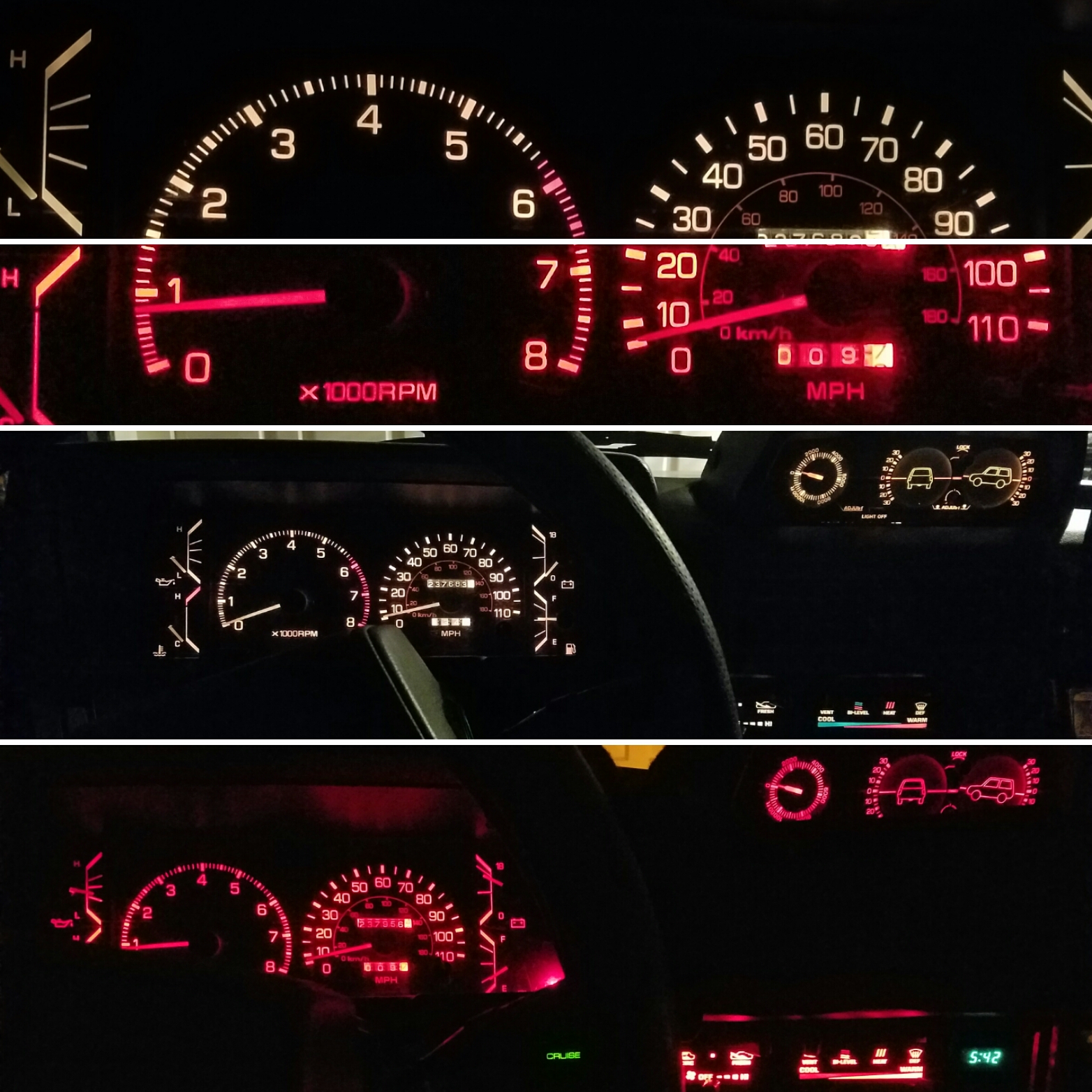

Red LED gauges compared to the regular 194 incandescent bulbs. I liked the regular bulbs but I'll rock these for a bit.

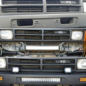

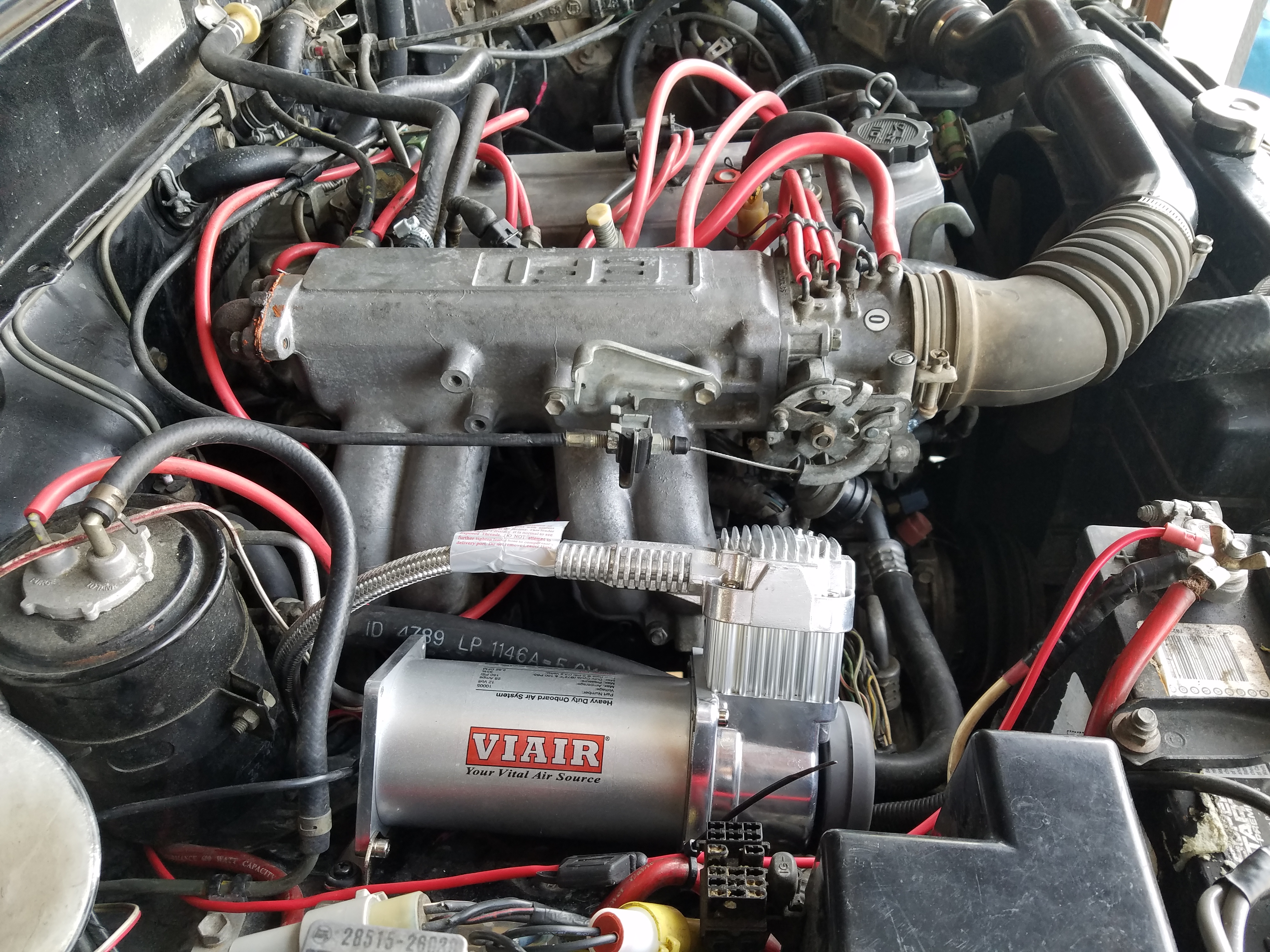

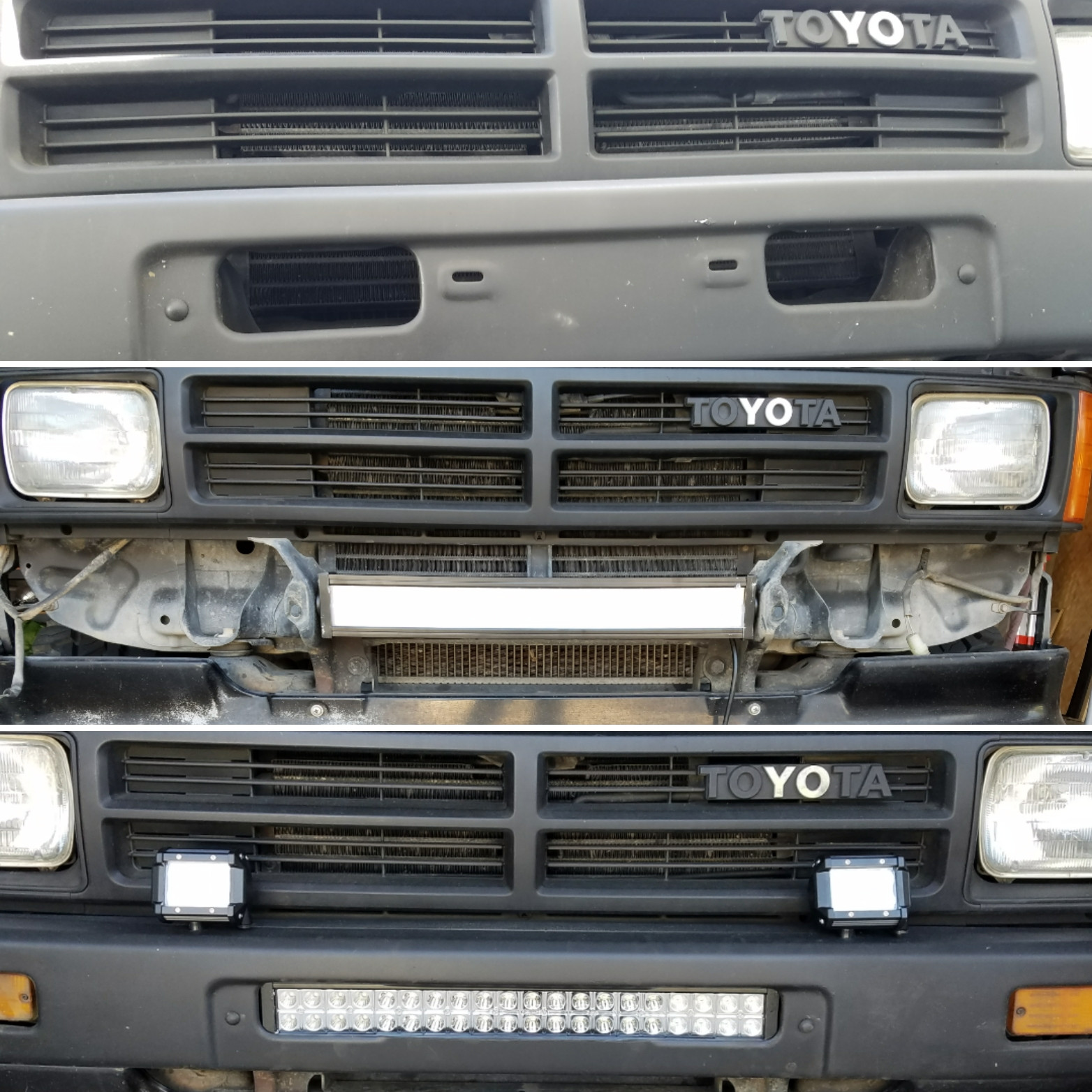

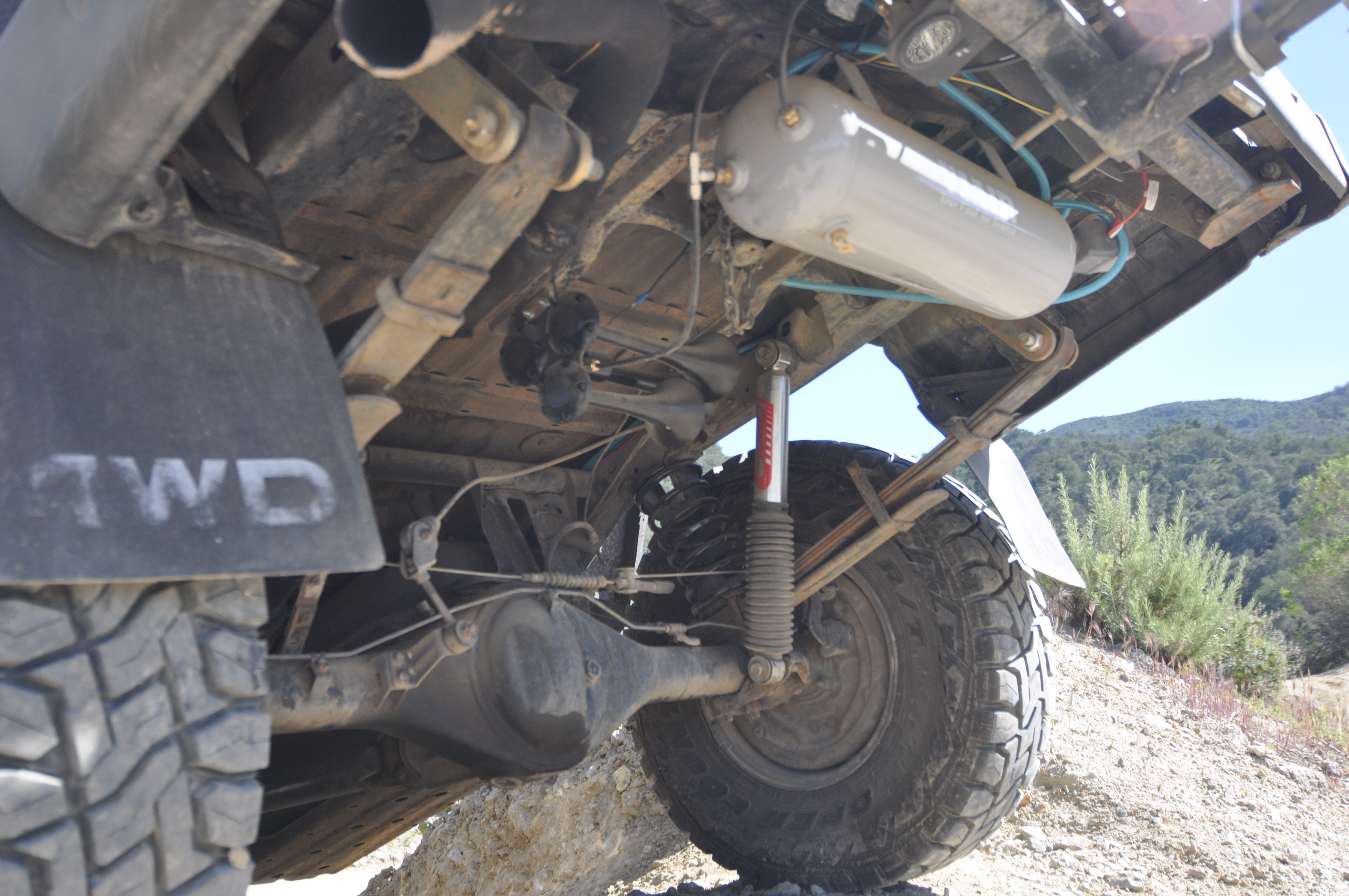

Had a busy weekend in the garage.
LCE vacuum kit
Late model plenum and throttle body swap finally ditched the aux air valve garbage.

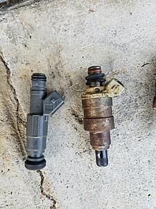

220cc 4 hole injectors

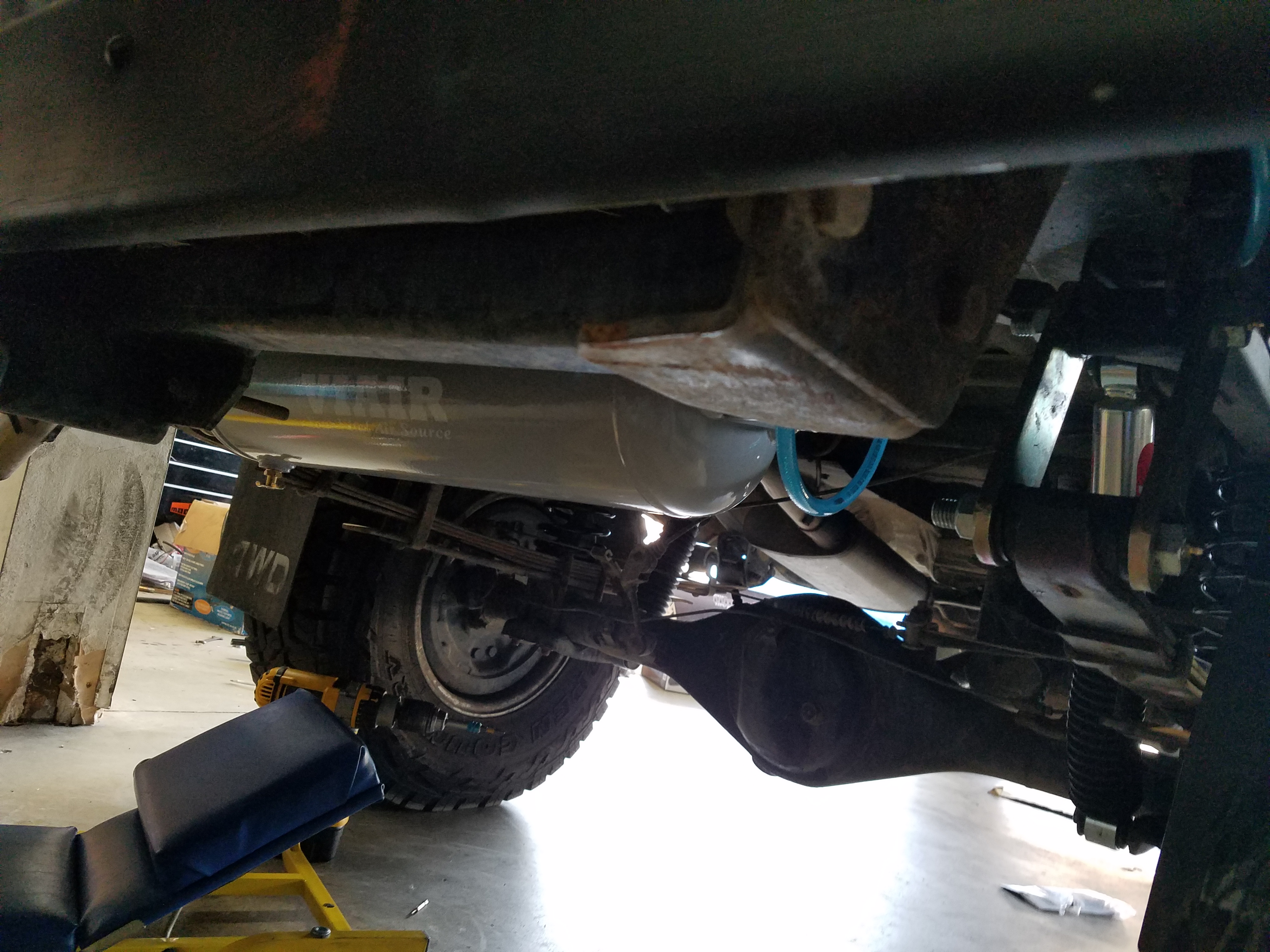

Viair Heavy Duty on board air system

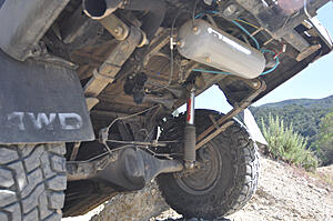

No Cut Zuk Mod Southwest Speed 11"x5" 125# springs
Low Range Offroad greasable 6" shackles
Eibach protruck shocks
Recessed a 20" LED bar in the front bumper
LED Pods on the bumper

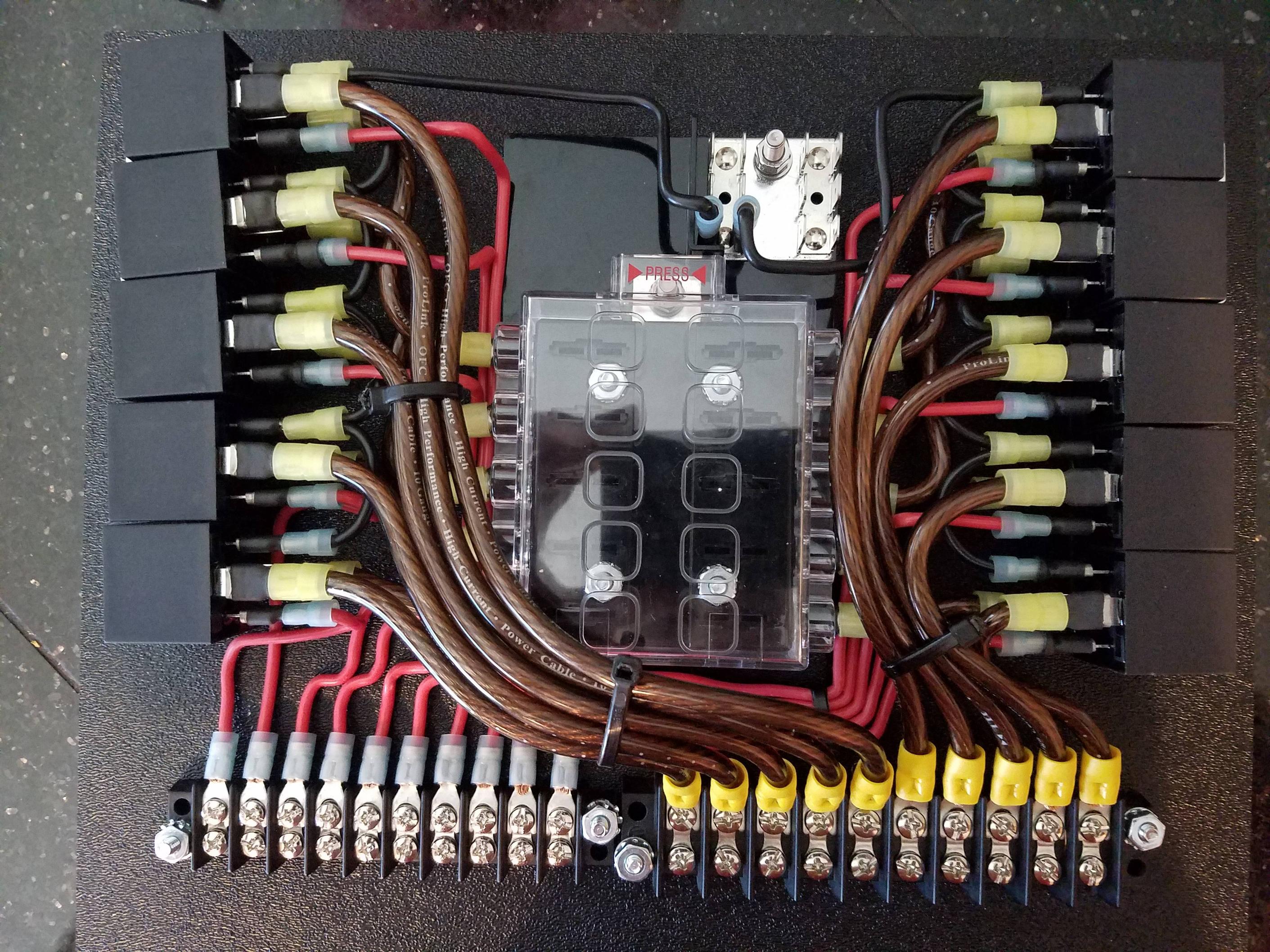

Built a relay board but haven't installed it yet. I have a bunch of switches and stuff to put together too. Got a dual diaphragm booster and 1" master to put in too.

Nice! Clean electrical work!

Wow you did have a busy weekend. Very nice relay board.

Since I did all this work, I have noticed a slight drop in MPG because of the injectors. Kind of expected it because they are 220cc where the stockers were around 185cc I think. It was a good sacrifice for me because it is so much smoother in the higher RPM range. I noticed a struggle above 3500 RPM previously that I thought was weak valve springs or something. Now I know it was just starving for fuel. It runs strong all the way up to 5500.

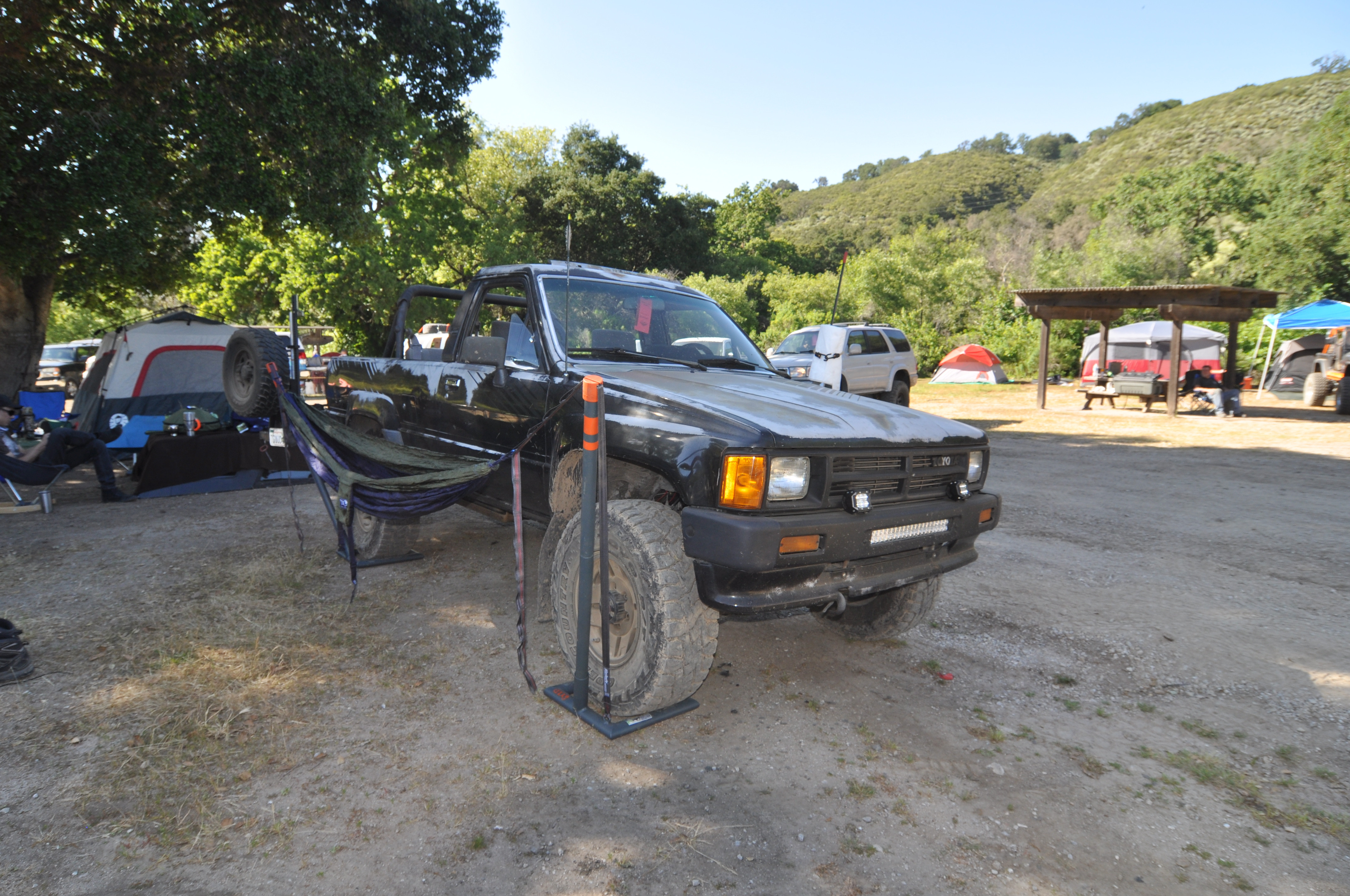

Just got back from a +1000 mile trip from socal to norcal hitting Hollister OHV park on the way. The truck did awesome! Loaded down with about 500 extra pounds and 3 adults in the truck the ZUK mod still kept it from sagging. Overall really happy with the latest mods. Oh and not having to find a compressor or gas station to refill tires after the trails was great as well.

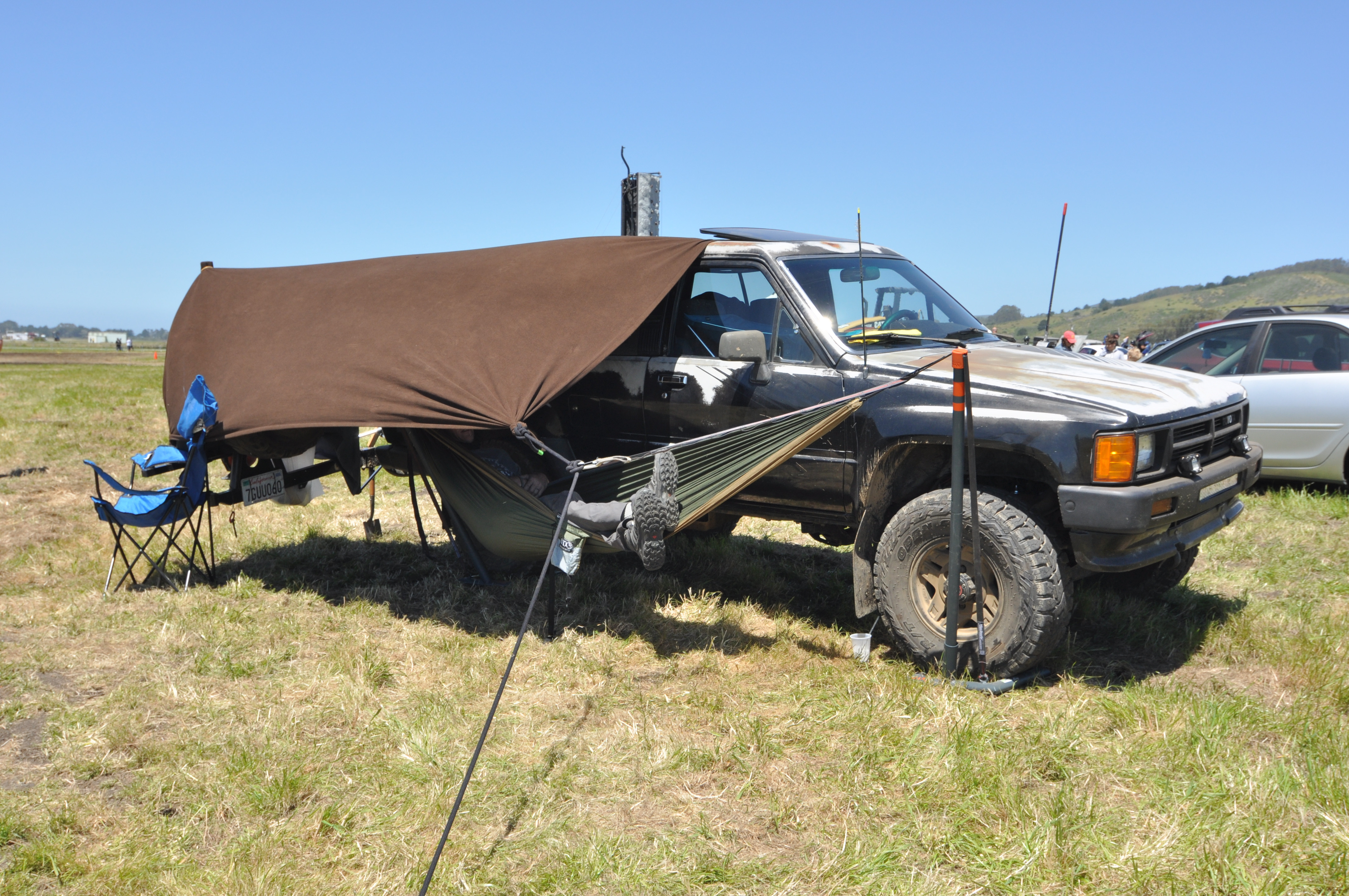

Took the top off and used it as a camping table.

Did a Q&A with VIAIR about their Heavy Duty OBA system I installed for the trip out to Overland Expo West 2017. Nice to see a first gen getting some love.
Q&A Link: http://www.viaircorp.com/shows-and-e...and-expo-west/
Took about 100 miles of the Mojave road heading out there. Along with some Colorado River fun and Grand Canyon at sunrise while heading home. Over the course of 2 weeks I put 2500 miles on my 87! It did great, except up hill, haha.
