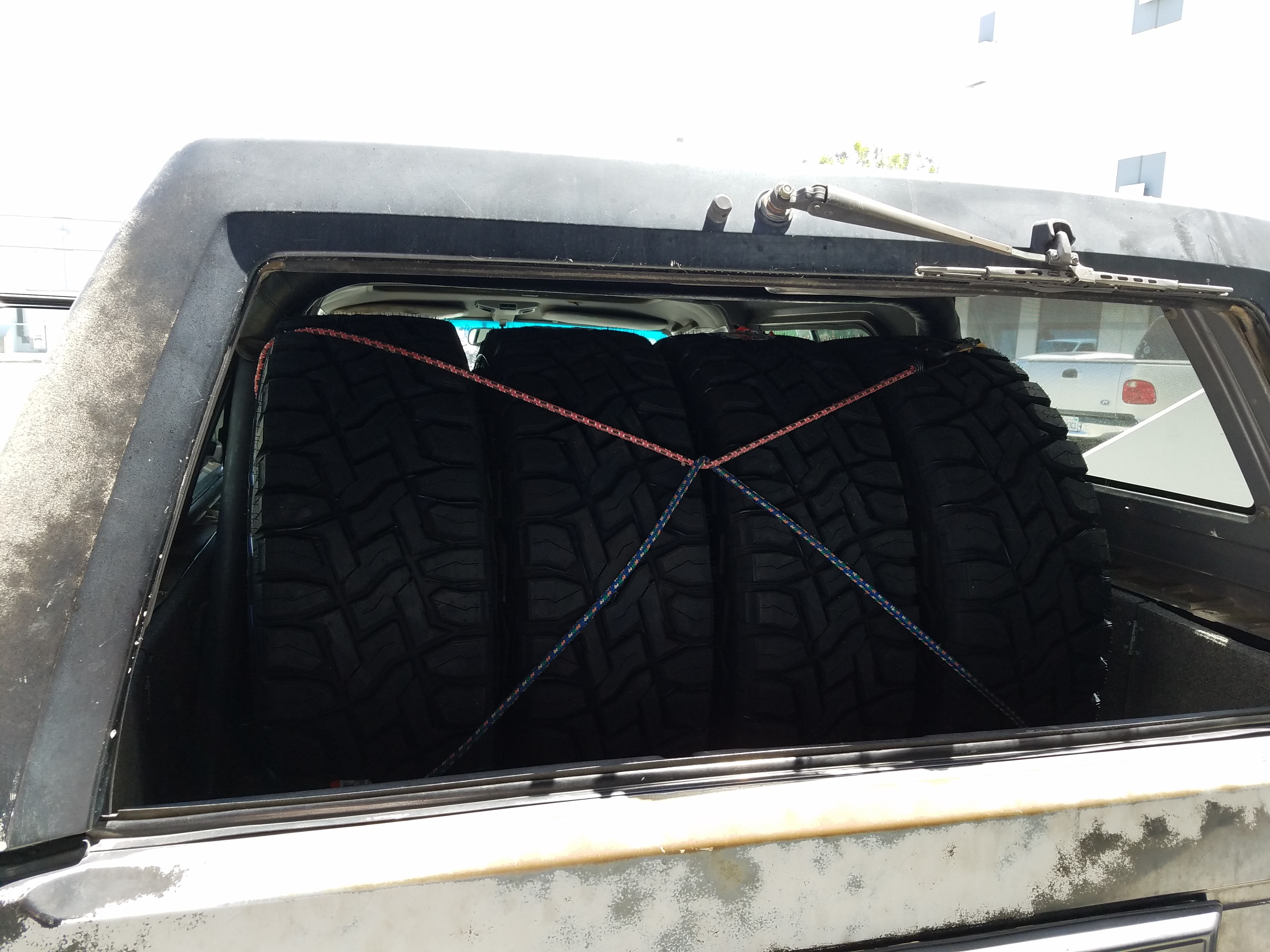

LCE Short shift in, Toyo Open Country R/T 31x10.5R15 mounted and balanced, alignment done. Heading out to the San Bernadino Montanans for camping this weekend. Should be fun testing them out.
It drives so nice now, compared to out of balance, worn Trail Digger M/Ts and a WAY out of spec alignment. Drives straight, no loud MT noise or violent shaking at 65-75. Plus the wheel returns to the center after a turn now!
The only negative thing I have to comment on is these tires are HEAVY! Just one tire (no wheel) weighs almost as much as the (now) spare Trail Digger mounted on my SR5 Wheel! Not extremely noticeable but I can tell. Just means their durable, right? haha

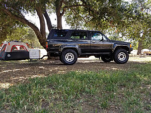

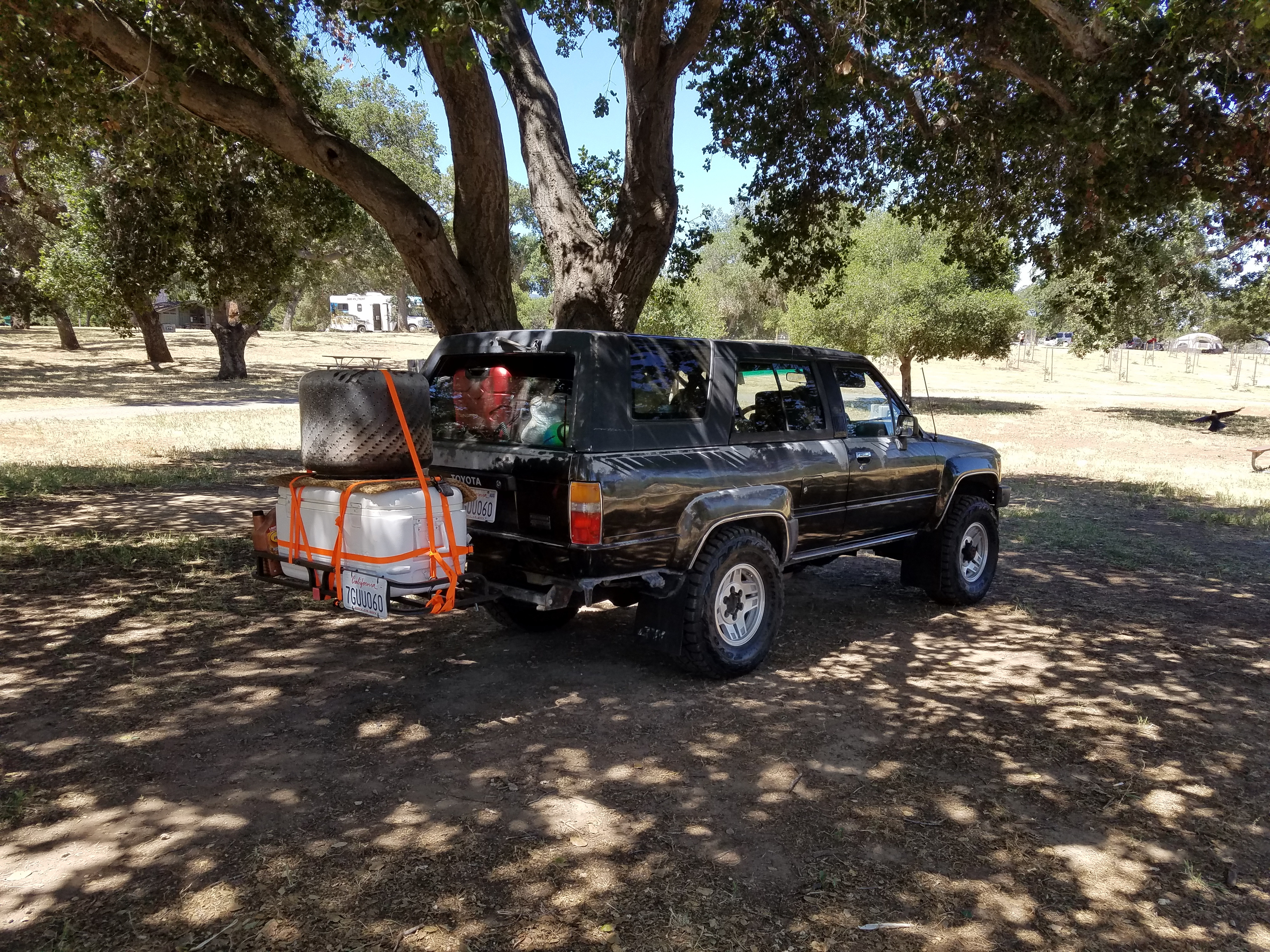

Loaded down the Runner over the weekend to test out the family camping/hiking capabilities. For the maiden camping voyage we headed out to Lake Cachuma for some hiking/camping.
It did well other than struggling up the hills. My input shaft bearing noise got a little more audible so now I'm on the hunt for a W56-B to swap out. Also started a list of camping aids for the runner that would have been useful. More on that later.

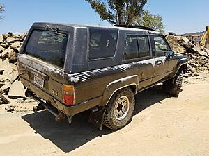

Took the runner out to a short local trail to play around for a bit. Consensus... I want lockers.

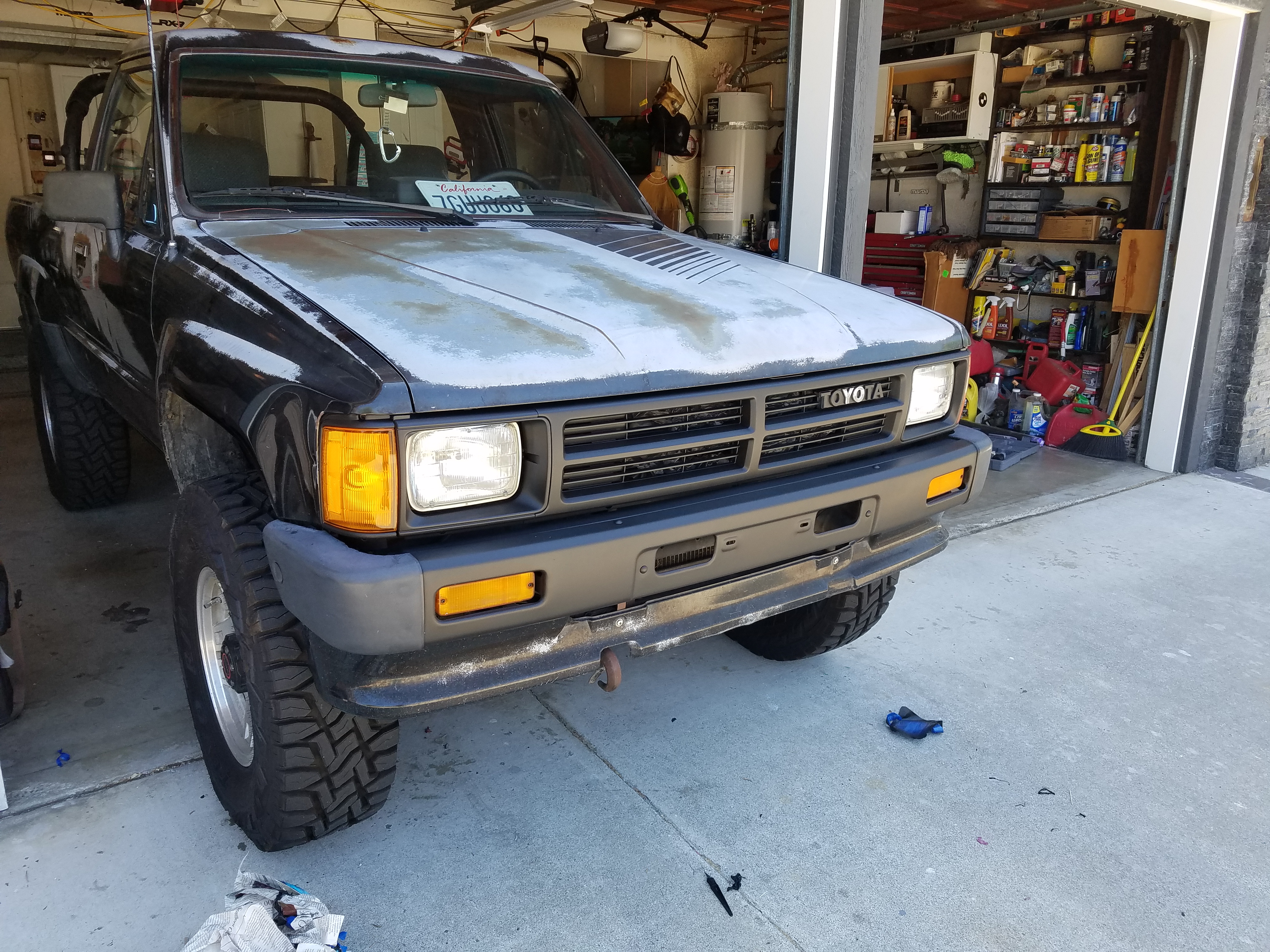

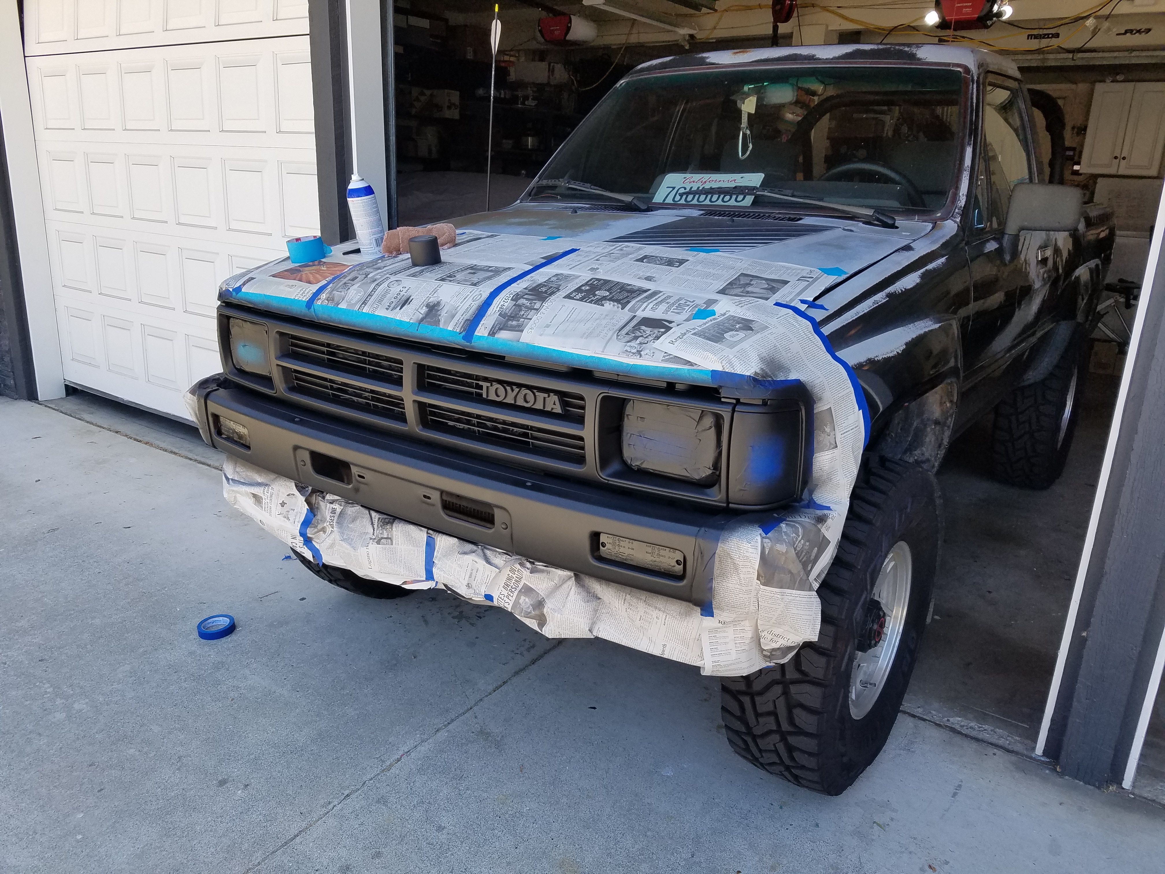

Had a chance to hammer out the bent up rear bumper and paint both front and rear bumpers along with the grill.
Did a valve adjustment and solved my ECT sensor issue. No more check engine light! turns out the wires had pulled out of the connector, ugh. Such a simple fix and wasted a bunch of time chasing it down.

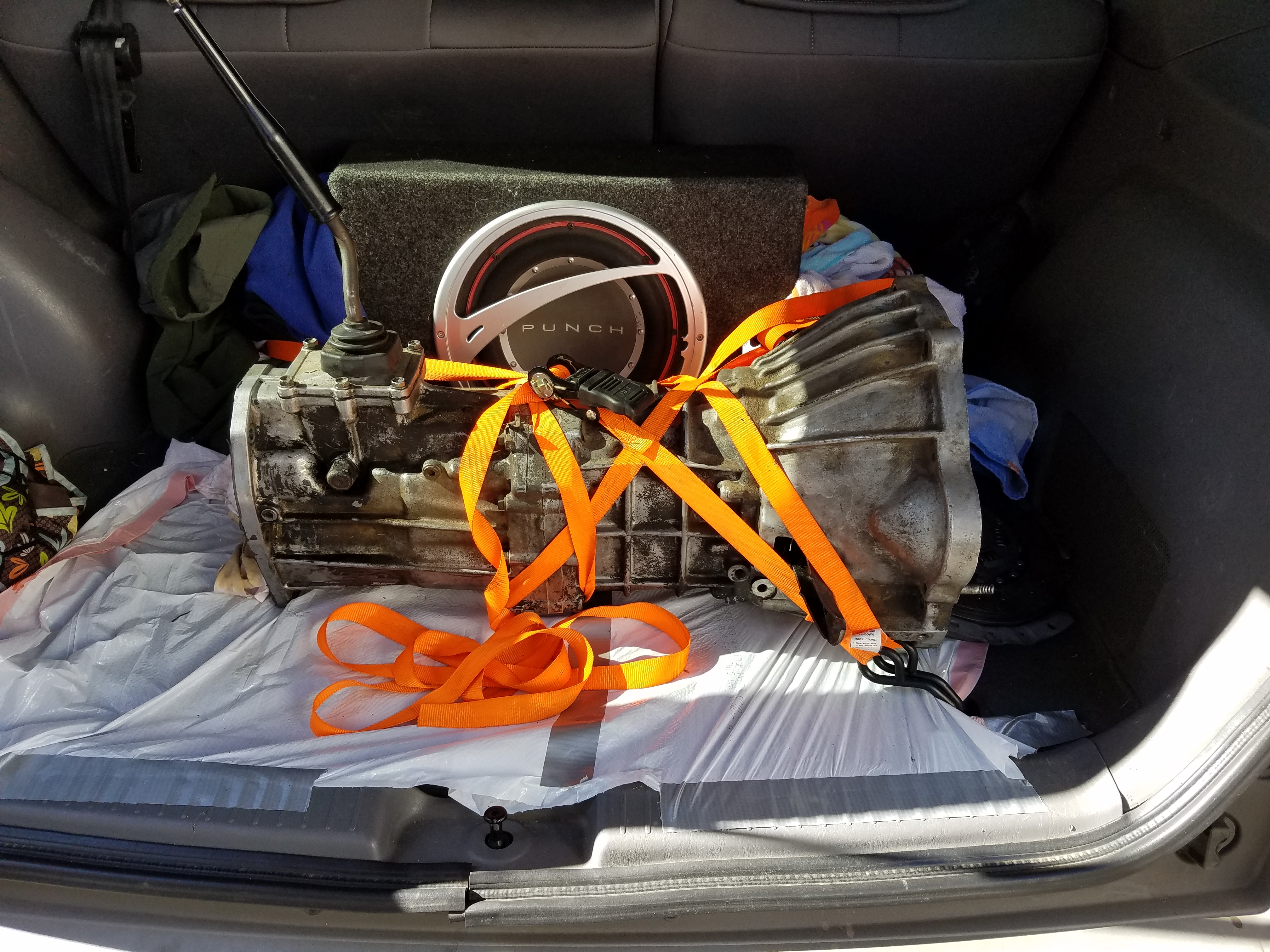

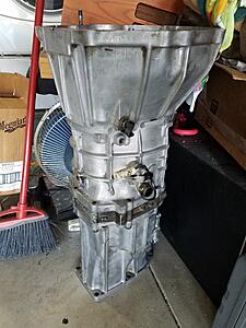

Picked up a used W56 from a guy on Craigslist swapping the input bearing and also throwing in new gaskets and input/output seals. He threw in a sub 1000 mile clutch along with it too.
Hopefully I have time to swap it out this month.

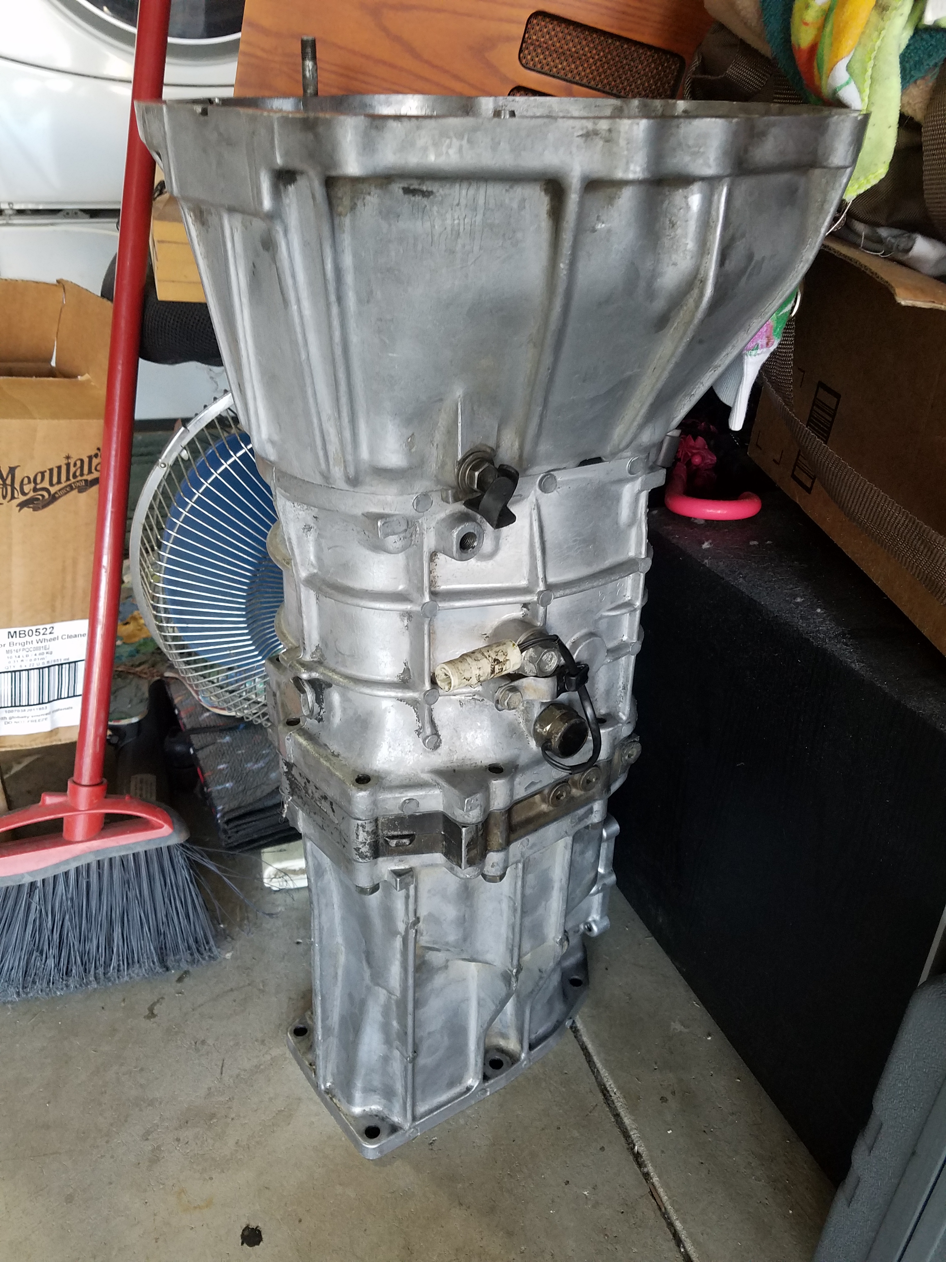

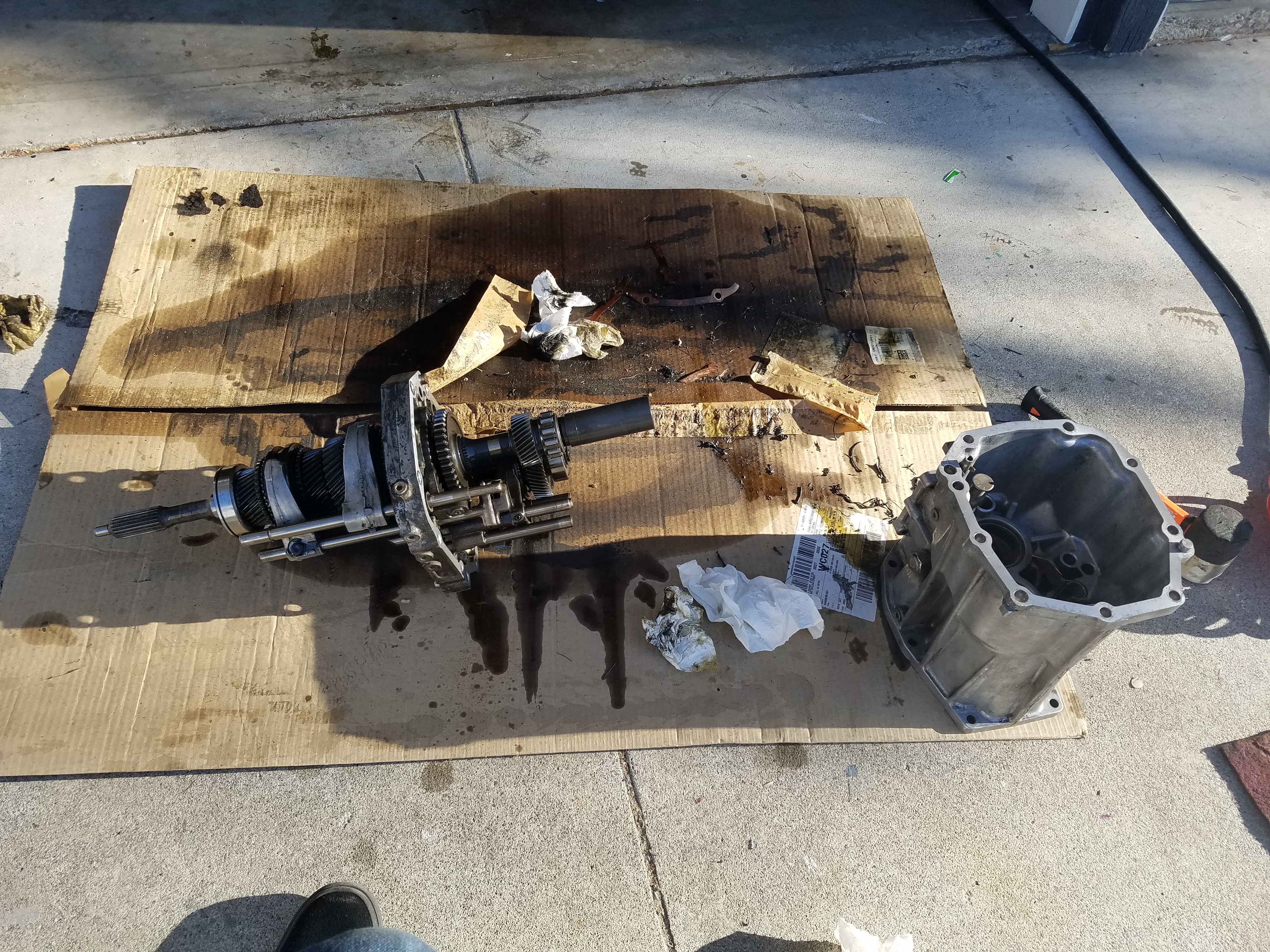

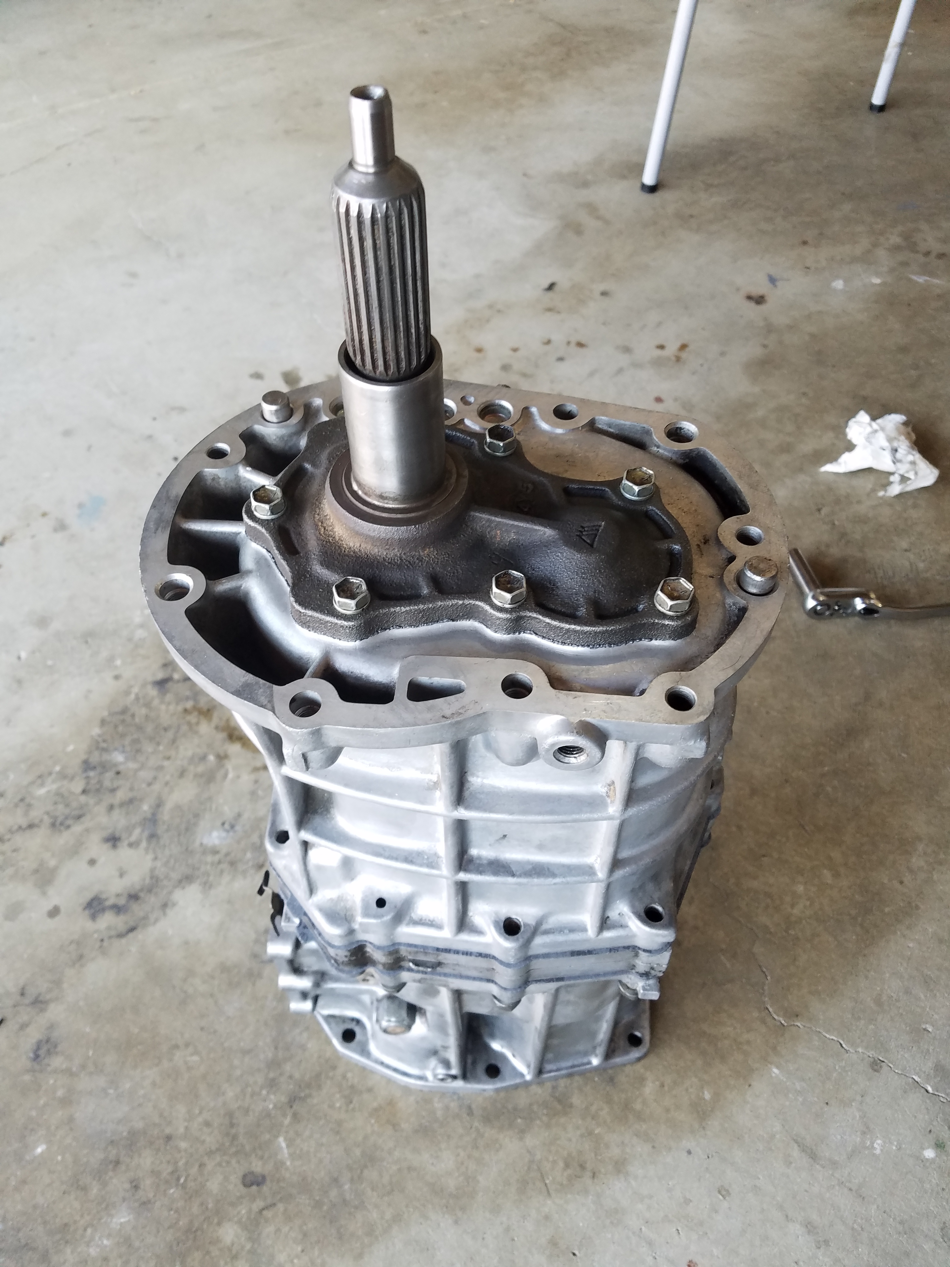

Got the transmission torn down completely, used some scrap pipe from the hardware store to hammer on the new input bearing. Cleaned up the housings with some engine gunk. Installed the new input/output seals. Got ready to put it all back together and it turns out Cobra Transmissions sent me the G series transmission gaskets inside the W56 gasket/seal kit. So now Im at a stand still until they get me the correct gaskets. Mildly infuriating having to halt the process.
bagged everything up and now... I wait.

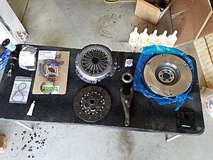

Got the correct gasket kit and the W56 with new input bearing is all back together and ready for install. Picked up a new Flywheel have the clutch kit, rear main seal, trans mount and Red Line MT90 ready to go in. Hopefully I can get it done next weekend or the following weekend. Sooner than later hopefully, 4th gear is giving me hell lately due to the bad input bearing currently in the truck. Anything else I should do while I have the trans out?

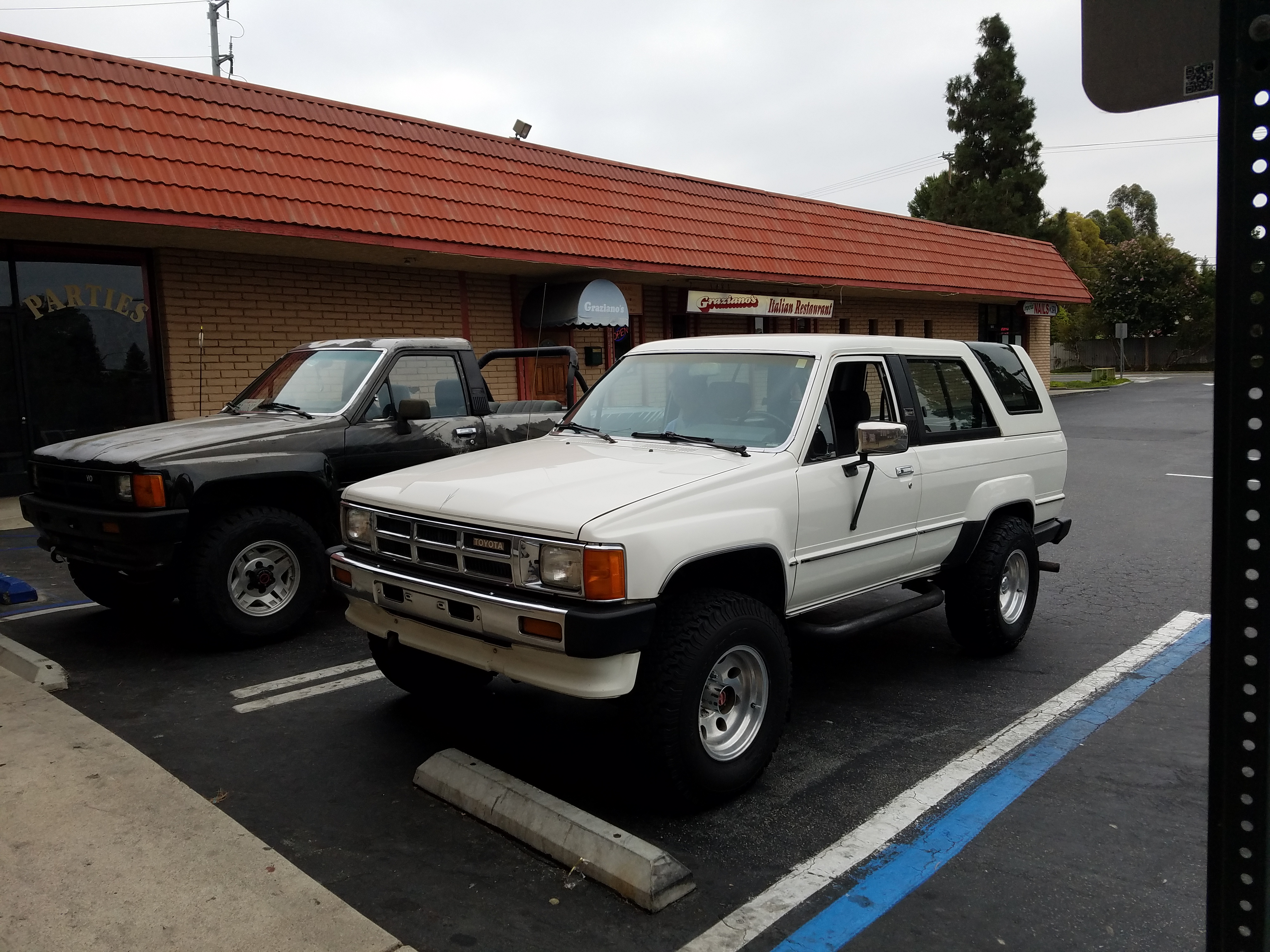

This guy parked next to me this morning at the liqueur store. Older couple, had a nice chat with him and his wife. Hes had his 86 DLX since new and it has clean original paint and around 350k miles on the original 22re and still running strong.

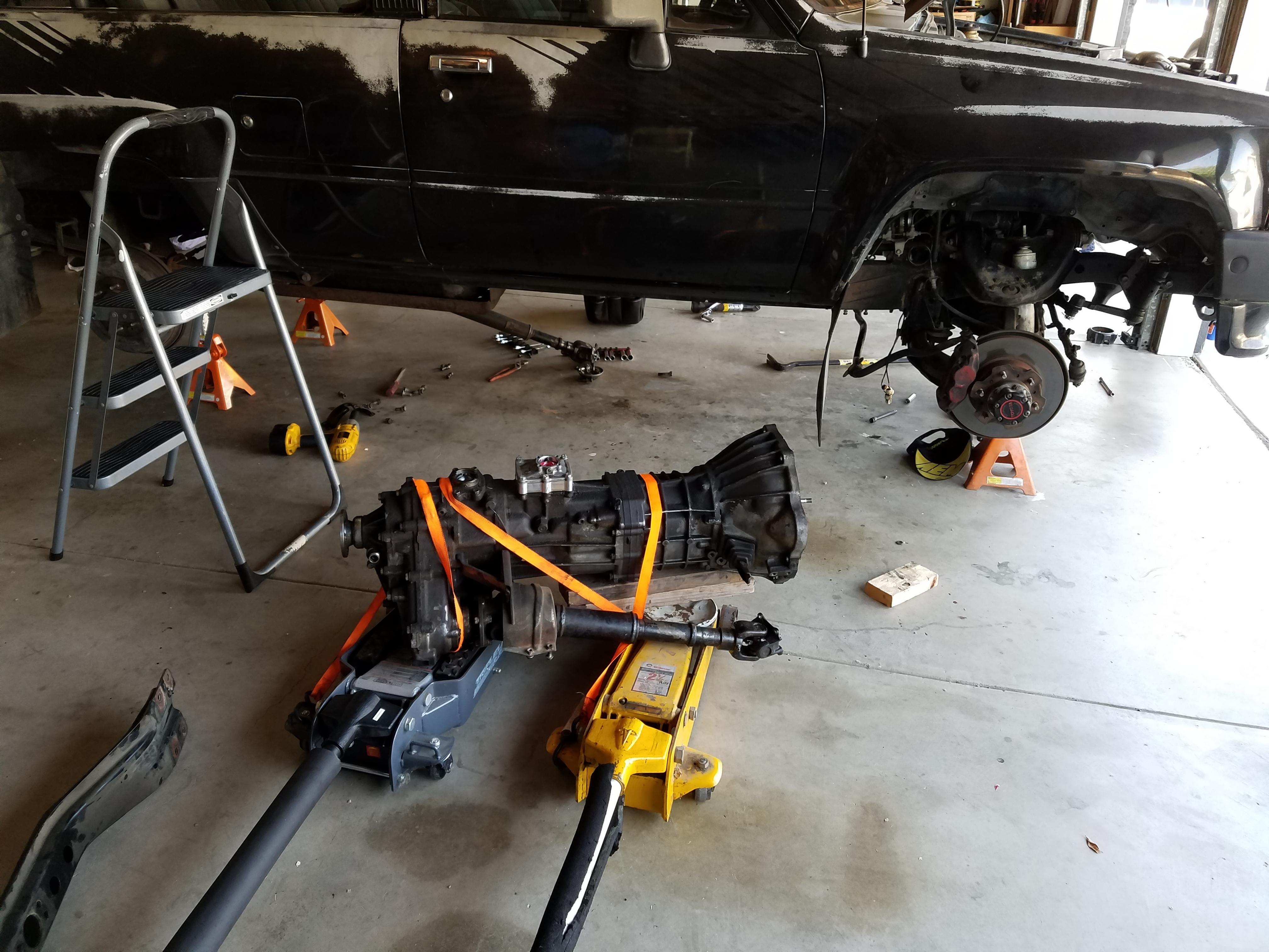

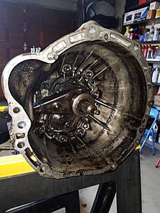

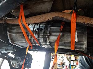

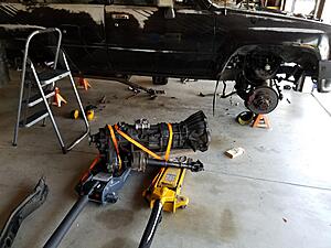

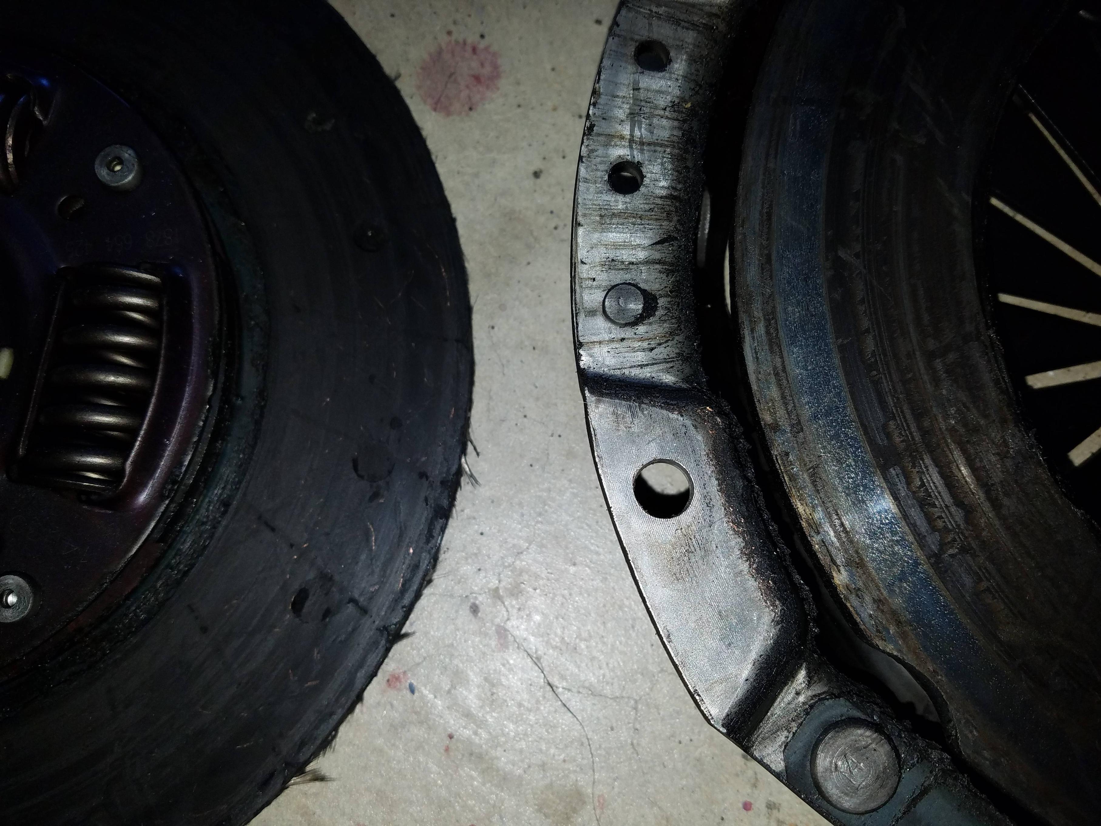

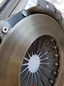

Well, Im about 2hrs into the trans swap. Got the bad unit out and the clutch/flywheel off. Wonder why it took so long to engage from a stop? New parts ready to go in!
Clutch is packed with gear oil, input seal leak along with about an inch of input shaft play.

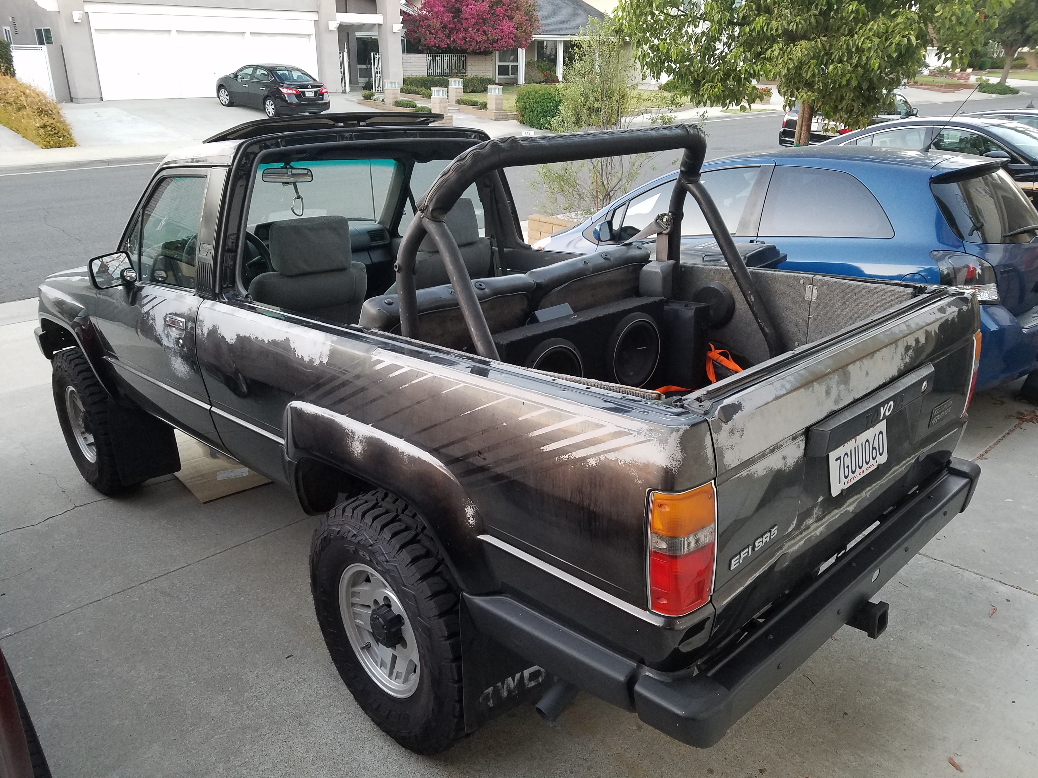

7am to 5pm, Done and Done!
Painted the wheels too!
