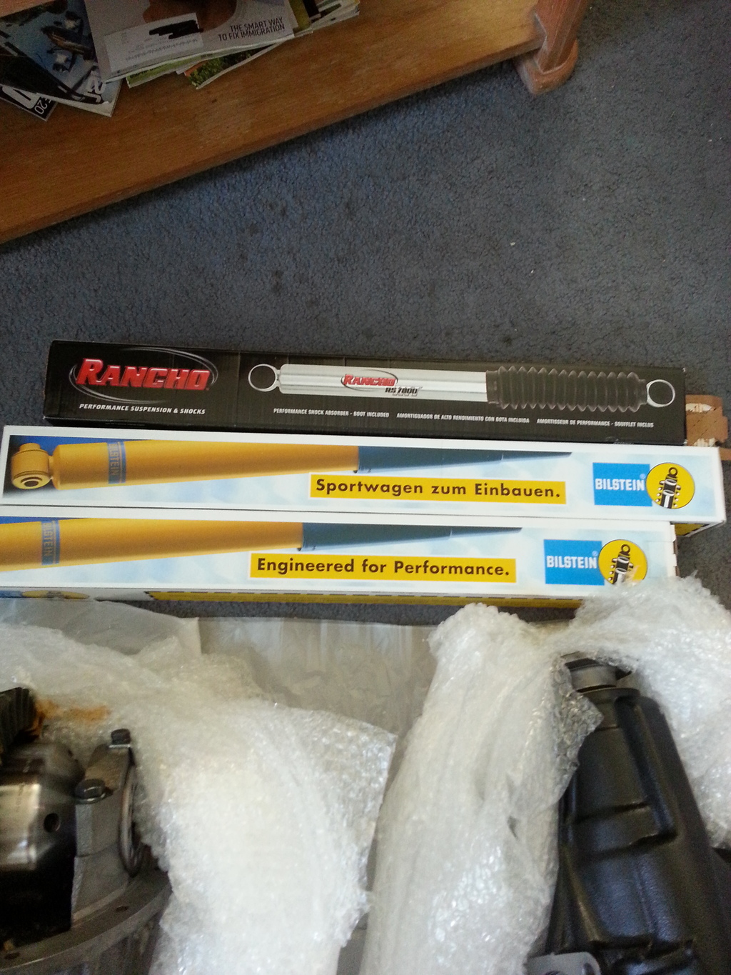

So my items are starting too come in. My rear shocks plus my rs5000 stabilizer shock are in with the steelies i got also(new rims). Just waiting on my front and rear diffs from MC. Will put up pics, been saying that for awhile now but trust i will put up pics when everything is in. i'll keep you guys posted for sure

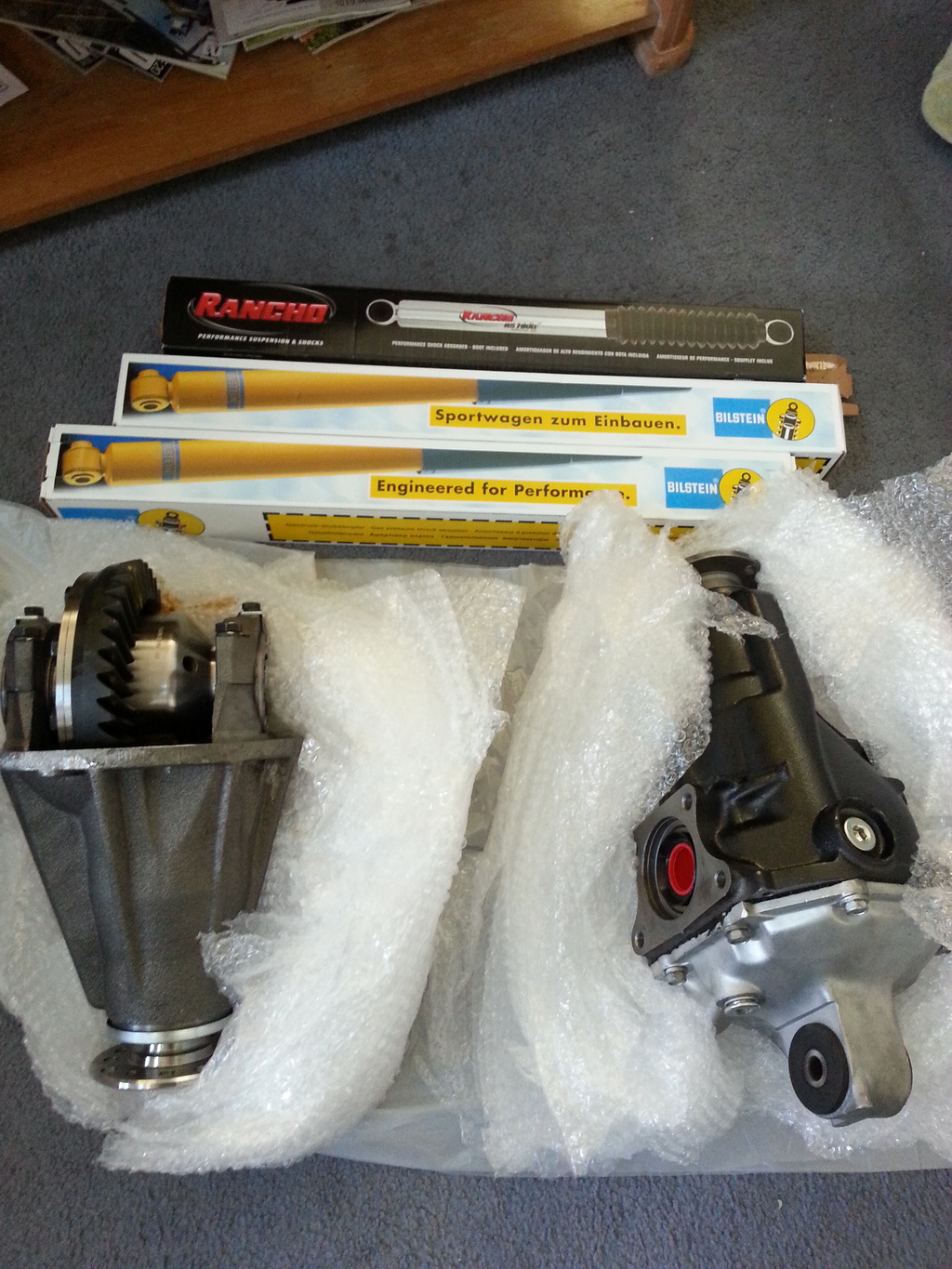

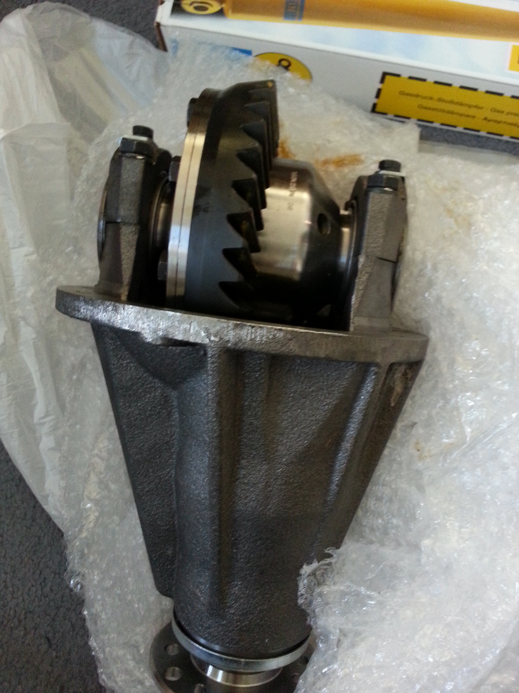

Talking On and cracking
http://i1295.photobucket.com/albums/...pss4tswxrk.jpg
http://i1295.photobucket.com/albums/...psdx46emew.jpg
http://i1295.photobucket.com/albums/...psqksmor2e.jpg
http://i1295.photobucket.com/albums/...psybxci0eq.jpg
Here we go guys gotta get this in and break it in...then got sum spots were i'm gonna go mount and have fun climbing hell yeah guys

Red face Lets try this again

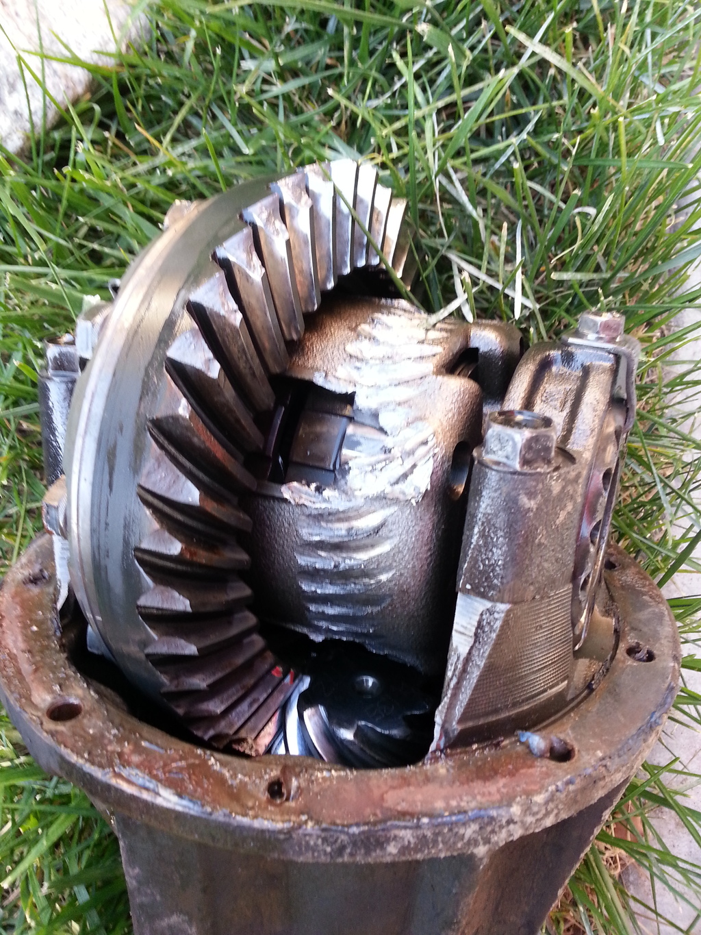

Talking Old rear diff.
Yeaps that was all bad guys. But got the new rear diff in with alilo mod so it would fit in the houseing right. But its all goid now. Running late so the front will be worked on 2morrow with the shocks

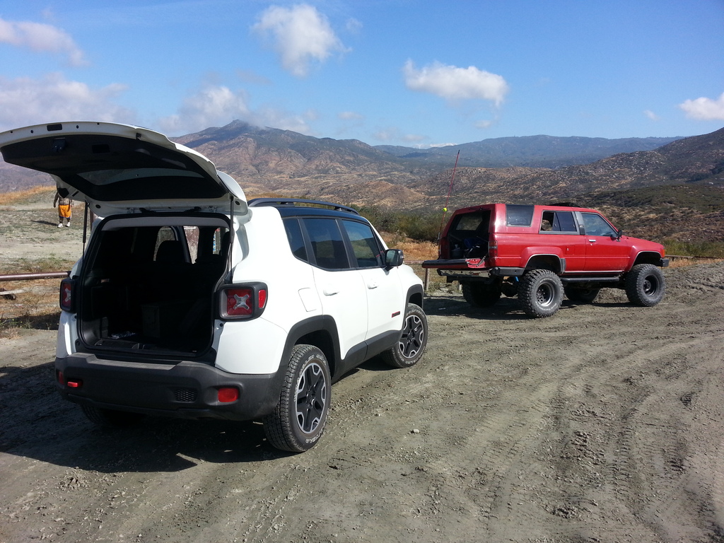

Talking Nice...keep rollin oN

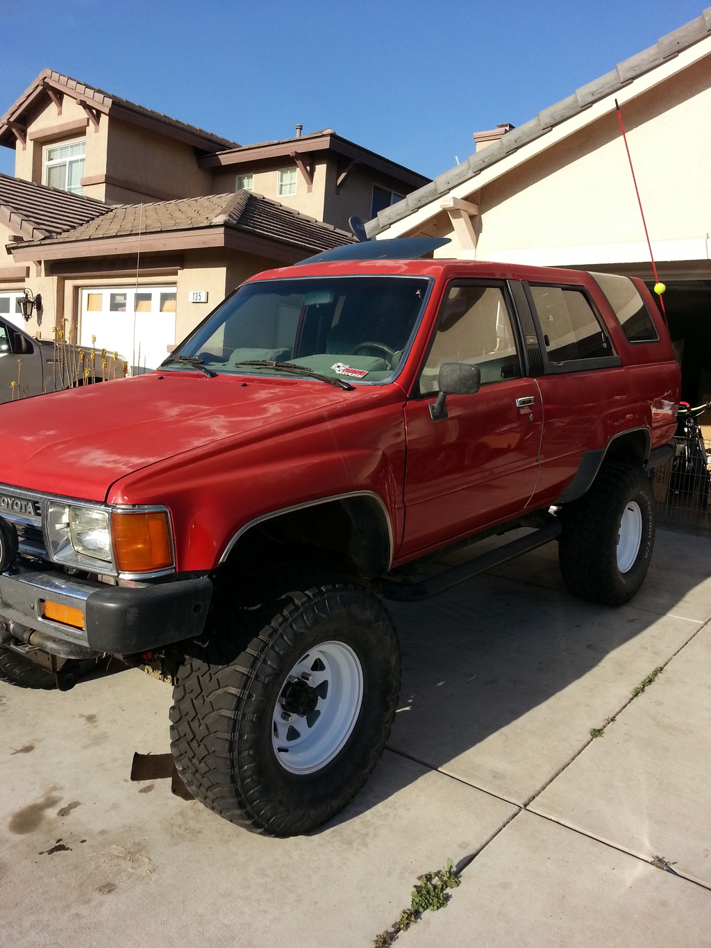

Was nice too roll again. Love da 5.29 gearing i put in plus da locker from yukon is great. Makes everything roll really nice no more wheel spin from da rear on rocks n other stuff pretty nICe guyS o yeaH!!

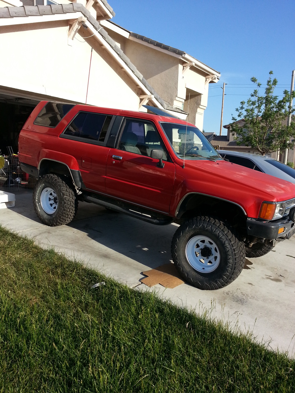

Talking Wheels
I think those steelies look good

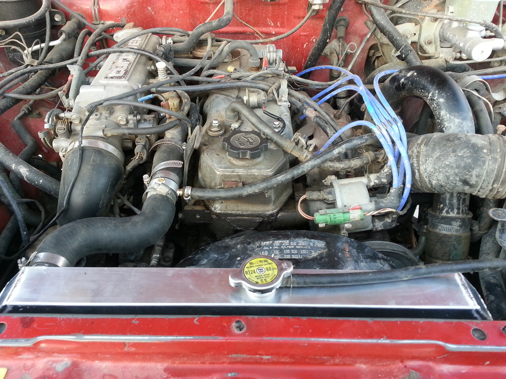

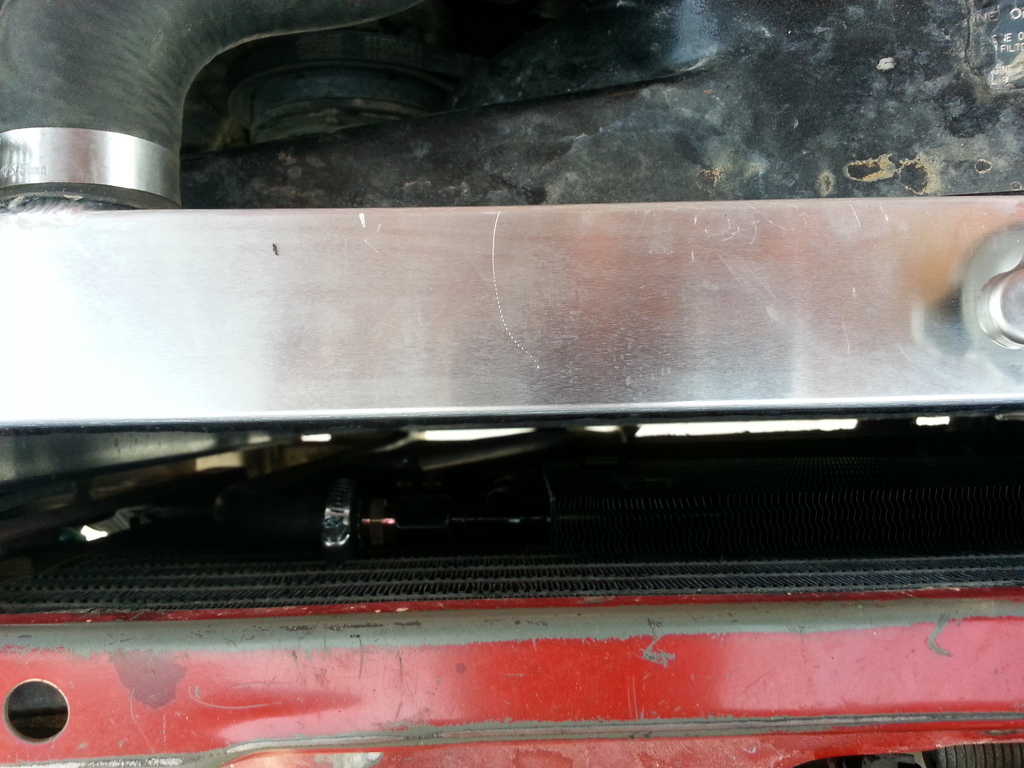

New rad. Install, hope it works out.
Also installed ah new oil cooler too keep the heat off the rad too.
Can't reallie see it but its in the middle of the ac and rad. 75% cooling. Gotta see if it works.
