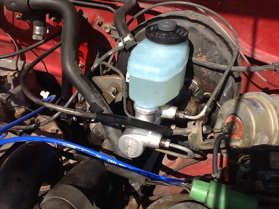

ok so i'm going slow at this but hey its moving. Just put in ah 1" bore MC from low range off road. Hardest part of it all was getting the right 90 degree bend on the rear line too screw into the MC. I had too bleed all the lines. Old fluids was thick stuff. last owner had new fluids in the bottle only. Gonna have too get those v6 calipers for the front, brake pedal feels harder now from the last MC i took out. It feels like it didn't give me better stopping power but for sure its gonna only take one pump of the brakes now instead of two

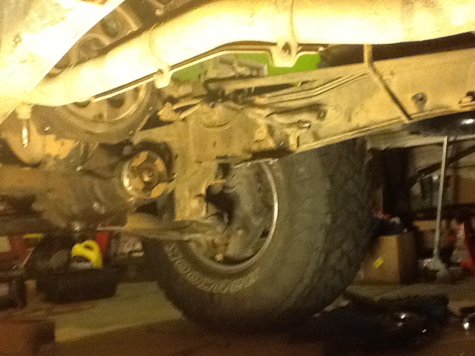

i had too add this, didn't really take pix's when i was changing out my dead 22rte a340h. Stupid thing still got new parts on it plus filter. Pulled it cause it lost "R" and "2". Started off acting up. Not wanting too go up hill with out good rolling start.(i think that was when i lost second gear) when i did ah manual shift test, that's when i lost reverse. so i didn't have a nice pool of cash too start off or else i would of went with the 5-speed swap
Had money for ah used a340h out of ah 88 4runner v6. Picked that up
Then i had too change just a-little too make it work. Bell housing, cross member had too be shaved down a-little too clear the drive shaft from grinding the cross member if i'm calling it right.(it holds the transfer case and tranny up.) the v6 a340h trans has shorter wires then the old one, so i had too extend the wires so they would plug into each other. Broke ah fly wheel bolt so i'm only running 5 sucks i still gotta open her up again too fix that. The four low on the new trans works good, have not tried the four high yet?
More projects too post up when i get too them.

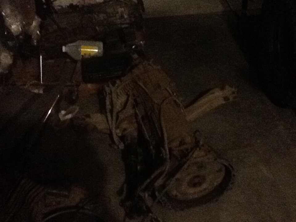

I think this one was the v6 a340h

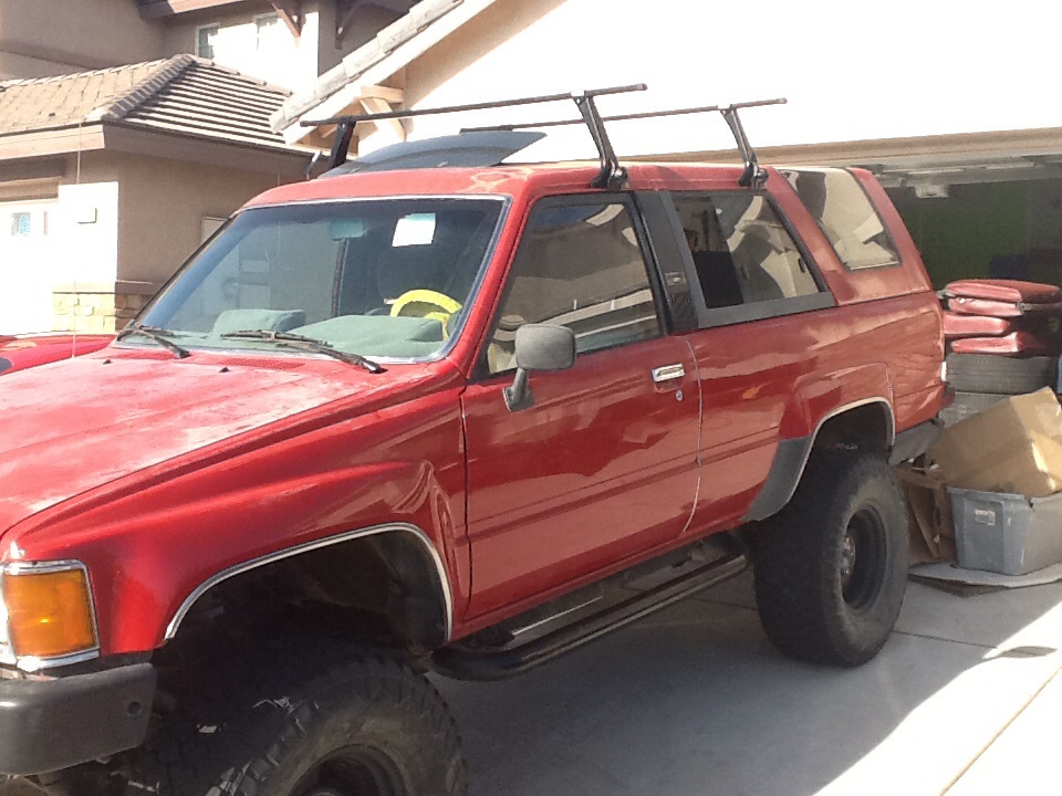

my rain-gutter roof rack system came in.
well better more then not enough, was trying too clear the moon roof got extra two n half or three inches over. Just in case, next would be ah cagE
Had too clear the moon roof so the glass can open if i run the cage more too the front.

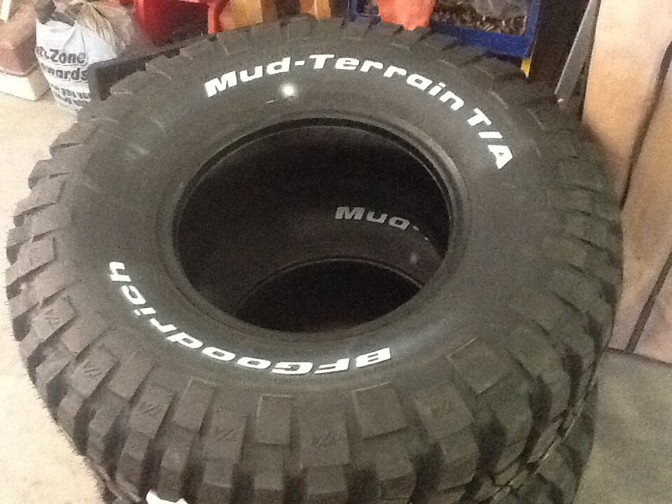

Talking Km2's came in.
My first set of tires for wheeling. Had to replace the old worn out with one nail in it km1. Kind of good other then that it can't hold pressure. Also an ok hankook dynapro mt that will become ah spare. Working on getting ah set for the front ASAP still got too mount them. Been hunting on trails with bfg AT, so these bfg MT should be nICe

Nice runner, those KM2 are going to look sweet on it! Did you step up in tire size, or did you already have 33's on it before?

Naw the last owner from what the members here said looks like he added 3" bodylift, maxed the torsin bars and add ah leaf spring. Yes i'm just replaceing tires of the same size. Hopefully by this weekend i can get some time too get them on the yota.
