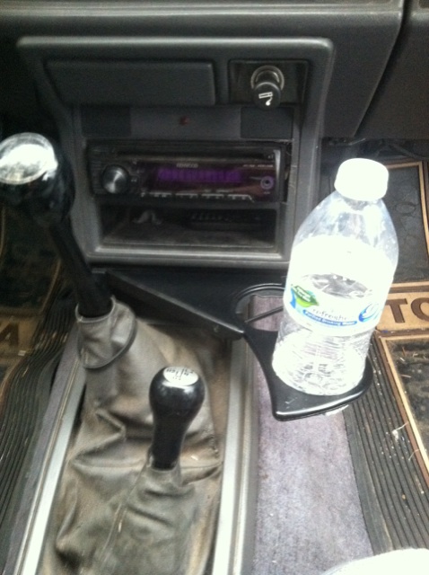

How about this for cup holders. It's out of a newer passat or jetta have had mine in my 4runner for 2 years and haven't spilled a drink yet.
What year Jetta? How did you mount it?

https://www.yotatech.com/forums/f123...trucks-260137/ here is an explanation of how I did it but I have since used a metal strap thing to hold it in place now but they are out of a 2000 and newer passat or jetta.
